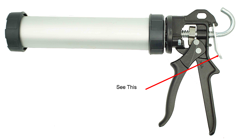

SteamyTea Posted July 29, 2025 Posted July 29, 2025 Depress the latch lever as soon as you finish applying. You can get silicone sealant remover, but white spirit works as well when it is still soft. If you are using polyurethanes, I have told you what to use many times, but as you decided that it gives you cancer, even though its main usage is to get the caffeine out of drinks, I can't be bothered to tell you again.
