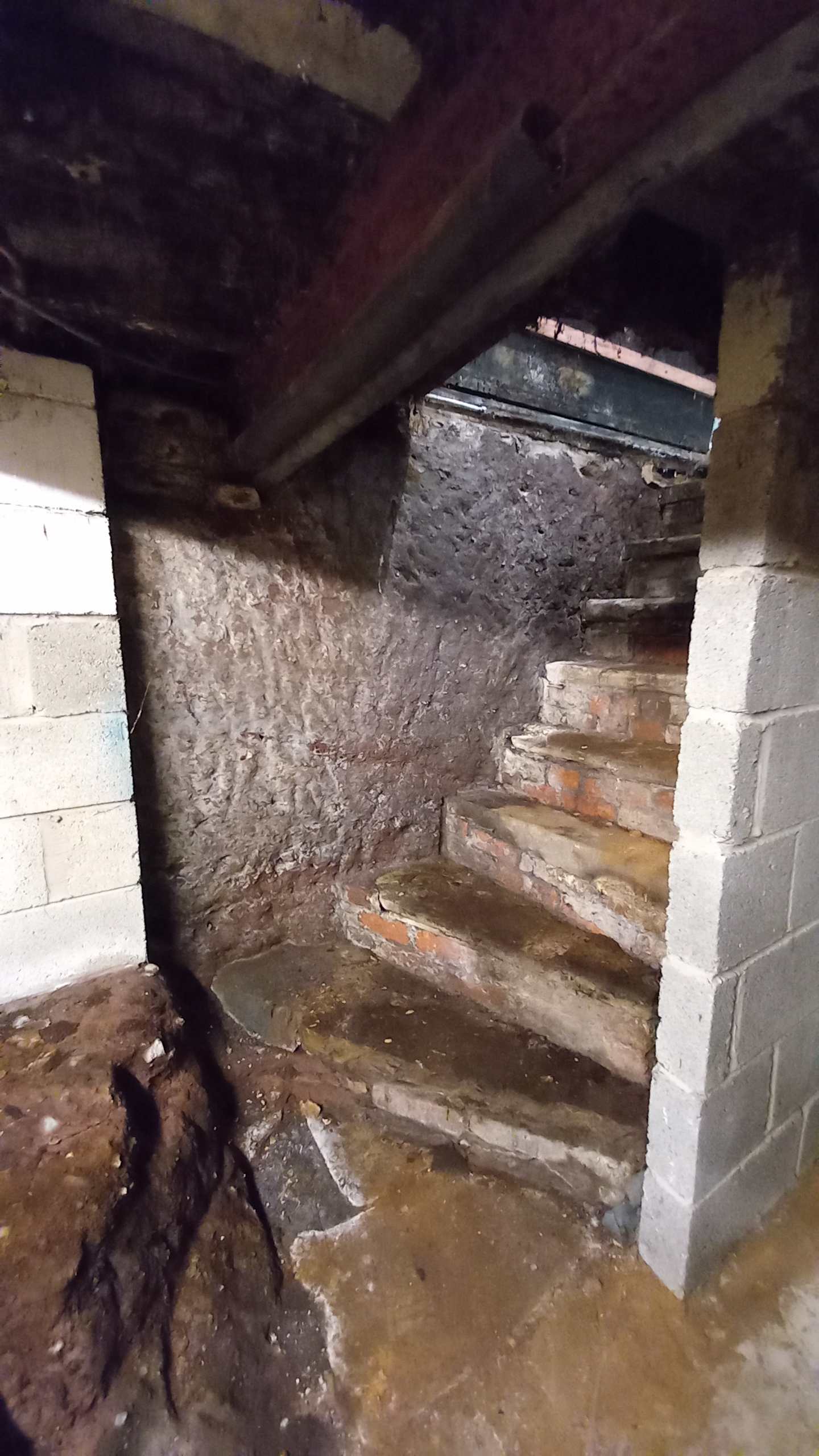

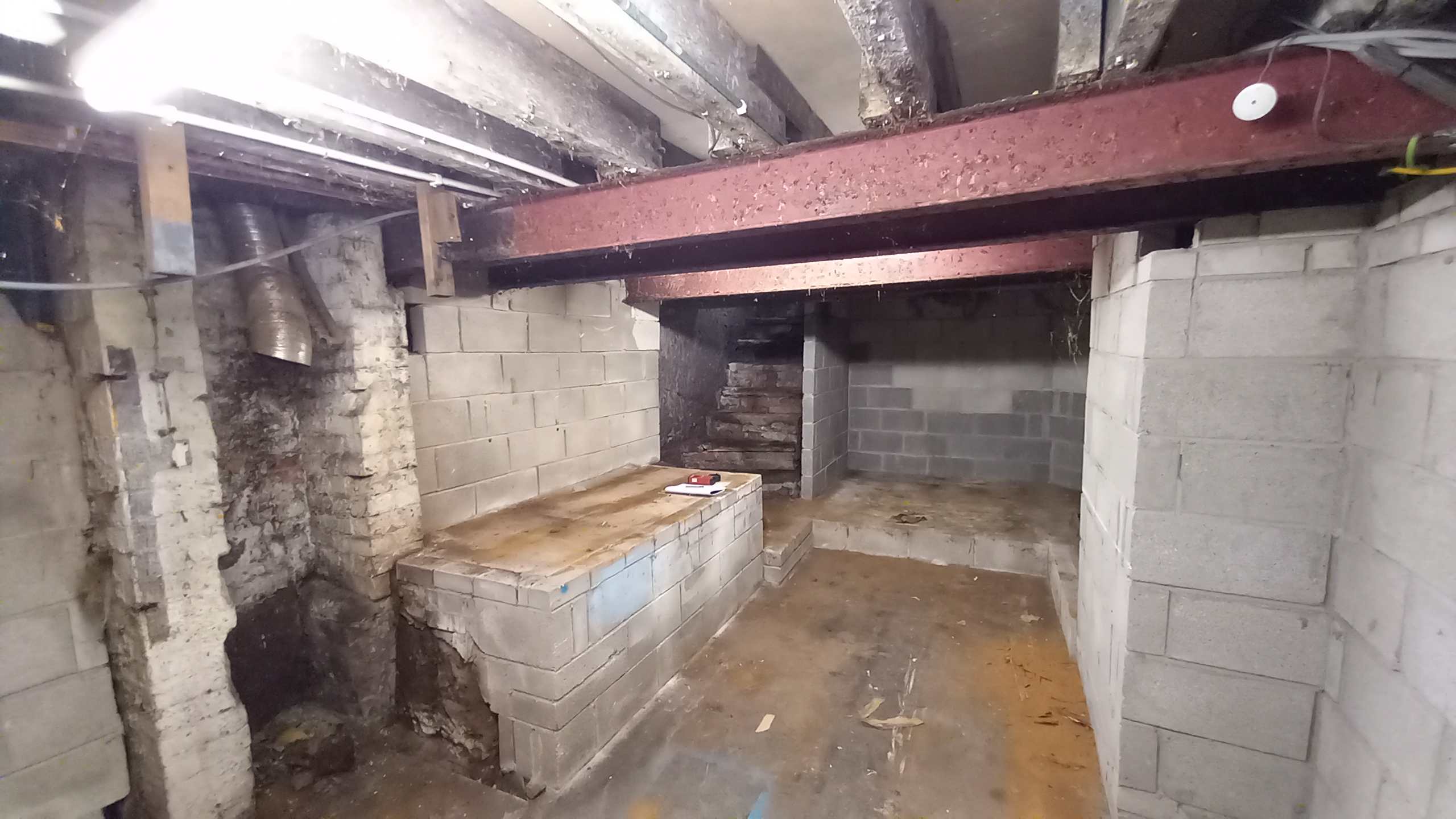

MarkGee Posted July 23, 2025 Author Posted July 23, 2025 11 minutes ago, Mr Punter said: I would consider just treating it as a crawl space, closed off from the floor above. You could maybe put in a hatch for access. Unfortunately that wouldn't be practical due to the usage of the building. The front of the cellar has no issues as that is brickwork from all the tunnels etc in the area. You can see from this image that it's brick on the left but the sandstone starts just after the chimney breast (behind the block work), and steadily gets higher as you go towards the back of the building. So on the ground floor, the floor joists at the rear are sat directly on top of solid sandstone.

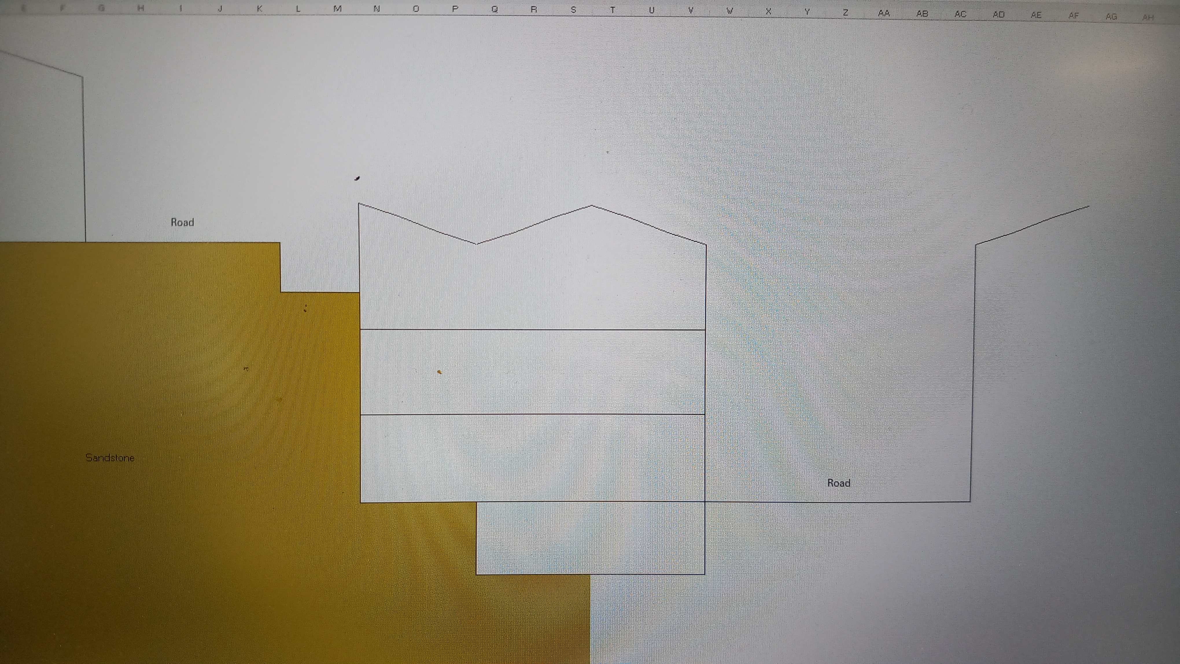

MarkGee Posted July 23, 2025 Author Posted July 23, 2025 47 minutes ago, saveasteading said: No magic chemicals I know of, and most would alter the stone. Is it a flat or sloping area? Ie where is the water coming from? Does it vary seasonally? I just knocked this up in excel. So this is side on. I imagine it's rain water hitting the sandstone on the road above/any damaged drains. The wetter the weather, the worse it is. 1
saveasteading Posted July 23, 2025 Posted July 23, 2025 That's superb info. It might be wetter if there was no road, because that is a lot of hillside collecting rain. Are the other storeys dry, or you can't tell because they are tanked/ covered? You need people from Edinburgh for this. There are tower blocks from the 1800s with 9 storeys above ground, facing downhill, fewre facing uphill, and into basements. Sandstone too. Google Earth: West Bow, Edinburgh That's the good news.. they lasted a long time.
