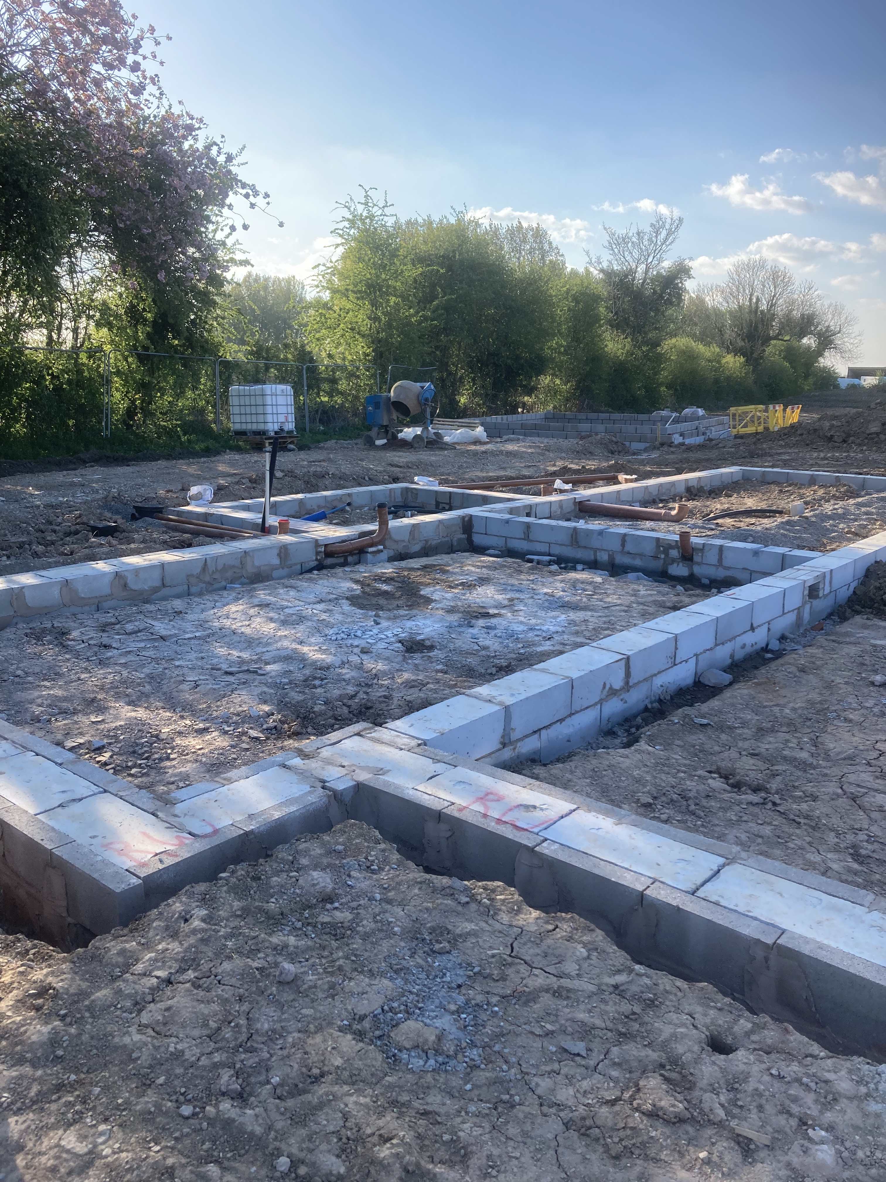

I hit chalk within a metre, so planning on using strip foundations.  Estimators have gone with trench fill and they have listed the following m2 figures.
Block solid concrete 7.3Kn 100mm, cavity walls.       M2    62.983
Block solid concrete 7.3Kn 100mm, internal walls.    M2    20.583
I lost my Brickies for the foundations on the first day
It only took my wife and myself five days Pay them £18 meter

I am also very interested in the approach taken with the construction method.  So I see you have got a solid 100mm + 225mm + 100mm  wall?  I have not seen this before and always assumed that you just laid the blocks as standard and then filled the cavity with concrete.  Is this an alternative option to that approach?
I used the 100 mil solids to add extra width on the foundations As i had a plinth wall running around the front and and side and six inch solids at the rear elevation due to an architect's cock up

So my most recent quote of 60k for below DPC and then up to plate is a bit steep 😂
Lincolnshire. Day rate - labour only.
From found to wall plate inc two external gables and one internal.
101m2 external 150mm cavity wall. Brick/block with English garden wall bond externally. 45m2 internal block some 140mm and some 100mm. All “technicians” work I.e tray, taped insulation, stays etc. insulated block and beam with reinforced slab atop.
couple of days left but currently sitting at 13k and forecasting to finish under 18k
