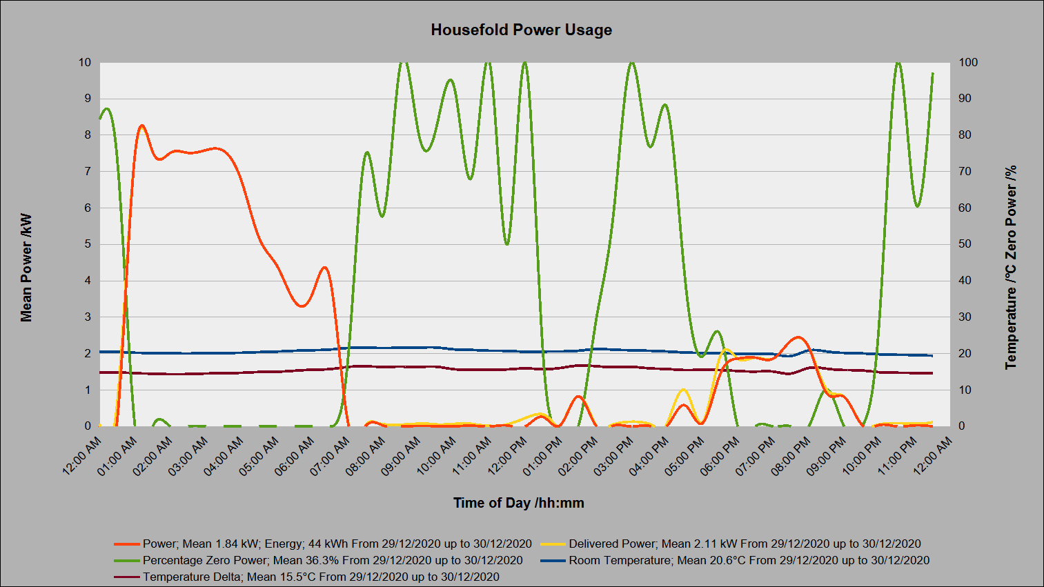

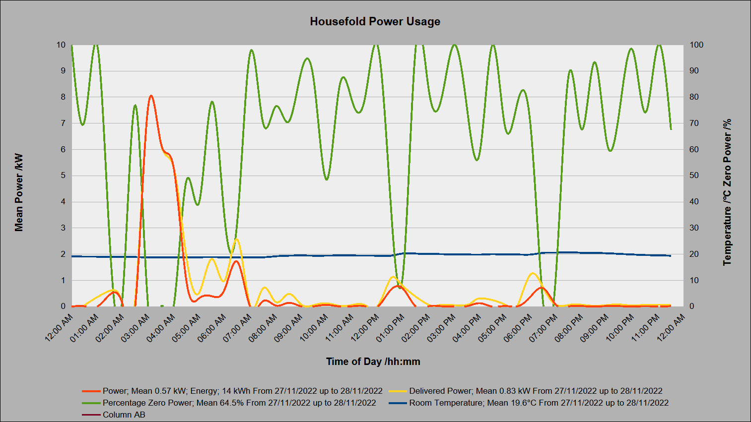

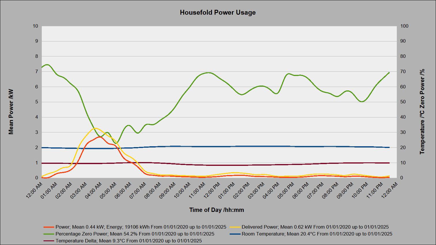

SteamyTea Posted July 19, 2025 Posted July 19, 2025 (edited) Knowing means values is one thing, but they cannot recreate a detailed, fine grade, model. For that you need other statistical parameters. As an example, here is some of my usage data. It is my mean usage figures for a 5 year block, then a couple of random days. Edited July 19, 2025 by SteamyTea

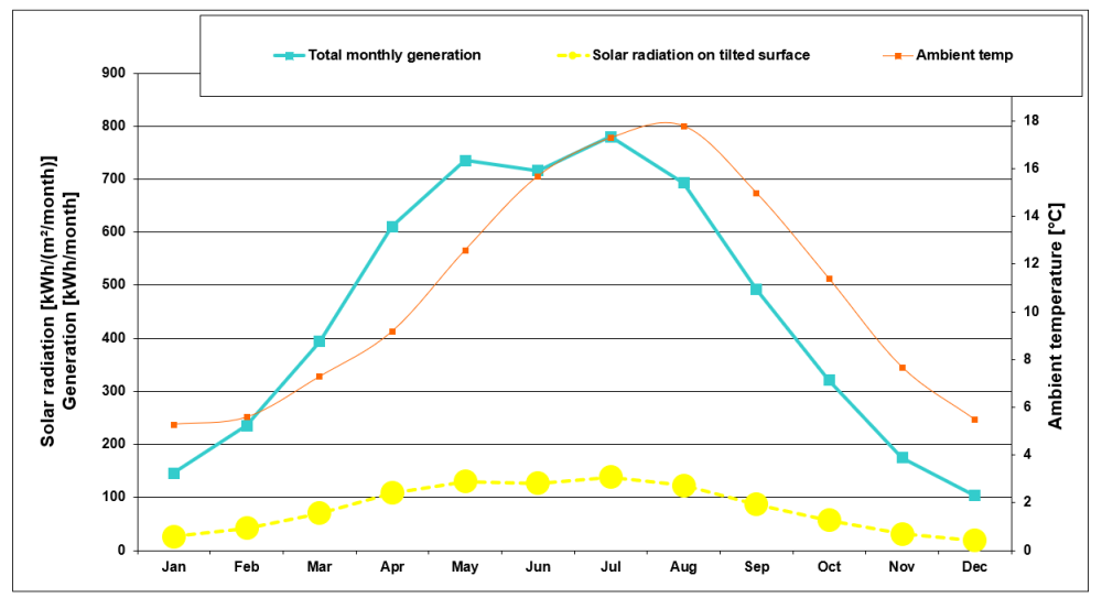

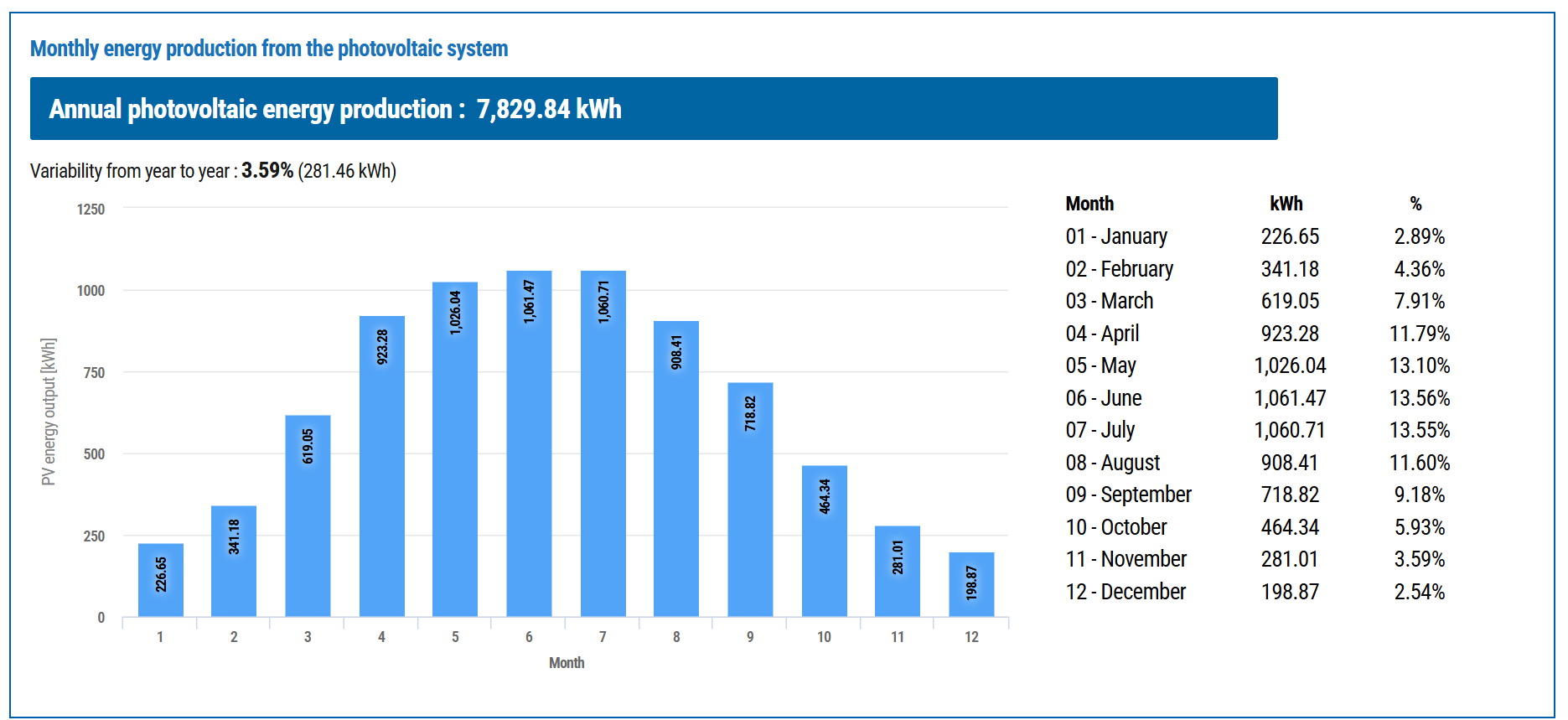

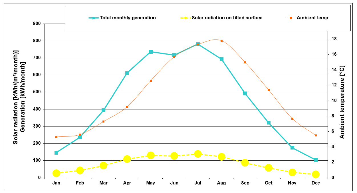

MikeSharp01 Posted July 19, 2025 Posted July 19, 2025 Just ran our system through the PVGIS system. Previously I just used the PHPP calculator to work out how much we should be getting, as this is the final arbiter of whether or not we get Passive house status. Interesting that the PVGIS finds our total generation should be 7,829.84 kWh while the PHPP package using the same data gives 5,723 kWh. The PVGIS has no settings for shading but even if I remove the shading from the PHPP sheet it only gets to 6,500 kWh. So with shading the PVGIS should be a little lower I think. Interestingly though the reality gives another angle - see below. PVGIS PHPP Actual production this year (Exceptional I know) yet to be established but for export alone we have for the first two full data months: May @ 993.262 kWh June @ 1,052.983 kWh The predictions are not in agreement and actuality seems to favour the PVGIS prediction (May @ 1026 kWh and June @ 1061kWh) if anything but only given we have had an exceptional May / June and these are EXPORT amounts not generation. Both May and June were a fraction out, by hey who is counting, - everyone of course.
SteamyTea Posted July 19, 2025 Posted July 19, 2025 10 minutes ago, MikeSharp01 said: The predictions are not in agreement and actuality seems to favour the PVGIS prediction Not sure if the predictions take into account air temperature, but they can, if unseasonably high (i.e. 1.5K above mean) reduce output. Like climate science, which is generally 30 year weather averages, solar prediction does not take extreme variables into account. (Also just noticed that a data series on my last chart is missing, the deltaT, because I used a cell to make a random date calculator, makes no difference to what I wanted to show)
