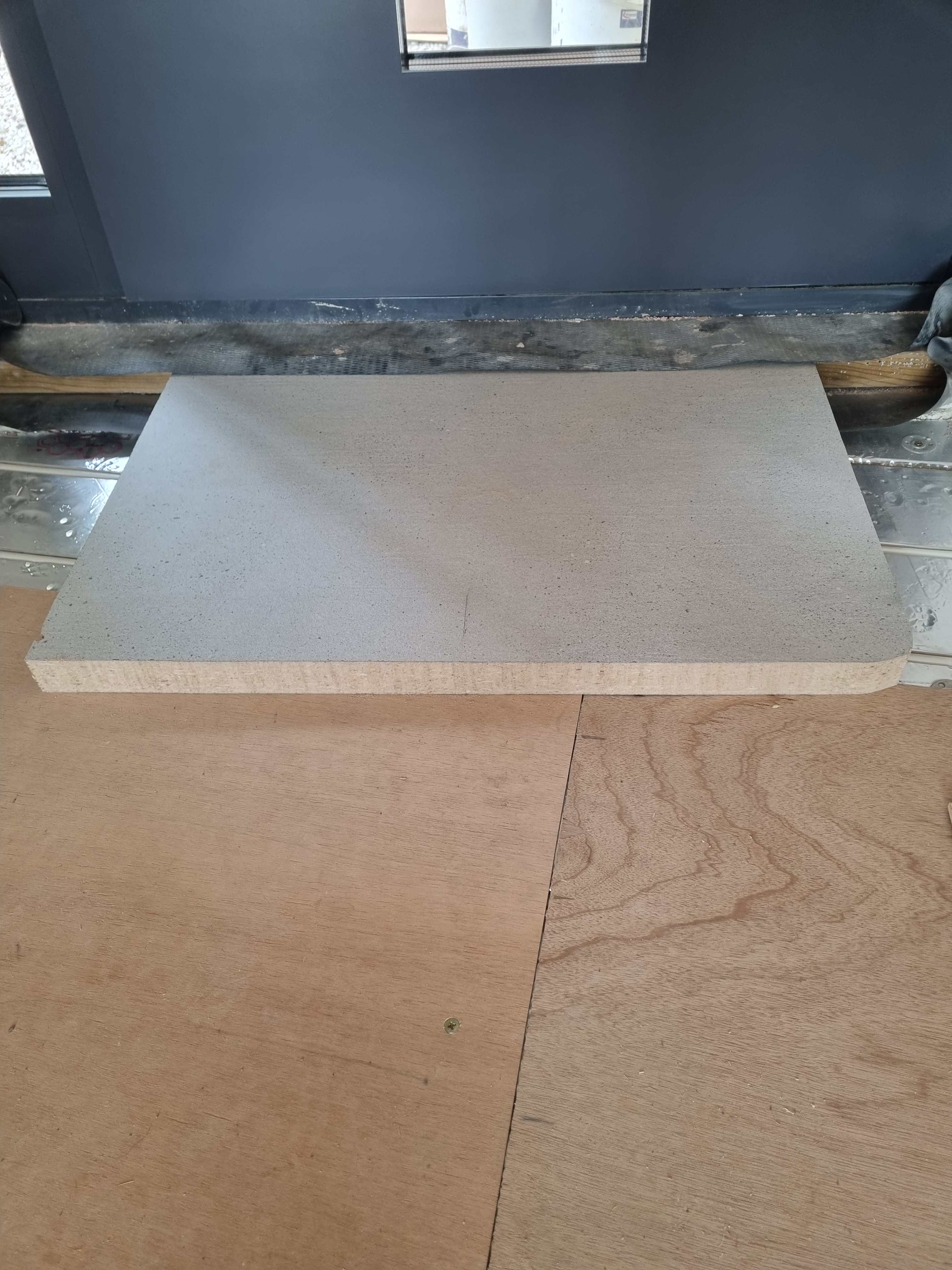

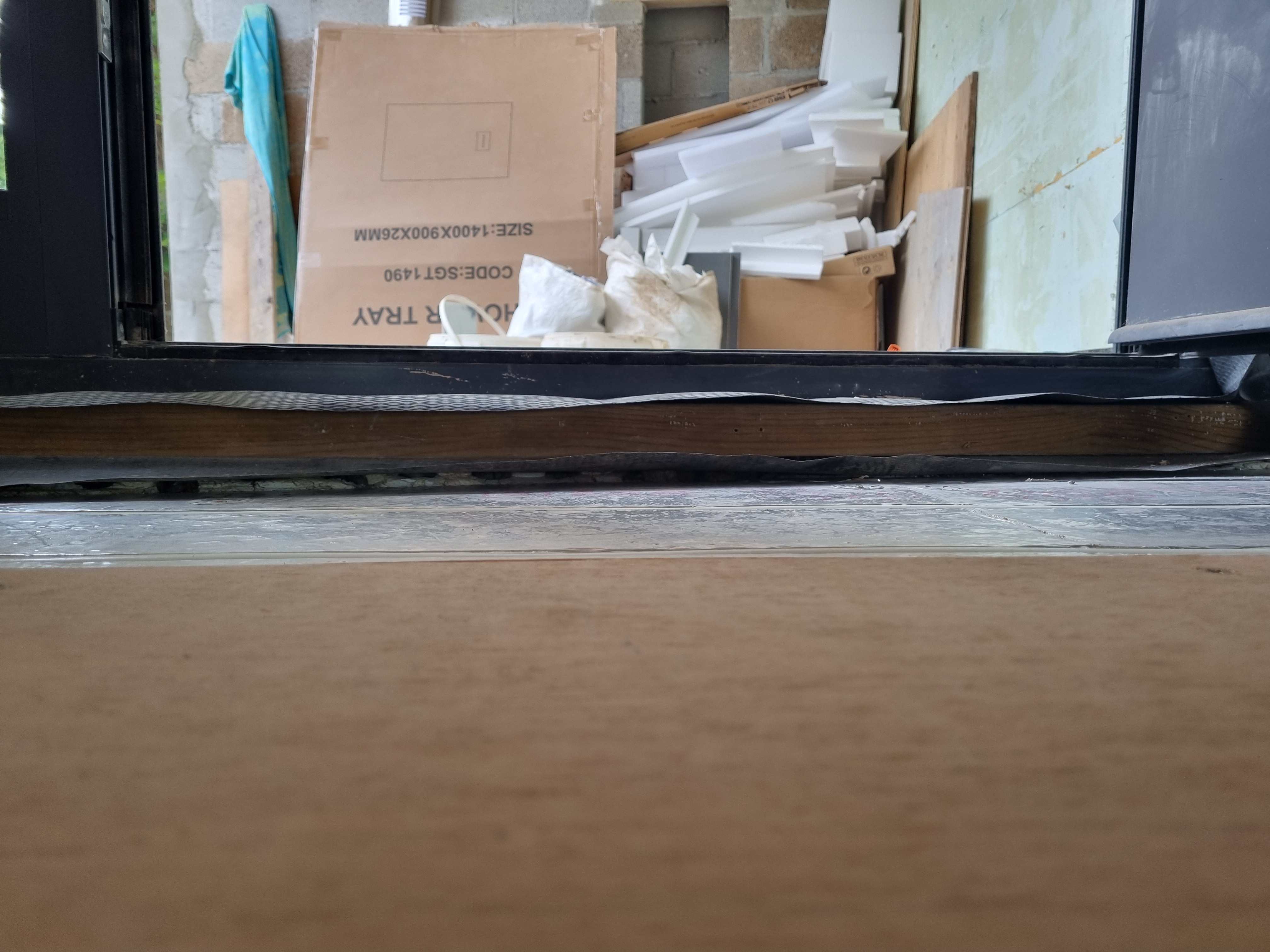

BotusBuild Posted July 17, 2025 Posted July 17, 2025 (edited) Currently the internal area of the front door involves a 49mm step down (not including the 20mm or so of the door frame). I've read relevant BR and still not clear if this is OK. So Q1, is it OK? If not then I propose a step inside the door that goes an appropriate distance from the door as a "landing" area. Something like this Q2. Would something like that satisfy BR (if it is required)? Edited July 17, 2025 by BotusBuild Added tags
Mr Punter Posted July 17, 2025 Posted July 17, 2025 You can have some transition pieces or a shallow ramp. What is the floor finish? Are you having a mat well?

BotusBuild Posted July 17, 2025 Author Posted July 17, 2025 20 minutes ago, Mr Punter said: What is the floor finish? Are you having a mat well? Click LVT, although if we need a landing step, we could incorporate a mat well, or do it with a slate top that matches the porch area outside

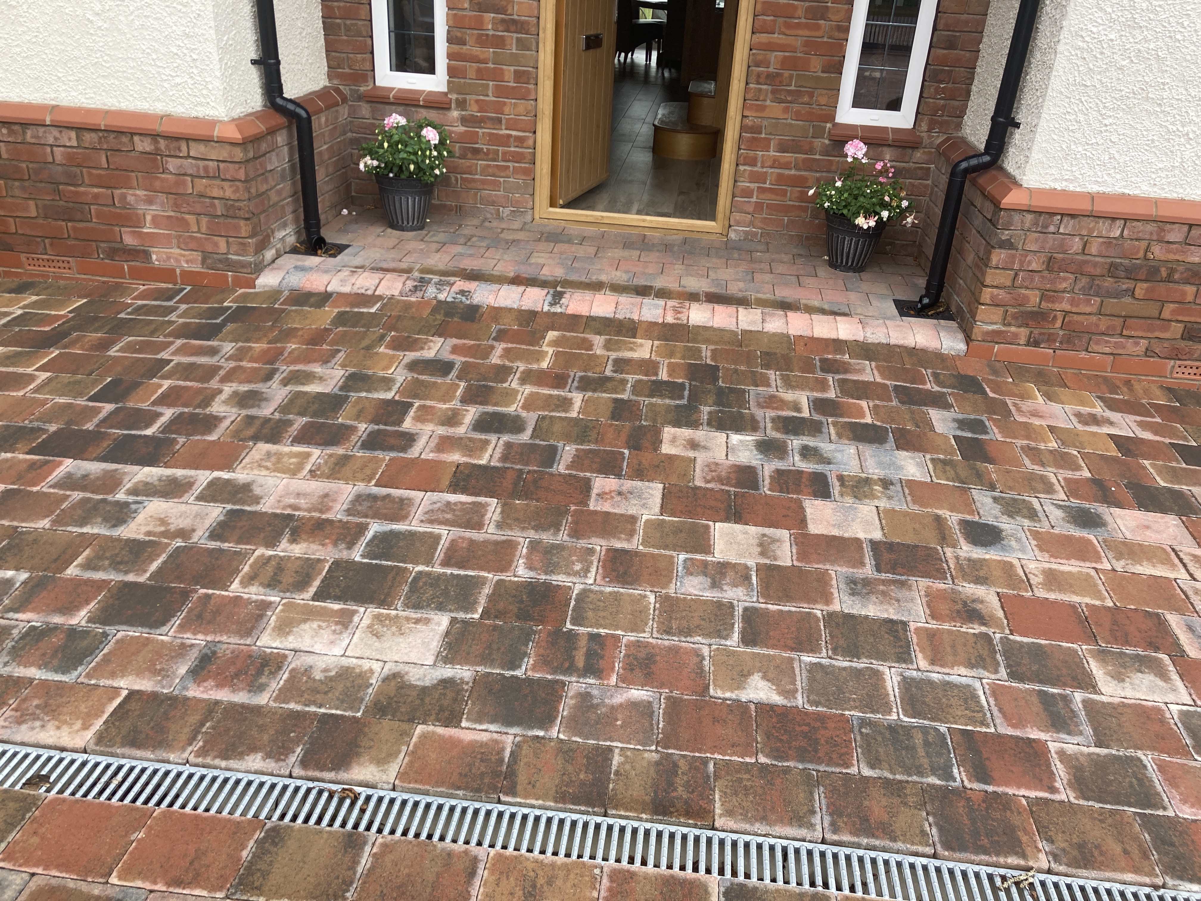

nod Posted July 17, 2025 Posted July 17, 2025 You can add something temporary in order to get signed off and a Matt on the inside As we did on our previous build We’ve around 40 mil of threshold on our DA door BC was fine and more concerned about the lead up to it being ramped With a flat level pice in front of the door 1
BotusBuild Posted July 17, 2025 Author Posted July 17, 2025 Thanks @nod The outside of the door will be fine. I have a plan for that. The bit I'm concerned about is on the inside of the door, which is what the pictures are of.

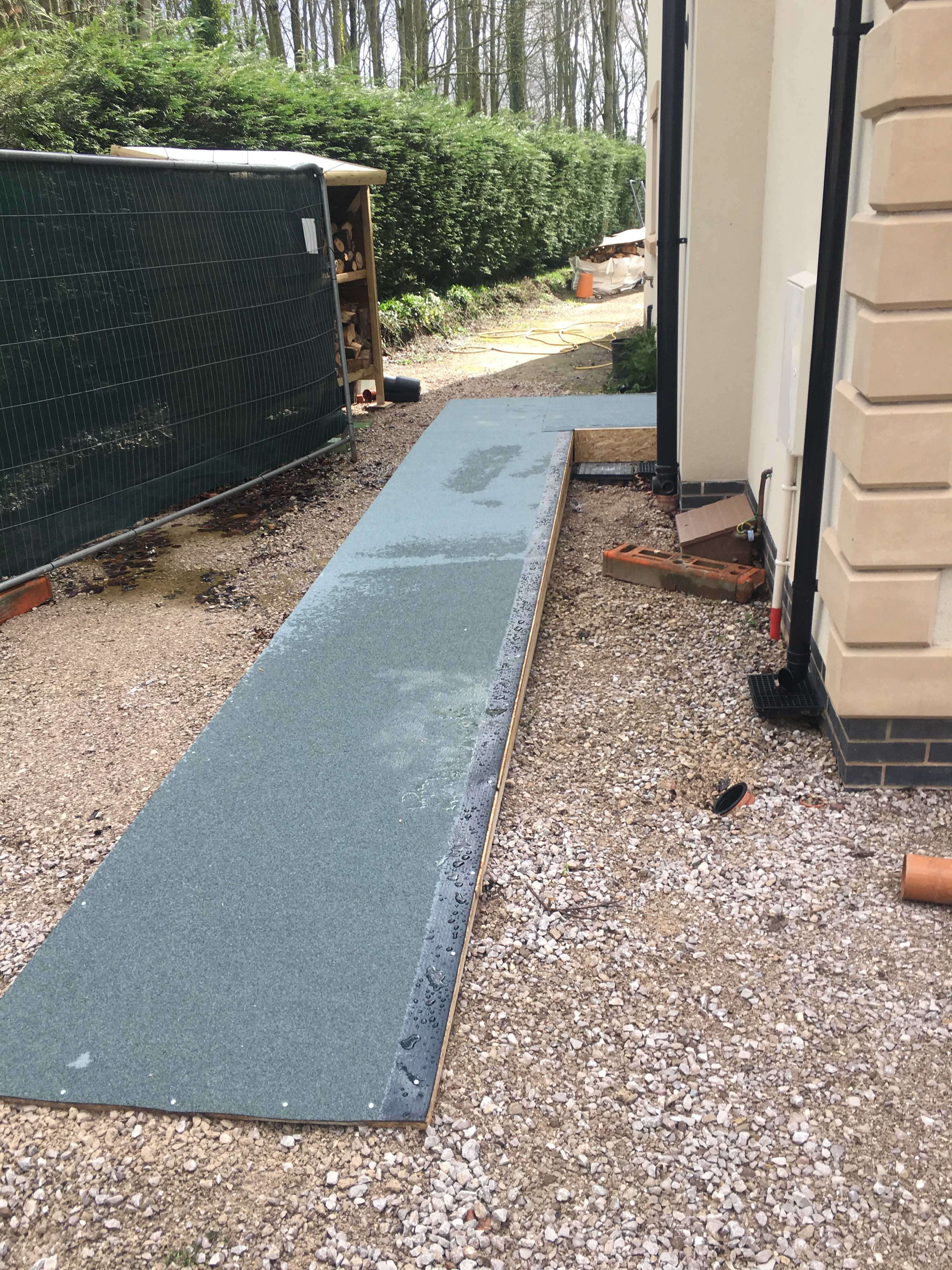

nod Posted July 17, 2025 Posted July 17, 2025 46 minutes ago, BotusBuild said: Thanks @nod The outside of the door will be fine. I have a plan for that. The bit I'm concerned about is on the inside of the door, which is what the pictures are of. we are about the same as you on the inside We’ve a friend that’s in a wheelchair She can easily navigate over the threshold The ramp on our previous build was made out of four sheets of ply with mineral felt on the top They just need to know that a wheelchair can safely get in and out
BotusBuild Posted July 17, 2025 Author Posted July 17, 2025 Thanks. Looks like I'm going for a ramp on the inside of the door, and I now have a cunning plan to make it part of a piece of furniture that will be in the hallway, so we can have it in place as and when needed e.g. when the BCO comes to visit 🙂. I'll try and remember to post piccies when its done (don't hold any breathes) This becomes our second disable access 😉 Thanks everyone
