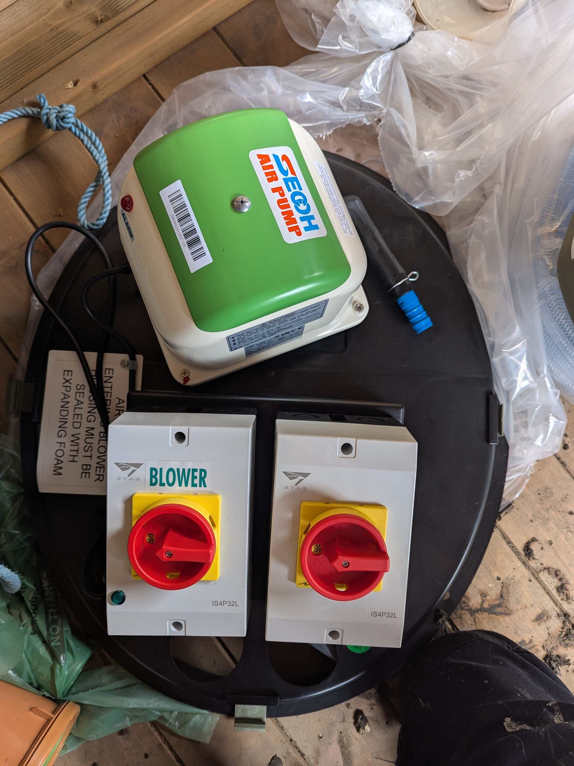

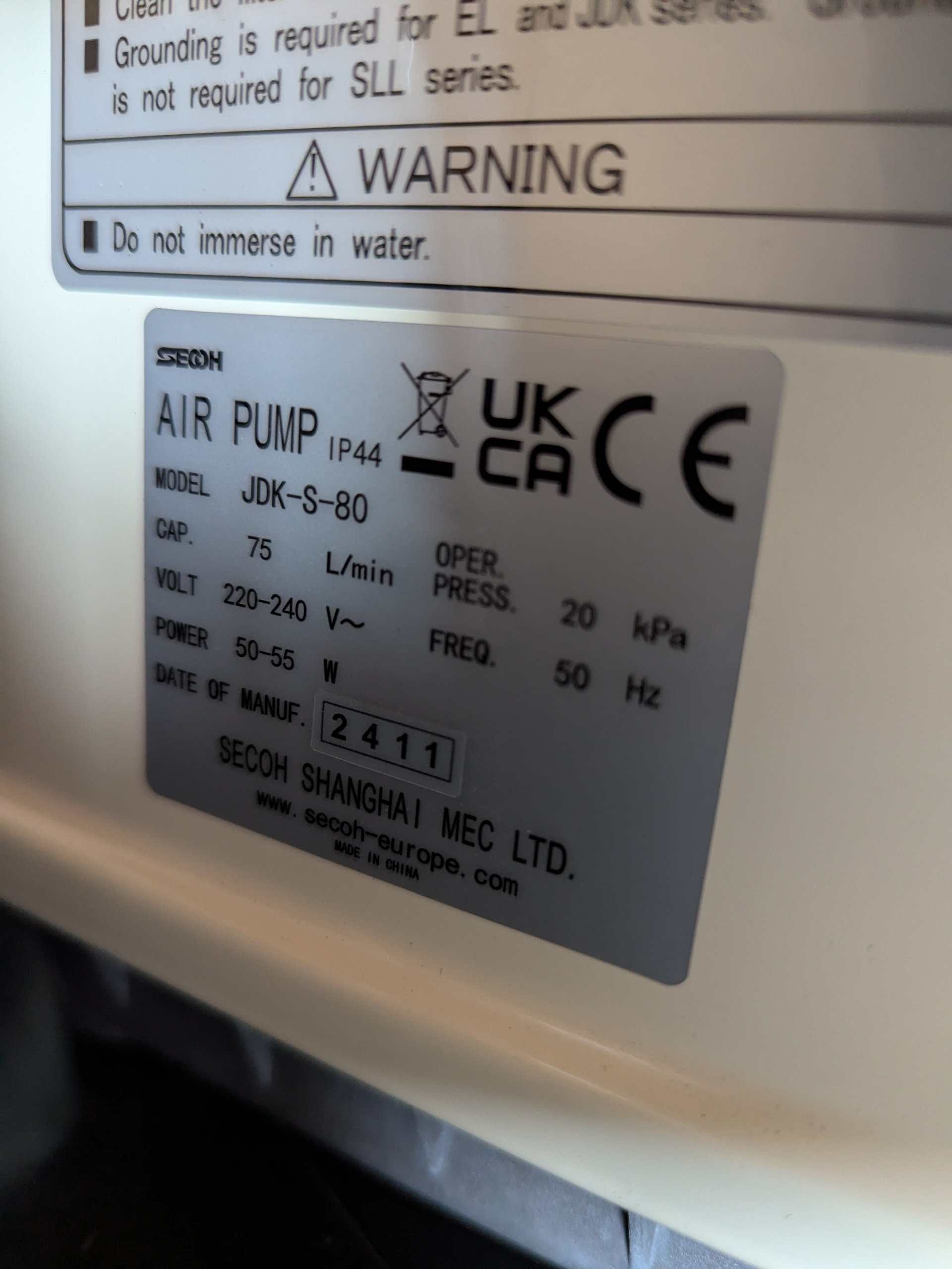

Lincolnshire Ian Posted yesterday at 18:46 Posted yesterday at 18:46 Hi everyone We are just starting groundworks and this will include laying drains to the private drainage plant. In the same trench, above the waste water, I want to bury an armoured electrical cable to power the aerator and the pump. As we are at the start of our project we haven't engaged a sparky yet. Can anyone suggest what type of cable I should get? I have taken some pictures of the set up. Thanks
cjsparkey Posted yesterday at 20:08 Posted yesterday at 20:08 Could you install a duct with draw rope then pull the cable in at a later date once you have your sparky sorted.
ProDave Posted yesterday at 20:57 Posted yesterday at 20:57 the aerator is tiny power 75W. What is the "pump"? What is that doing? Pumped discharge to soakaway at a higher level or what? That is likely to me a much higher power rating. How far from consumer unit to treatment plant? What do instructions say? Can both pumps share a single supply or do instructions say they must have separate supplies?
