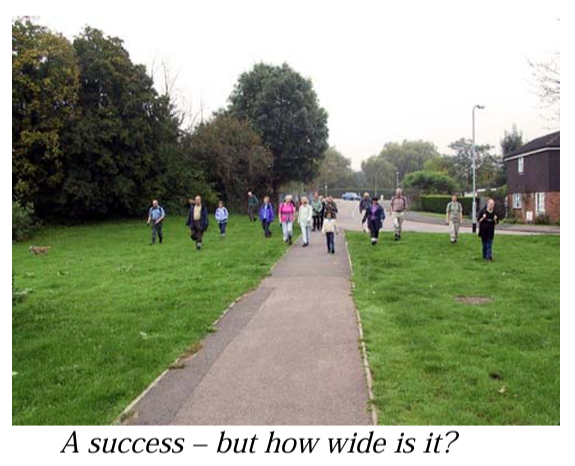

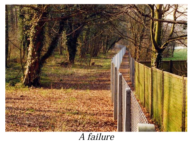

Ferdinand Posted July 6 Posted July 6 A question which may get nerdy so I have put it here. It is common for a garden adjoining a road (ie a public highway) to have a minimum public fence height of 1m, unless planning permission exists for a higher fence - or eg a hedge is used. What is the position with respect to a Public Footpath, a Bridleway etc, which are also public highways in law? And what is the position in civil law wrt fence heights next to RoWs such as public footpaths? (There are wrinkles around the edge of this, such as new paths created on estates or otherwise by Councils not being initially dedicated as RoWs, and so being permissive paths of various types, but I'm interested in anything that anyone knows or thinks.) The piccie below is an example of a "squeeze" between housing and countryside. The underlying issue here imo is the rural landowner being an antisocial twunt - the width of these are not often specified, and he has taken for himself everything he thinks he can get away with, turning the experience of the public into a miserable one. This is the "success" to which it is compared. This is the source doc from the Open Spaces Society, the people who deal with Village Greens and Common Land, and PRoWs, which started my train of thought: https://www.oss.org.uk/wp-content/uploads/2019/04/Getting-decent-widths-in-path-diversion-orders.pdf Thanks Ferdinand

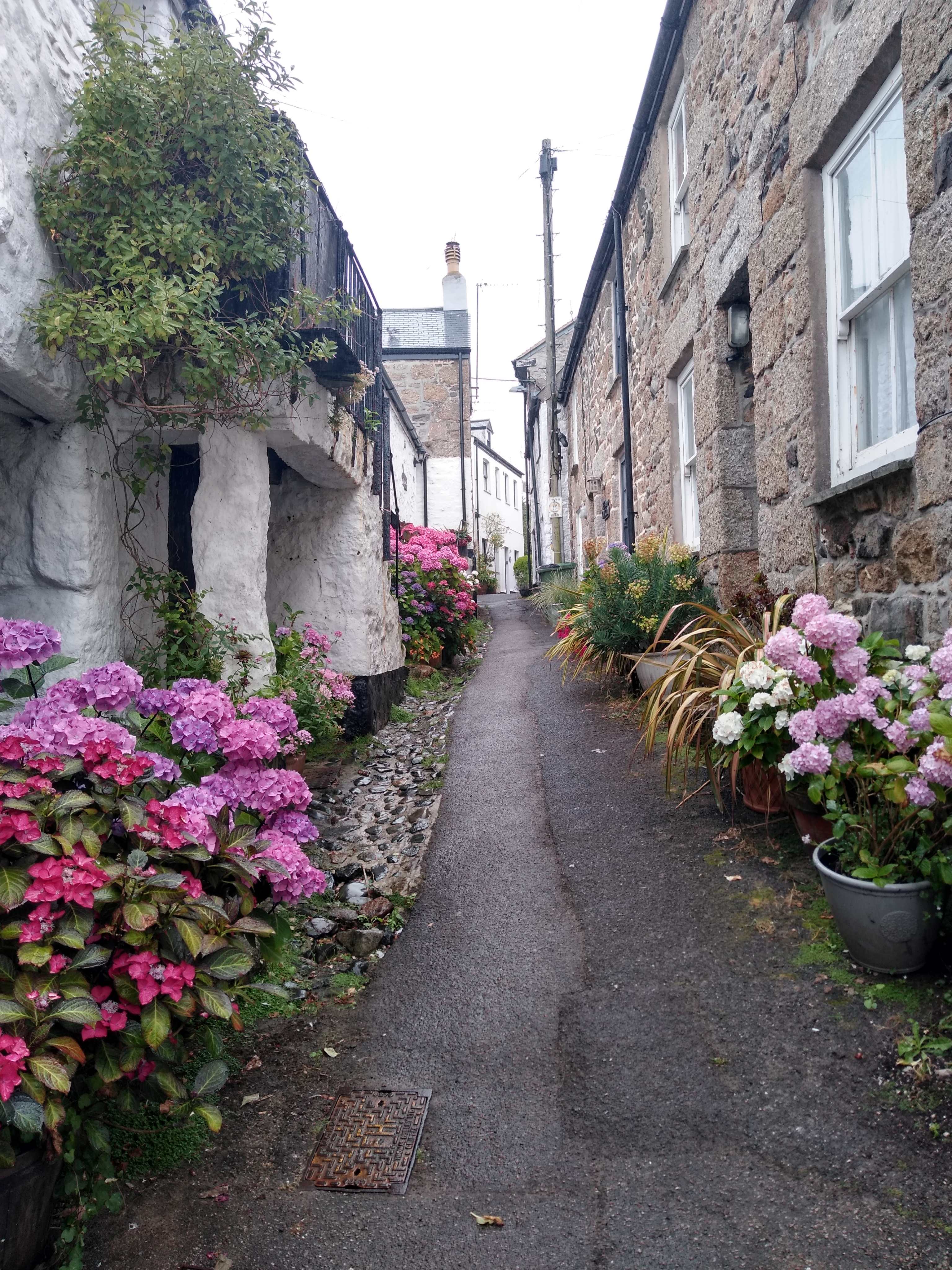

SteamyTea Posted July 6 Posted July 6 (edited) I am sure you have seen this, about the width. https://www.gov.uk/guidance/public-rights-of-way-landowner-responsibilities No idea about height on the boundary, some buildings are the boundary, and after quite tall. Took this yesterday. Not much more than a metre wide in places. Edited July 6 by SteamyTea
ProDave Posted July 6 Posted July 6 If you are a regular hill or mountain walker you will know there is no such thing as a minimum width for a public footpath. What is your "failure" footpath used for? I doubt it if for the home owners to get access to their back gardens. More likely for walkers to gain access to / from somewhere in the countryside. The only "complaint" you might have is if the actual right of way shown on the definitive map is further to the left in that picture, then he won't have just made it narrower, he will have diverted it to a different location. That they could take action against. 1

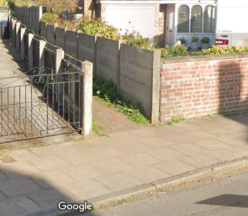

Ferdinand Posted July 8 Author Posted July 8 On 06/07/2025 at 15:58, SteamyTea said: I am sure you have seen this, about the width. https://www.gov.uk/guidance/public-rights-of-way-landowner-responsibilities No idea about height on the boundary, some buildings are the boundary, and after quite tall. Took this yesterday. Not much more than a metre wide in places. That's partly a difference between rural and urban. I think that those flowerpots are probably obstructions that could be required to be removed if it is a Public Footpath, unless the "stoned" area is in the boundary marked on the deeds, and there are no supervening rights held by a public body (eg Local Highways Authority). This is one near me that is around 90cm between 2 houses. It is a Public Footpath I think it has been like that since the early 1970s when I lived in the area and the house on one side is 1930s. It has a horrible anti-wheelchair barrier on it at the other end, but that one is not a priority as the path is essentially unusable for mobility aids. https://maps.app.goo.gl/qJZQShbbtemaLh2Q7

SteamyTea Posted July 8 Posted July 8 5 hours ago, Ferdinand said: That's partly a difference between rural and urban. With Cornwall being different again. It is Mousehole, so as long as a small child can roll a barrel of pilchards down it, then there is room for a campervan.
Ferdinand Posted July 8 Author Posted July 8 1 hour ago, SteamyTea said: With Cornwall being different again. It is Mousehole, so as long as a small child can roll a barrel of pilchards down it, then there is room for a campervan. Wot no barrels of burning tar ?
SteamyTea Posted July 8 Posted July 8 40 minutes ago, Ferdinand said: Wot no barrels of burning tar ? Think that is a heathen thing. We feed our children, Tom Bawcock fed the whole village. Should have got Tesco to deliver, it is only 3 miles away.
