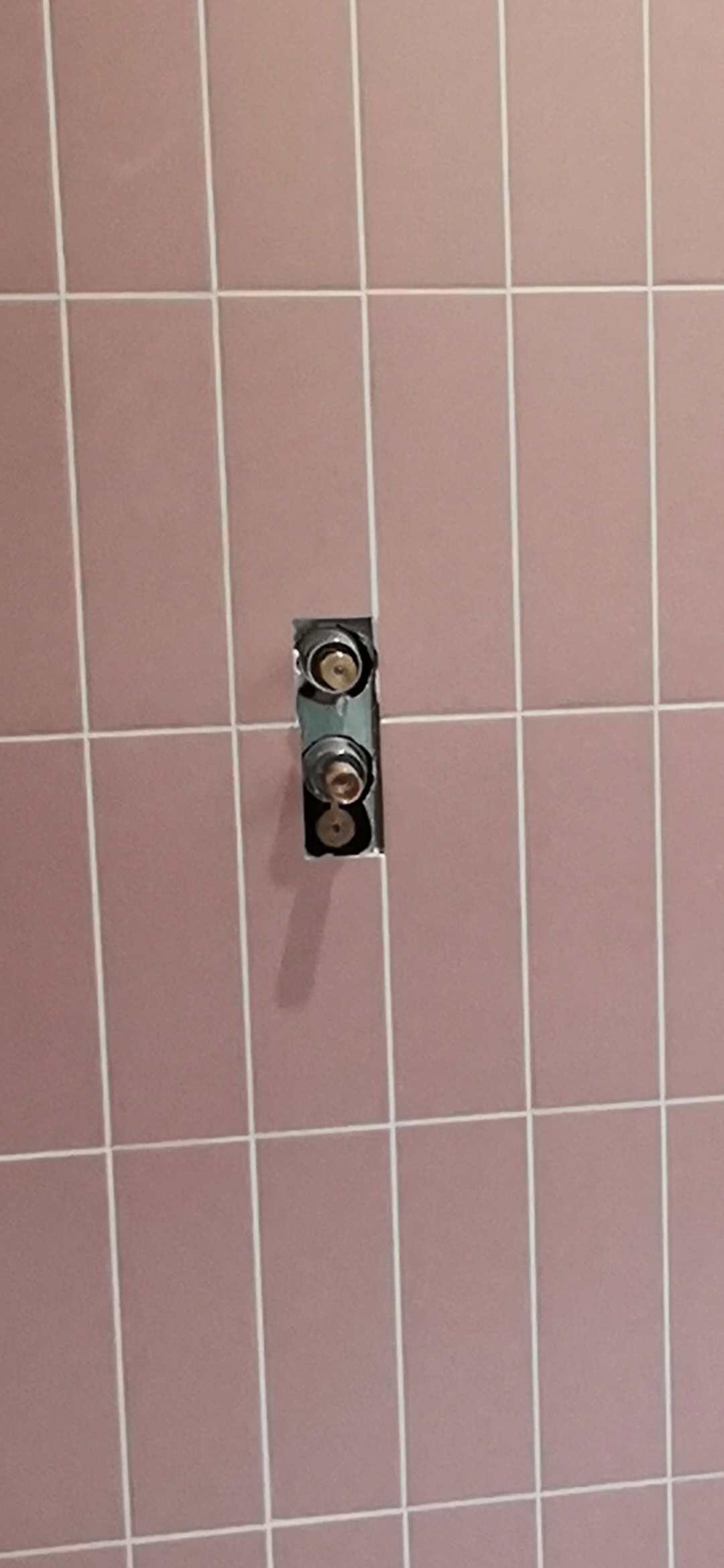

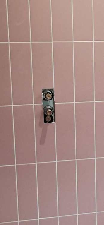

Nickfromwales Posted July 4, 2025 Posted July 4, 2025 1 hour ago, Barryscotland said: If I remember there is an adjustable Allen key in the face of each cartridge behind the dials once there removed, unsure what they did tho. Put pressure back up and isolated each tap in turn but that made no difference so must be a shower. Couldn't hear any flowing noise from behind tiles. One shower does drip awhile after switching off if that could indicate a fault Yes, that type are concealed but should have forward facing plugs which allow access to the NRV's etc, plus you should be able to remove the cartridge too. Get the dials off, slide the cover plate off, and take a pic. I'd bet its the shower, lets put a 4-pack on it
Barryscotland Posted July 4, 2025 Author Posted July 4, 2025 If I remember there is an adjustable Allen key in the face of each cartridge behind the dials once there removed, unsure what they did tho. Put pressure back up and isolated each tap in turn but that made no difference so must be a shower. Couldn't hear any flowing noise from behind tiles. One shower does drip awhile after switching off if that could indicate a fault
Nickfromwales Posted July 4, 2025 Posted July 4, 2025 You may need to remove the plasterboard so you can see the whole valve, and then look again. The Allen head plugs usually give access to the NRV inserts, so you can change them.

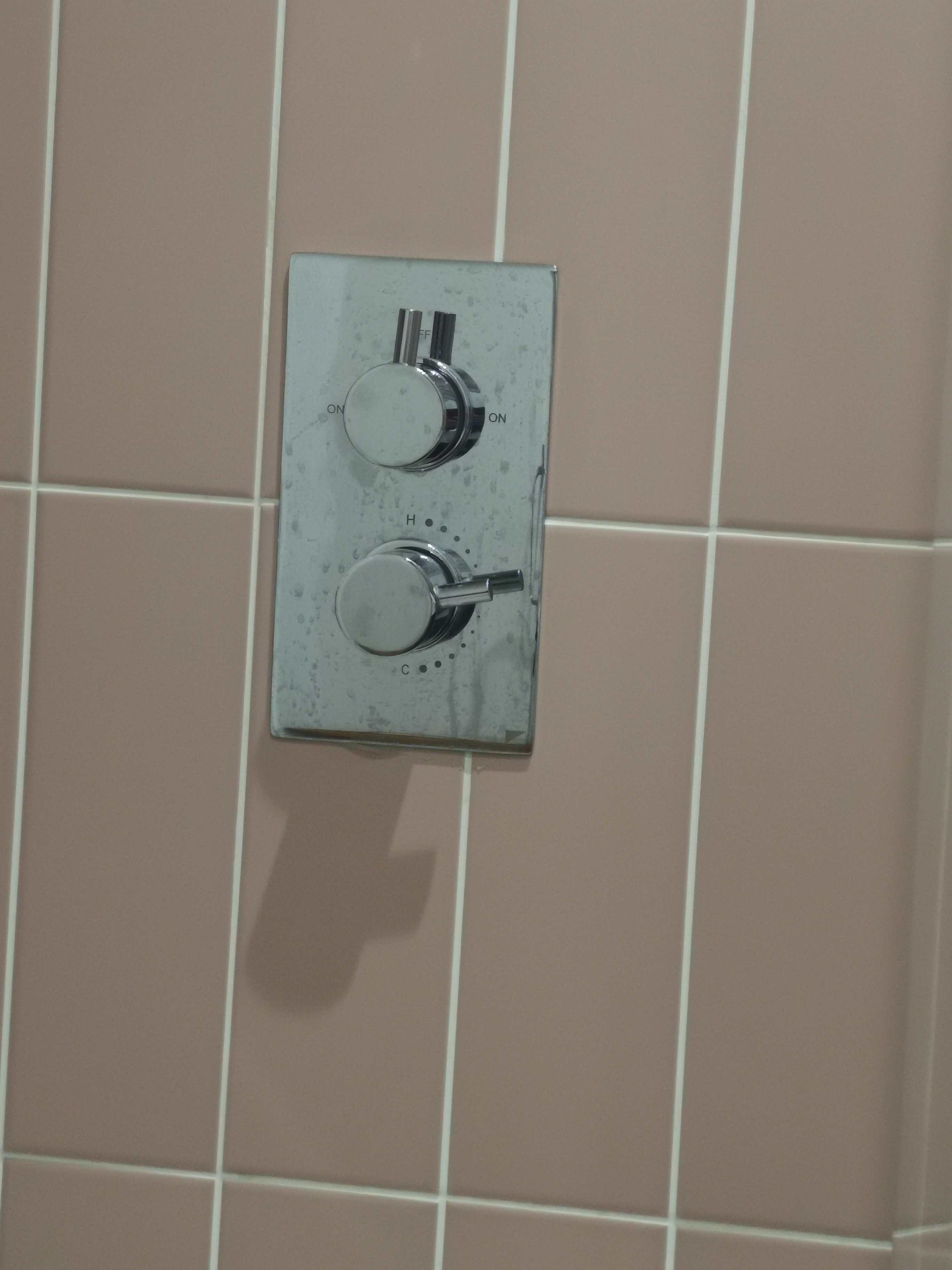

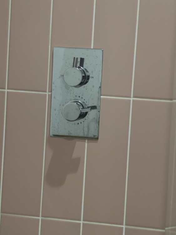

Barryscotland Posted July 9, 2025 Author Posted July 9, 2025 Shower valve is a rhoper Rhodes event sv1406. All I can find is a flow cartridge and thermostatic cartridge. No non return valve or parts diagram
Nickfromwales Posted July 9, 2025 Posted July 9, 2025 53 minutes ago, Barryscotland said: Shower valve is a rhoper Rhodes event sv1406. All I can find is a flow cartridge and thermostatic cartridge. No non return valve or parts diagram Maybe a IR thermometer will help. If you start at ambient and run the water to recreate the issue, if cold (street temp) water mixes through that valve you’ll be able to watch the temp of the brass dripping all the way down. Grab one locally in Screwfix or cheaper on Amazon etc.
