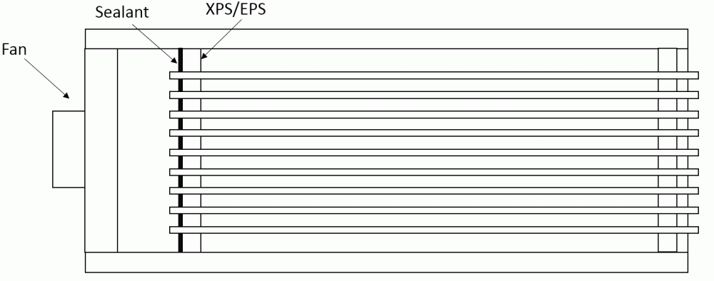

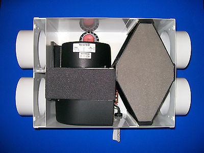

Onoff Posted November 29, 2018 Author Share Posted November 29, 2018 How easy to recreate the heat exchanger in one of these? Doesn't look a lot in them: Link to comment Share on other sites More sharing options...
Ed Davies Posted November 29, 2018 Share Posted November 29, 2018 Just caught up on this thread. A few posts here are a bit concerned with the conductance (thickness and/or conductivity) of the separator material. My conclusion is that typically the resistance is dominated by the boundary layer resistance so the material doesn't matter all that much: https://edavies.me.uk/2014/03/mhrv-area/ , the hard part is making the area large enough in a compact and cheap way. Link to comment Share on other sites More sharing options...
