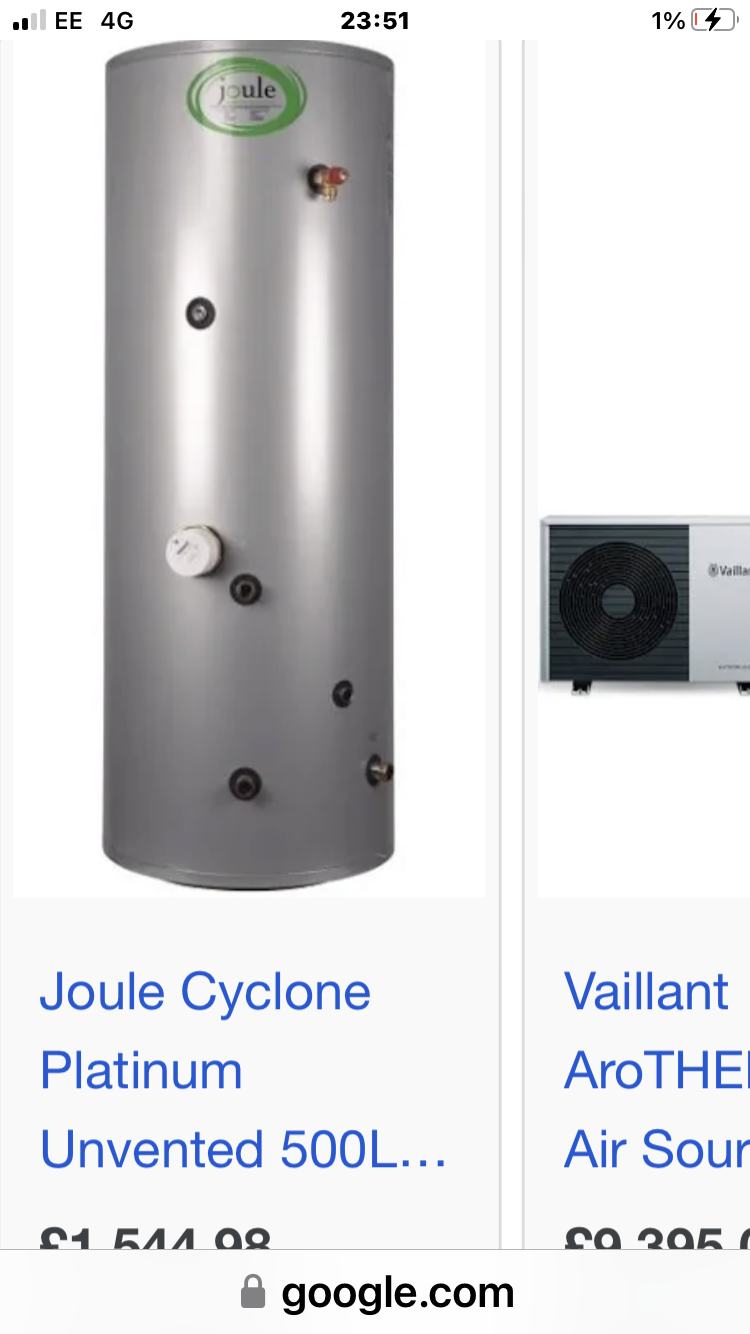

nod Posted July 3 Posted July 3 5 hours ago, nod said: I must be looking in the wrong places 😂The tank they used was about £1200 plus’s buffers 3 pumps etc The numbers just don’t add up I’m over 5k without all the other bits Or any labour

JohnMo Posted July 4 Posted July 4 8 hours ago, nod said: The numbers just don’t add up I’m over 5k without all the other bits Or any labour My cylinder was in a summer sale so several hundred off normal price (currently selling at £1200) Heat pump was on eBay a distributor selling excess stock normal price around £4500, I paid £1300 after some bargaining. I got no warranty, but was willing to take the risk, it was still in the manufacturers box unopened. My labour is free.
