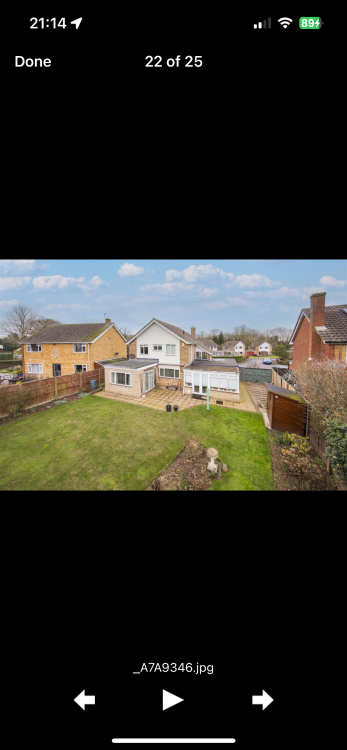

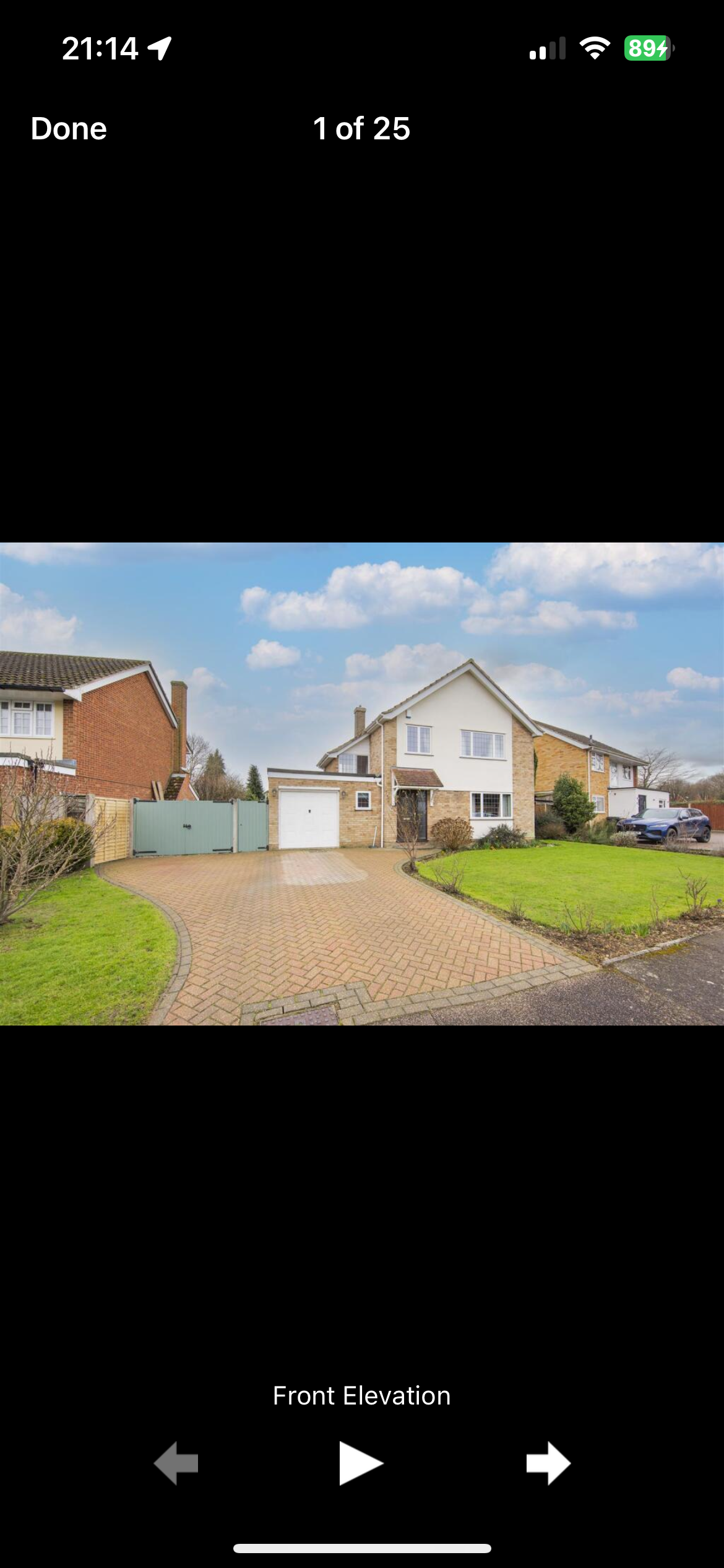

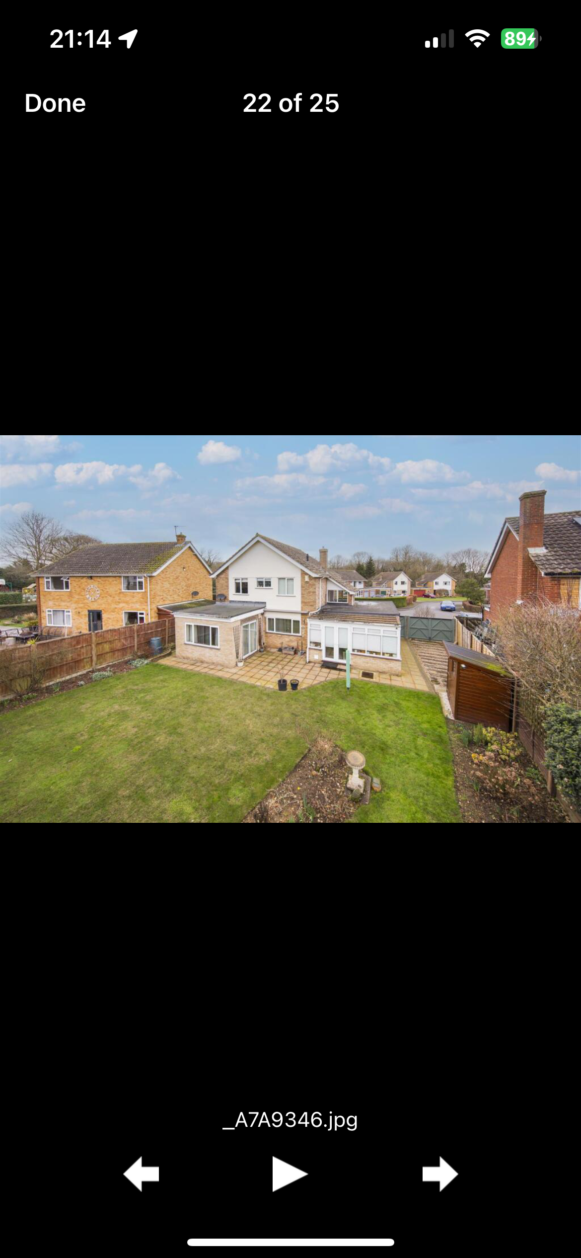

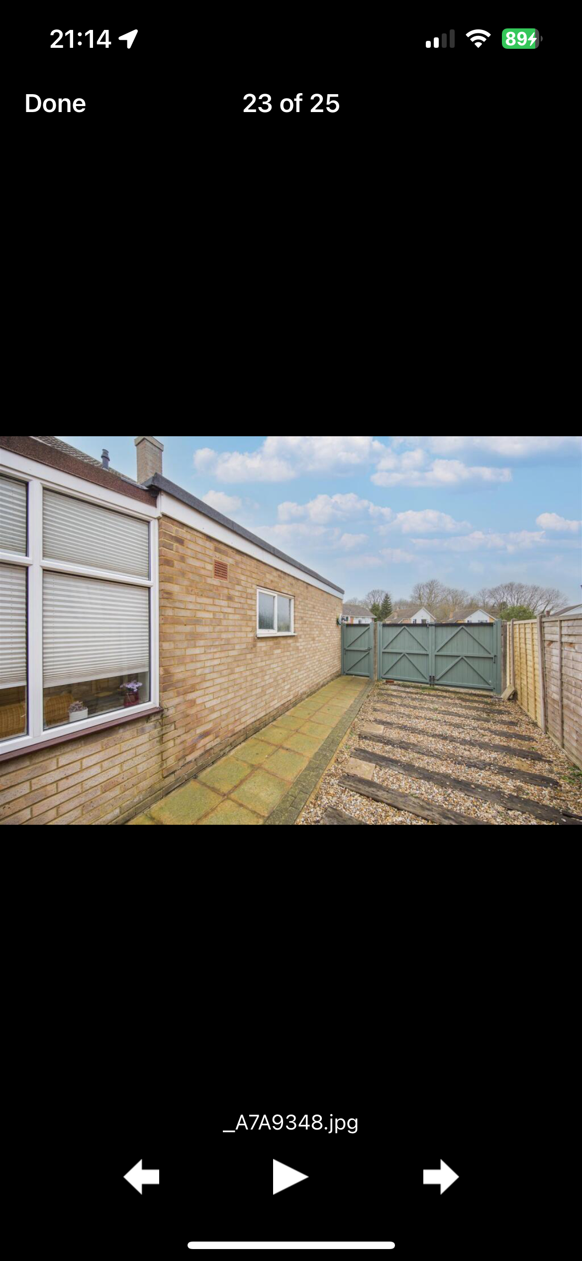

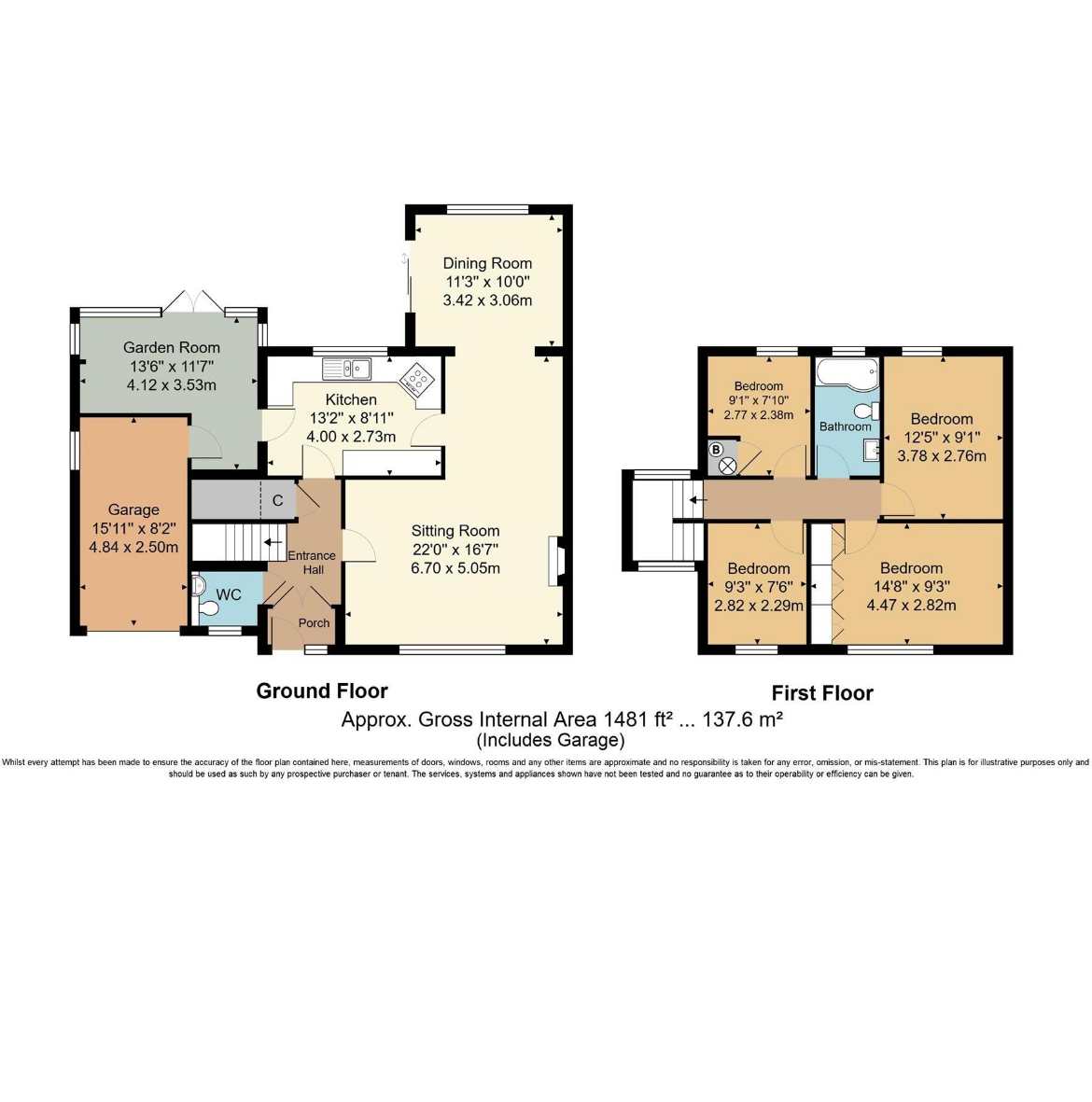

KSS_88 Posted Wednesday at 20:15 Posted Wednesday at 20:15 My husband and I are really interested in a property that looks perfect for extending to the side. We could also do a rear extension but the garden isn’t huge and so utilising all the side seems the best way to maximise space. Could we knock down the current garage and build a new two storey extension then build a new garage where the side gates/caravan parking is. I can see that the staircase goes over the current garage, does this make it either incredibly expensive or impossible to knock down and rebuild around it? Is there anything else we could consider? Any guidance welcome!
JohnMo Posted Wednesday at 20:40 Posted Wednesday at 20:40 Why are you looking to buy the house, obviously it doesn't meet your requirements? As soon as you get in, you want to pull it apart and add more extensions. From the rear view at least two add-ons have been done. So would assume all permitted development rights are exhausted? So what happens if you don't get permission to extend again?

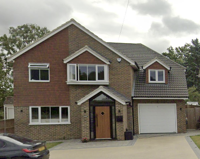

ProDave Posted Thursday at 08:07 Posted Thursday at 08:07 That plot is large for the house so has great potential. However the house is not so easy. The gable end of the house faces the road. Most houses of that type I have seen extended they continue the roof line down, in this case to the left and then put a dormer on the side to create headroom upstairs. Or build a flat roofed extension which in many cases looks awful. I am going to throw in another possibility for that plot. Taking the garage width and the extra parking alongside the garage, subject to actual measurements, that looks to me like you could fit a second house in there next to the original one. Subject to planning permission of course and any covenants or finding something under that gap like a big water main that might stop you doing it.
KSS_88 Posted Thursday at 08:12 Author Posted Thursday at 08:12 2 minutes ago, ProDave said: That plot is large for the house so has great potential. However the house is not so easy. The gable end of the house faces the road. Most houses of that type I have seen extended they continue the roof line down, in this case to the left and then put a dormer on the side to create headroom upstairs. Or build a flat roofed extension which in many cases looks awful. I am going to throw in another possibility for that plot. Taking the garage width and the extra parking alongside the garage, subject to actual measurements, that looks to me like you could fit a second house in there next to the original one. Subject to planning permission of course and any covenants or finding something under that gap like a big water main that might stop you doing it. Thank you Dave! Much appreciated. I agree on the type of upper extension. There is another house not far which gave us the inspiration - we would love to replicate something like this.
