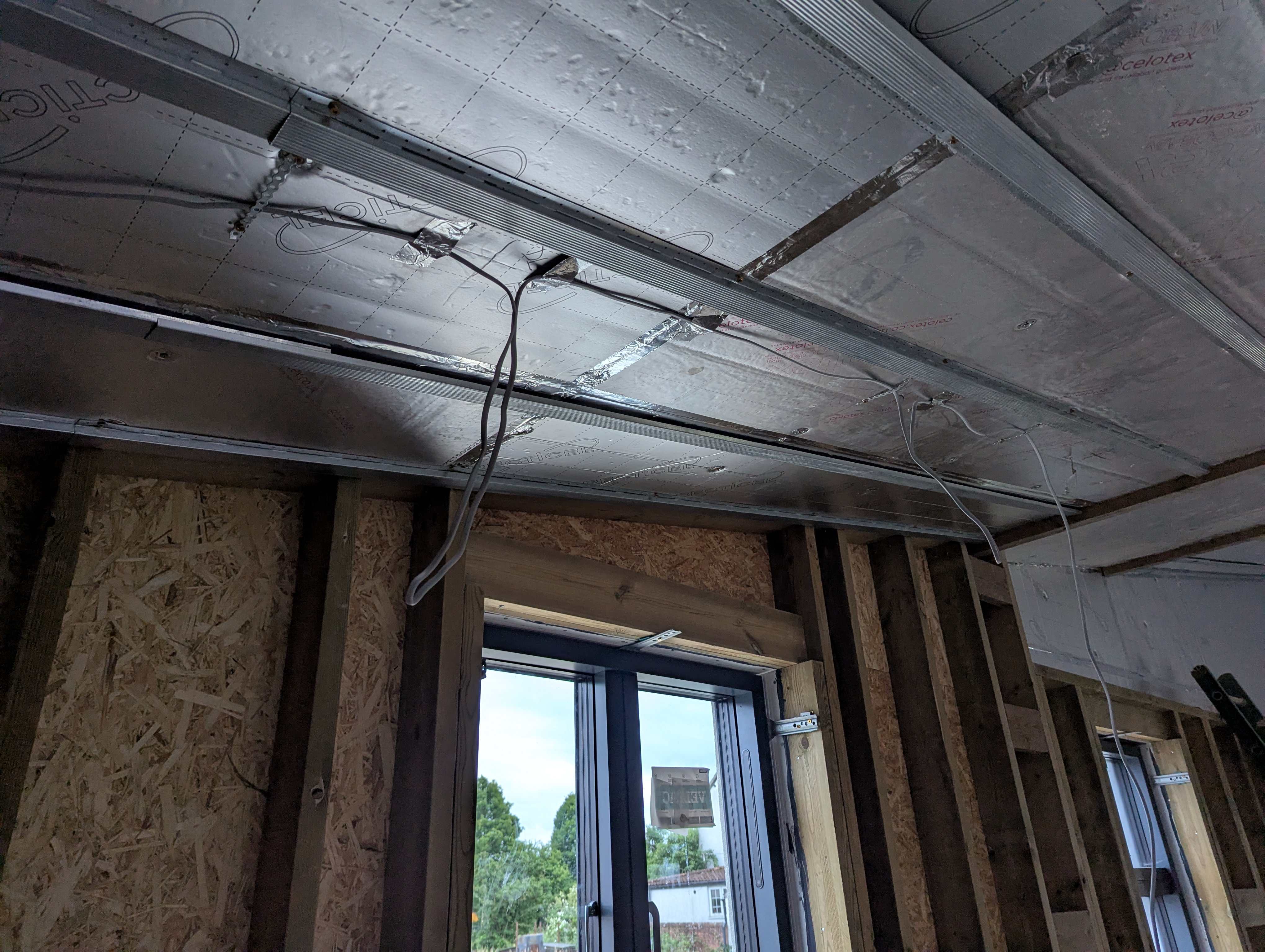

First fix cabling on celotex
I've 50mm celotex below purlins and then resilient bars running perpendicular over top. First fix electrics going in, and boarding this week. Electricians used some aluminium insulation tape to pin cables up (and some straps where were joists).
The insulation tape has let cables dropped, is it literally just to hold them up temporarily until PB is fixed, and then cables at future point drop onto pb as tape fails or should I attach a little better with something. I did half wonder about those insulation clips for ufh pipes. But if only needs to hold extremely temporarily until PB is fixed I'll just pop a bit more tape on.

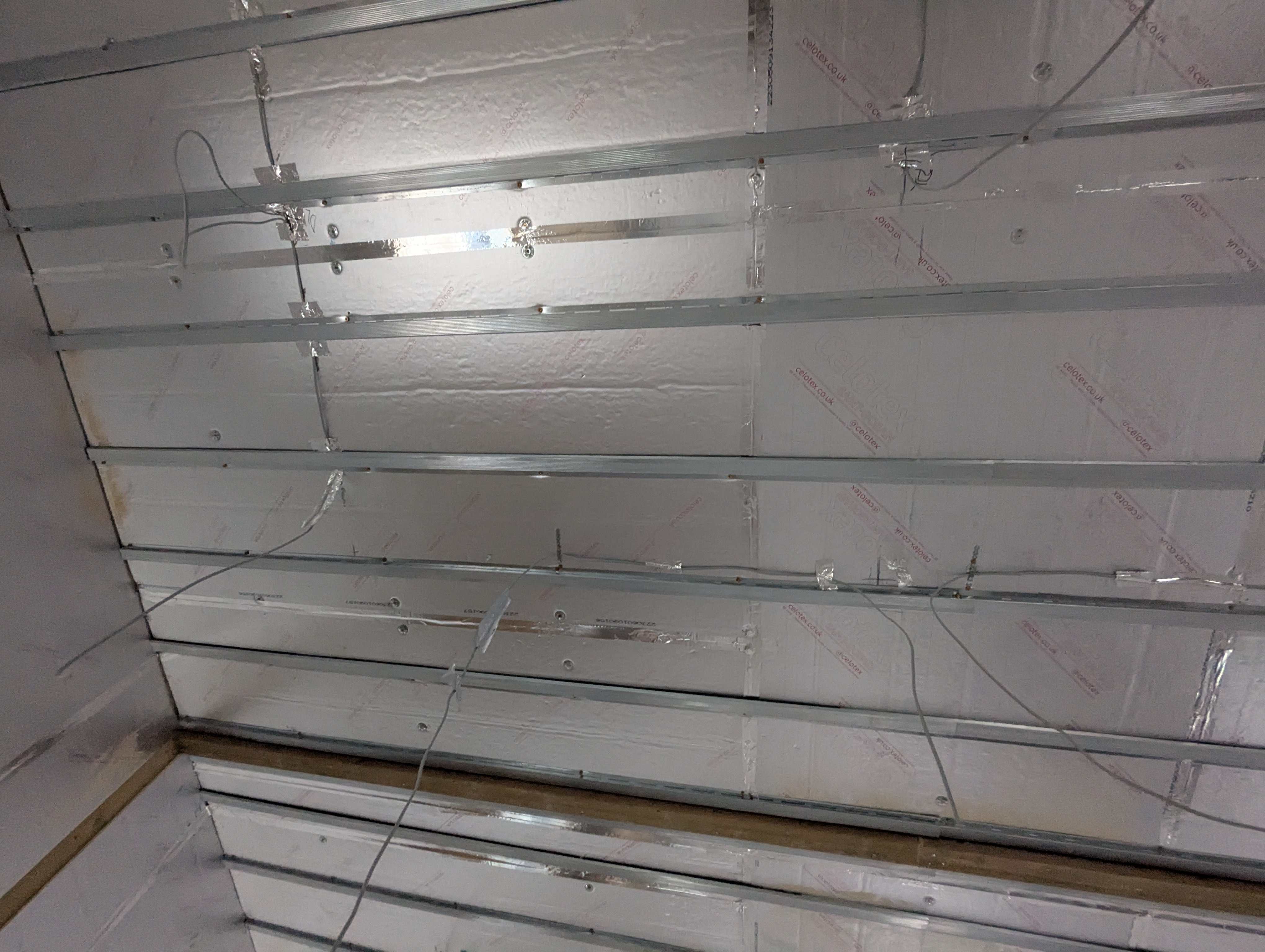

Cables normally go in before the installation This is one I was installing last week
Not great if your foil surface is the VCL?
Normal gaffa tape would have been better vs using flimsy foil tape for fixing them…..
But as above, cables should have been behind and pulled in whilst the insulation was installed.
What lights are going in, as you’ll need recessed pockets in the insulation for spotlights?
Thought cables aren't allowed to go with insulation surrounding them? There is another 215mm rockwool insulation between purlins.
Lights are surface mounted spots to avoid having to chase out the celotex.
There is not an additional VCL. I'm sure I'd read @nod say elsewhere he didn't particularly like VCL on ceilings as when he was taking old ones down was moisture? Was some months ago so can't remember detail. The celotex is foil faced both sides and 50mm so I don't see it's that heavily compromised as VCL.
I'll pop some gaffa tape up instead. Thanks for input
There is not an additional VCL. I'm sure I'd read @nod say elsewhere he didn't particularly like VCL on ceilings as when he was taking old ones down was moisture issue with the PB? The celotex is foil faced both sides and 50mm so I don't see it's that heavily compromised as VCL.
