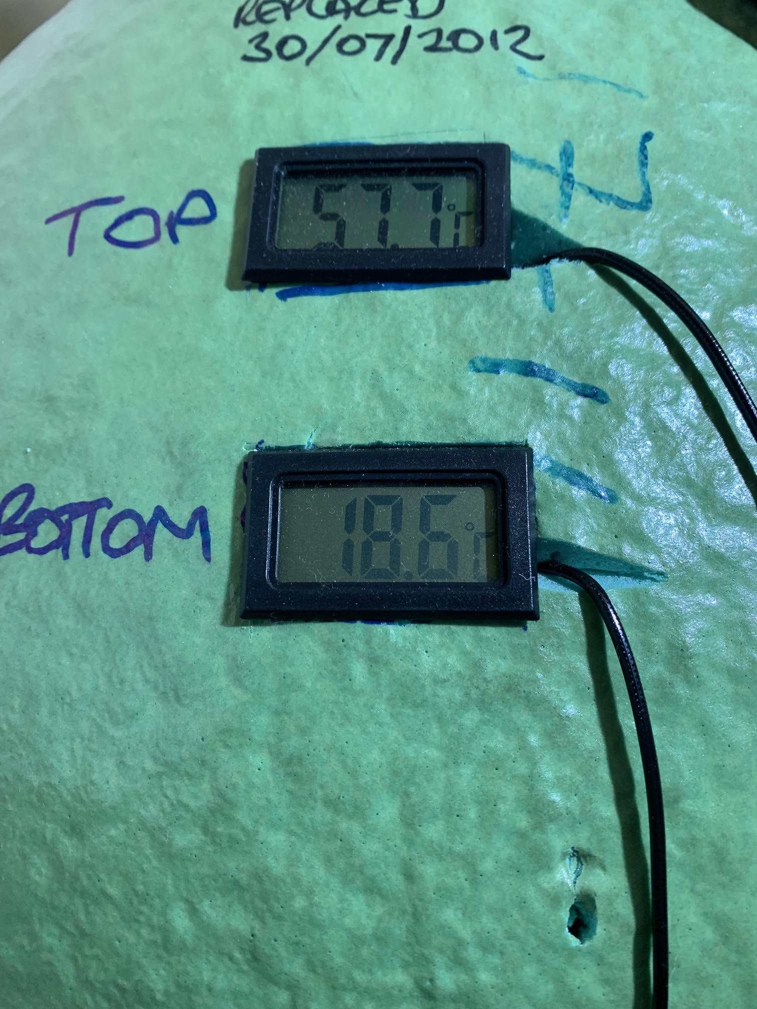

This is what I have on the tank (Library picture from a legionaires cycle to 61 deg C - followed by pouring a bath) the top one is looking at the top of the tank - the bottom one where the boiler tank thermostat is
I'd need to put another temp probe in or move the bottom one up to roughly where the immersion element ends to get a better idea of hysterisis

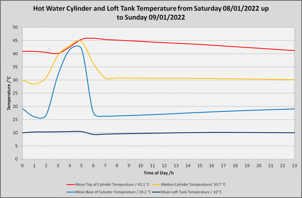

This is what happens with my DHW cylinder.  It is on E7 and only uses the lower element, but you can see that there is quite a pronounced temperature gradient after switch off (5AM).
With a bit of extrapolation/guesswork, you could estimate that there is a 15°C DT below the element.

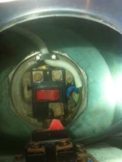

OK I had the system drained down to do so other work (it was planned for summer but well life gets in the way)
Work
1. London loop on the HW outlet of the tank (early days but it already seems to have reduced standing tank losses)
2. Re-pipe the bypass so it's after the CH zone valve (it was before so when I restricted the flow thro the HW tank coil it opened the damn bypass and defeated my efforts to slow down the flow thro the coil!!!)
3. Combined 22mm Feed and vent for CH (removing the old 15mm feed) - Thank You @John Carroll it's solved all the issues with air ingress and got rid of another pipe in the cold loft
4. Generally remove a load of joints (from previous versions being adjusted) and clean up the lagging
5. Convert all the main rads to TBOE with Danfoss RAS-B2 flow control TRV bodies
Anyway  what I needed to say was
Immersion stat is set to 55 Deg C (well mid way between 50 and 60)
After heating it overshot by a large margin - Tank temp at the top was 60 deg C when it cut out
1 shower later and tank temp at the top was down to 50 and the immersion cut in again
Turned it up to 60 because bath night and top of the tank was nearly 70 when the immersion cut out
She hadn't finished pouring the bath before the immersion fired up again top of the tank was reading 60
So I'm guessing the temp sensor is lower down the element.

Top immersion heaters are the work of the devil.  If yours has an old style thermostat without the new safety cutout trip then they work apart from eratic water temperature.
But when I was working I had no end of trouble with thermostat failure, and you can now only buy thermostats with the safety cut out, and they were notorious for spurious tripping when top mounted.
I would 100% replace the cylinder with a new one with side entry immersion heater.
No idea - certainly it seems like it's got a pretty wide hysteresis judging from the overshoot
The devil is in the detail. They obviously don't make them like they used to. No pesky rod thermostat in mine, still working perfectly after exactly 53 years. Sink/Bath c/o switch conveniently on top of the Immersion.
