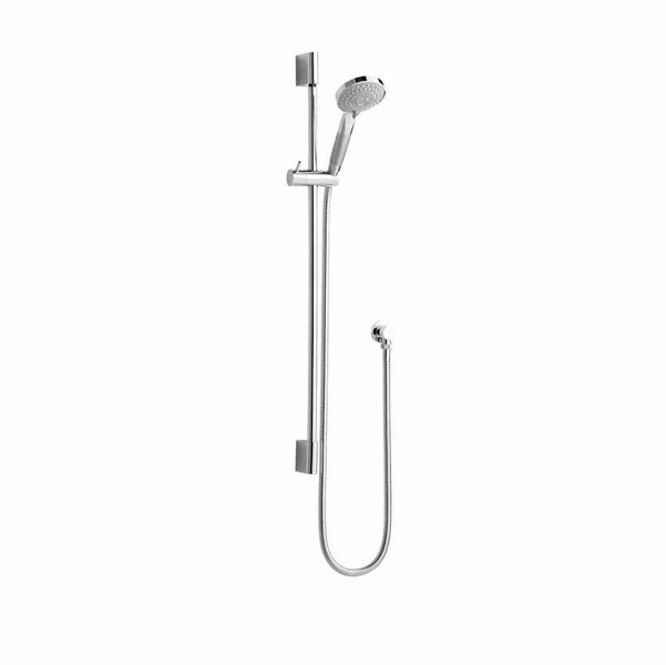

Onoff Posted January 1, 2018 Share Posted January 1, 2018 (edited) @nod, hope you don't mind the hijack. Figured I'd add to this given the generic thread title. Need a concealed mixer at the budget end of things. So with the aid of the model, "we" have decided the shower is going on this wall. I was going to have nothing on this wall as it's an outside cavity wall. Was going to pack it with PIR but have been overruled. The shower head is misleading as that'll be mounted on the ceiling. SWMBO wants a riser rail with removable hose / handset. Presumably for "lady" things. Me, happy to stand under and get drenched. So I presume I need a 2-way valve? As in handset or overhead? What's a 3-way then? At the mo however it looks like this: I'm after a concealed mixer not so deep that I can get some insulation behind it and run the feed pipes up, again within the insulated layer. The horizontal studs will get drilled as required to support the down pipes. More timber can go in if needs be. Space wise, between those two studs is 165mm and face of stud to the rough old white wall is only 125mm. Add 12.5mm of Aquapanel and tiles and I've maybe 150mm from face of tiles to wall. Only ever fitted bar mixers. Am I on the right track? Edited January 1, 2018 by Onoff Link to comment Share on other sites More sharing options...

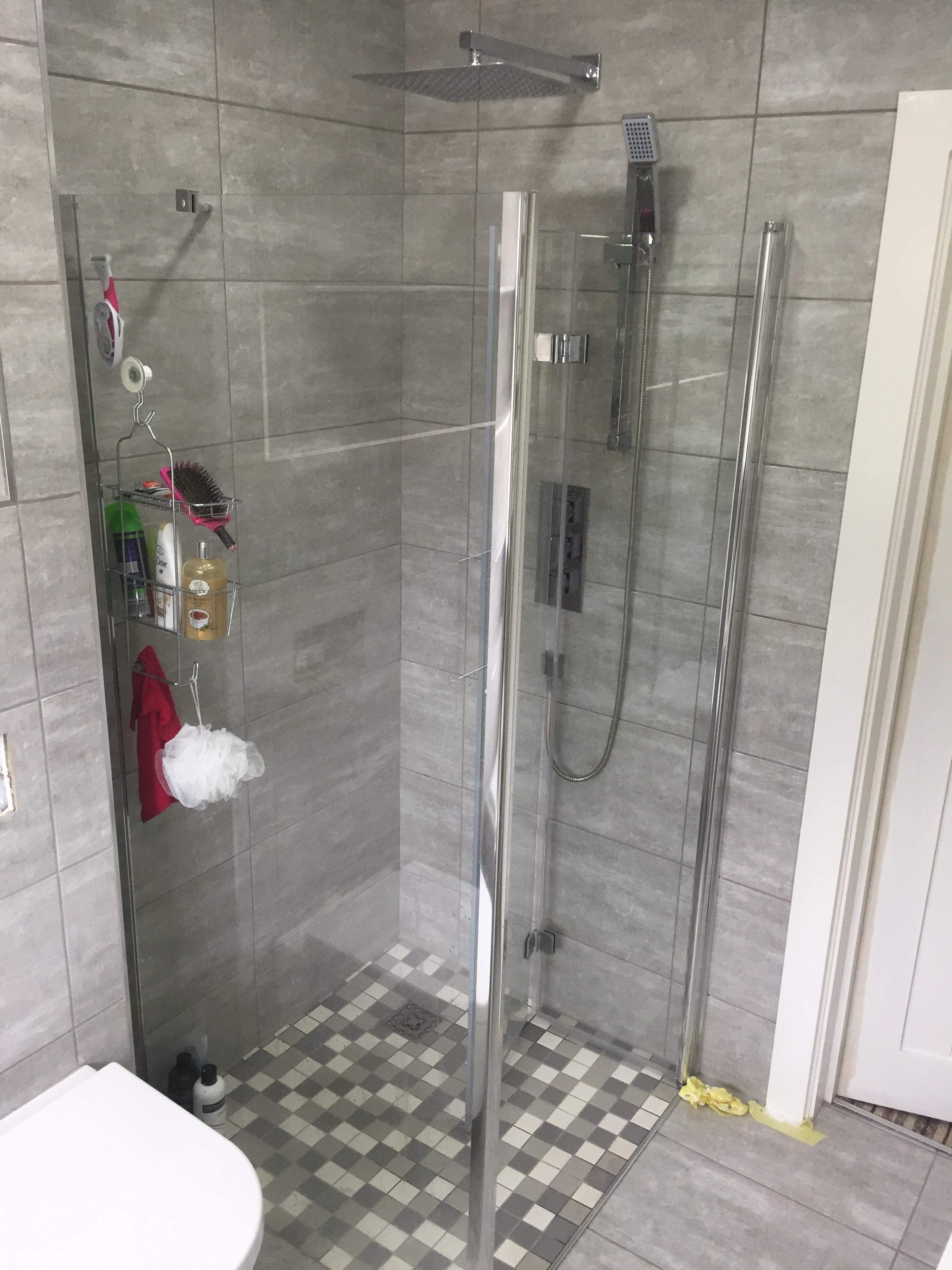

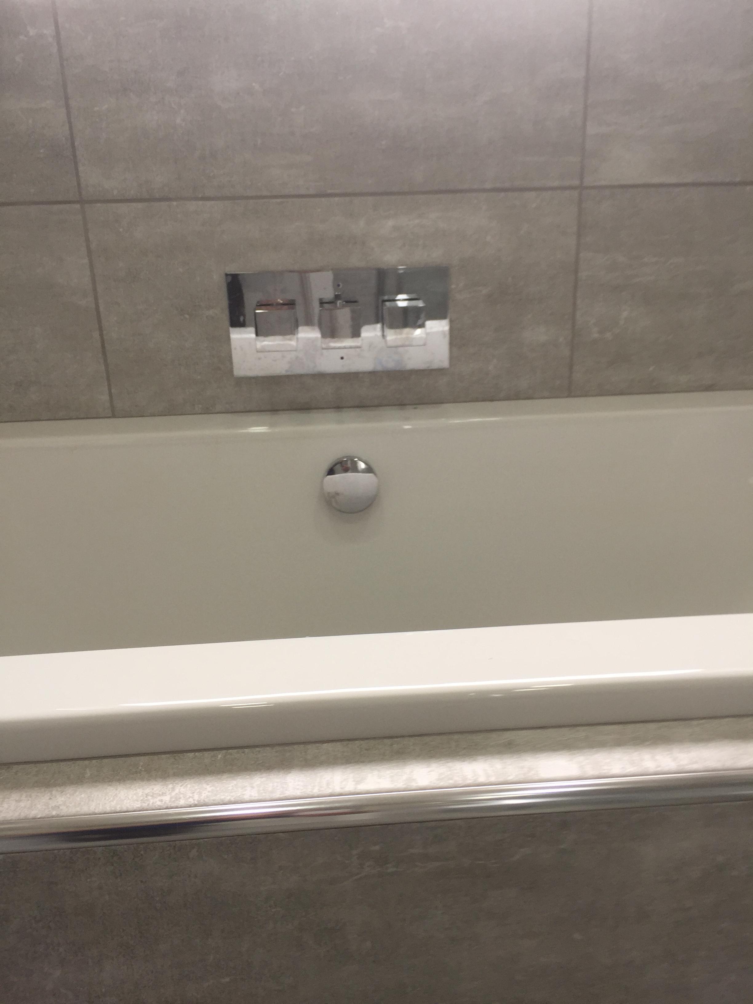

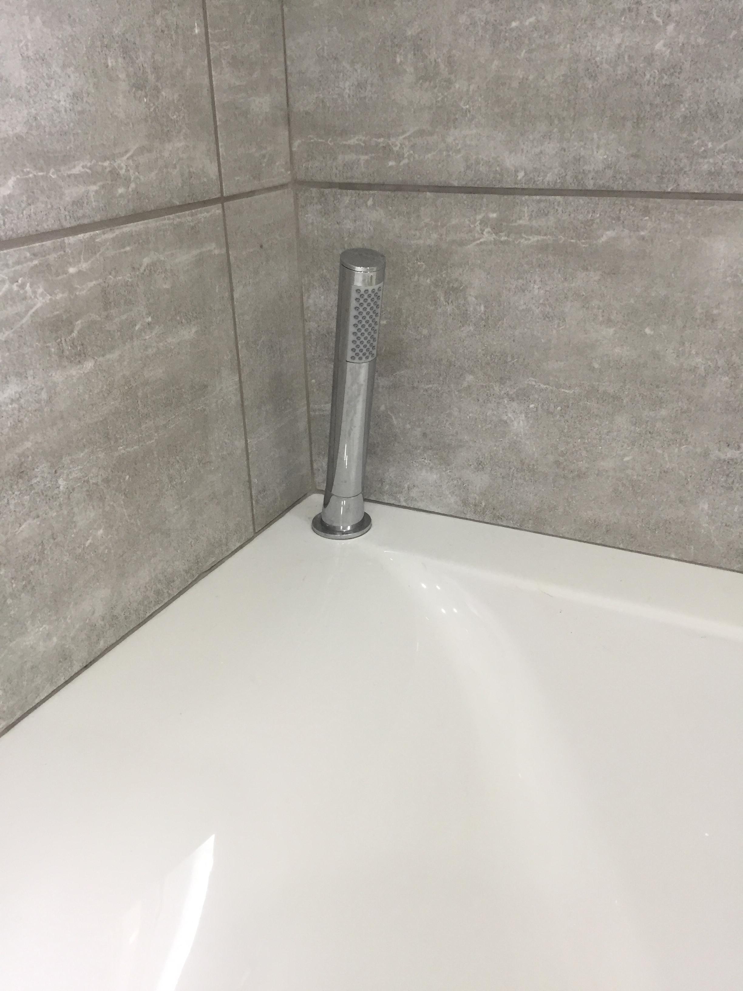

Nickfromwales Posted January 1, 2018 Share Posted January 1, 2018 @Onoff I bought these for the last job. One went vertically mounted in the shower, selecting rose or handset, and one horizontally over the bath selecting overflow filler and pull out handset. Excellent flow rates and cheaper than shoplifting. Tres bien. Flow to the relative outlet at each end and temp dial in the middle. Get the round ones or your OCD will take up the rest of your life getting them realigned after each use 1 Link to comment Share on other sites More sharing options...
