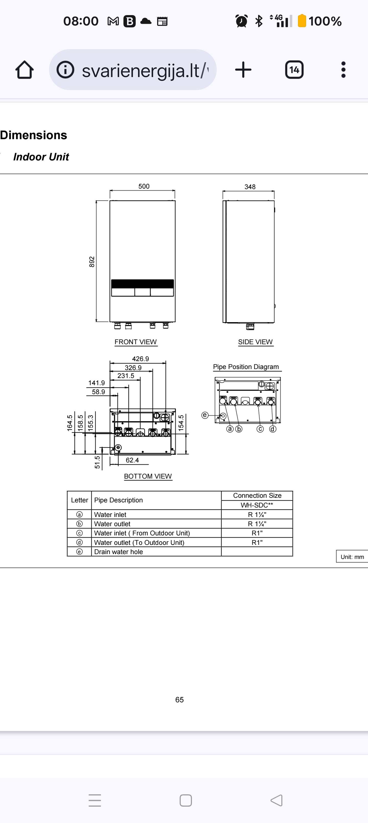

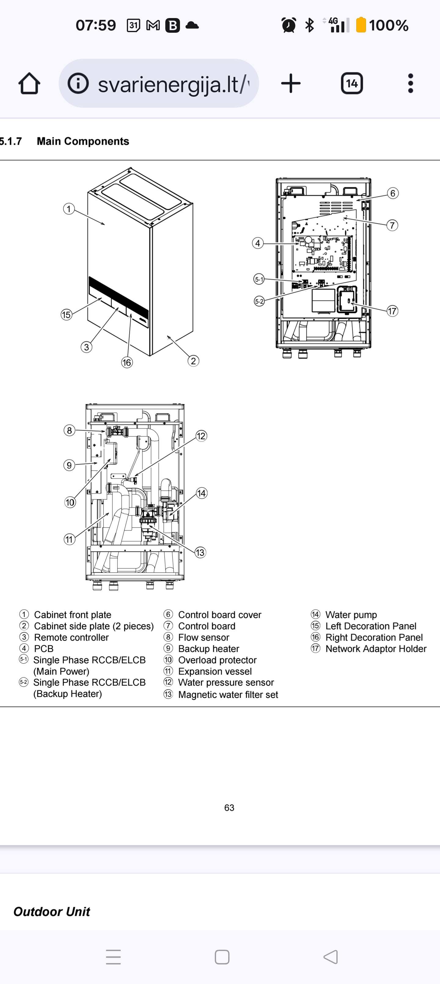

8 hours ago, G and J said:
Bi bloc is a unit that sits inside the house.  It connects via a refrigerant circuit to the compressor which sits outside.  The two units make up the heat pump. (A split unit I think it’s referred to as
Not quite correct. A bi bloc is water split, not refrigerant split. A split unit is refrigerant split.
This is the internal unit. It has water connections to outdoor unit - not refrigerant. It contains water filter, water pump, expansion vessel and the control system for the whole unit.
Screenshot_2025-06-05-08-00-01-19_40deb401b9ffe8e1df2f1cc5ba480b12.thumb.jpg.bac586bed6c0e51b2e6f8666d090ef87.jpgScreenshot_2025-06-05-07-59-51-51_40deb401b9ffe8e1df2f1cc5ba480b12.thumb.jpg.bf5f3d2e7af11b965555ff5f36e1c28e.jpg

Posted (edited)
Are those diagrams the Aquarea L series or just illustrative of similar ASHPs?

Posted
From the installer manual for the Panasonic L series.
