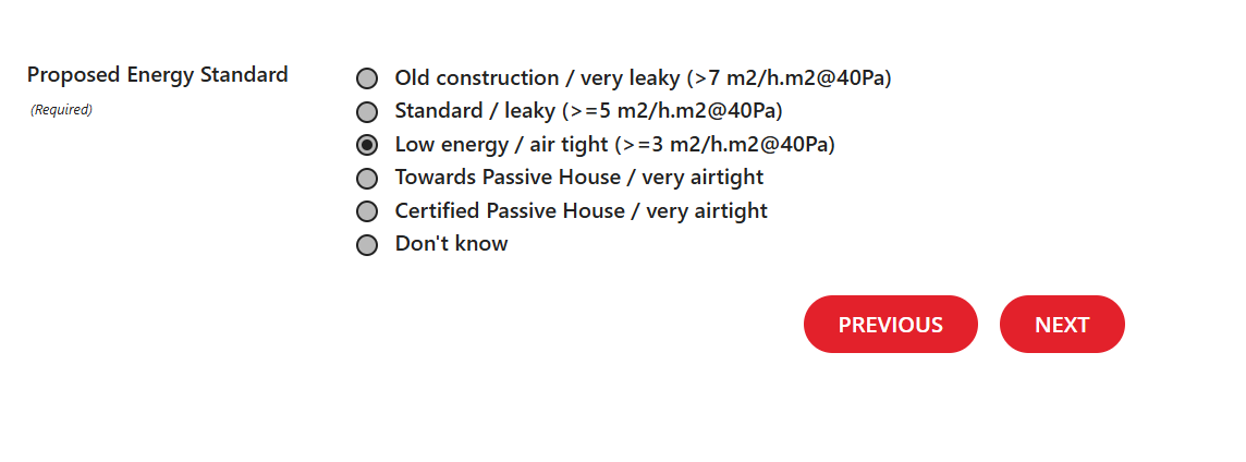

Excuse my ignorance on the subject of 'air tightness', but if I am building a new brick and block house to current regs, how does that differ to a Passivhaus spec design.  If for example, the windows don't have trickle vents, there are no extractors in the kitchen, bathrooms ... (because I am fitting MVHR) and the roof is insulated with Celotex and taped, then how can the house be 'leaky'.  Eg, how is air leaking out / in?
Only asking as I am wanting to get a MVHR design done and the question below was asked.

To meet current building regs you need to achieve < 8m³/m².h @ 50Pa Air Infiltration (leakiness), however to meet PH Spec you need to achieve 0.6 ACH @ 50 Pa. Air Changes per Hour is a different unit for measuring Air Infiltration and there's no set conversion figure that works for all houses to convert between the two, but very roughly 0.6ACH will be in the order of 1m³/m².h. So, a PH spec house roughly leaks 1/8th of the air volume of a house that just meets Building Regs.
The difference in construction, between the two is certainly attention to detail, likely the use of tapes and foams, and maybe the use of air tight barriers. Some construction methods and insulation types are easier to get air tight than others. Celotex in your roof needs mitigating with taping and likely an air-tight barrier and depending on your wall costruction, other mitigation may be required.
Take some time to consider this for your build. MVHR doesn't bring you any benfits in itself, it's the air-tightness it facillitates that brings the benefits. If you are not targetting < 3m³/m².h @ 50Pa air infiltration rate, you have no need for whole house mechanical ventilation and adding MVHR will increase your energy losses, rather than reduce them, while costing you to power and maintain the system.
Achieving <3m³/m².h @ 50Pa will take a conserted effort in both design and construction, it doesn't happen by accident.
If you plan to put the effort in to, say, target 1.5m³/m².h @ 50Pa or better, then you really will benefit from the air-tightness and MVHR with both a more comfortable home as well as lower heating bills, but if air-tightness is not your focus then MVHR is an unrequired expense.
