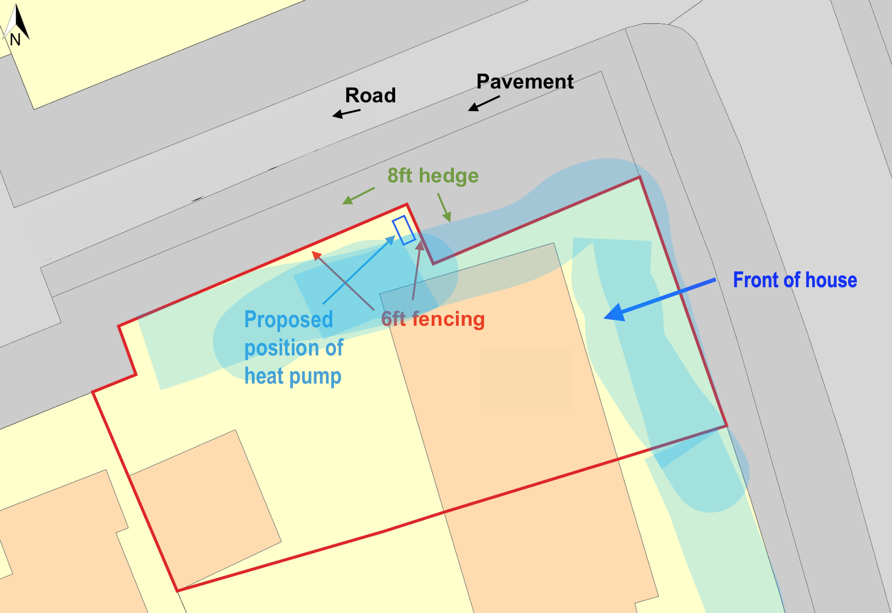

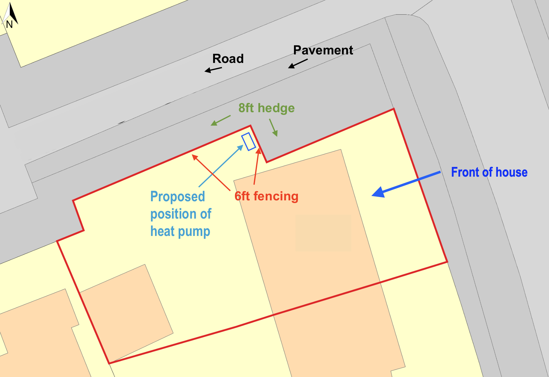

I live in a conservation area and I put in a planning application last year for a heat pump, but it was refused on two grounds; 1. it being inside the one metre rule and 2. the location being between the line of the house and a highway.
The exact wording for the second refusal came from Schedule 2 G.2 j(ii); “in the case of land within a conservation area or which is a World Heritage Site the air source heat pump—would be installed so that it is nearer to any highway which bounds the curtilage than the part of the dwellinghouse or block of flats which is nearest to that highway; or”
I understand that the motive behind this rule is to prevent units being installed in front gardens or somewhere that would be visible from the actual road. In this case though, I want to install it in the back garden and the highway in question runs down the side of the property. If it was located there it would be at ground level, behind a 6ft fence which in turn is behind an 8ft hedge so there is no issue of visibility. I’ll add a drawing to show the arrangement.
I have no other location that I can place the unit and now that the 1 metre rule has gone I would like to try again to get permission. Would anyone have any experience of this or advice on how to go about countering this objection? Thanks.

1m rule now gone as long as it passes noise assessment.
Other than objection move it elsewhere, what about behind the square building?
2 hours ago, JohnMo said:
air source heat pump must not be... be nearer to any highway which bounds the property than any part of the building

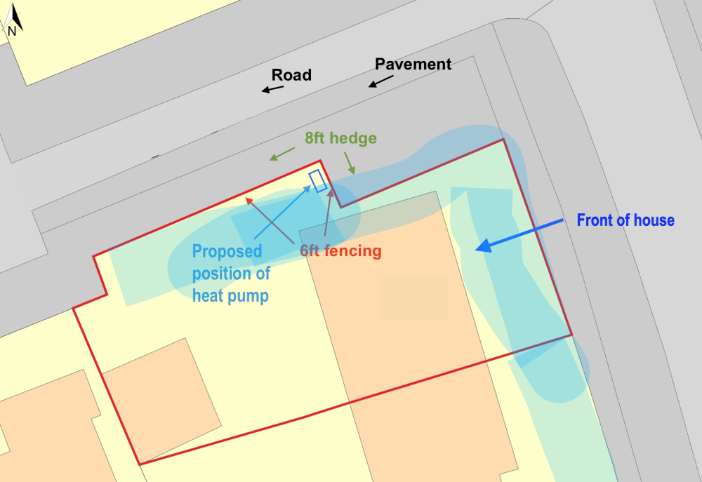

So the way I read it you can't do anywhere I have highlighted in blue, so first application didn't comply. So no surprise it was rejected, so just choose somewhere else to site the heat pump. Do the new noise calc - done

I would "just do it"
But I would not put it remote from the house as you have shown, I would put it adjacent to the house wall just around the corner on the side.  Hidden by a tall fence and hedge I bet nobody will notice and you will get away with it.
If you are served enforcement notice, then just move it around the corner so it is now on the back wall of the house and thus no closer to the highway than any part of the building.

I would reapply citing the change to the 1m rule. If refused on the road issue appeal with pictures. I would put a short section of fence or wall between it and the hedge in case they argue it would be visible in winter? I don't think you need PP for a 1m high fence but a 2m would.

This should not restrict air movement, otherwise you draw back in air that has been expelled chilled. The planners may or may not be interested in the mechanics and efficiency.
Actually, I'd give them the credit of being interested, and that efficient air changes reduces running time too.
So a fence would be slatted or hit and miss (which is proven to reduce noise well..horiz slat on one face, then the next on the opposite face).
Thinking that this little item may be among major developments and disputes on their desk, I'd make it easy for them to approve.
A tick list of all the pros and cons and how the cons were imaginary or are now removed by your thoughtful proposal.
