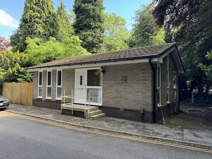

Some context, I live in the the Northwest of the UK. Have owned our 1970s bungalow since 2020 we never intended to move in, but due to ongoing ( even to this day, flooding, fire issues ) in our flat we moved to let work commence there. We had always planned to refurbish and extend this when we bought it but a number of challenges meant it never started primarily with bad architects.
Anyway fast forward to 2024 we have now a great architect and are in the process of planning things, we have incorrect planning permission and was going to apply for a modification then sadly in January 2025 our house was flooded

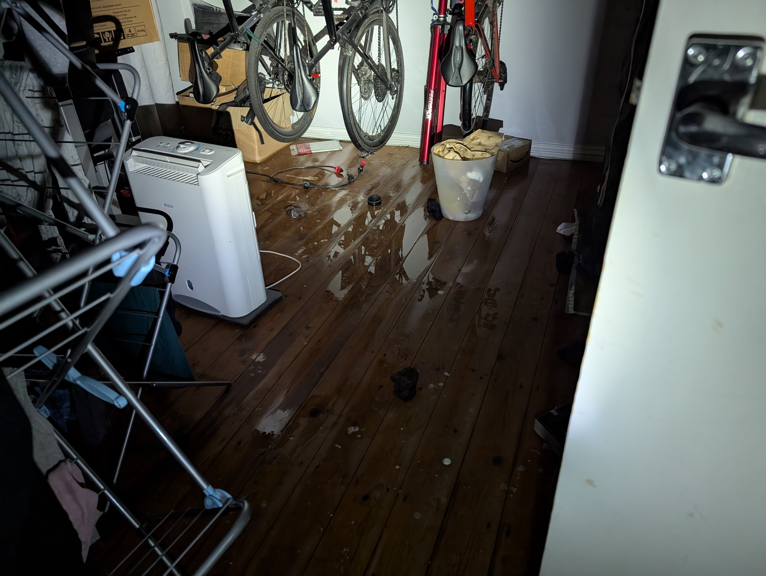

This meant we had to move out whilst it was being dried out, we decided to fast forward our building plans and applied for amended permissions.
The plans are to extend and completely gut the existing bungalow, leaving only the outside walls. New roof, windows, floor, add a bunch of rooflights ( 9 total ) to get light into the property. Then finish with MHVR, heatpump and underfloor heating. We will also be getting triple glazed alu-clad ( Norrsken / Fakro ) windows both on the roof and all round and having to take sensible flood prevention measures.
Many have asked why we didn't knock it down and re-build but ultimately that was just one step too far, we had so many decisions to make and keeping the footprint of the original building to work with just made one less major decision.

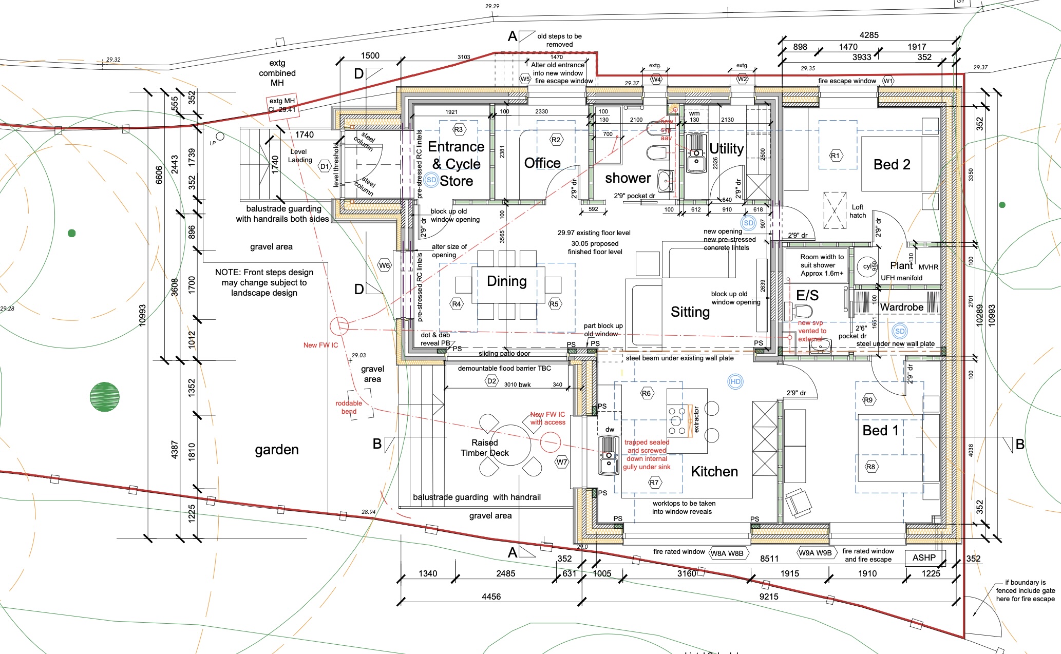

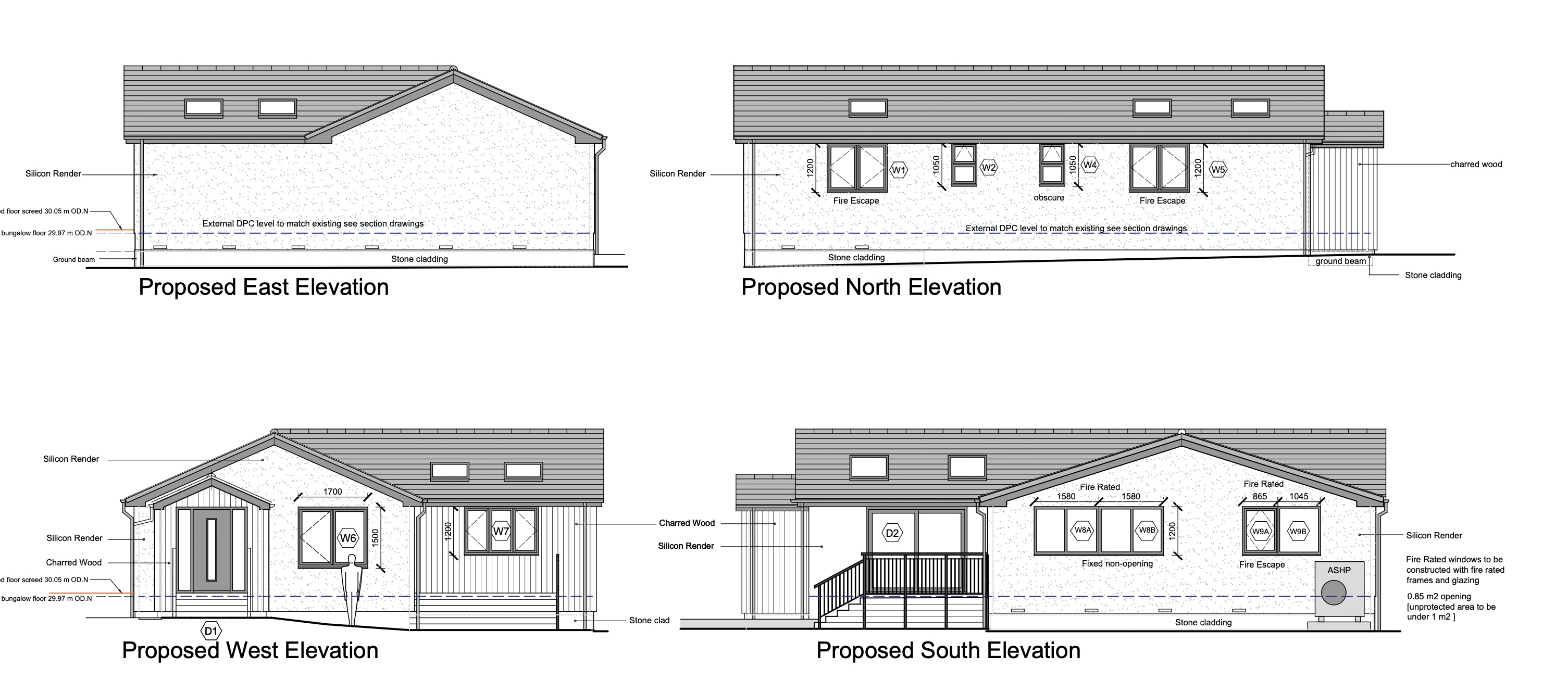

Plans are broadly as follows, we will finish with around 115 square meters of house and will be looking to get external wall insulation. We are going to move the entrance to the side and our foundations need to be piled due to surrounding protected trees.

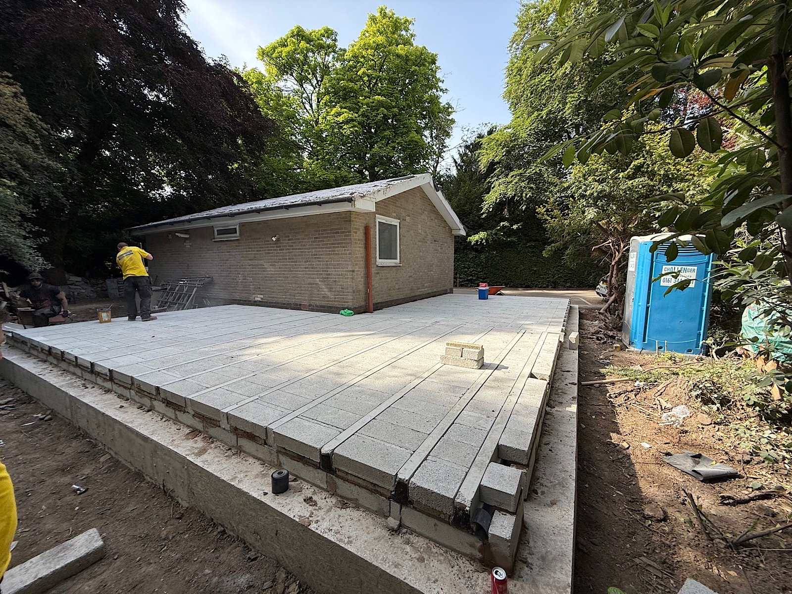

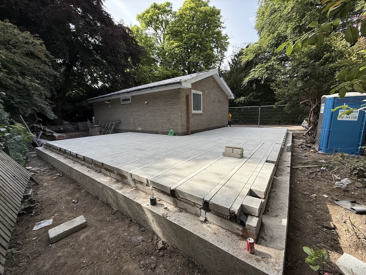

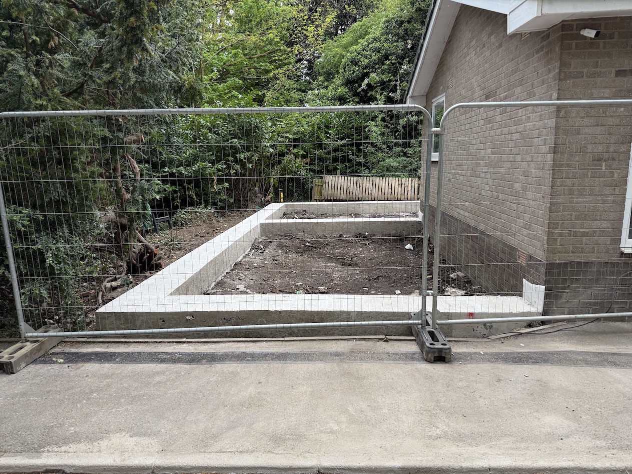

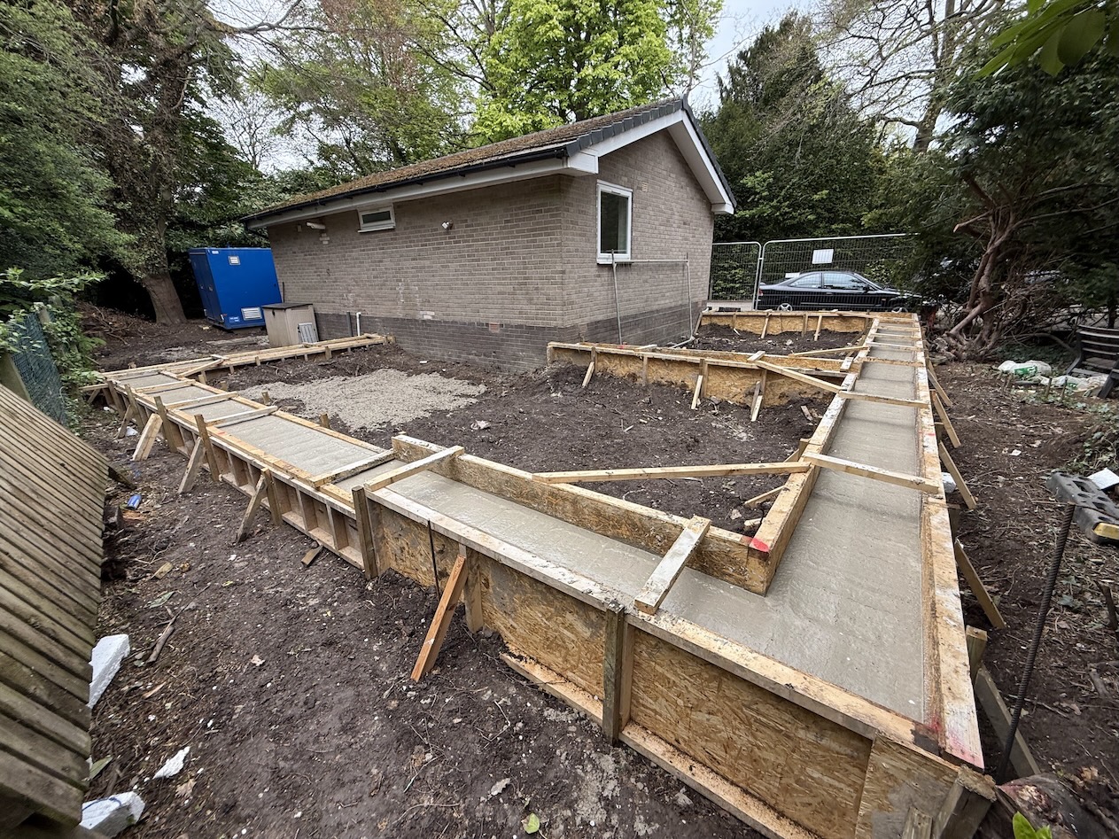

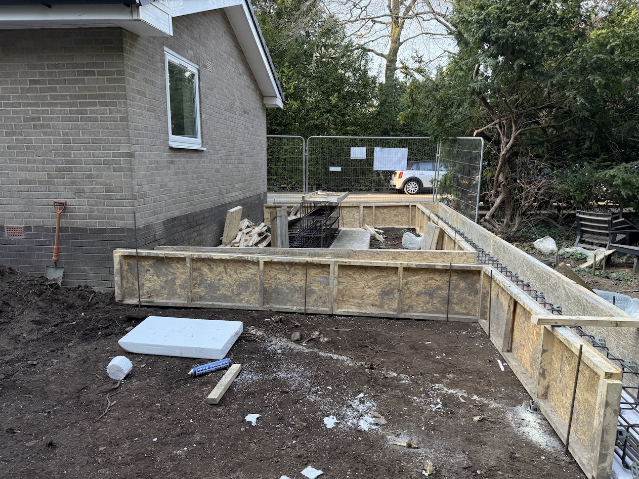

Foundations were finished around the end of April and we have been building / stripping for around 2 weeks now.

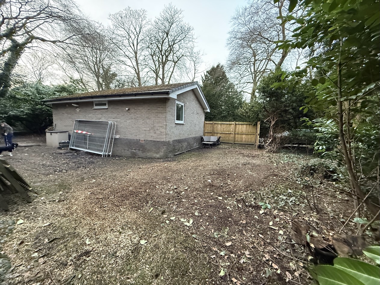

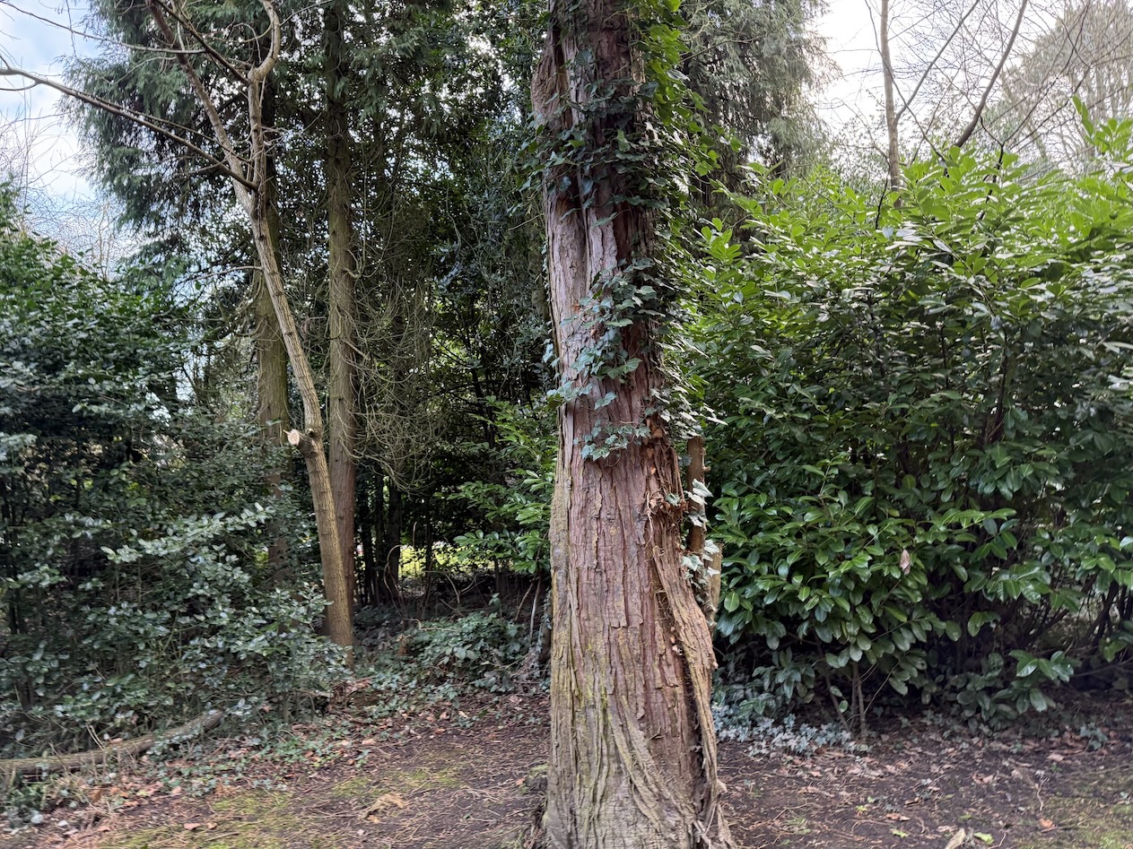

A few pictures of the ongoing stuff, we started out removing a large tree.

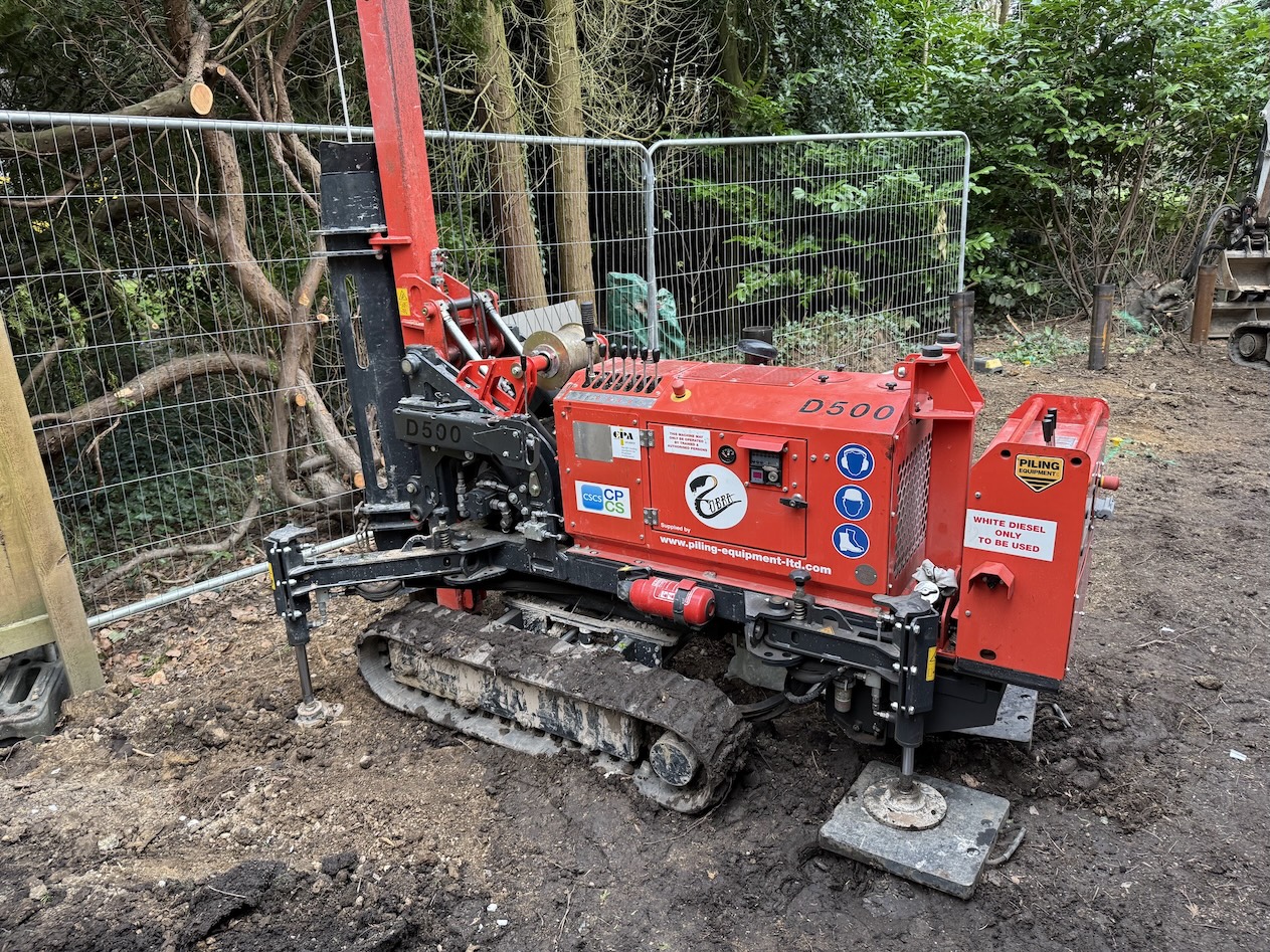

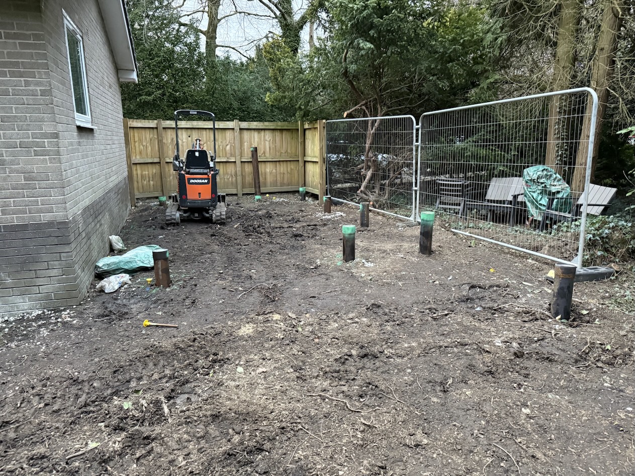

Then I got a piling firm to build my foundations whilst I waited on amended permissions, I did this with the older planning permission

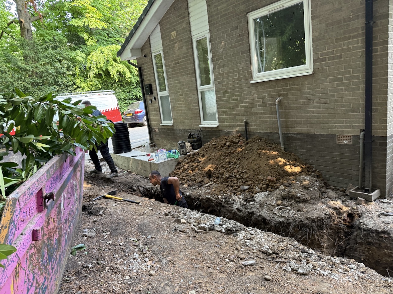

Sadly during this they managed to puncture the water mains which caused me a lot of stress....

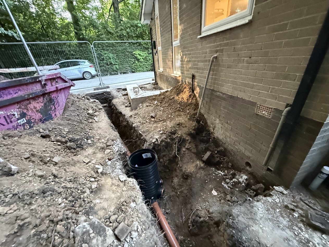

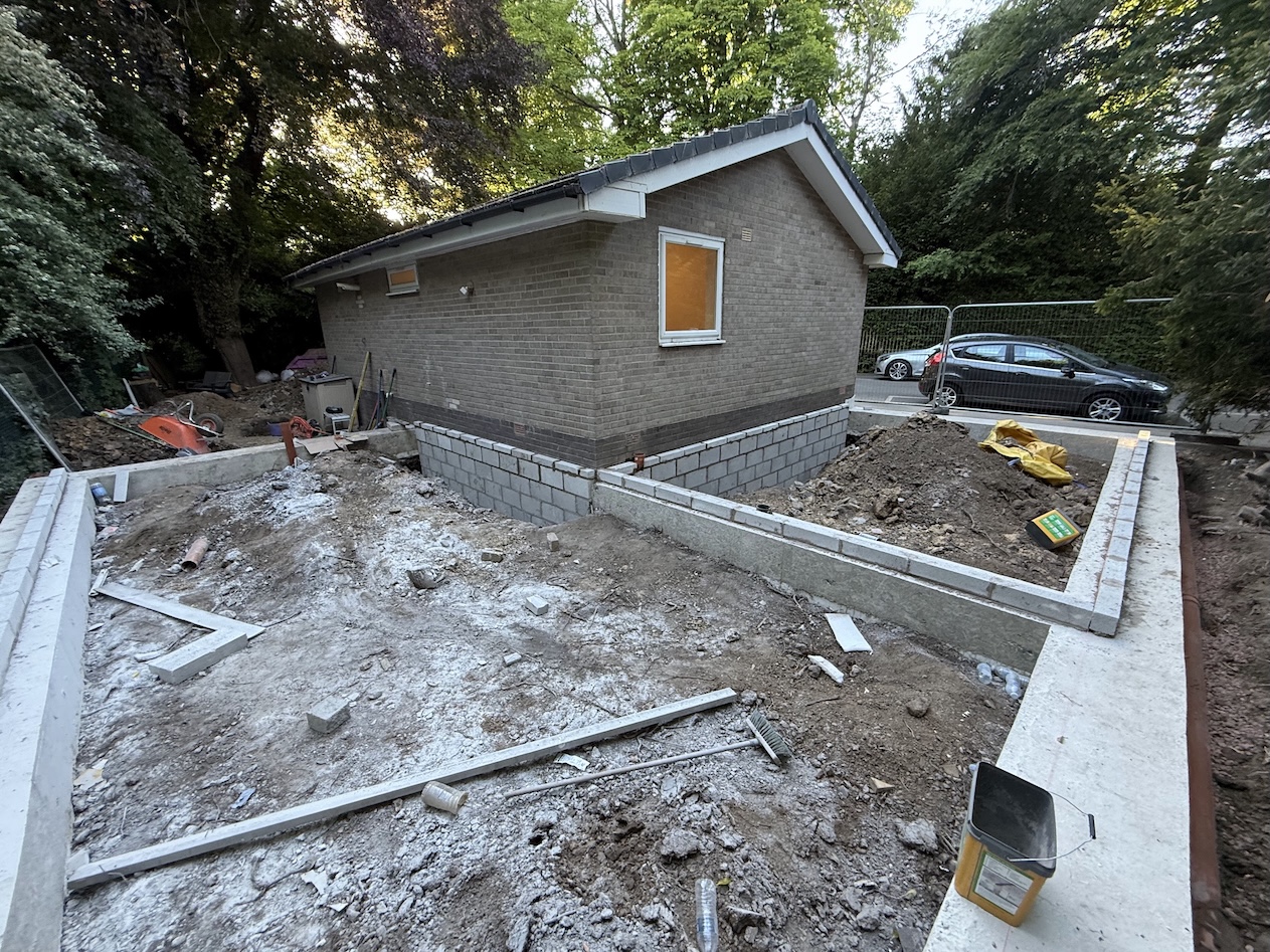

Then I finally chose my builder and a few weeks later we got started with the drains

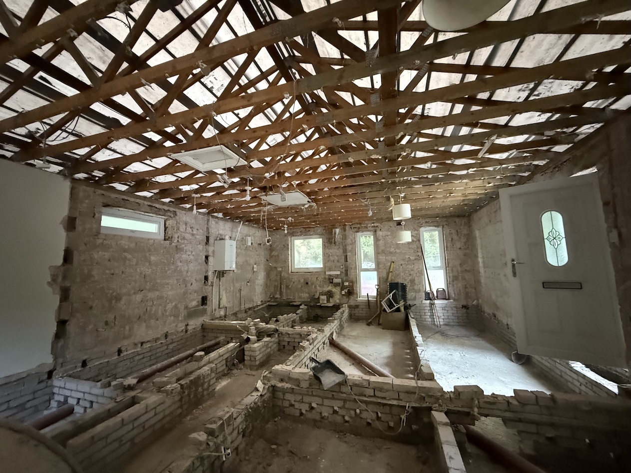

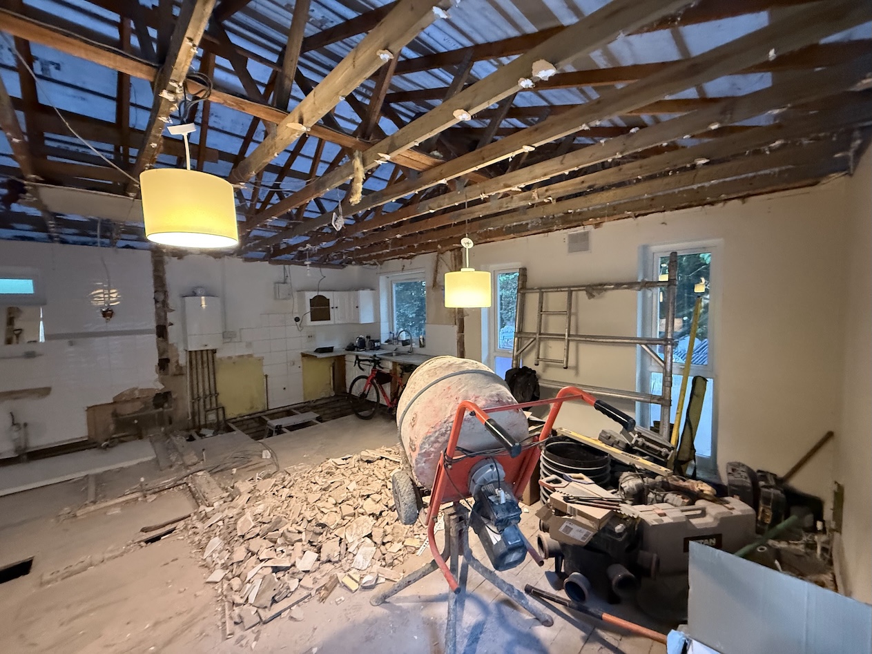

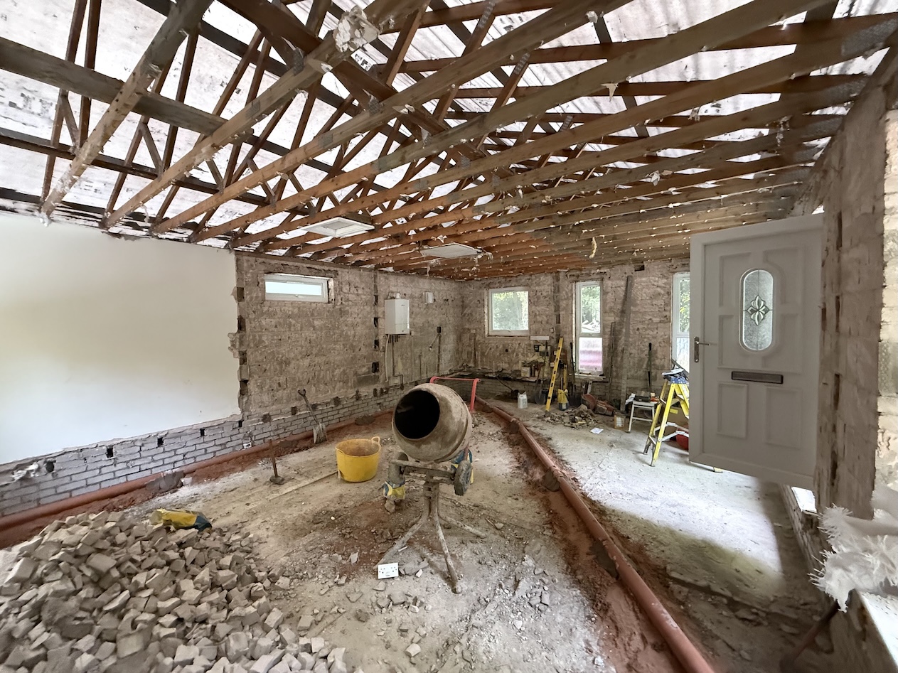

Then whilst we were waiting for signoff we started stripping the inside, roof ceiling etc
Then after we got the drains signed off, we backfilled. The beams arrived and the flooring built up in the new section:
Which largely brings me to where we were on Friday see this quick video:

Right now I just paid for a Heatgeek to do a heatloss survey for my ASHP and underfloor heating based on my plans and intended build, my local guy seemed incredibly knowledgeable rather than the other people I have spoken to who feel more like salesman. Sadly they only seem to install Valliant ASHP
I am also trying to get a full sensible design for MHVR so it works well within my property.
So right now I would appreciate any thoughts or input
- Is there anything sensible I should be doing in respect of extra measures in regards to flooding? ( We have raised the floor level and are concrete infilling existing property ) I will also be using things like anti-flood air bricks so any particular brand of that would be appreciated
- Anything worth doing in respect of the property in general, I keep hearing things like tanking being thrown around. Insurance is covering some general improvement works around the area and the flats so if I can bring anything up extra which may help me that would be useful.
- Any brand of ASHP I should be pushing for or looking at?
- Whilst I am at this stage, anything I should be considering to include or modify on my build I may have overlooked?

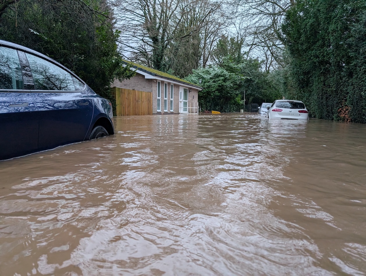

First question obvs is what is the flood risk? 1/100? worse? What caused the flood and when did it flood last? Useful to know before anyone can really comment, plus how high did the water get?
You're brave building (re-building) there tbh... :/
Posted
It was an exceptional year for flooding, tho it may be that it happens again. What is the local view on it? was there an issue, eg blocked channels?
You seem to have been unlucky with the water height. 50mm lower and it would have flown past?  You could devise a set of removable dams across the outer doorways.
Basically a piece of ply into a slot then cramped to the wall, but other materials would be better.
At much greater expense and ugliness:  a wall surrounding the house, with a removable panel for  a gate.

I didn't really have a whole lot of choice, our house would be worthless if we didn't. Luckily we are in a very good area and demand for houses here is high. Hopefully the measure we are taking will help mitigate future floods.
This spot has never flooded its a 1/100 year event, but obviously things are getting worse. In this case, the river broke its banks which meant it flooded worse than before and spread further.
Nothing wrong with Vaillant ashp as far as I'm aware.
You could say unlucky, but honestly I have had a big payout from insurance. We have had accommodation paid for whilst we are doing our rebuild, so despite the stress of having to manage it all. Its been a blessing in disguise. We managed to move most of our nicer possessions onto worktops and similar.
I will get flood gates for our sliding doors / front door I think.

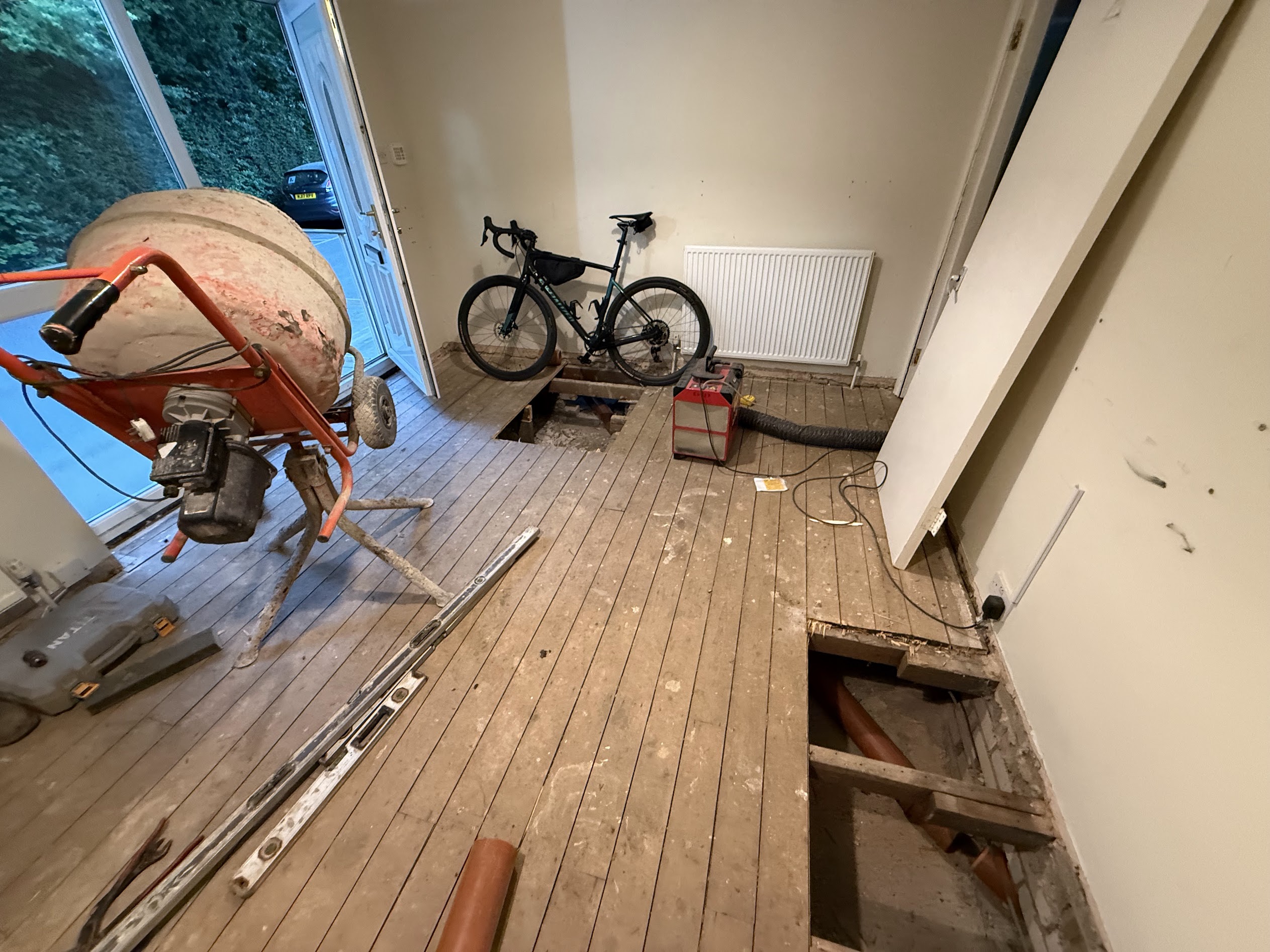

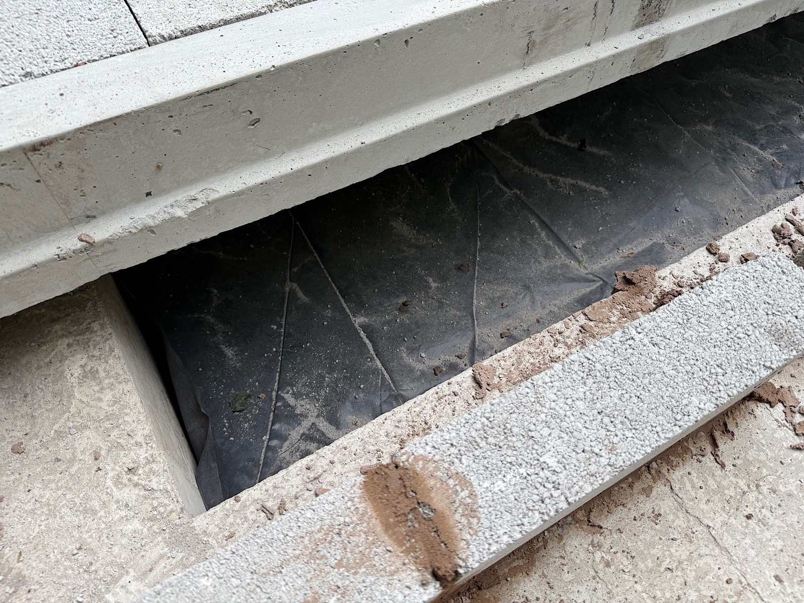

In the existing property we are going for a full fill concrete floor.
The new property is on piles and is block and beam and it's all going to be a good bit higher too.
Is there something else I can be doing beneath the block and beam before it gets fully encased?

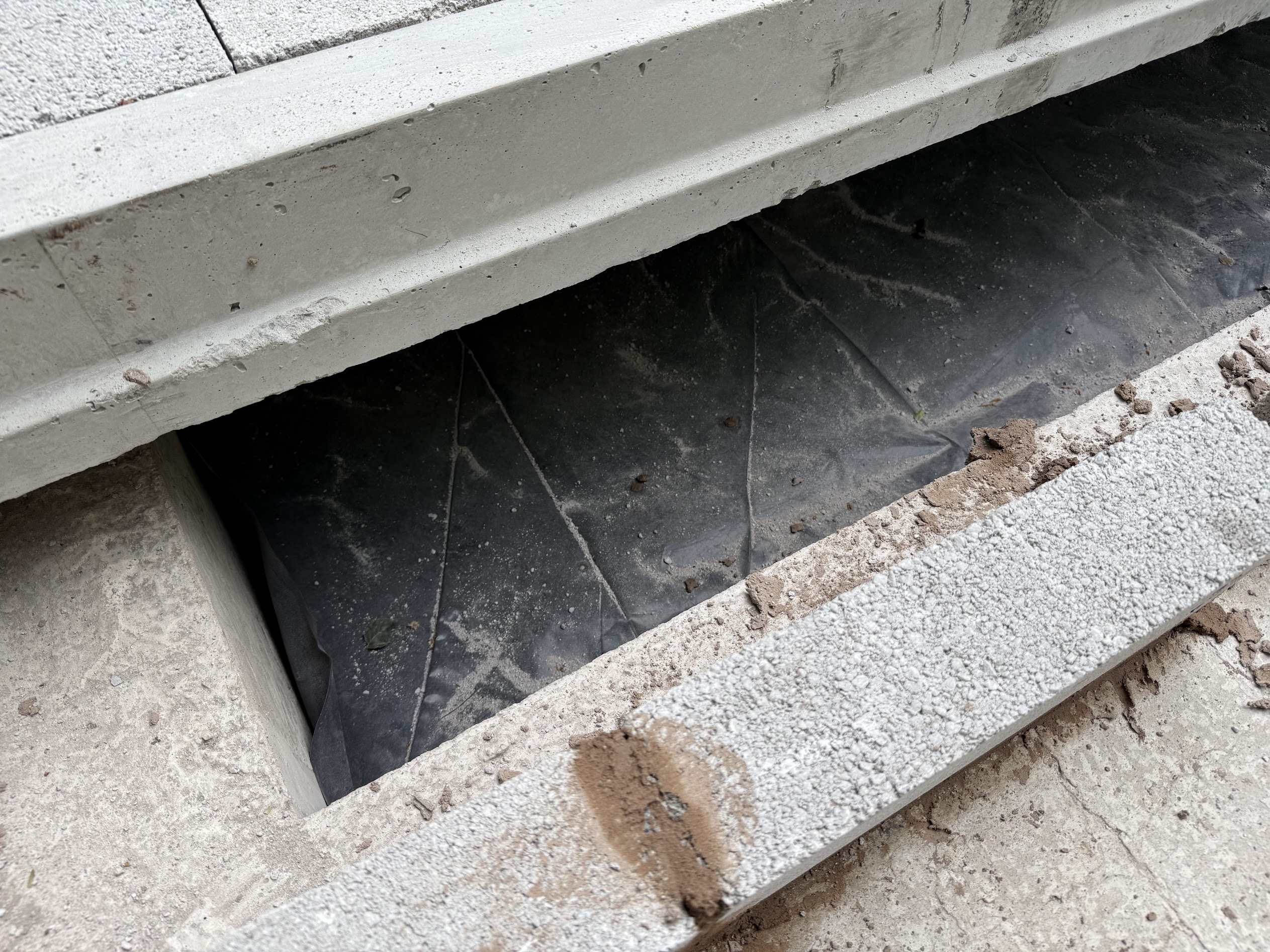

We have exposed ringbeam and it's mostly bare soil with a membrane over the top.
At the lowest point we are already putting anti flood air bricks but this sit basically on top of the ring beam.

1. Try to stop water entering the void. Any airbricks vented up above flood level.
Tanking.
2. If it fills it must drain again quickly.
So no solum membrane.
Then it needs lots of ventilation.
3. Poly barrier between floor and flooring.

We are using anti flood air bricks which will have a channel right through to the void underneath block and beam, avoiding the cavity. Existing property airbricks to be removed as we are infilling with concrete.
We already have a membrane here which was just laid on the soil as mostly a weed barrier. Should I get my builder to rip this out? Ventilation is up to building regs which is approx every 1-2m
My feeling is yes.  But welcome any other thoughts.
It can stay very wet in a damp basement for a long time/permanently.
i doubt the bco will agree because it is off the wall thinking.
what about forced ventilation? A fan system. Perhaps just build in a pipe sticking out of the wall (above flood level) that a suction pipe cold be fitted to.
Not that you will ever see in there again until the floor collapses.

So below the block and beam floor he has placed a level of visqueen which is basically an impenetrable plastic barrier. If I flood and it somehow gets into my subfloor, I assume this will simply gather water.
Is it sensible at this point in time to get him to remove that and replace with some material which allows water to drain and then perhaps cover in a layer of gravel so it doesn't float?
Posted
the purpose being to stop weeds.  that should be completed by now.
Also to keep dampness down in the earth.
It is not intended to be flooded from above.
My hunch is that it is best to remove it, but what about  the bco?   the bco needs to see it in place as normal if they are to approve normal construction.
BUT we should not deceive the bco so I am 'writing aloud' not advising this....more research is needed.
My very old books show a layer of cinders or concrete instead of the plastic. That was never damp-proof but will have moderated seasonal changes.
