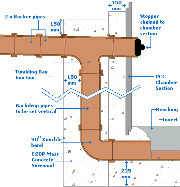

Temp Posted May 24, 2025 Posted May 24, 2025 For long drops you use a "backdrop pipe" (vertical section of pipe with a bend at the bottom and a bend/access at the top). I might be wrong but I think these days they have to go outside the Inspection chamber and connect into the ports at the bottom. Something like..

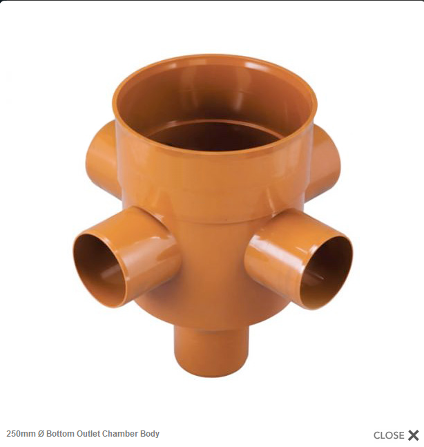

Alan Ambrose Posted May 24, 2025 Author Posted May 24, 2025 Ah, I hadn't thought of that, thanks. Key word is 'drop chamber'? Sounds a bit tricky. I also came across this (below). The whole area seems sufficently complicated, that I think I might need someone (rather than me) who actually knows what they're doing .

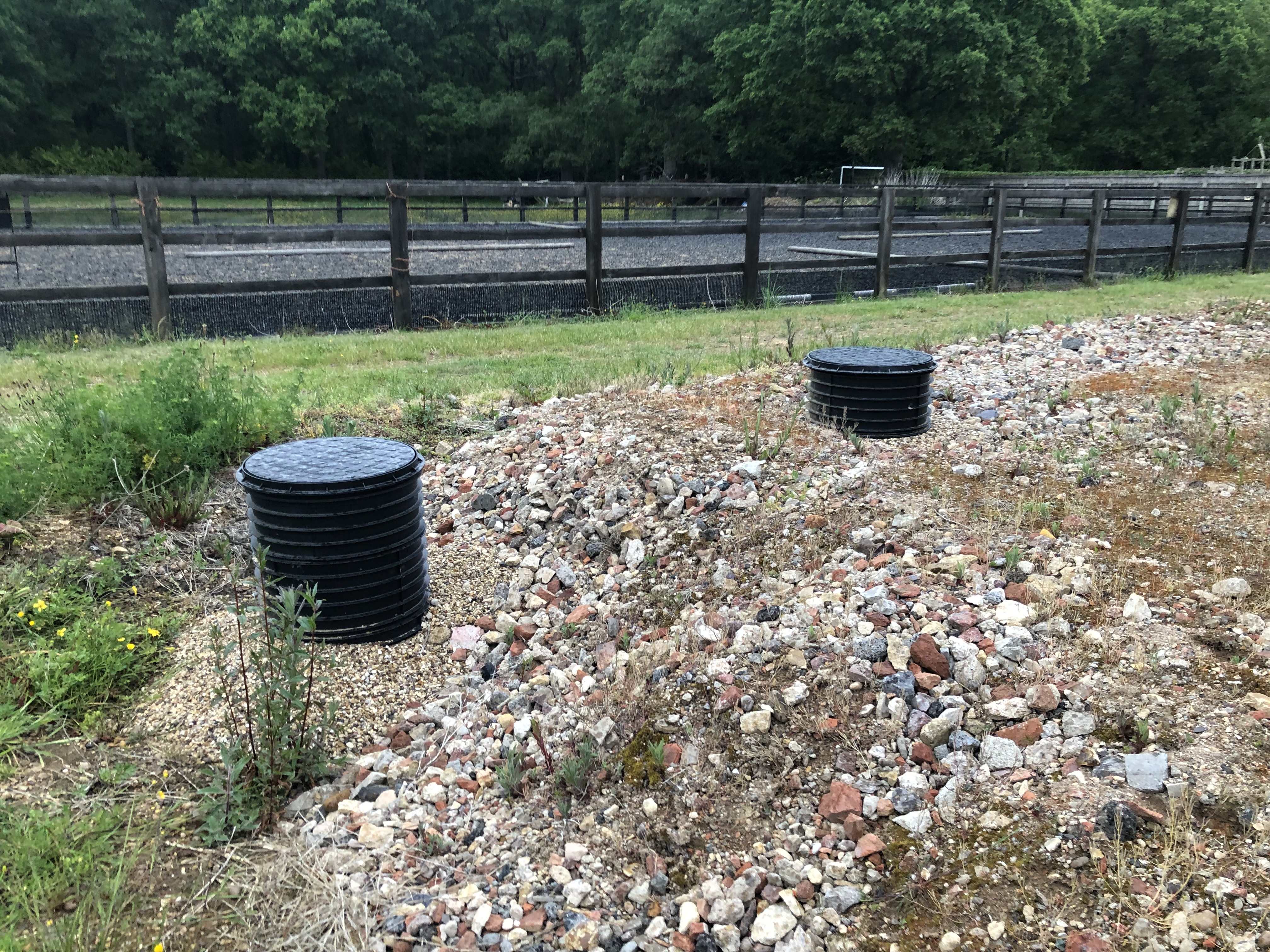

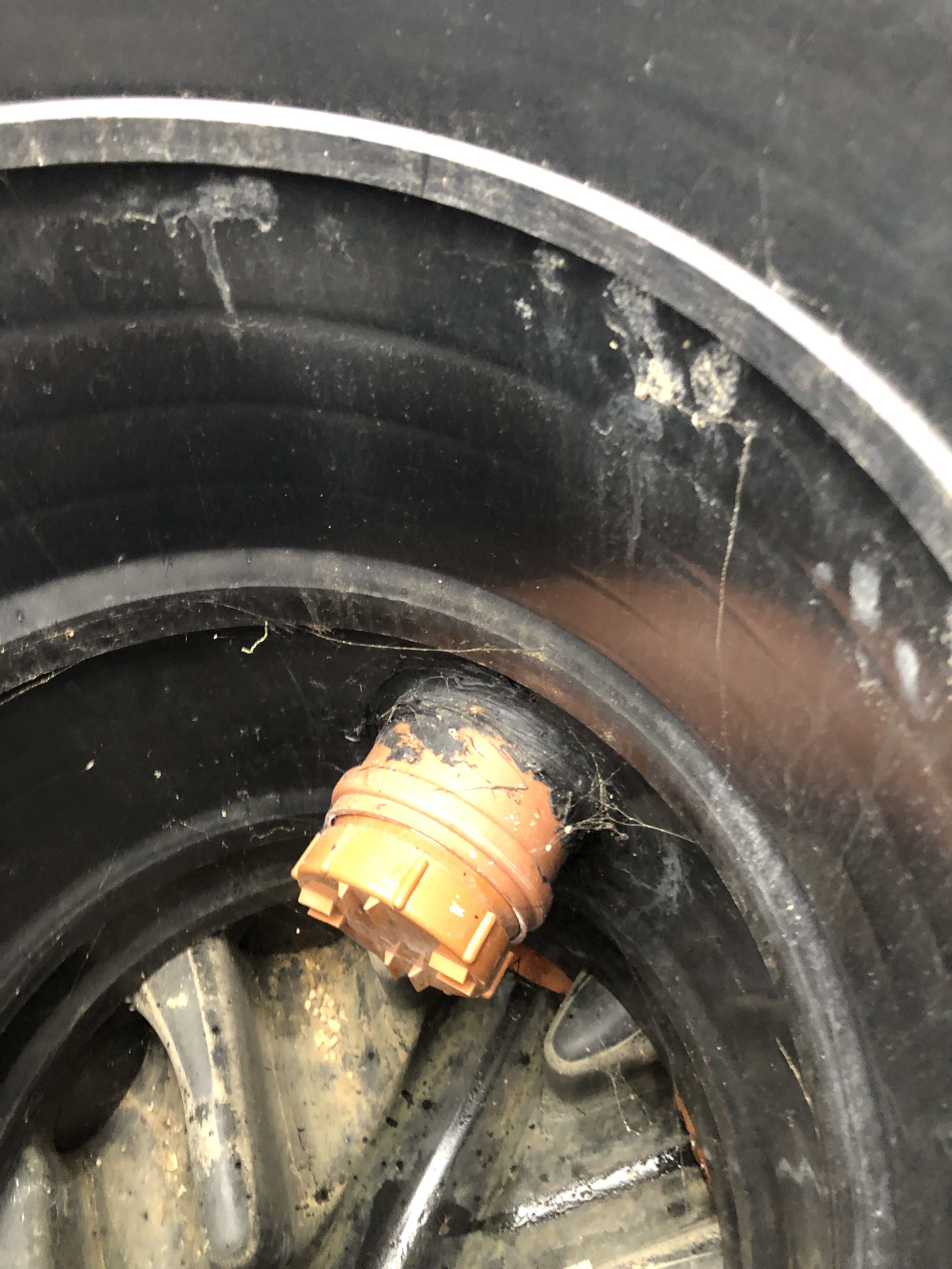

crispy_wafer Posted May 24, 2025 Posted May 24, 2025 Quick example of a backdrop to go with the example image above Got two inspection chambers with inlets from the build at two levels (excuse the weed’s) drops 300mm ish for another inlet before heading to the treatment plant. Hopefully it gives you a brief idea of what’s going on! Hardest bit was sealing of the stopper pipe through the riser. Liberal use of BT1 smeared on both sides before backfilling.
