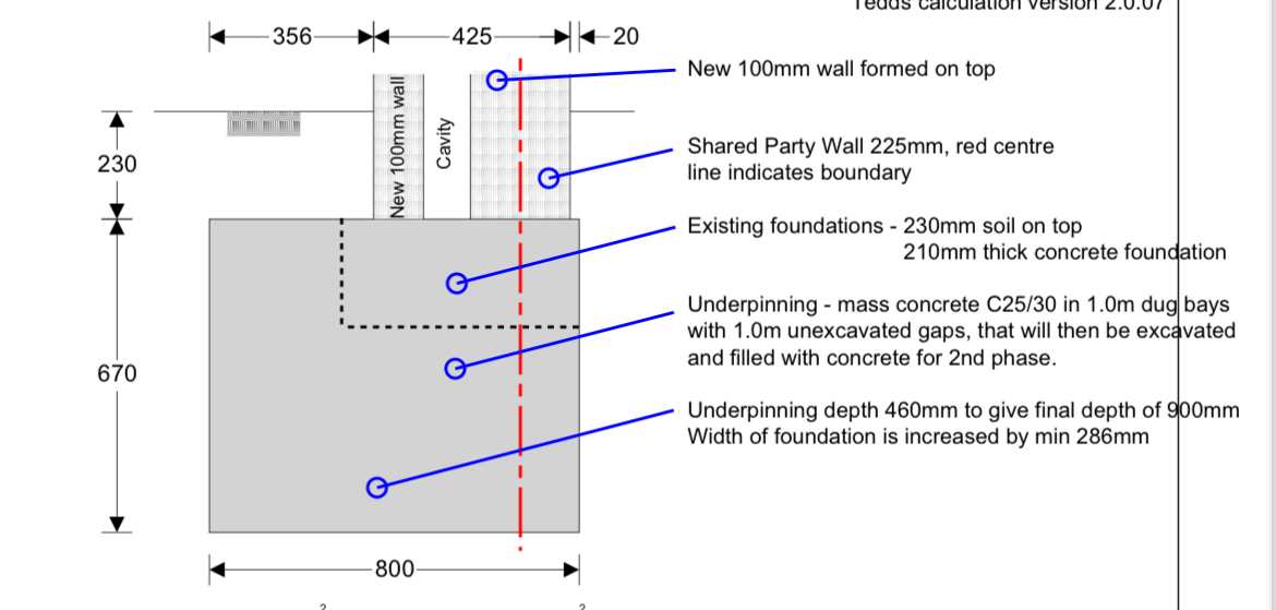

Timberframeguy Posted yesterday at 12:28 Posted yesterday at 12:28 Hello there - I’ve had the attached design from our SE for a garage conversion with a second storey above. My builder has said the footing depth of 670 is ‘ridiculous’ and I should look to have this redesigned as it’s complete over kill. Can anyone shed any light on this? Thanks Normal ground, no trees nearby.
nod Posted yesterday at 14:11 Posted yesterday at 14:11 Your SE will probably no more about ground conditions than your builder 670 isn’t deep Our last build was 1800 detached garage also 2
Timberframeguy Posted yesterday at 18:35 Author Posted yesterday at 18:35 (edited) Thank you for your reply, the total depth is 900 with a 670 depth strip. 1800! Wow Edited yesterday at 18:35 by Timberframeguy
ETC Posted 22 hours ago Posted 22 hours ago I’m presuming your SE has two things on his or her mind: 1. The foundation is asymmetrically loaded. 2. He doesn’t want to get sued if shit hits the fan. 1
Temp Posted 21 hours ago Posted 21 hours ago Did you dig a test pit to check out the foundation depth of the main house?
Timberframeguy Posted 13 hours ago Author Posted 13 hours ago 8 hours ago, Temp said: Did you dig a test pit to check out the foundation depth of the main house? We didn’t, this wasn’t requested.
