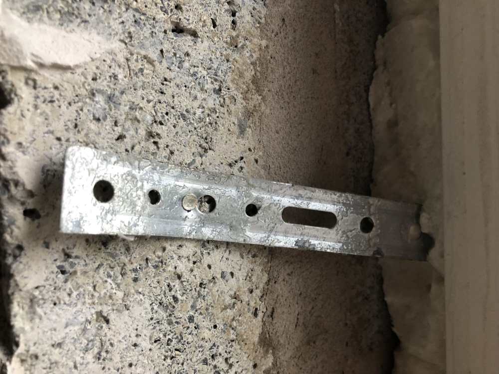

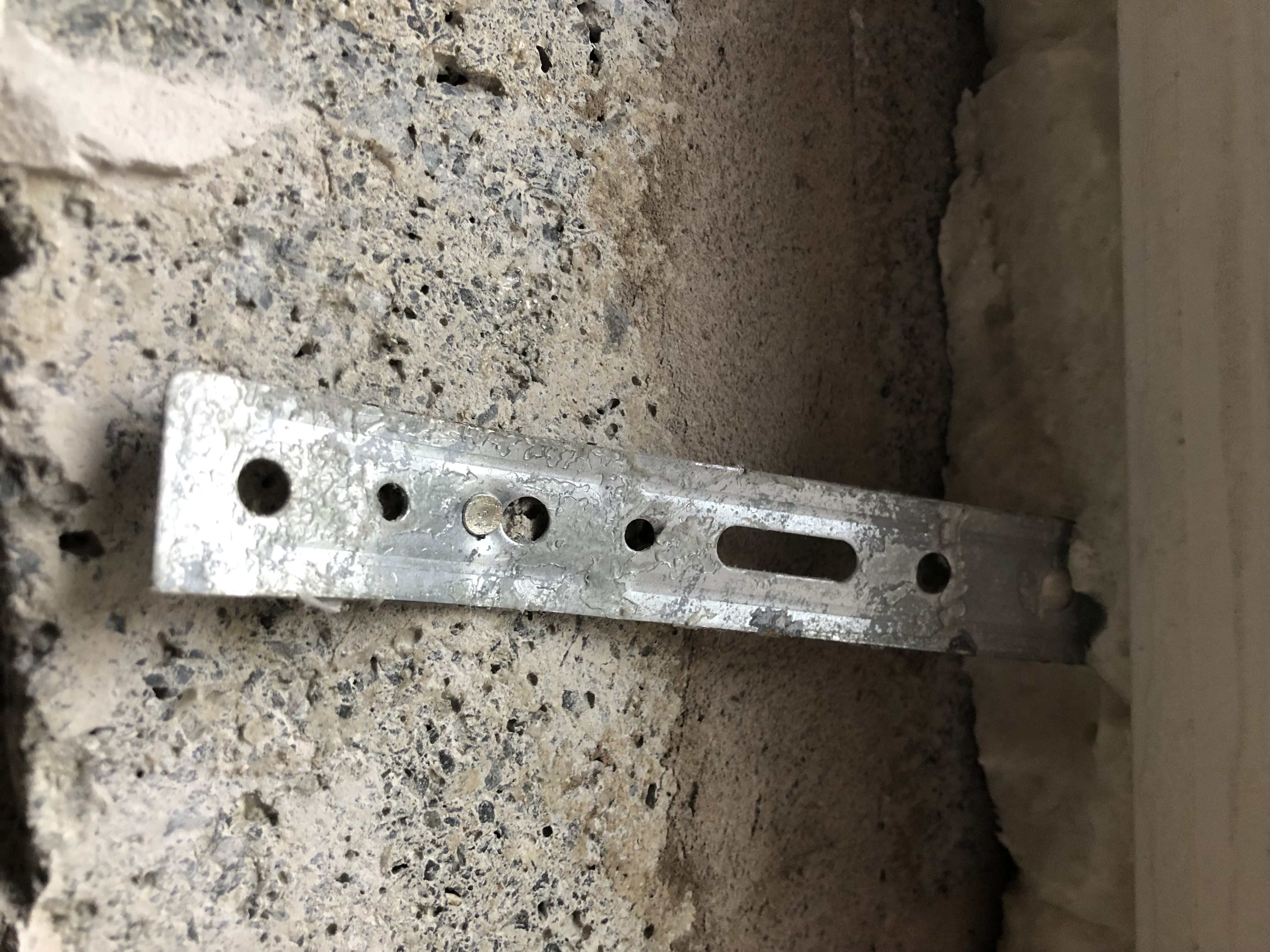

  8. Better to use screws on the last hole to both pin it flat and add extra strength to the strap? Throughout the house there’s at least one strap that has come loose.

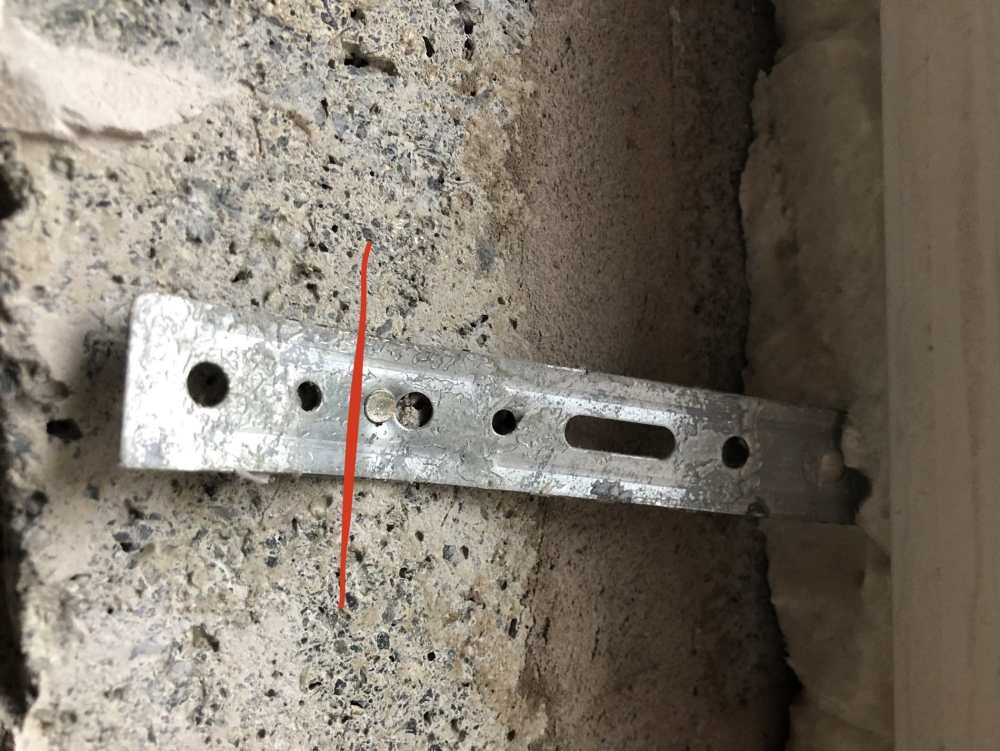

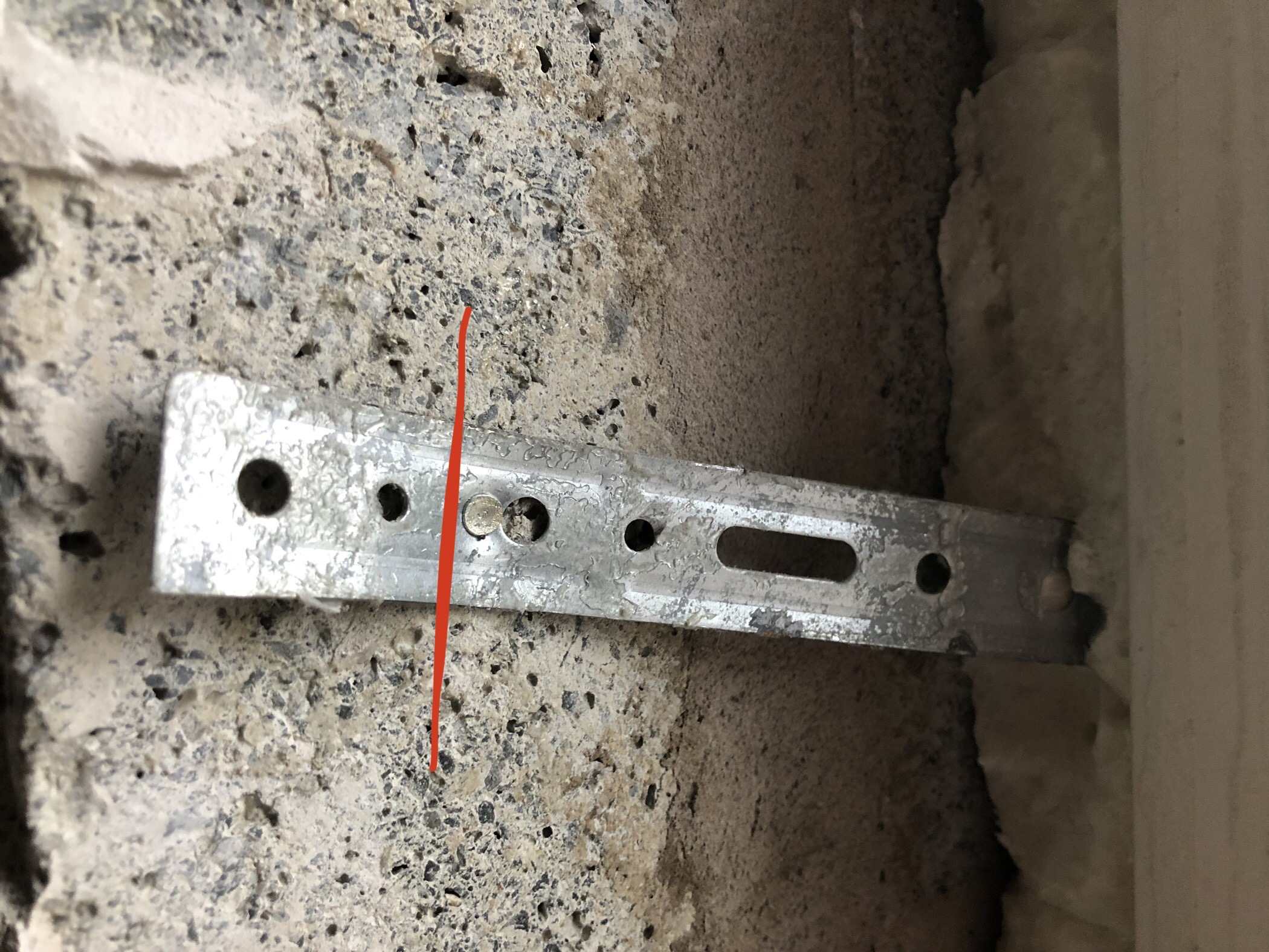

  9. Have seen these fixing straps referenced as often being a source of air leakage and reduced airtightness. Is there any reason I shouldn’t cut the strap after the affixing nails (red line) so there is less chance of them pulling up the airtight tape?

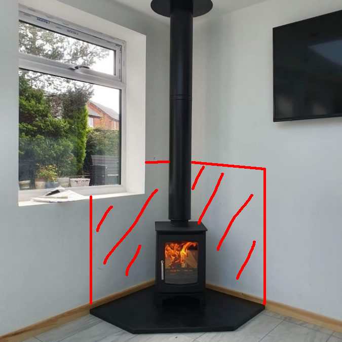

  20. Getting conflicting advice on this. We will have a free standing corner stove (as in it will be sitting in the room) just like the attached image - we just won't have that window. There won't be any wall cladding added around the stove, at least that's our preference. Outside to inside our wall build-up is: Block, Cavity Bead, Block, 25mm IWI PIR, (yes not the way many would go) 12.5mm Plasterboard with skim finish. On one side we're told we need to replace the PIR IWI around the red wall area on the attached image with something like an "isoboard" for fire safety, on the other side we're told the PIR IWI (unilin, mannok, or kingspan) is perfectly safe in this position. I've tried searching here and wasn't just finding a clear answer. Is it safe enough to go with the 'standard' PIR IWI for a 5kw multi-fuel stove here? I posted here rather than the stoves forum as I thought this query focused more on the insulation than the stove.
