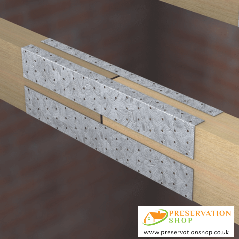

Temp Posted Wednesday at 19:19 Posted Wednesday at 19:19 (edited) Google "for joist repair plates" or "Bower beams" https://www.permagard.co.uk/bower-beams-large?gad_source=1&gad_campaignid=20104758639&gbraid=0AAAAAD6l7u6eYbKpQcQBXyc85Smq5MoS8&gclid=CjwKCAjw87XBBhBIEiwAxP3_Axxih9ZPj7neGI8nFscH233n-kk6VjP3GPKyrL0vkQGshG4fCttAOhoCbzMQAvD_BwE https://www.preservationshop.co.uk/product-category/timber-treatment/timber-repair-systems/ Edited Wednesday at 19:21 by Temp
andreas Posted Wednesday at 19:32 Author Posted Wednesday at 19:32 9 minutes ago, Temp said: Google "for joist repair plates" or "Bower beams" https://www.permagard.co.uk/bower-beams-large?gad_source=1&gad_campaignid=20104758639&gbraid=0AAAAAD6l7u6eYbKpQcQBXyc85Smq5MoS8&gclid=CjwKCAjw87XBBhBIEiwAxP3_Axxih9ZPj7neGI8nFscH233n-kk6VjP3GPKyrL0vkQGshG4fCttAOhoCbzMQAvD_BwE https://www.preservationshop.co.uk/product-category/timber-treatment/timber-repair-systems/ Thank you I had seen those but I cannot slide the lower lip in below joist without damaging ceiling below, and notch in top of beam and has pipes in so I could not put a full top one in. The glued ply scabbing was suggested to me as I can slide in through lifted boards but they do not know about glue on rough sawn timber and I cannot find clear answer.

saveasteading Posted yesterday at 16:53 Posted yesterday at 16:53 If the notches are near the ends then it probably doesn't matter structurally. Where are they? The plates shown by @Temp would be great but your point is valid and important. So you could instead simply fix the flat plate equivalent to both sides, using several screws. More thought needed if that suits. I wouldn't bother with glue at all. Standard at any BM or at SFix or ToolS. Or you could use plywood instead Again multiple screws are more important than glue. Or, replace the flooring locally with plywood, again screwed down. This becomes a top flange for the joists.
