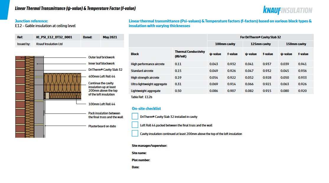

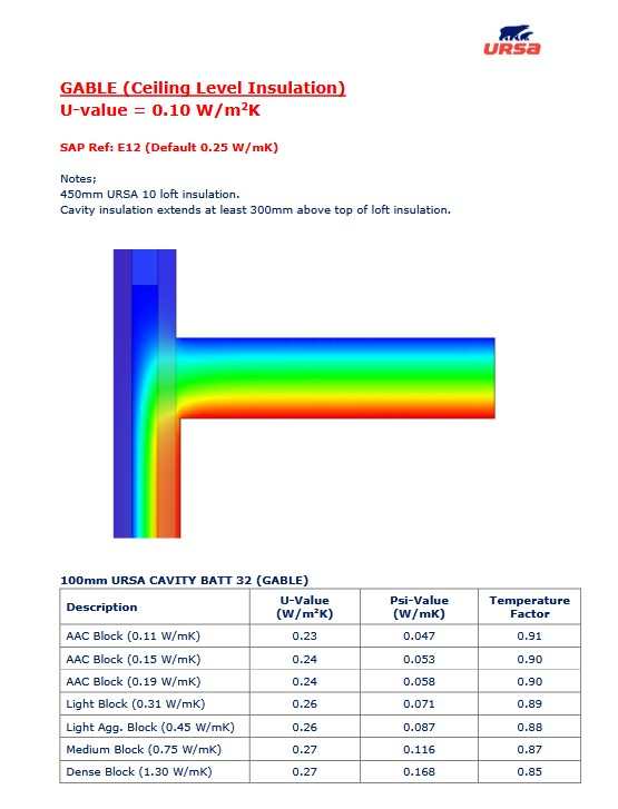

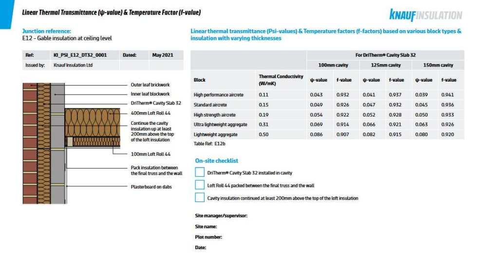

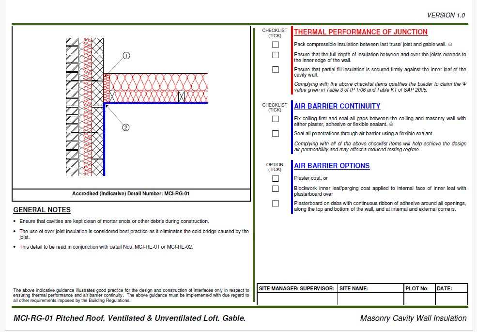

ADLIan Posted May 20, 2025 Posted May 20, 2025 Here are 3 examples one from the now out of date Accredited Construction Details (so been good practice for some time) and one from URSA and Knauf current publication. There are many more.

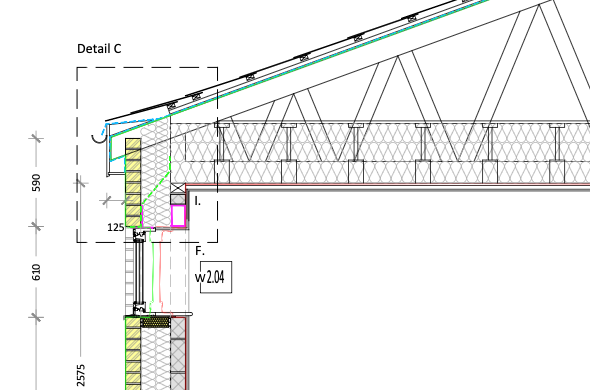

DannyT Posted May 26, 2025 Posted May 26, 2025 On 20/05/2025 at 15:54, ADLIan said: Should also use a cavity tray to protect the top edge of the cavity insulation and change of construction (in practice I’m sure this is rarely done!) This is how we are told by NHBC to do it at work now but I can tell you now, my gable ends won’t be sitting on any cavity tray. Why would you want a non bonded slip joint running the length of your gables in gale force Winds? 1
