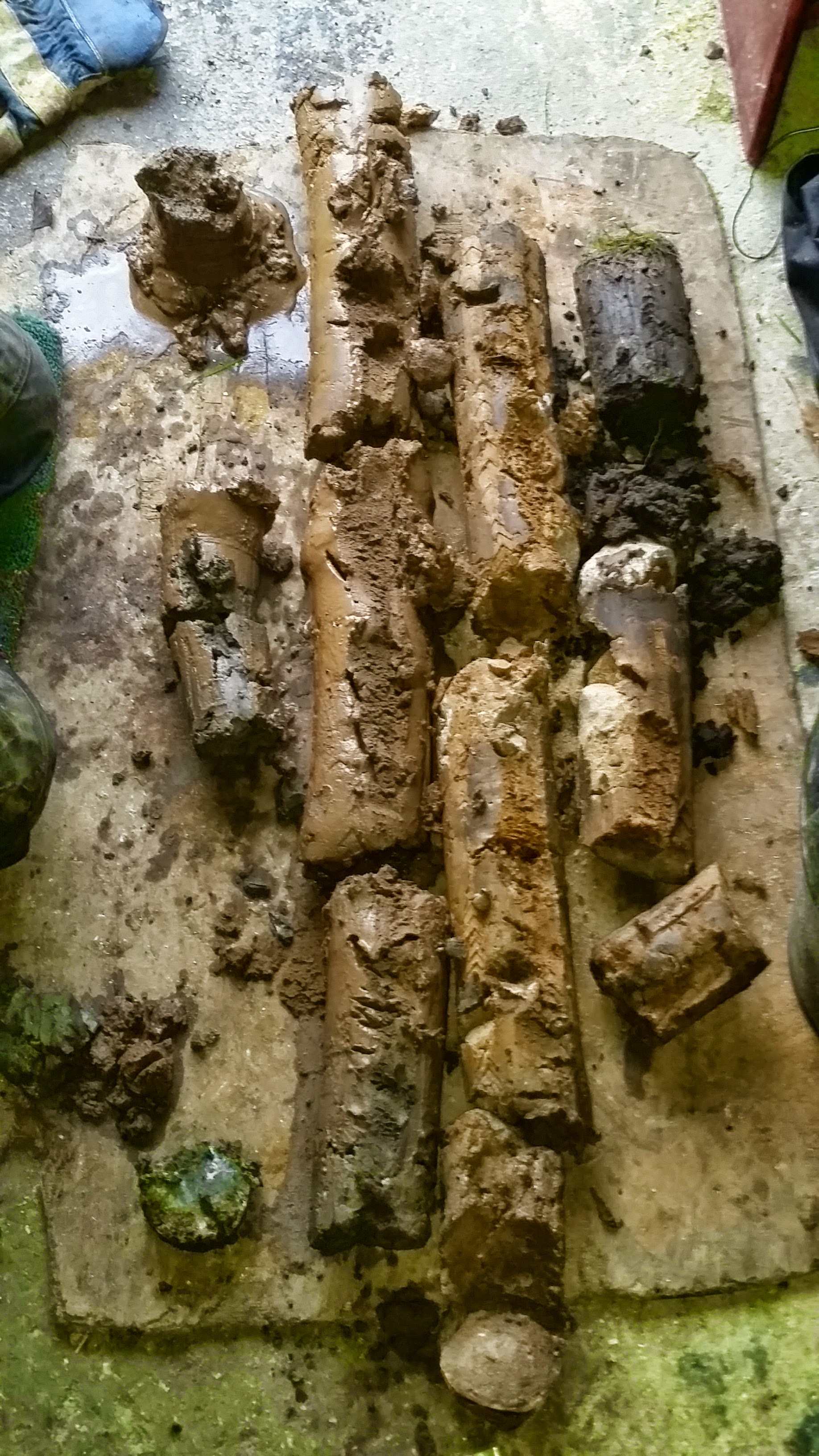

ToughButterCup Posted May 21, 2025 Posted May 21, 2025 8 hours ago, Lincolnshire Ian said: ... below 3m it's the consistency of play-dough. Â Same here. But wet play-dough. Here is one core. Â Height 'reads' from right to left. Top to bottom sequentially . You can see the topsoil on the right. The very last bit to be laid out is top left. As you can see, it's full of water.
Lincolnshire Ian Posted May 21, 2025 Author Posted May 21, 2025 20 minutes ago, ToughButterCup said: Â Same here. But wet play-dough. Here is one core. Â Height 'reads' from right to left. Top to bottom sequentially . You can see the topsoil on the right. The very last bit to be laid out is top left. As you can see, it's full of water. You win this rather expensive competition, your play-dough is wetter than mine. My sampling was down to 5m is yours 4m?

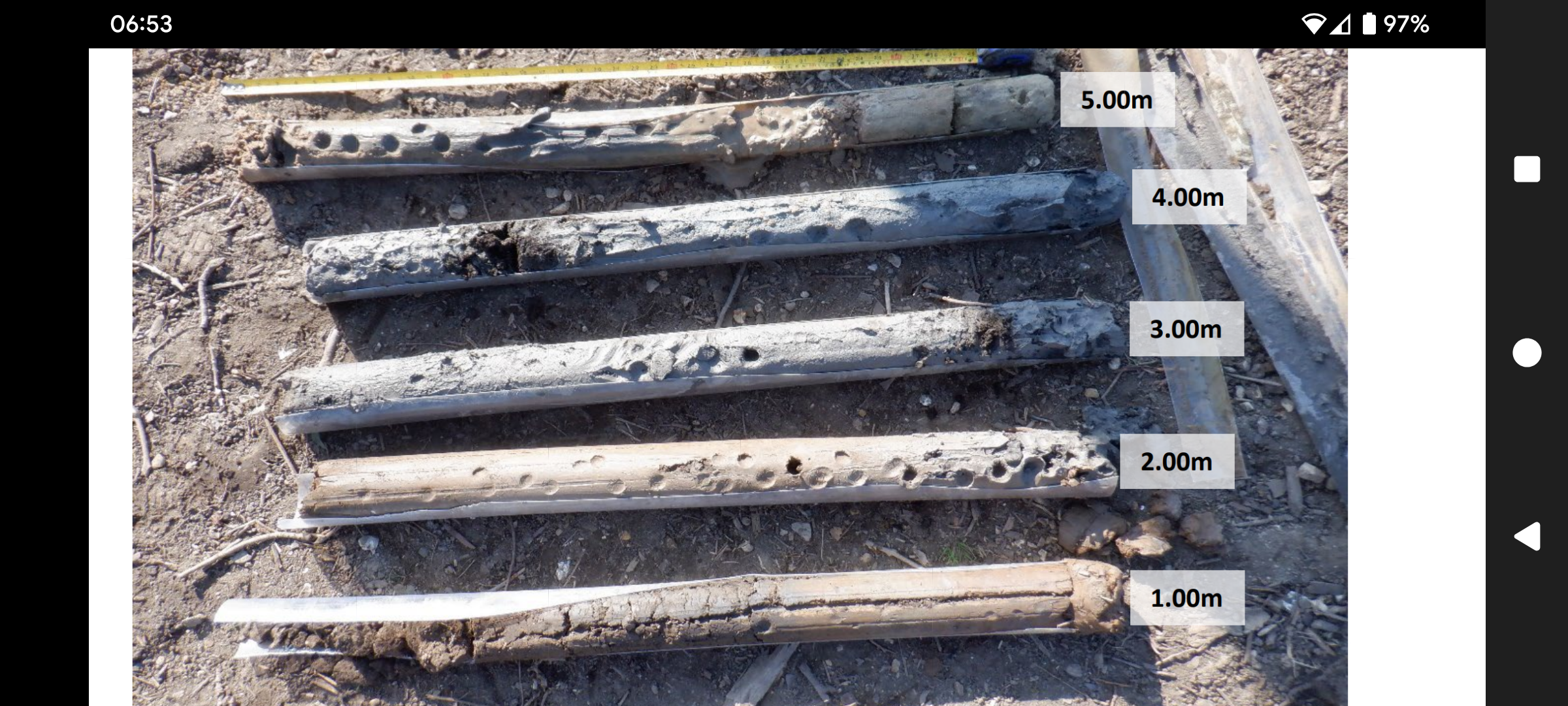

Lincolnshire Ian Posted May 21, 2025 Author Posted May 21, 2025 Here are my ground core samples. Its expensive, but interesting stuff. The geologist pulled a perfectly preserved shell from the clay and told me that 150000 years ago my plot was part of the sea (the sea is now 15 miles away.Â
ToughButterCup Posted May 21, 2025 Posted May 21, 2025 2 hours ago, Lincolnshire Ian said: You win this rather expensive competition, your play-dough is wetter than mine. My sampling was down to 5m is yours 4m?  It was dug down to 'Refusal' . ( Can't remember what the setting was - or who specified it) But the piling company would not quote until they had that report. In addition one of their lads came out and did a thorough site survey ( digger > 3 m down> jump in > grab hold of the clay and feel it)  I asked for one 8 meter core - which they did for me FoC. 2 meters (?) of it was topsoil. And the bottom was very sandy wet clay with bits of gravel ( ground down sandstone?) in it. That bit of information was key for our SUDS submission. Another use for the soil survey for the BCO company. (when it came to it, the site Inspector wasn't in the slightest interested.) We dug a pond and ducted our roof water to it, knowing that (since we are on a slight slope) that we could dig down outside the pond and let excess water overflow into that sandy / gravelly bit of clay: and from there into the GCN-laden pond a few meters below our garden level.  This morning there are 8 or 9 GCNs feeding on hatching WhatEverTheyAres trapped in the surface tension of the water in the pond we dug.  Our Tomcat is eyeing them suspiciously. Can't wait for the splash.
