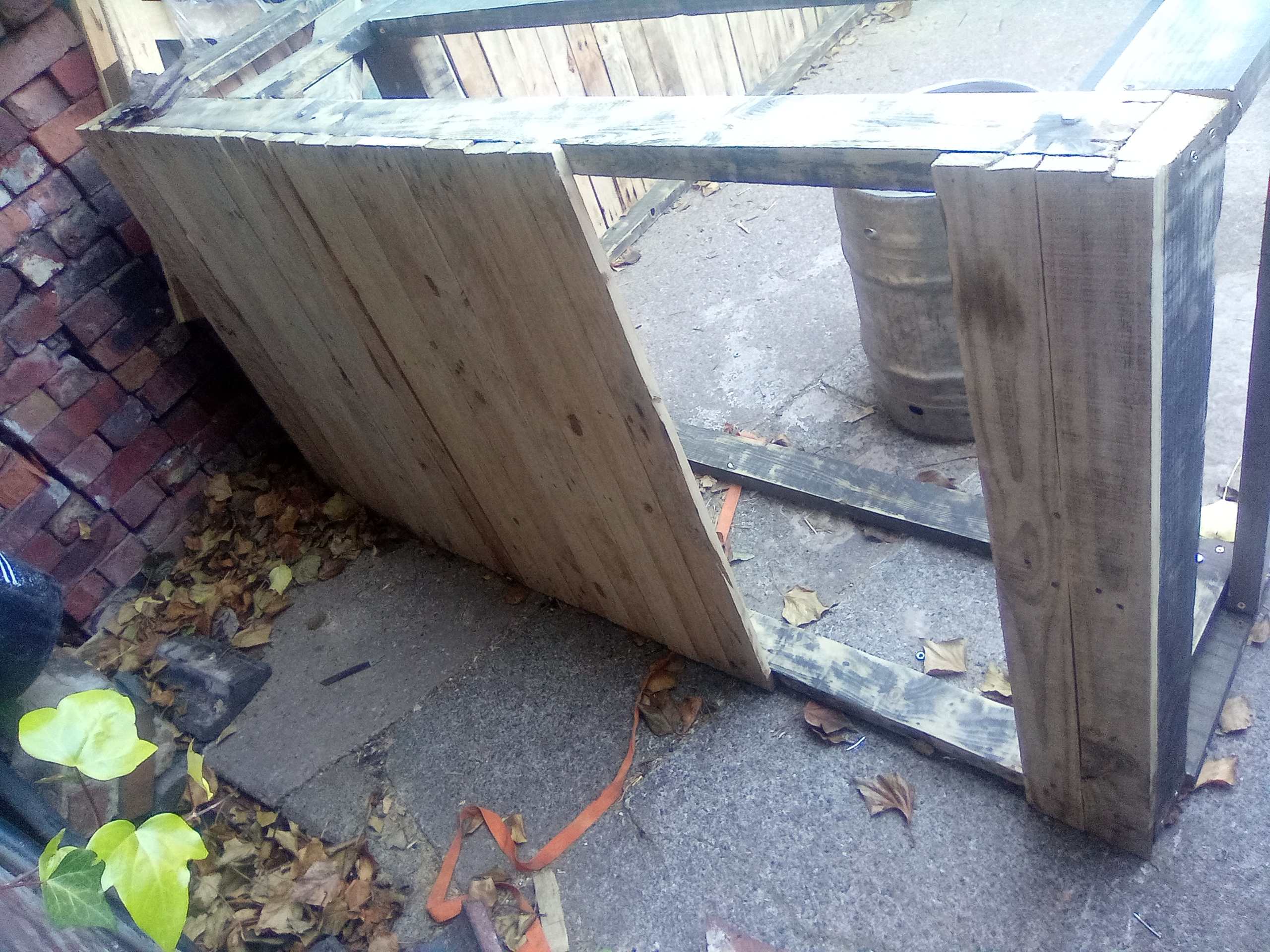

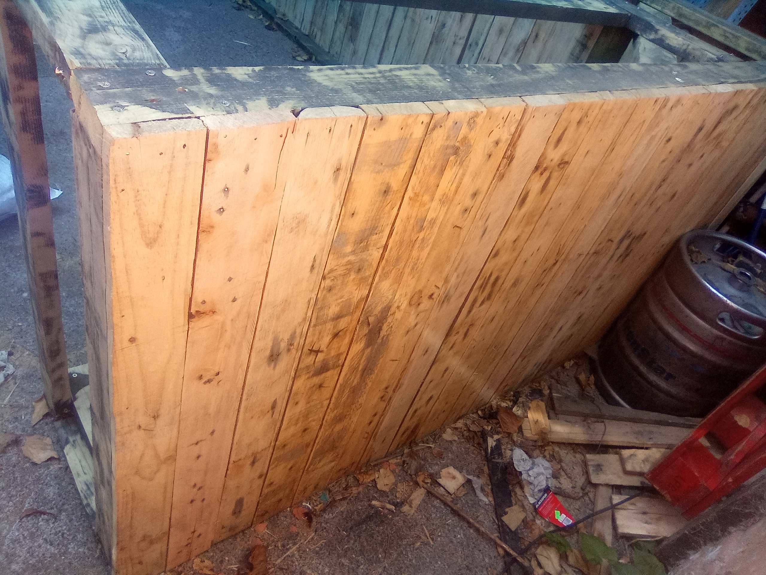

lord mud of the flyes Posted Saturday at 14:21 Posted Saturday at 14:21 Cant seam to find a painting section hear for it Anyway this is what I have. its for an indoor bar so want it looking as best s possible really. so any ideas on paints? Thanks
Crofter Posted Saturday at 17:32 Posted Saturday at 17:32 It's very rough and coarse grained, you might find that out soaks up paint like a sponge, and the paint will be liable to crack and peel over time. I would stain or oil it instead. 2
MPH243 Posted Saturday at 20:54 Posted Saturday at 20:54 I have used Cuprinol garden shades before and has lasted outside OK so indoors should be fine. A coloured stain or oil would work well as @Crofter has suggested.

SteamyTea Posted Sunday at 16:31 Posted Sunday at 16:31 6 minutes ago, lord mud of the flyes said: do you think it will look like the above ebay links With lots of sanding.
Crofter Posted Sunday at 16:44 Posted Sunday at 16:44 20 minutes ago, lord mud of the flyes said: Is staining called satin pain? when you say oil it do you mean like soak in waste engine oil like they do with the fence posts Stain is a separate product to paint, it's generally green or brown and it soaks in to the wood. Used primarily for waterproofing and protection, but also gives a uniform colour to the wood which hides rust marks from nails etc. Satin paint is simply non gloss paint, completely different product and purpose. Oil is a specific timber treatment, historically linseed oil was used. The unscrupulous may use engine oil. It's just to protect the wood from water penetration. I would definitely never suggest using engine oil because it will stink, it's carcinogenic, and it will probably leach back out of the wood over time, getting on anything that touches the wood.

MPH243 Posted Sunday at 18:37 Posted Sunday at 18:37 The first link you will never get that finish it looks like spray painted mdf. Probably a satinwood. The second link is a coloured wood stain which would be similar to what you would get with something like this https://www.wood-finishes-direct.com/product/osmo-colour-foundation?gclid=Cj0KCQjwiqbBBhCAARIsAJSfZkbIb7zWiLooLaZjZ_JnCi6u-gxmIjnSnDusdA9Z9WloE7rlW7wCT9UaAnciEALw_wcB>in=4006850745999 It is expensive but good and has different shades to colour the wood. There are other stains that would give a similar effect.
