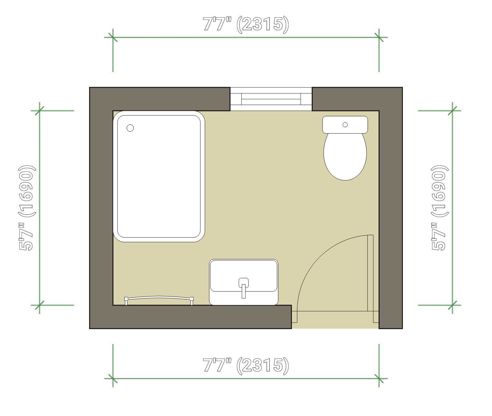

FuerteStu Posted May 11, 2025 Posted May 11, 2025 Starting my upstairs shower room and toilet.. Blank canvas. I've already got a layout that works, what I'm asking for are any tips and 'things that went wrong' or 'we wish we had'. Relatively small budget, expecting most of it to go on tiles to improve the 'look'. Maybe I'm just over thinking it, but thought I'd post in case anyone had any advice. It's in a timber frame loft conversion, pozi joists floor and ceiling. one external wall. My plans are roughly. Marine ply floor tanked, tiled. Tanked Tile backer walls, tiled. Centrally placed 4" humidity sensitive extractor, flexi to wall in ceiling. Tall Towel rad next to shower. Soil stack exits top right next to WC.

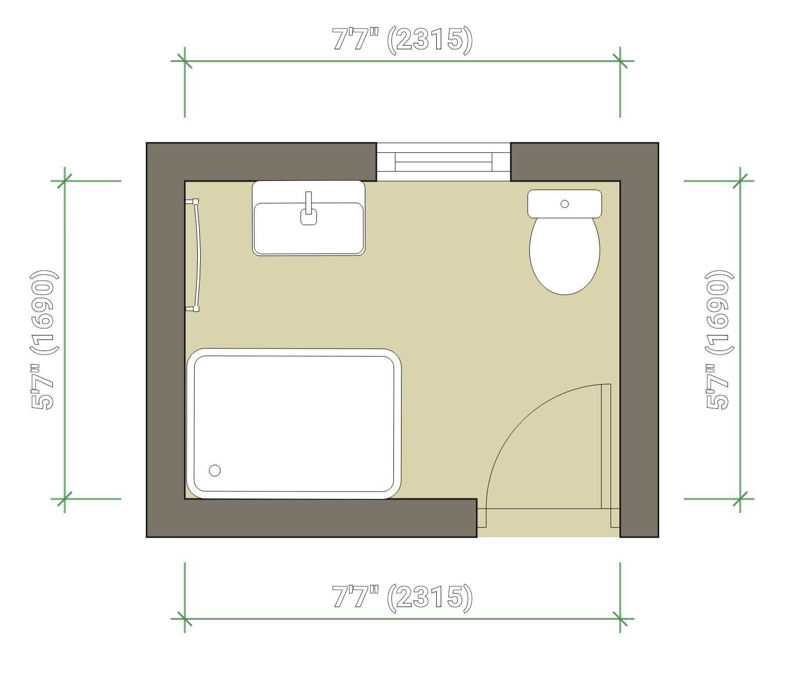

Mr Punter Posted May 11, 2025 Posted May 11, 2025 Is this a wet room? The sink and shower are very close. Maybe move and rotate the shower:

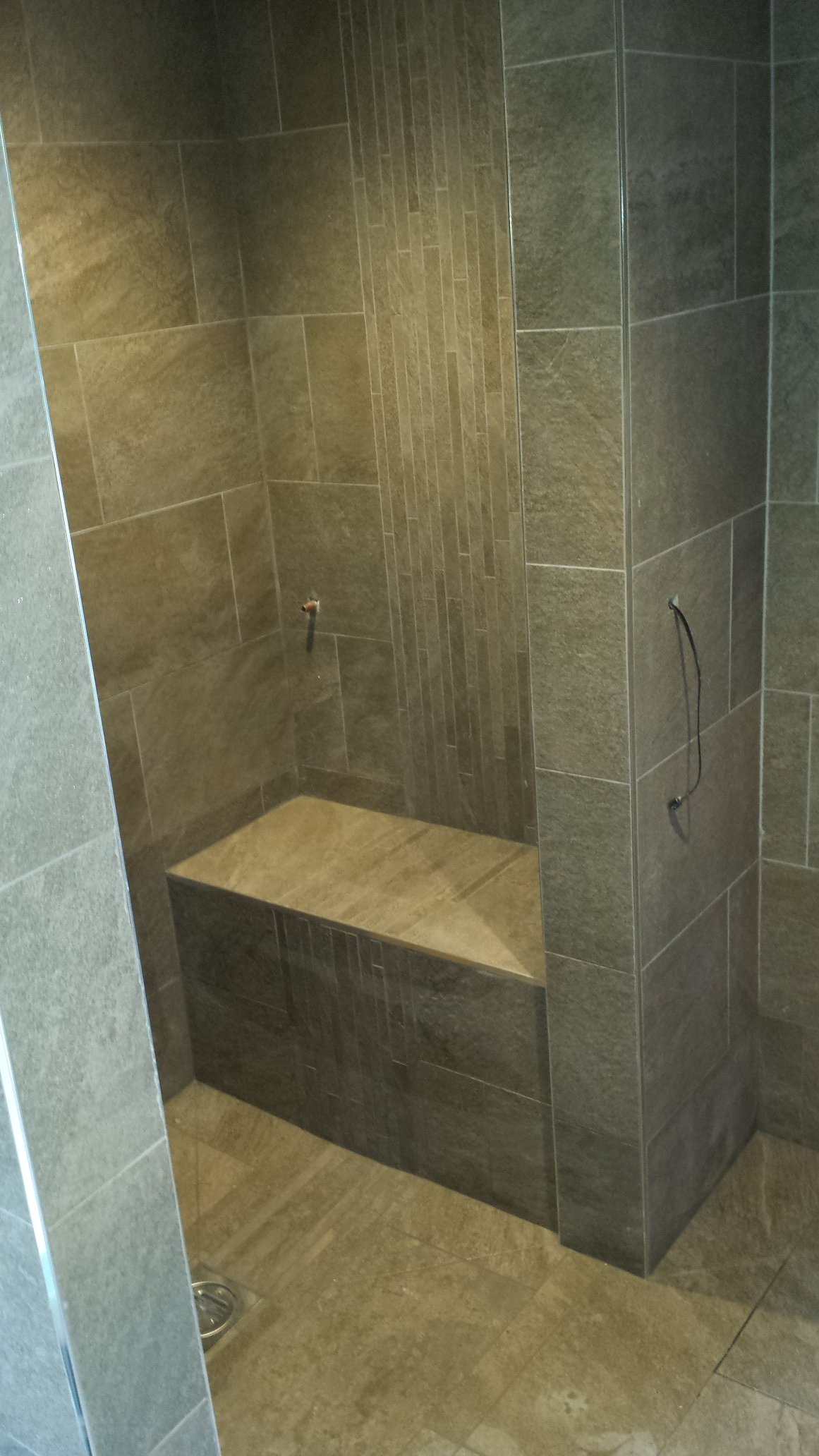

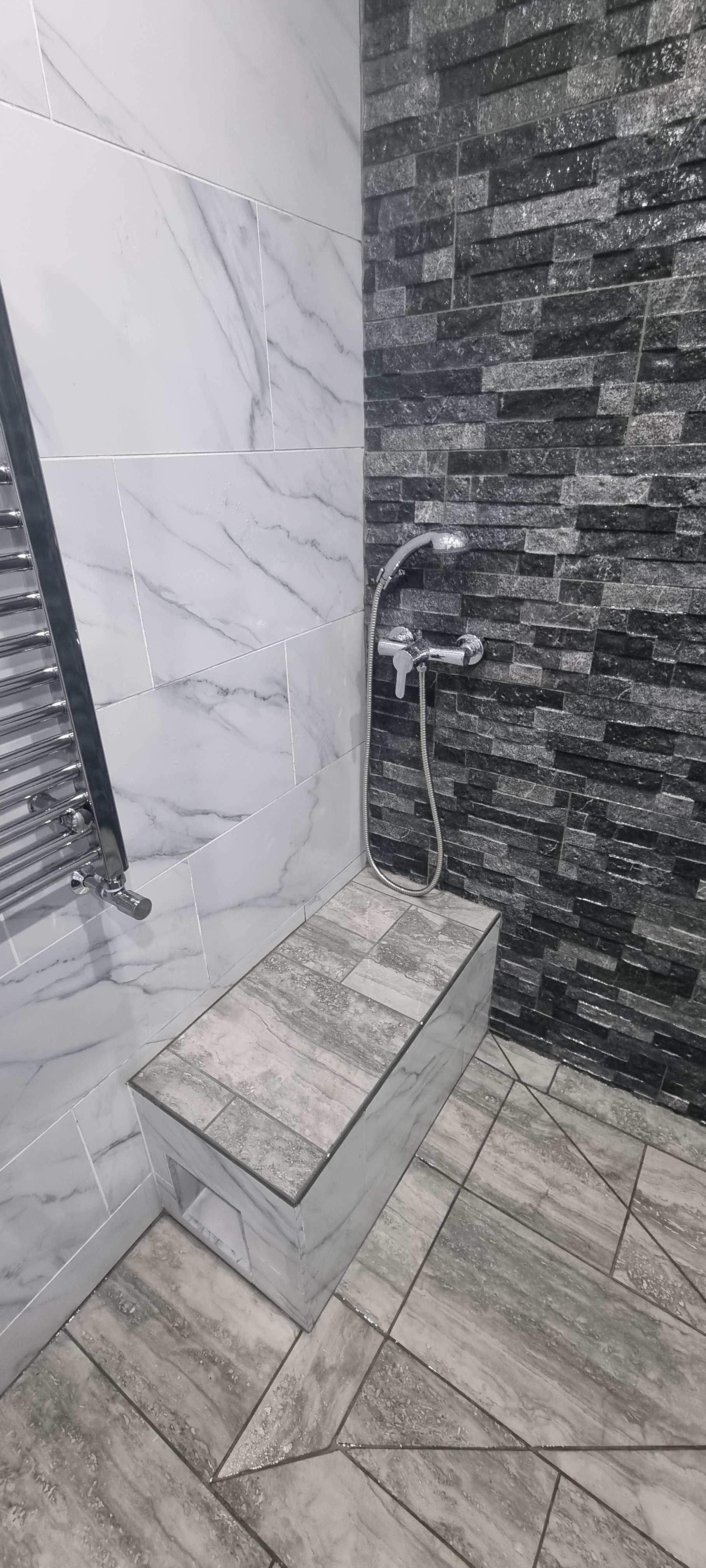

FuerteStu Posted May 11, 2025 Author Posted May 11, 2025 I'm borderline on going full wet room, it just having a large shower tray with half screen. There was the possibility of having a bench seat built into the wall next to the shower (for hair washing, leg shaving etc..) like the third picture..

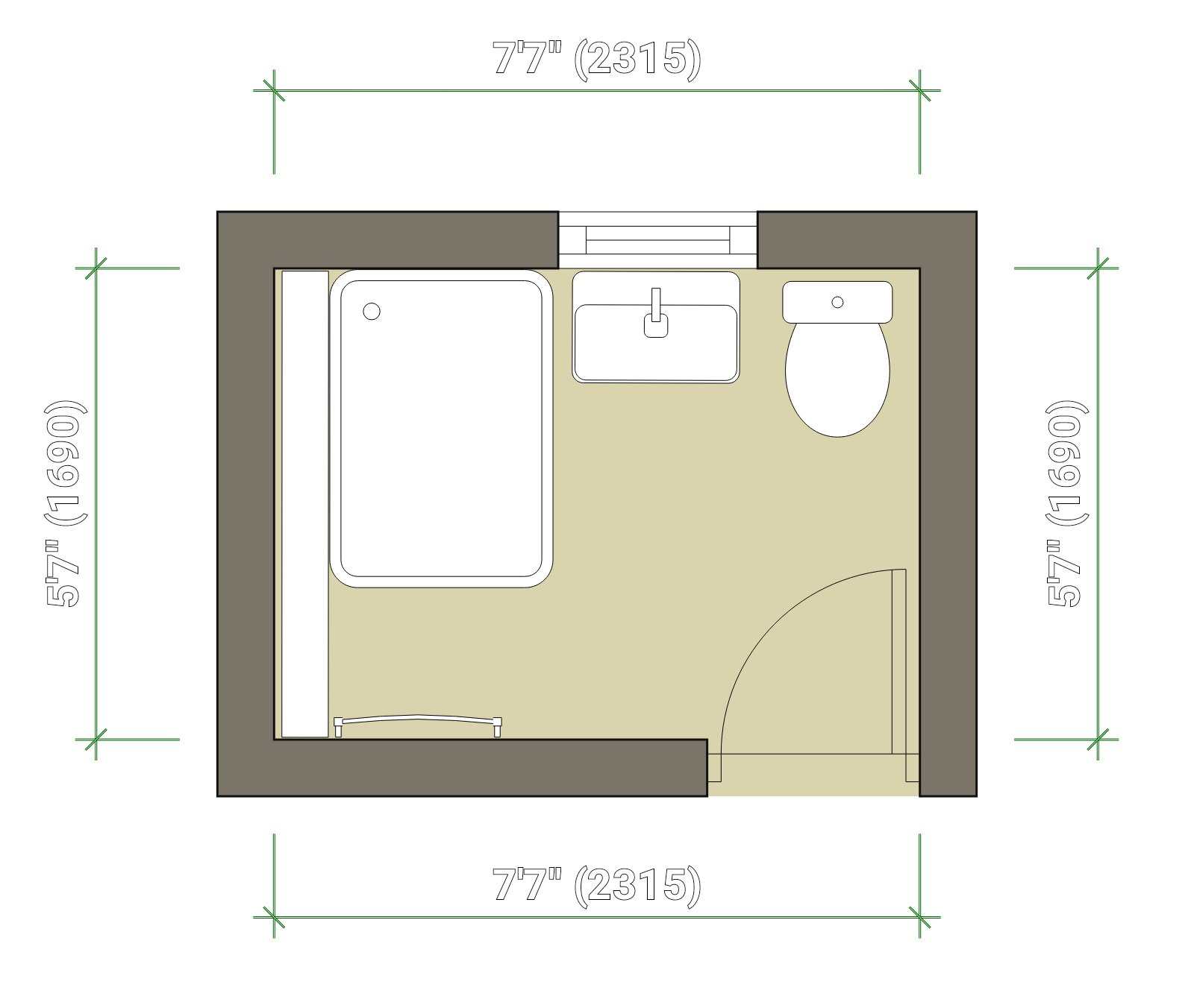

Gow Posted May 11, 2025 Posted May 11, 2025 (edited) Where the towel rail is in the first plan above would it be possible to put the sink there and perhaps turn the toilet 90 degrees to face the sink rather than face the door? Edited May 11, 2025 by Gow

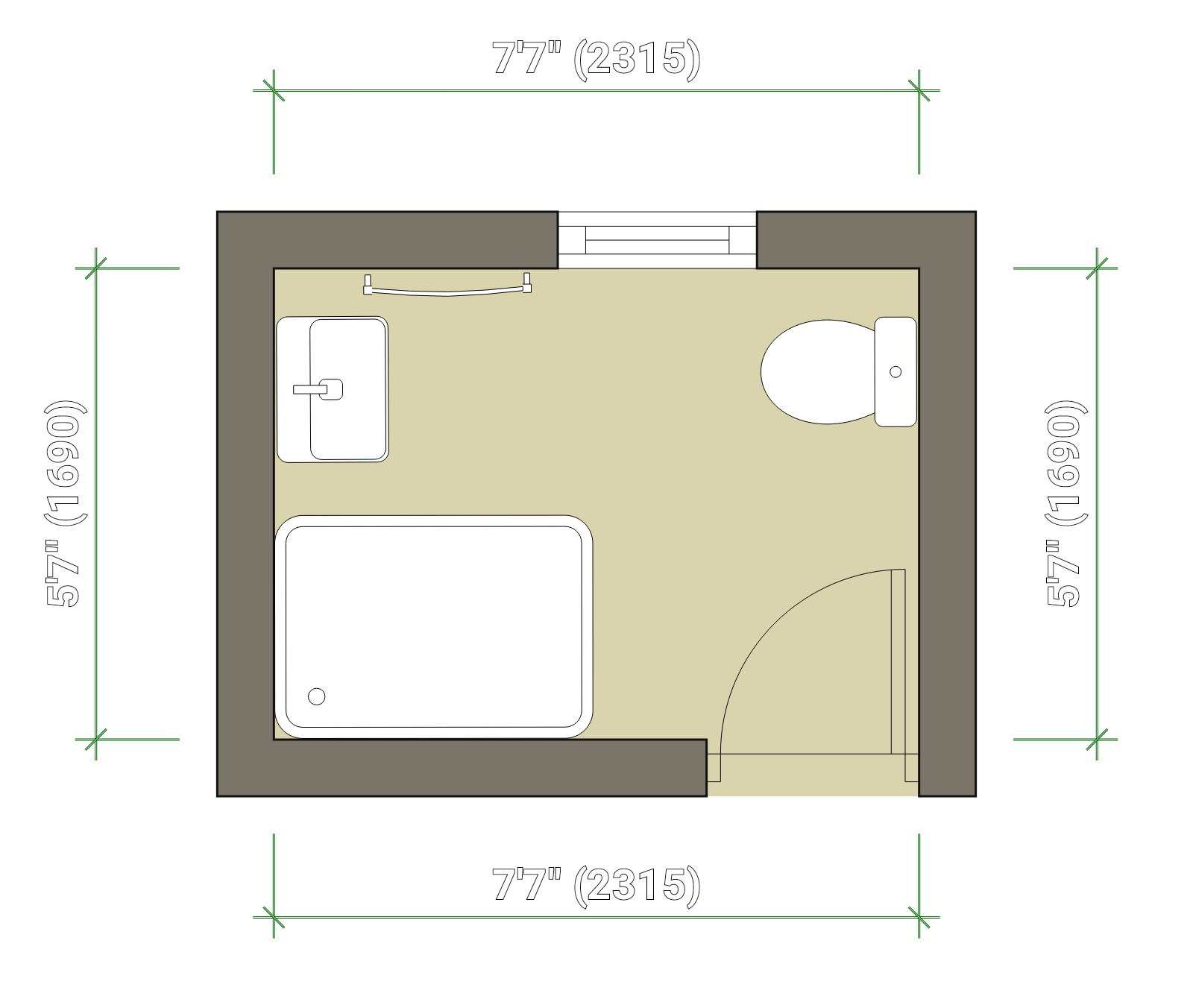

FuerteStu Posted May 11, 2025 Author Posted May 11, 2025 9 minutes ago, Gow said: Where the towel rail is in the first plan above would it be possible to put the sink there and perhaps turn the toilet 90 degrees to face the sink rather than face the door? Like this? Feels strange to be seated on the throne and not facing a door.. Its that unnatural?

Gow Posted May 11, 2025 Posted May 11, 2025 2 hours ago, FuerteStu said: Like this? Feels strange to be seated on the throne and not facing a door.. Its that unnatural? 👍

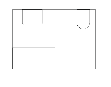

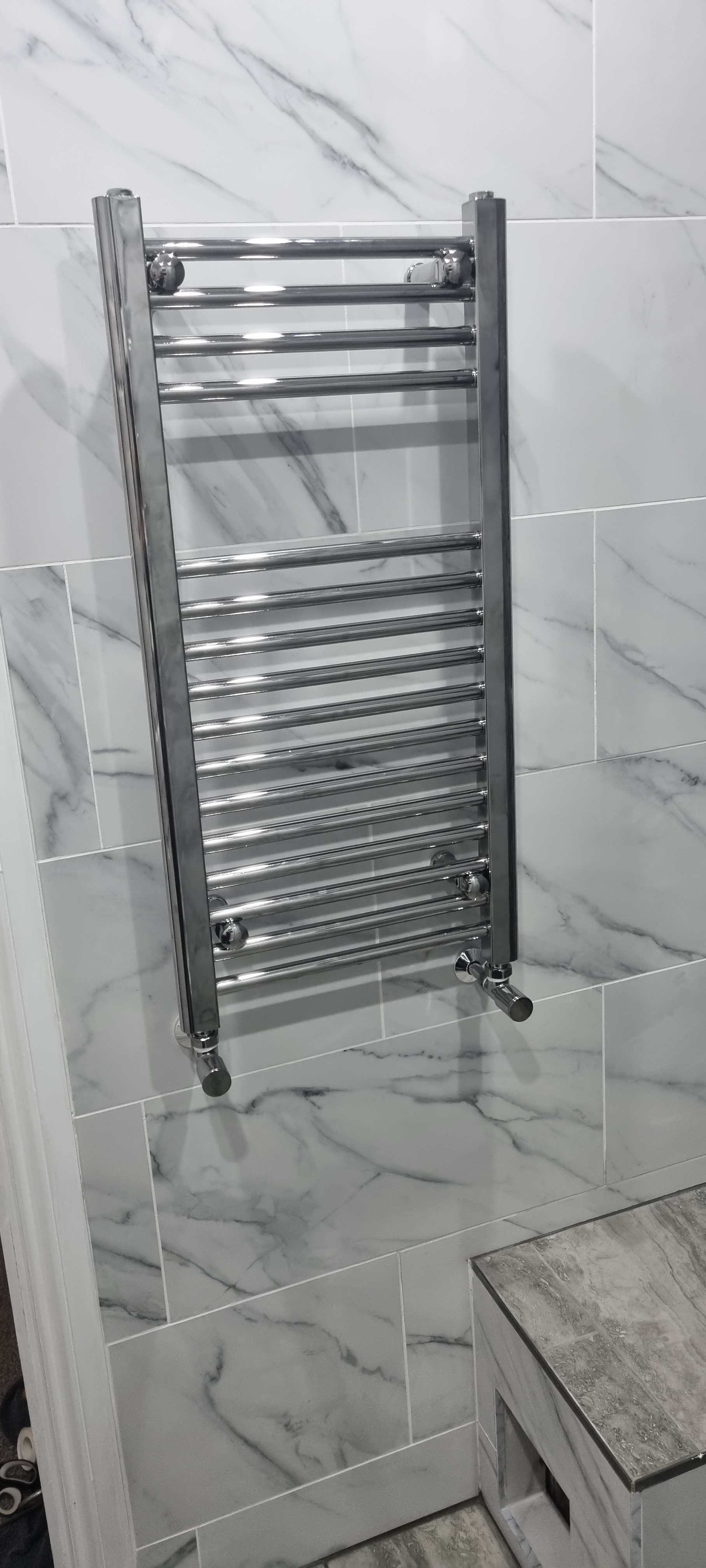

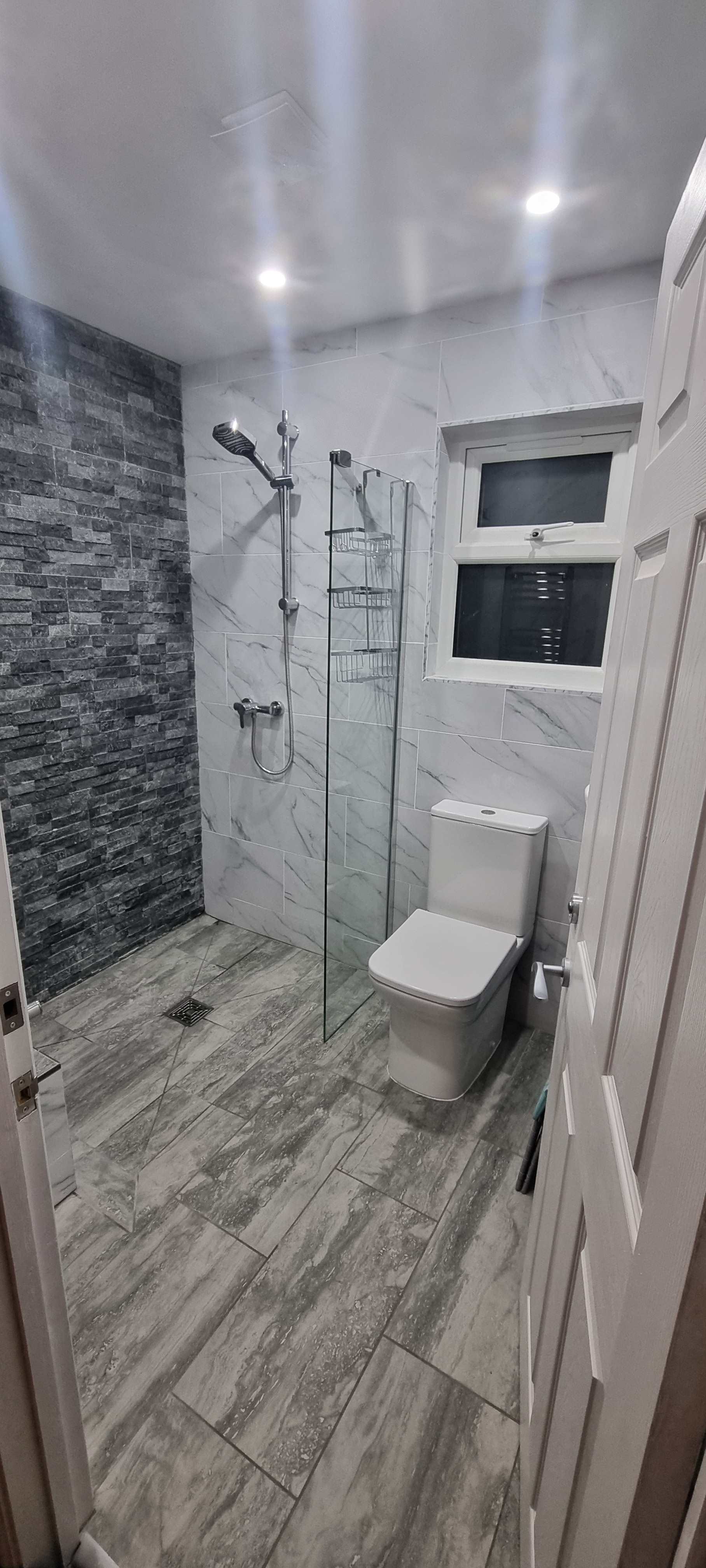

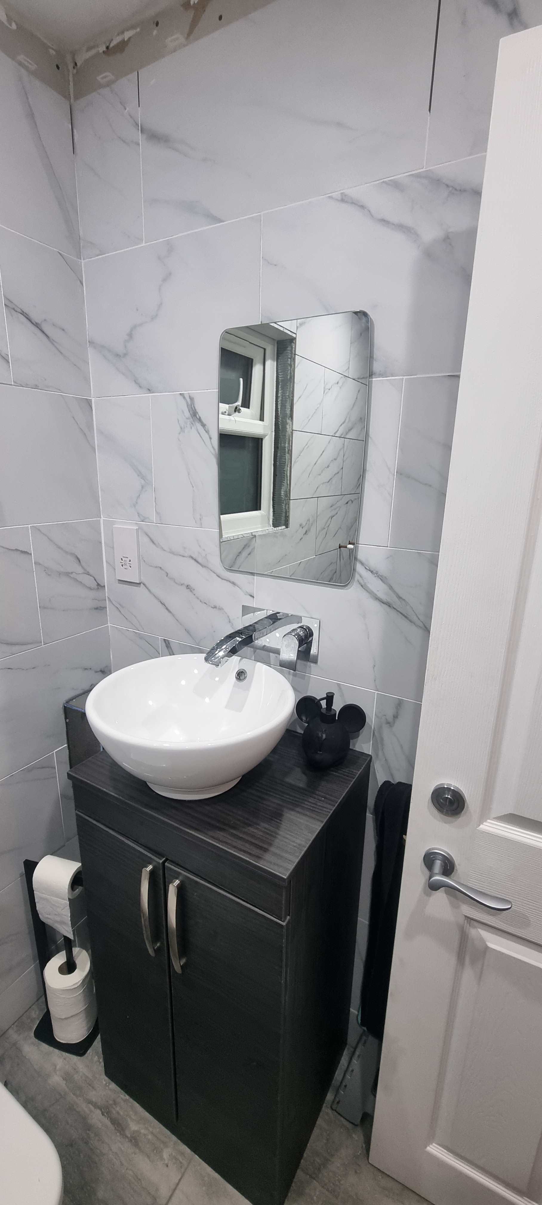

FuerteStu Posted Sunday at 15:19 Author Posted Sunday at 15:19 Just an update on this guys. Thanks for all your inputs, but In the end the chief decided the layout and I had to make it work. Featuring bench seat with separate shower valve for hair wash, leg shaving, and pet wash (includes children)
