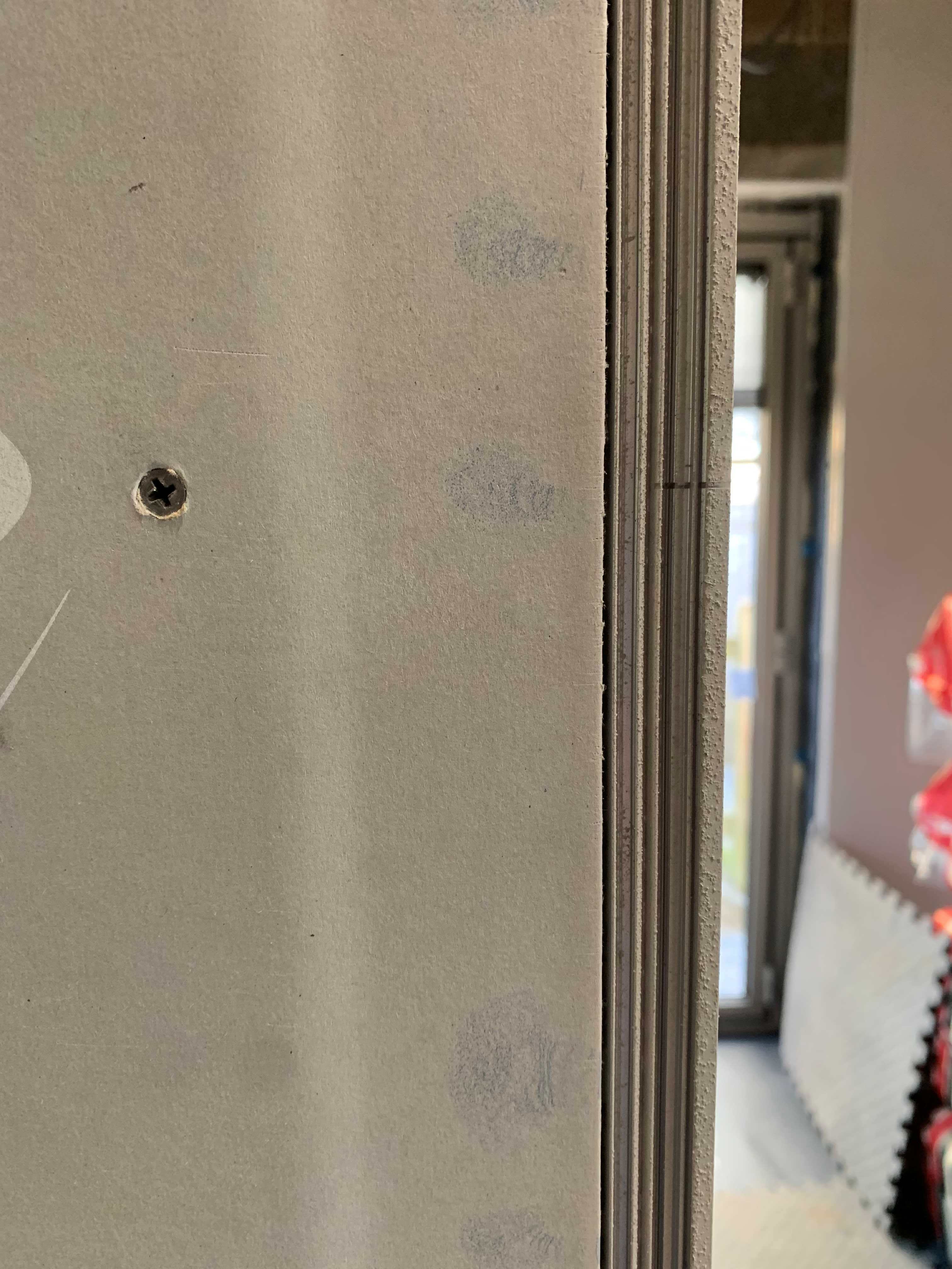

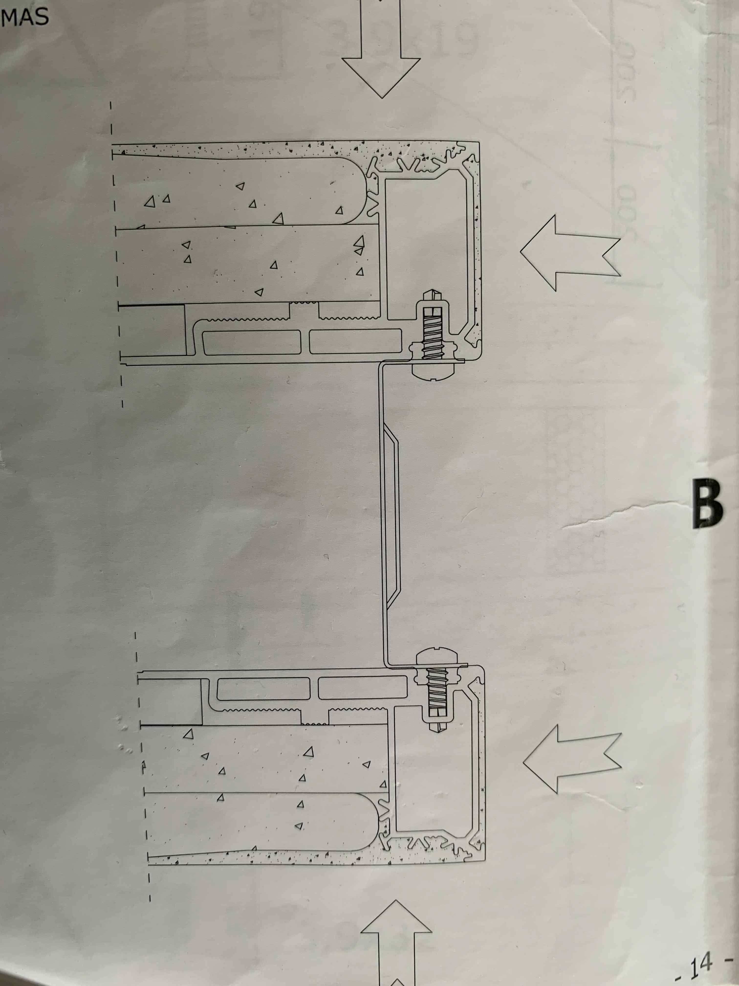

Spinny Posted May 10, 2025 Posted May 10, 2025 (edited) We have an a Elisse pocket door opening installed for our utility room. This was chosen in order to create an opening in the wall without any architrave but with a pocket door - a clean contemporary look. The pocket door metal framework from Eclisse has a plastering bead built in at the corner of the opening to support this look with plastered corners to the opening. It also has suitable roughened areas in the reveal inside the opening to allow plastering right around the corners and up to the slot where the pocket door runs. . However I now discover that this is positioned by Eclisse to support jointing and taping the plasterboard to a finish ! However we want and need to skim plaster onto our plasterboard and hence up to the corner of the pocket door opening. Hence it seems the built in metal plaster bead is not in the correct position to support this as it is level with the plasterboard rather than slighty proud of it by 3mm to support the skim coat. So, how do I solve this ? How much plaster can cover a corner bead when skimming a wall - can the plaster bead be 3mm deep beneath the plaster at the corner ? Or will it just chip and flake off ? Could some special reinforced plaster be used in the corner area and blended into the rest of the wall skim ? Could some small 2-3mm corner bead be fixed/glued onto the eclisse metal frame at the corner ? Anybody with experience of installing pocket doors without architrave ? Edited May 10, 2025 by Spinny
Temp Posted May 10, 2025 Posted May 10, 2025 I'm not a plasterer but perhaps these would reinforce the corner.. Skim coat bead.. https://www.profilestore.co.uk/c/render-plaster-bead/thin-coat-hook-on-bead Corner tape, not sure how strong... https://www.screwfix.com/p/diall-reinforced-corner-jointing-tape-white-30m-x-50mm/981CF?tc=UT2&gad_source=1&gad_campaignid=19823510542&gbraid=0AAAAAD8IdPxgoUiqaNEyp2UQAKsiCamHx&gclid=Cj0KCQjw8vvABhCcARIsAOCfwwpR9074scYSb2Y_pj_lW2CO_Ww-QYDxvjZiI5O48eAA1xb3HK5fWysaAh6KEALw_wcB&gclsrc=aw.ds

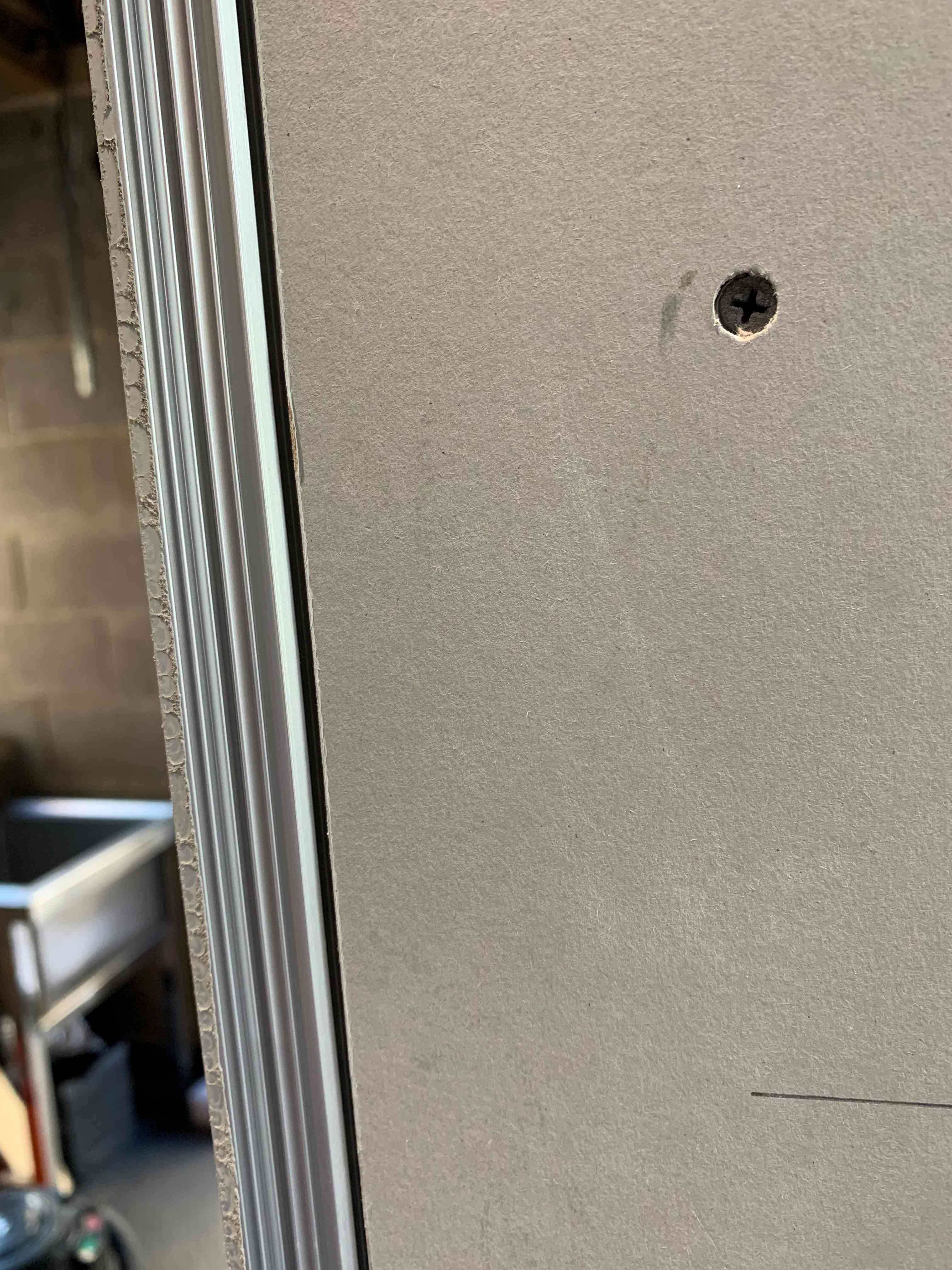

Spinny Posted May 10, 2025 Author Posted May 10, 2025 uh oh. Just looked at what is built to post a photo. Now I discover the whole bl***y wall and frame is not even true on one side of the opening. One side the tapered edge of a piece of plasterboard is flush with the edge of the pocket door metal edge, exactly as per the installation diagram. However that vertical edge is not perfectly vertical, it lays slightly backward at an angle as you go up from floor to top by a few mm, the adjacent plasterboard fixed to the metal studs of the pocket also runs the same way. So I guess the whole of the pocket side of the frame is slightly layed back from true vertical. Meanwhile on the other side of the opening, as in the last photo an untapered edge of the plasterboard is recessed w.r.t. the edge of the vertical metal frame. The metal frame on this side, the closing side, is fixed at a true vertical, and the wall also runs at a true vertical on this side of the opening. The other side of the wall is currently not boarded, but if it were the plasterboard would clearly show discrepencies on that side too. So the carpenter has installed the metal stud pocket and the surrounding timber studwork too presumably - on the wonk and out of true. And seemingly displaced in some way from the other side of the door opening. It is only 'a few mm' out - dunno 3-4mm out, but it is out. He must have known this when it was done. Presumably he has frigged it in some way, rather than adjust surrounding timber studs, to make it look ok to casual observation. Presumably didn't want to tell the builder there was a discrepency, or told the builder who told him to botch it. More dishonesty. P**** o** again. What do I do now ? Pay another carpenter to rip it all out and presumably botch it again ? Would they do it in their own houses ?
