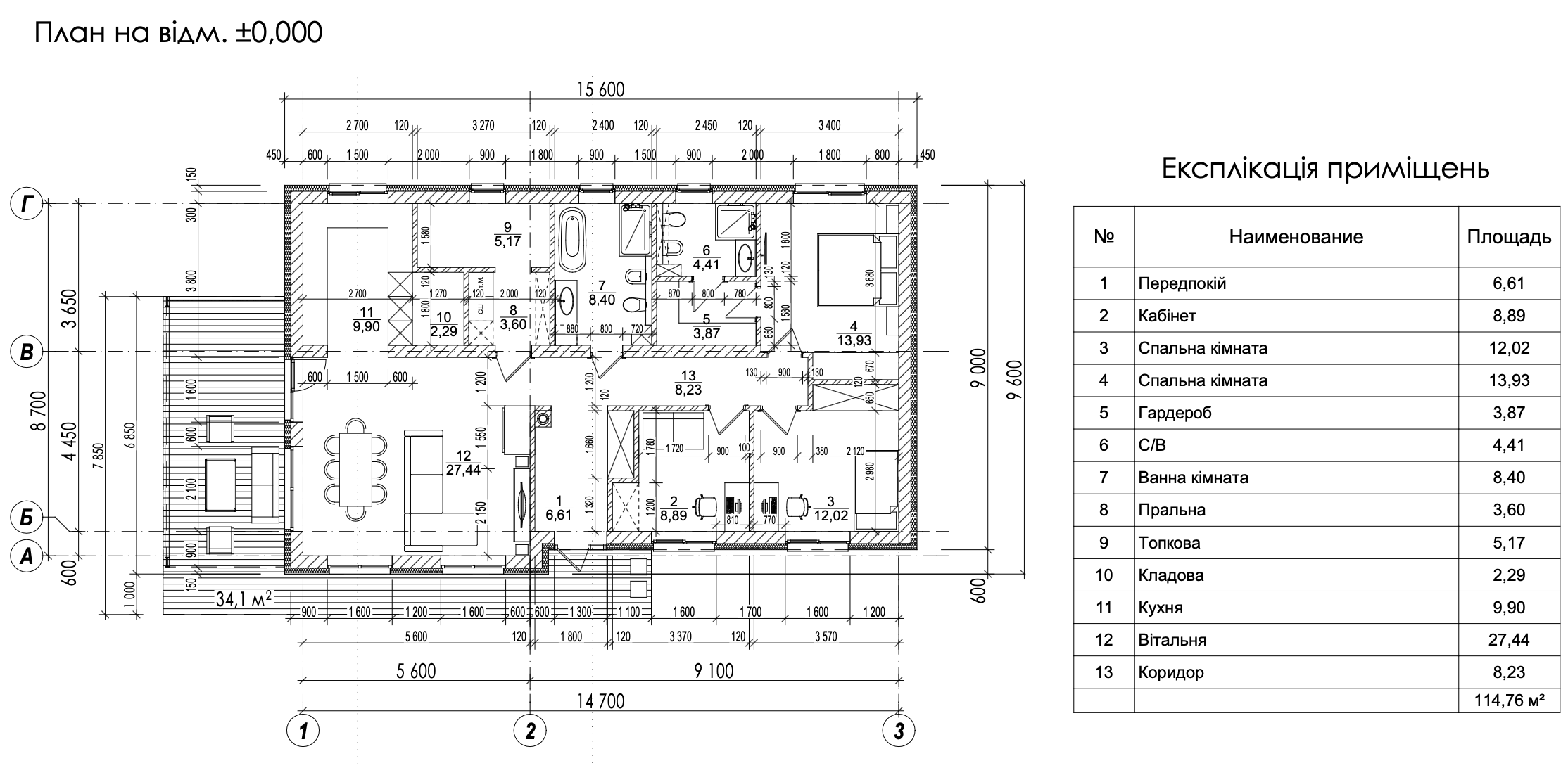

Vugarh Posted yesterday at 10:30 Author Posted yesterday at 10:30 (edited) This is my plan Please criticize and suggest your ideas 1 Hallway - 6.61 2 Study - 8.89 3 Bedroom 12.02 4 Bedroom 13.93 5 Wardrobe 3.87 6 W/C 4.41 7 Bathroom 8.40 8 Laundry 3.60 9 Furnace 5.17 10 Pantry 2.29 11 Kitchen 9.90 12 Living room 27.44 13 Corridor 8.23 114.76 m2 Edited yesterday at 10:41 by Vugarh
LDNRennovation Posted 21 hours ago Posted 21 hours ago I don’t really like the flow of your kitchen, it’s being treated as another utility area and not the star of your house. You spend a lot of money and time there, it should feel more open and less boxy. How about you take some space of your furnace, and open that area up? I also think your dining are is in the way and will always annoy you there - it doesn’t look spacious to me. Also, it’s nicer to have something at the end of a corridor rather than a blank wall. 1
