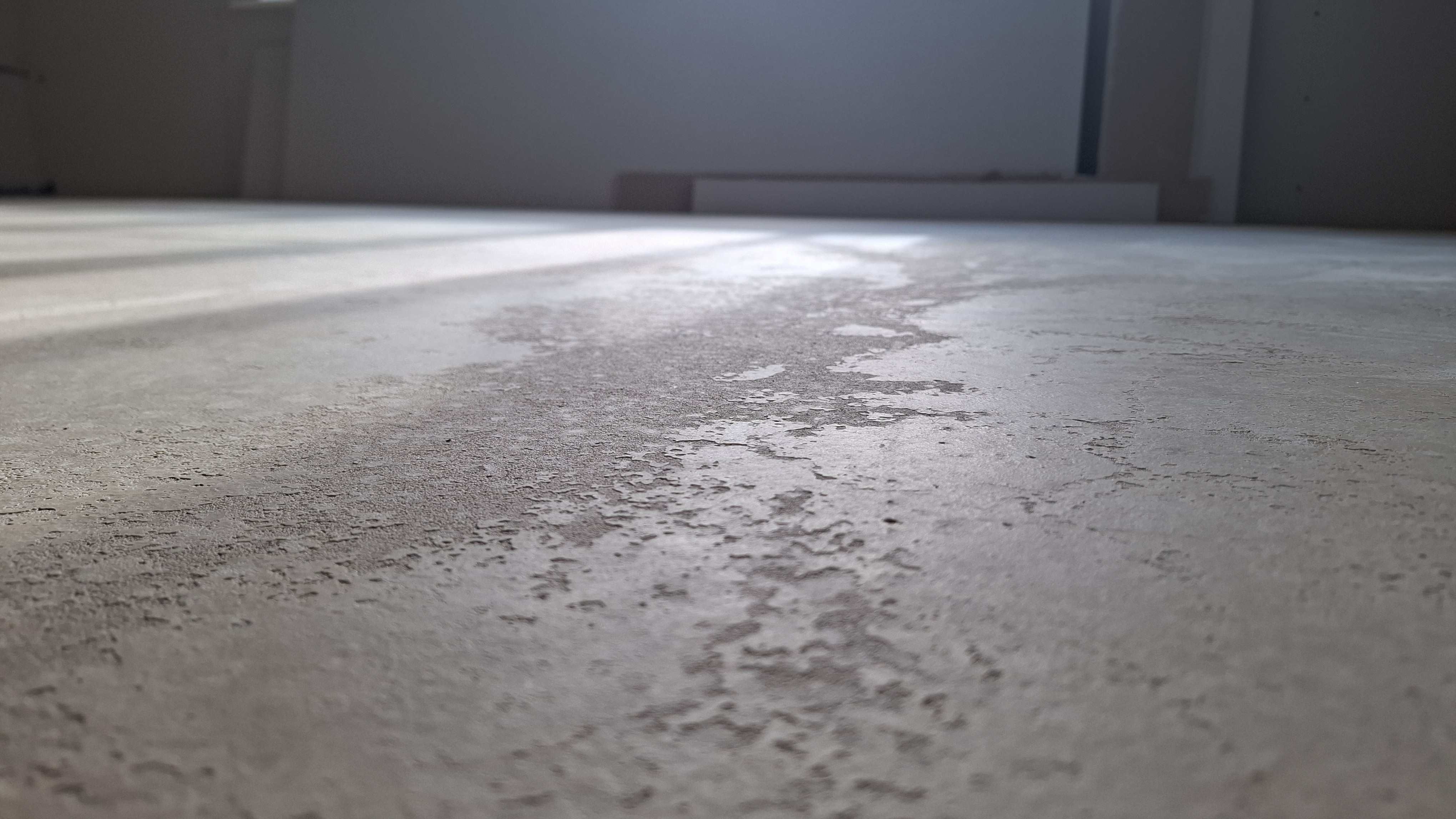

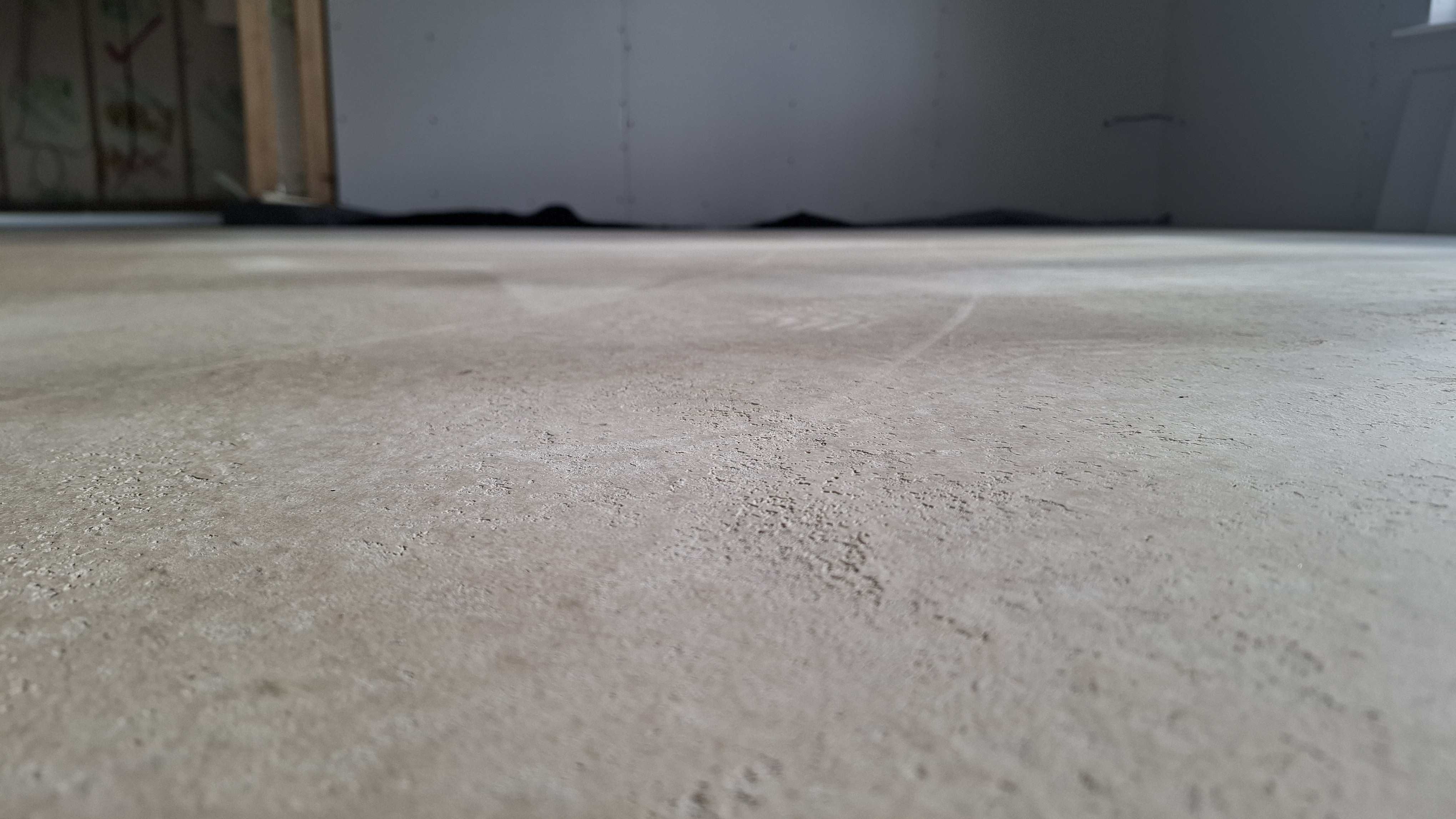

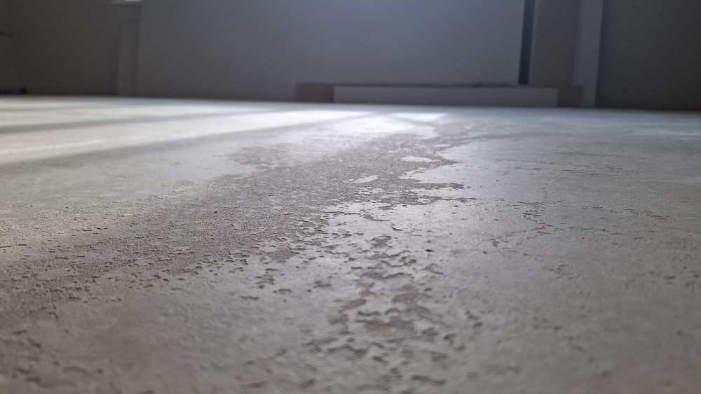

Post and beam Posted May 8, 2025 Author Posted May 8, 2025 Yes Anhydrite of some variant. I basically scrubbed until the amount of dust being given of reduced to almost zero. I hope thats good enough.
Nickfromwales Posted May 8, 2025 Posted May 8, 2025 That looks a bit like you've removed loose stuff and polished the stubborn residue? Have you tried a scraper on that polished bit vs where it appears 'matt'?
nod Posted May 8, 2025 Posted May 8, 2025 2 hours ago, Post and beam said: Yes Anhydrite of some variant. I basically scrubbed until the amount of dust being given of reduced to almost zero. I hope thats good enough. Don’t overthink I tile dozens of these each month Quick scrape Then brush up Seal with diluted SBR
Post and beam Posted May 8, 2025 Author Posted May 8, 2025 1 hour ago, Nickfromwales said: That looks a bit like you've removed loose stuff and polished the stubborn residue? Have you tried a scraper on that polished bit vs where it appears 'matt'? No scraper yet but i will pick one up tomorrow. To be honest the rotary thing has a mind of its own anyway.
Nickfromwales Posted May 8, 2025 Posted May 8, 2025 Just now, Post and beam said: No scraper yet but I will pick one up tomorrow. To be honest the rotary thing has a mind of its own anyway. Not sure how aggressive the pad you used was, but it looks like you may need to up your game a bit Looks like a bit of the laitence is still there, but that's not easy to tell from these pics obvs.

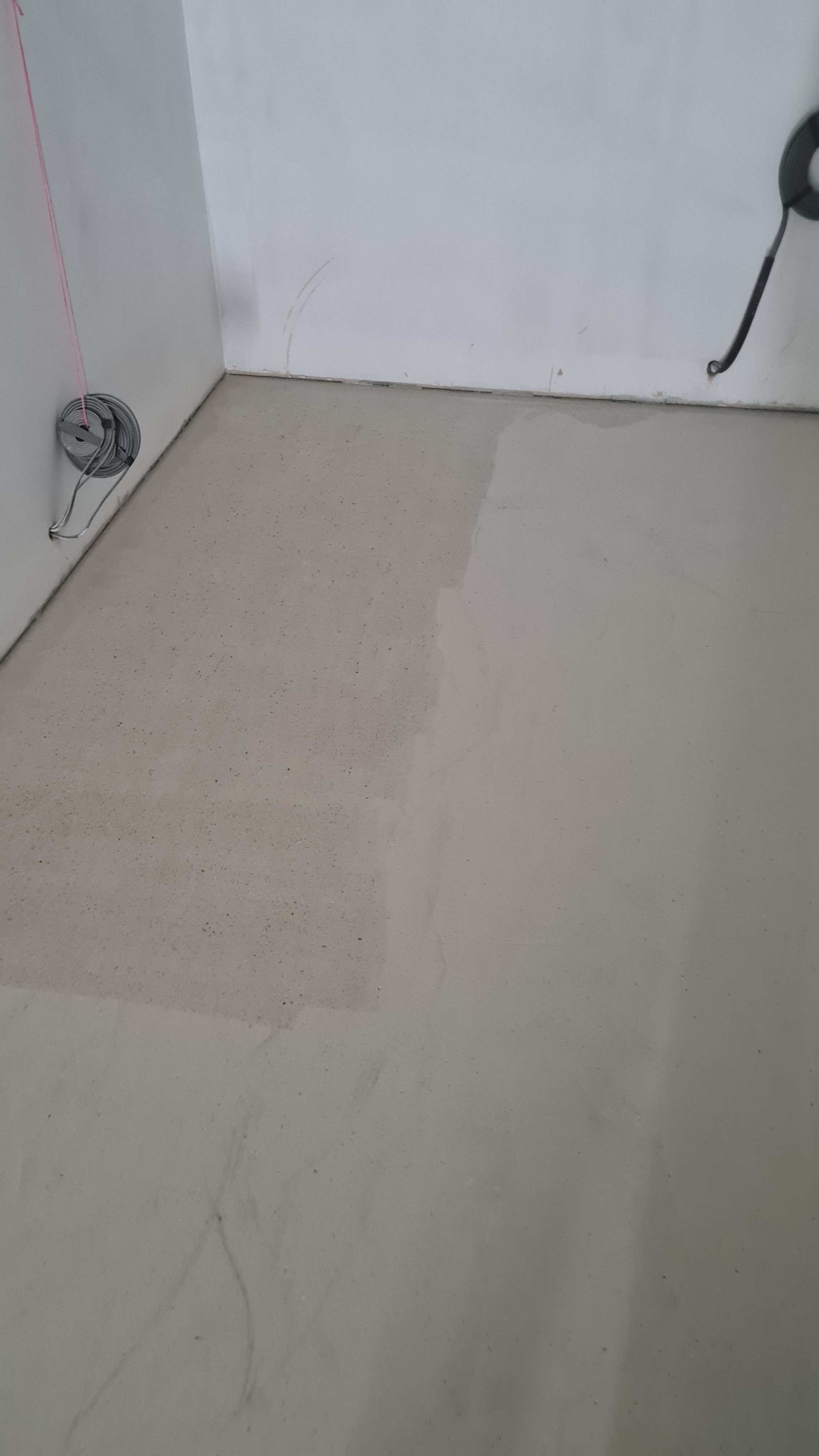

Barnboy Posted May 8, 2025 Posted May 8, 2025 This is my anhydrite screed after I'd taken a floor grinder to it and started hoovering after 3 rounds of sweeping. If you zoom in on the hoovered patch you can see that the aggregate has become visible and looks more open.
Post and beam Posted May 8, 2025 Author Posted May 8, 2025 In case my scraper does not do the trick tomorrow would you indicate exactly what floor grinder you used please
Barnboy Posted May 9, 2025 Posted May 9, 2025 https://images.app.goo.gl/uKd67 The one I hired was the same as this link, it had a disc of cutters rather than individual stone like the Husqvarna I've used before which was a handfull and nowhere near as clean finish as this one was.
