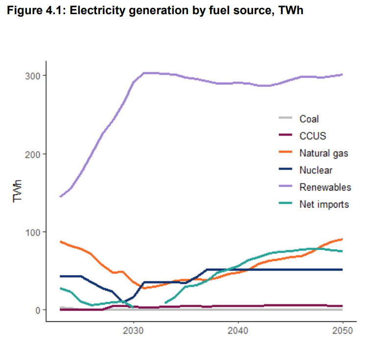

MikeSharp01 Posted May 7, 2025 Posted May 7, 2025 https://www.bbc.co.uk/news/articles/ce848g8l8vro Looks like we won't get this wind farm after all. While I heard again today that the only way to get cheaper electricity is to get away from fossil fuels and I recall that graph referred to last week, https://assets.publishing.service.gov.uk/media/675c0ca798302e574b915336/eep-report-2023-2050.pdf, that says we will still be using gas in 2050! How can we square this circle.

MikeSharp01 Posted May 8, 2025 Author Posted May 8, 2025 It looks like something has got to give as things are unsustainable. That report from Mr Milibands department in December clearly shows that we will still be burning as much gas as we are today although as a smaller proportion of overall generation. So it follows that gas will still set the price unless it is delinked from doing so. Given we assume that the department knows what it is doing the calculation must be that at some point the link will need to be broken by some means as yet unknown. This brings us back to what @SteamyTea says might be a tactic in the minds of the windfarm builders to push this date back so they can make hay while the wind blows.

MikeSharp01 Posted May 8, 2025 Author Posted May 8, 2025 Time we started a bit of gentle lobbying perhaps. Here is a note I have just sent to the BBC Today programme to ask them to ask an appropriate minister. "Here is a question you might like ask of an appropriate minister if they continue to say that the only route to cheaper electricity is to increase renewable generation. While I agree we should be increasing renewable generation there is a problem lurking at the core of this statement from government. The chart above is from this document (https://assets.publishing.service.gov.uk/media/675c0ca798302e574b915336/eep-report-2023-2050.pdf) published in December 2024 by Ed Miliband's department. It clearly shows that we will be using as much gas in 2050 as we are using now to generate electricity despite a massive increase in renewables. This means that unless the link between the gas price and the electricity price is broken the price for electricity will still be set by Gas. How does the minister square this circle? If we are going to delink why don't we do it now - perhaps it is because the renewable generators are getting a great price for their electricity. If we are not delinking how will the electricity prices not be tied back to a fossil fuel with all that entails. " Let's see if anything comes of it. 1
ProDave Posted May 8, 2025 Posted May 8, 2025 ^^^ Oh GOOD. In just 5 years, we are going to stop building ANY more wind farms. We just have to fight off the proposals until then. By which time the amount of renewables generated will flatten out. Planning to get roughly 1/4 of your electricity from "imports" in the long term seems a bad plan for energy security. 1
