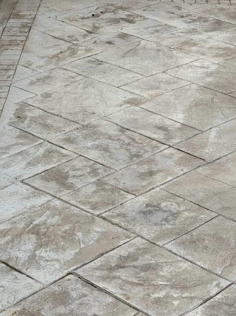

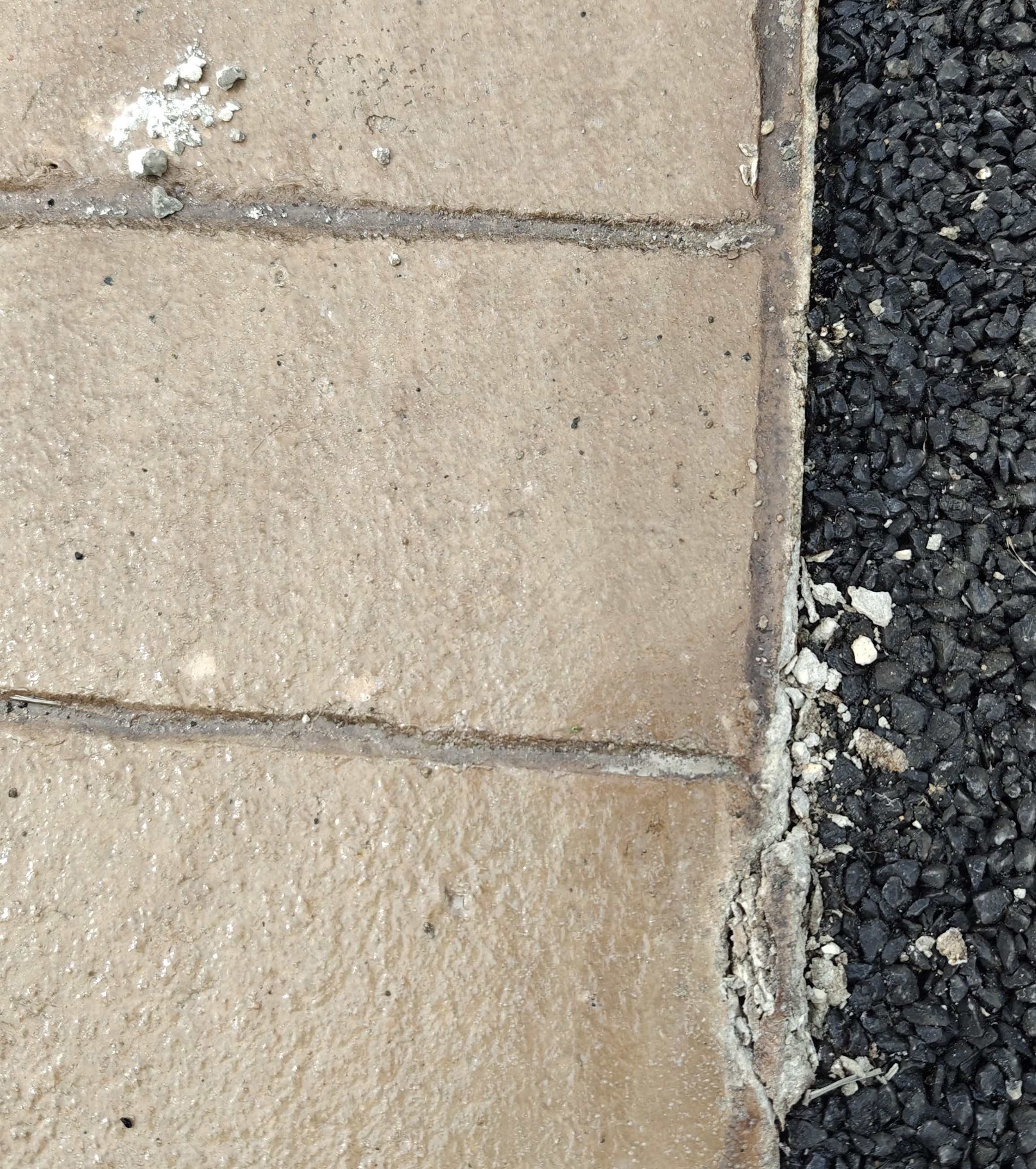

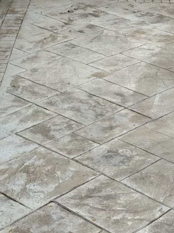

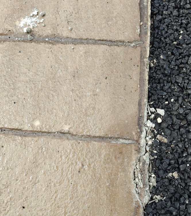

diyenthusiat Posted Monday at 19:02 Author Posted Monday at 19:02 Thanks for your help guys. So below is what it looks like right now. The first photo shows the colour being washed out and you'll notice the tile pattern missing from some locations. The second photo show the concrete has broken at the edge after a vehicle was driven onto it,
Andehh Posted Monday at 19:09 Posted Monday at 19:09 Have you tried digging at the edges to see how deep the sub layers are? That edge cracking isn't as bad as I assumed when you described it!
diyenthusiat Posted Monday at 19:25 Author Posted Monday at 19:25 12 minutes ago, Andehh said: Have you tried digging at the edges to see how deep the sub layers are? That edge cracking isn't as bad as I assumed when you described it! Sorry when you say sublayers what you mean? What I can tell you is that the concrete is 4 inches thick in most places.... definitely not less than 2-3 inches in the least areas. Below the concrete there is MOT type 1 hardcore which has been wackered down. The original ground is clay. Hope this better explains it
Onoff Posted Monday at 19:50 Posted Monday at 19:50 A mate got "conned" with imprinted concrete years ago. The firm sold it on the basis it could be applied down to I think 3mm thick and wouldn't crack due to "fibres". It came with a worthless X years guarantee. The job was crap. Looked good for about a week. Bits of it came unstuck from the original concrete underneath. No recourse to the cowboys who did it of course. When I did mine, above, the concrete was 3 or 4" thick with the pattern pressed into the top 1/2". 1
Andehh Posted Monday at 19:51 Posted Monday at 19:51 Just if it's possible to see how deep the MOT is. What was the original driveway surface? All I'm saying is if the ground was a compacted previous driveway, with mot whacked down well, then 4" of concrete... That's not an unreasonable light usage driveway from my amateur thinking. OK the colour has washed away, but concrete stain will hopefully resolve that. Just to try and offer some positive thoughts!
diyenthusiat Posted Monday at 21:41 Author Posted Monday at 21:41 1 hour ago, Andehh said: Just if it's possible to see how deep the MOT is. What was the original driveway surface? All I'm saying is if the ground was a compacted previous driveway, with mot whacked down well, then 4" of concrete... That's not an unreasonable light usage driveway from my amateur thinking. OK the colour has washed away, but concrete stain will hopefully resolve that. Just to try and offer some positive thoughts! Thanks! The MOT type 1 has large (3-4inches) and small rocks/gravel (1.5inches or less with some sand - Couldn't give you the exact dimensions though. There was no original driveway. It was just clay and I was planning to return and do it up into a driveway. The MOT type 1 was put down and wackered by previous builders around a month before the imprinted concrete was done.
