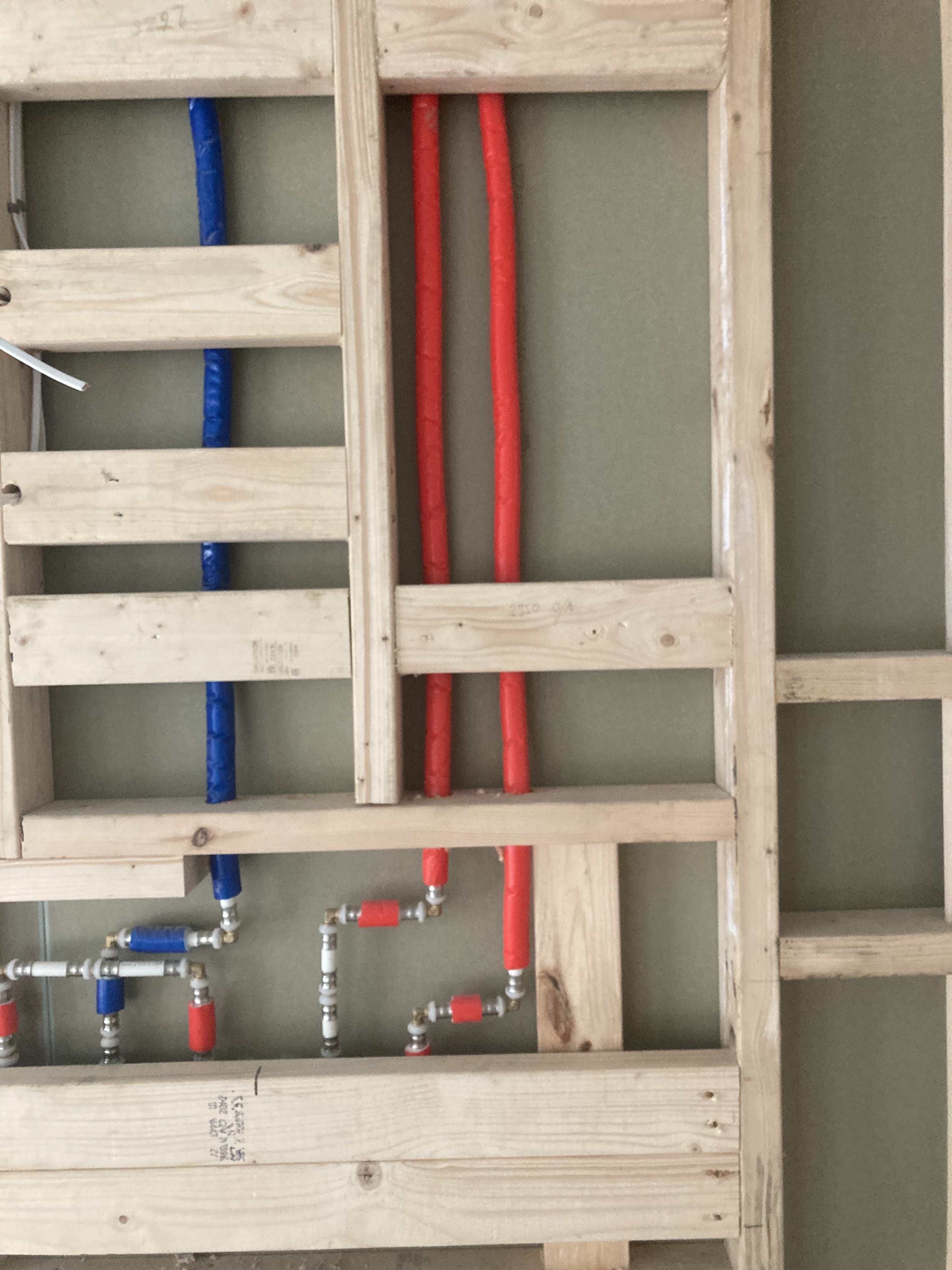

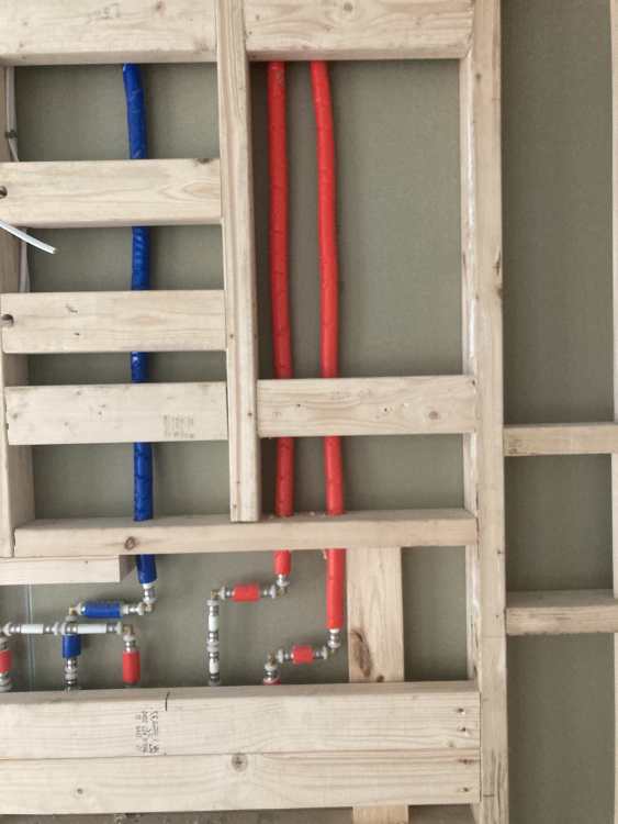

nod Posted April 24 Posted April 24 2 hours ago, saveasteading said: What are "these"? Pipes that come with the insulation on Every pipe in the house is ready insulated Saves time
Nickfromwales Posted April 24 Posted April 24 2 hours ago, nod said: Pipes that come with the insulation on Every pipe in the house is ready insulated Saves time Same we do with the MVHR ducts where we heat / cool (temper) the airflow to rooms. TBH I don't insulate everything any more, so putting insulation on where needed afterwards seems the most cost-effective. I work out the lengths of the hot & HRC run, walk it out, insulate in and tape it up well, and them pull it in in one go; we use band or 50mm waste pipe clips around the insulation to fix it into place vs clipping the pipes and then having to stop/start the insulation.
