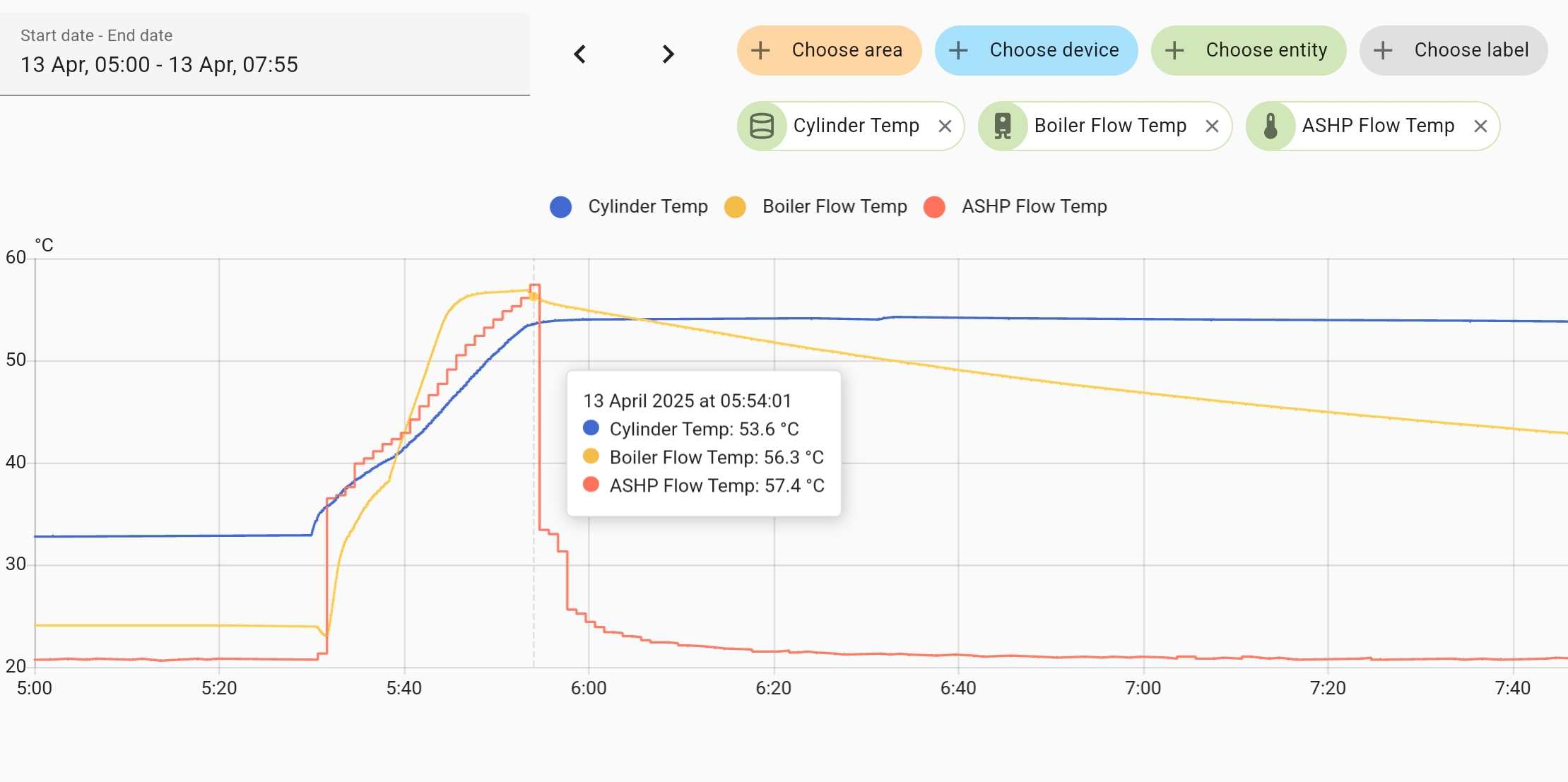

JohnMo Posted April 13, 2025 Posted April 13, 2025 Thought I would drop some information in to a stand-alone topic, about unvented cylinder (UVC) choice, be it for a heat pump or fossil fuel boiler. The normal advice from a plumber is to use gas/oil boiler specific UVC, when installing a fossil fuel boiler and a heat pump specific one for a heat pump. The primary difference is coil surface area, used to heat cylinder. However I would advise anyone to install only a heat pump specific cylinder, with any heat source. You generally get a huge 3m2 heating coil, which allows the cylinder to be hot without excessive boiler flow temperatures. This was mine this morning - running in hybrid mode (gas boiler and ASHP) Cylinder temp at 53 Deg, but more importantly the boiler flow temp was only 56 degs. This ensure good condensation while boiler is running for improved efficiency. Also if you are using S or Y plan heating schemes it allow a good reduction in flow for both central heating and you can have a hot cylinder. 3
ProDave Posted April 13, 2025 Posted April 13, 2025 If you cylinder is large enough you can improve on that by reducing your target temperature, ours is set to 48 degrees which is plenty. ASHP flow temperature set to 55 degrees max,
JohnMo Posted April 13, 2025 Author Posted April 13, 2025 14 minutes ago, ProDave said: If you cylinder is large enough you can improve on that by reducing your target temperature, ours is set to 48 degrees which is plenty. ASHP flow temperature set to 55 degrees max, Very true, ours is set a little high. Driven by wife's expectations of very hot water in the kitchen sink 1

JohnMo Posted April 13, 2025 Author Posted April 13, 2025 1 hour ago, G and J said: can’t work out if I need more than 200 litres We (2 off us) have 210L, 50% of the time it's heated once the other 50% twice a day. But currently, although heated this morning its been further heated to 68 degs via immersion (excess solar).
