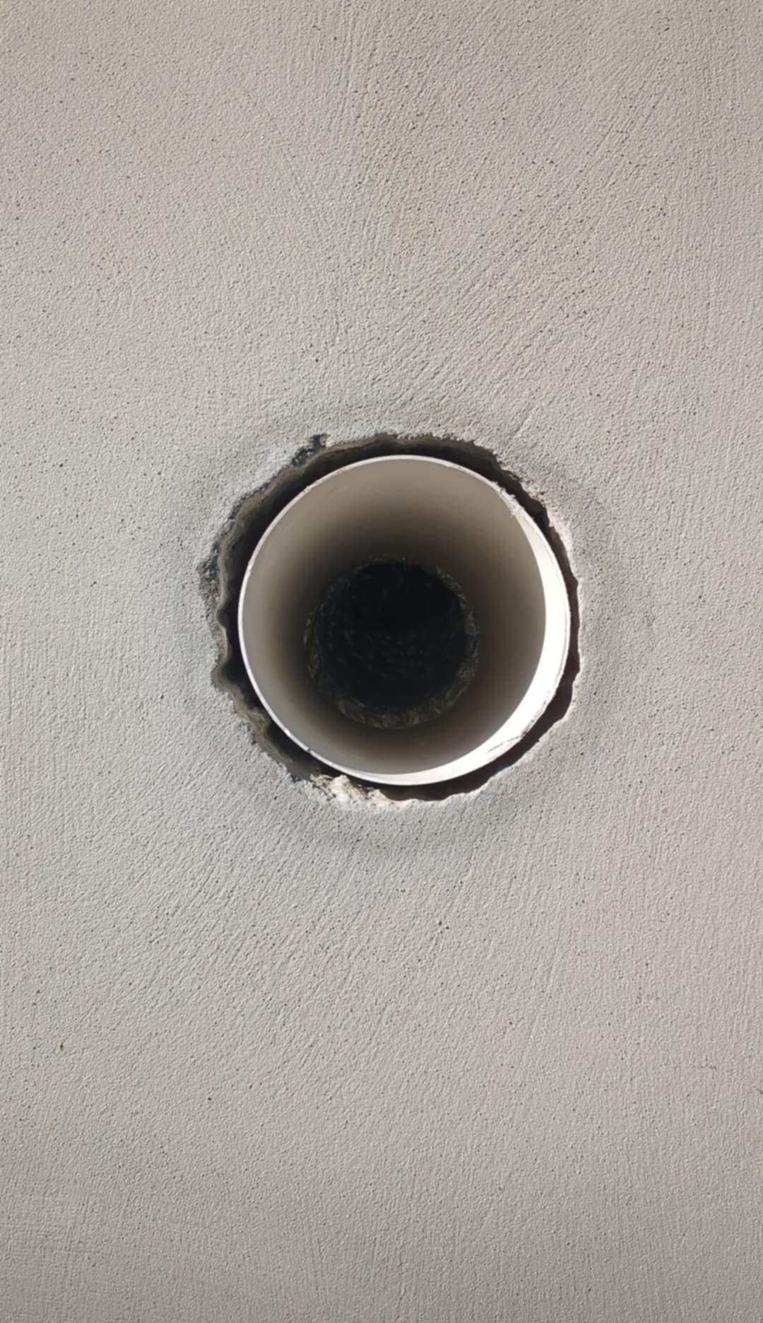

Hello again, we have a Vent-Axia Lo-Carbon Sentinel Kinetic B Plus and not sure what is the best vent to put outside?
Just choose one to suit your needs.
My choice will not be yours.
just be mindful that some have quite a fine mesh grille that you'll need to access and clean, if you don't remove it beforehand...
Make sure the vent you choose has at least the same flow area that the pipe has. It's a bad idea to restrict in any way the air flow into the unit. The main restrictions can be 90 degree bends, which slow the air flow, and/or insect screens, which reduce the area.
The basic grilles are flat with louvred slots, but we fit a lot of the ones that project a little, with a boxed section, and the outlet faces down and out at an angle. These seem to suffer less from windy days etc, but it may not be an issue if the elevation here isn’t hammered by weather.
Is that duct running downhill to meet the outside wall? If not then I’d suggest not going for the 1st option I mention as wind-driven rain can get in there.
Also, get some CT1 / other non-silicone sealant and seal around the duct before fitting the grilles ;)
