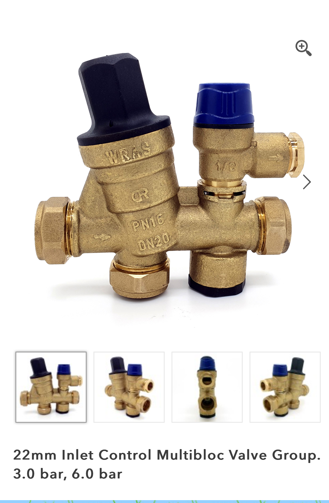

Nickfromwales Posted April 10, 2025 Posted April 10, 2025 On 08/04/2025 at 20:31, tokyotecubate said: we realized that some taps are not getting hot water Ok, so which ones work? Can you take your better half with you so one person can hold the hot pipe at the cylinder whilst the other person goes to open one of the non-functioning taps in the fully hot position. The new hot cylinder will have a ‘control group’ which looks like this, and you need to make sure that none of it gets even warm when running those outlets. The pipe at the top of the hot water cylinder will naturally be hot to the touch as it rises from the cylinder, so follow that pipe until it is cool / cold and that where you want to hold it to see if hot water travels out of the cylinder at all. Do NOT open the taps that work before this test or you’ll then heat up the pipe you’re testing with! Report back if opening any non-functioning taps pulls any hot water out of the cylinder or if that control group gets warm. This one may be tricky to solve so best to start getting through a process of elimination that doesn’t require paying for a plumber to come out. 1
