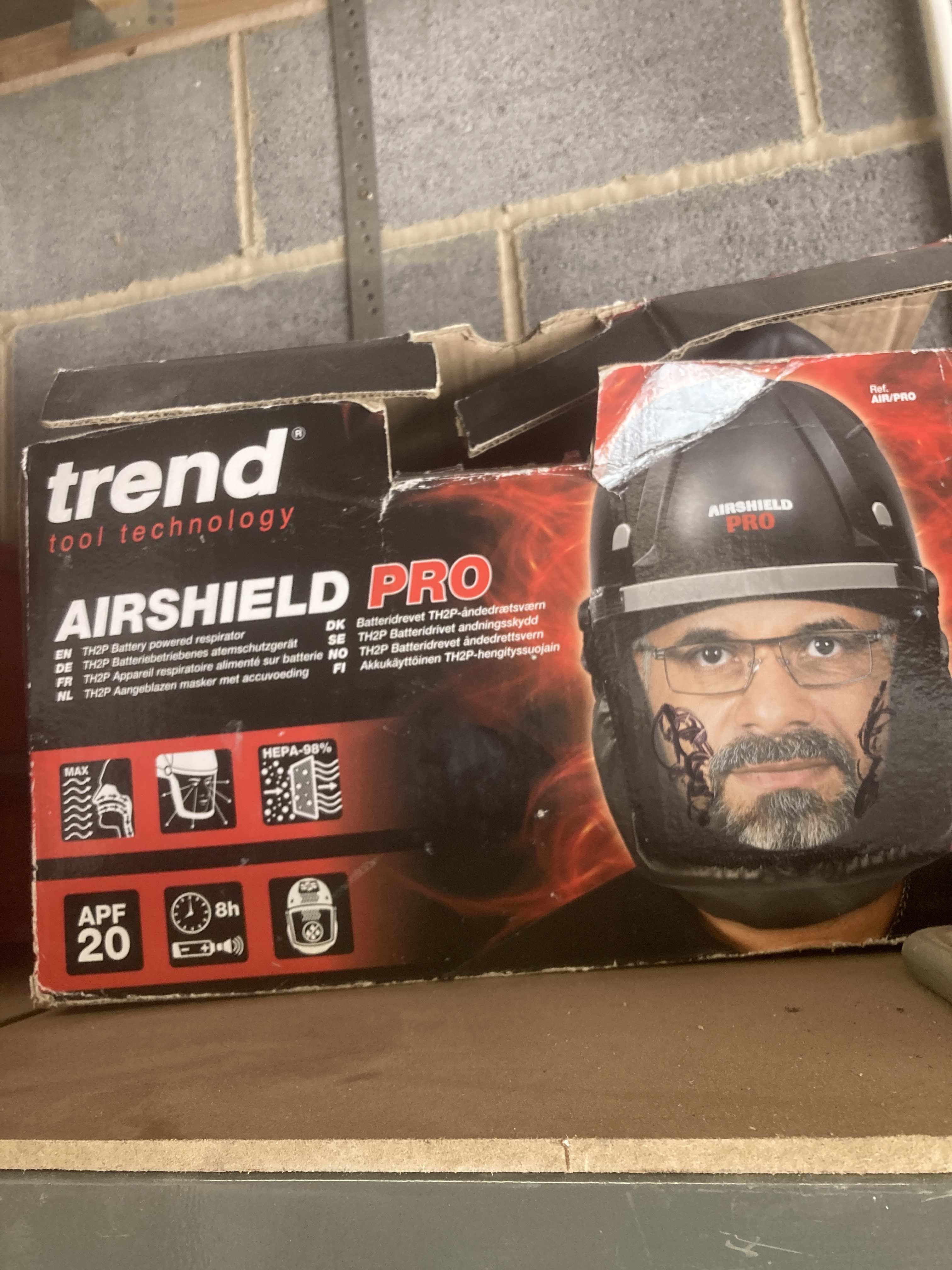

image.thumb.jpg.69d8292a3f1b90cb76d2e0ab5732352a.jpgMost of the sites insist on us using these for cutting and mixing plaster
Rechargeable Charge lasts for months
Pick them up for about £150

Are you sure?  I've just had a quick look & other than second hand, they're all more than £300.

Yeah
I bought a handful off a guy on eBay
West Midlands
