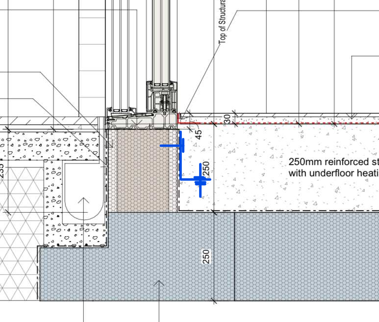

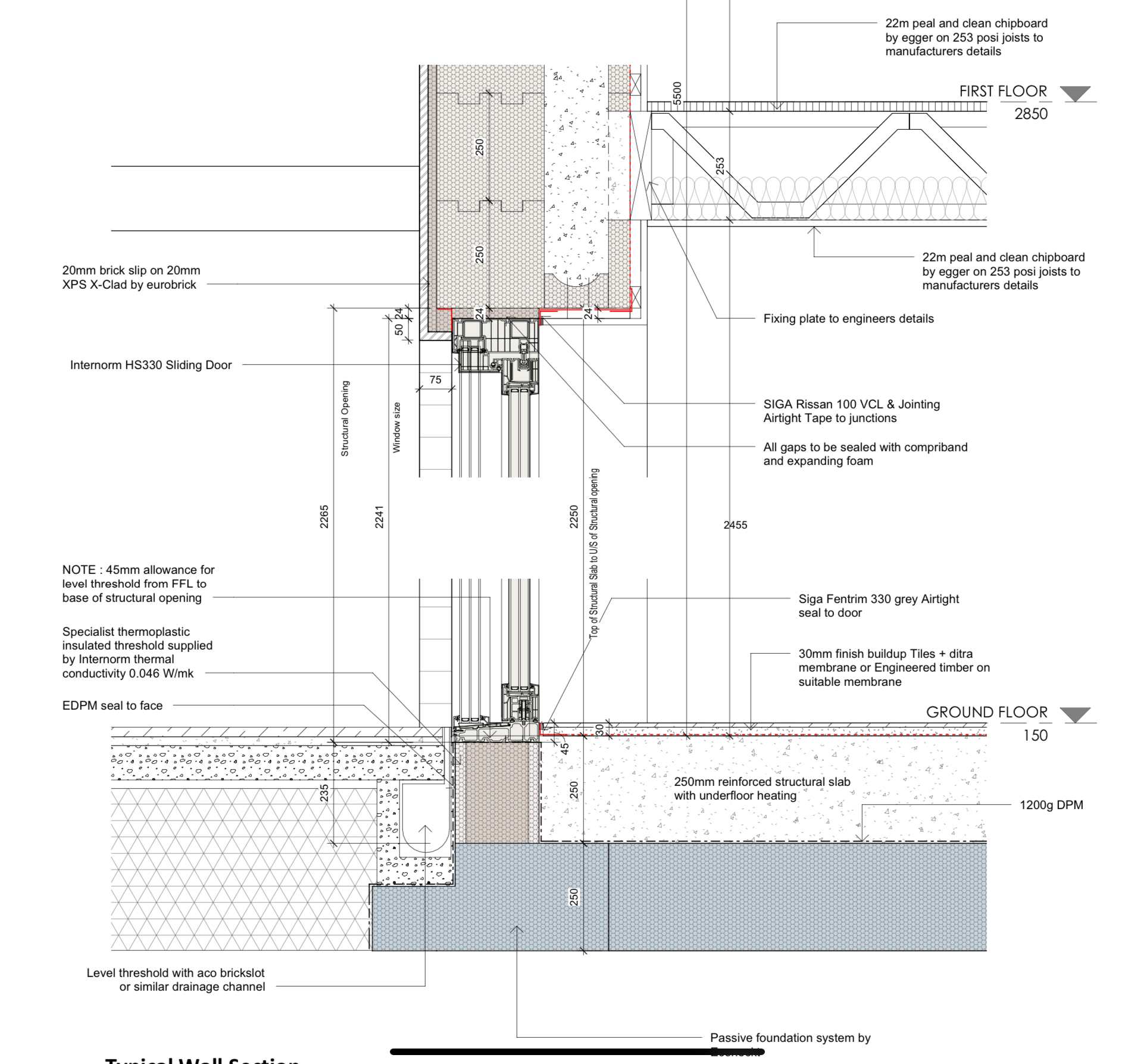

Hi hive mind, we are just about to start our ground works next week, so cue me trying to schedule delivery for all the foundation parts when whoops I’ve just found a small detail that’s fallen through the cracks somewhat.
Our door threshold details have been specified in conjunction with Internorm who are our window supplier. This is the detail we have from our architect:
which is based on Internorm’s standard detail.
All well and good except Internorm wants the threshold to be fixed into the structure to prevent it from moving. Their standard detail won’t work with our setup as the bracket is meant to anchor it into the base, which is EPS for us and wouldn’t really hold a bolt…
So we’ve now had the buck handed between Internorm, the window installers, architect, and now structural engineer, with each of them saying it’s someone else’s responsibility to figure out what to do in our case.
Internorm have confirmed that the anchors don’t hold the weight of our doors, as that load gets transferred downwards. It’s only there to prevent it from moving.
I suspect something like a J anchor fixed to the inside face and cast in place with the concrete should do, and we’re trying to confirm that’s fine with all parties involved, but I was wondering what have others done in a similar situation?
Edited by WannabeBob

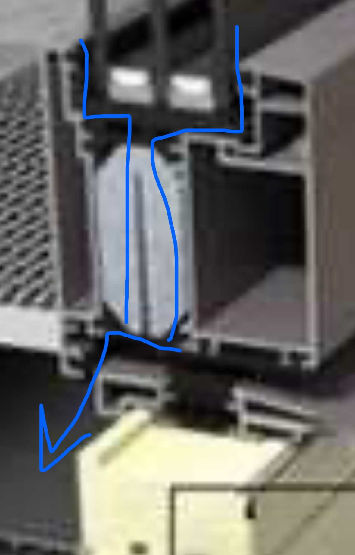

Rainwater management will be the constraint here, but possibly won over if you use (prob defo need to) a continuous bead on the inside, and then a stop start bead on the outside to allow drainage.

I’m sure I’m flaunting my ignorance here, but shouldn’t the DPC that we’re overlapping on the upstand prevent water ingress behind the upstand? Or is this a belt and braces thing, though I’d have thought if water did get behind it would be pooling behind the DPC and we’re kind of **** anyway?

I was referring to the drip in the threshold detail of the window / slider itself.  Check with the manufacturer to see if what I show is the drainage pathway, if so, all good and the threshold can be fully bonded down.

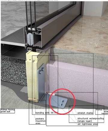

Resin anchor into side of slab? Also, it’s struck me that the fixing strips around the top and sides of the door could take some shear load - I think generally they just hold the door in place against wind loads etc.

I don't know of the Internorm "thermoplastic insulated threshold", but the image above shows it taking bolted/screwed fixing so I'd put the brackets on to the threshold and suspend the lower portion in air, where you are going to cast the raft. Put some threded bar through the holes in the (initially) unattached end, using a nut either side to hold the threaded bar in position, then cast the bracket into the raft.
You'll have to temporarily, externally, back up the threshold so that it doesn't move during the pour.
Edited by IanR
If you have a local metal fabricator then you could take the brackets to them and ask them to attach (stud-weld) some 6 or 8mm studs to them, one 40mm down from the top, and one 30mm up from the bottom.
Then use barrel nuts to screw onto the studs, then threaded bar (300mm long?) into those barrels to give you some length for purchase in the concrete.
A good deal of type 1 or other haunching  outside will hold everything in place curbing the pour, but that will require a lot of thought and preparation for prevention of any movement, and baby sitting to prevent the “oh, it’ll be fine” attitude of others who won’t realise that a few mm out is disastrous.
I wouldn't want the door in place before the concrete pour. It will likely be damaged.
So I think I favour keeping the slab low at that point. Same height as the block, or a little lower, perhaps 100 or so wide?
You could chance remembering to keep it low by hand finishing,  or put a shutter there, my recommendation.
Then the bracket bolts down to really solid concrete.

Passivhaus consultant is keen to avoid a bolt through the upstand to avoid point thermal bridges. There 25 of those over all the doors so not quite insignificant? Otherwise resin anchors would be appealing.
The “thermoplastic” I think of essentially purenit on the faces bonded to some kind of insulation in the middle. not quite sure what that insulation is made of.
I think your idea sounds similar to a J bolt? But it’s made me think if we could do the slab pour in 2 lifts? First lift then anchor down the brackets into it, then the full lift. Don’t know if that causes issues with the slab?

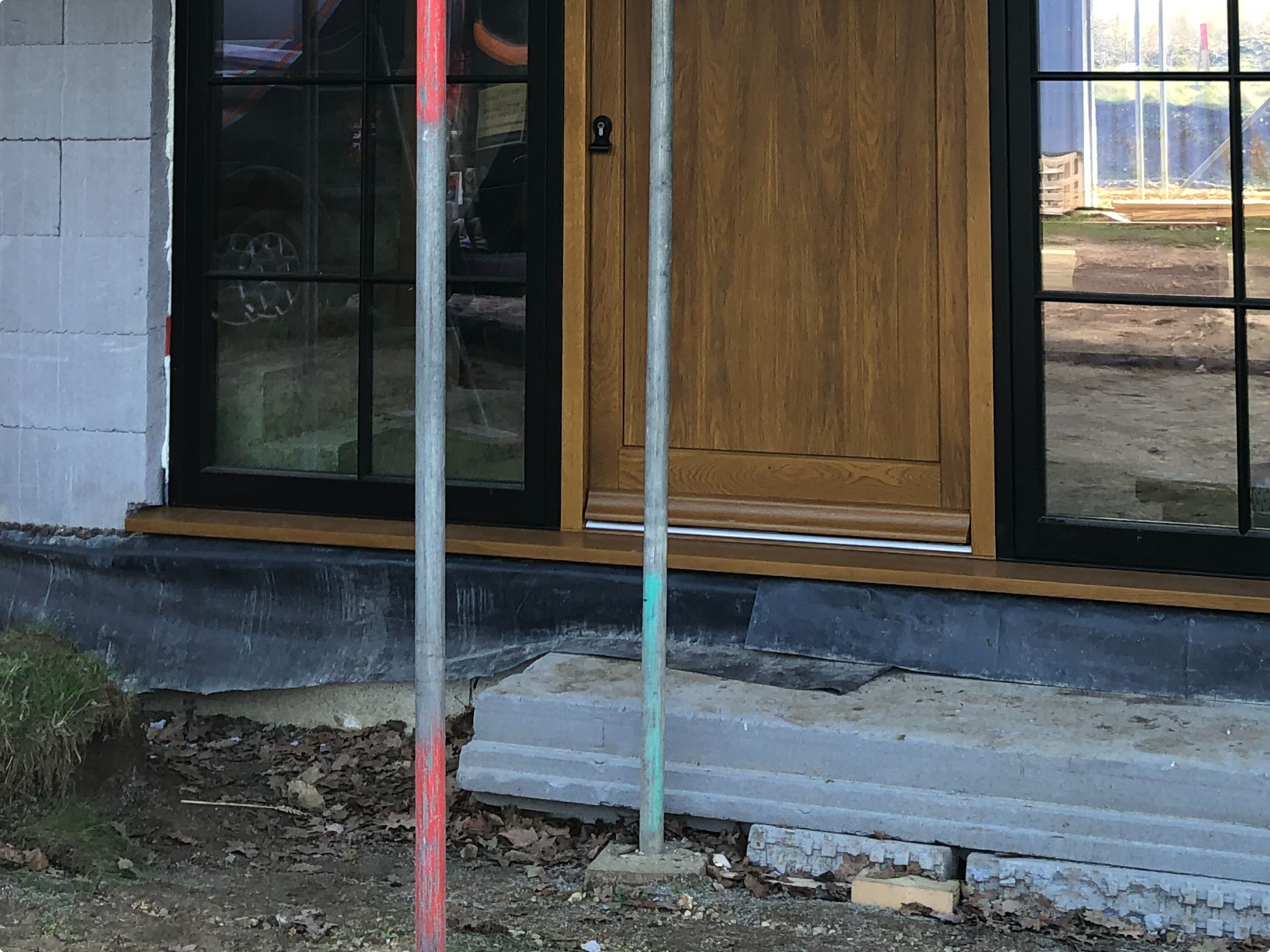

Hi nick, my door is also set back like yours. The sill does not cover the remaining part of the isoquick upstand. In a bit worried about people standing on the edge of the polystyrene. How did you finish you sill detail at the doors?

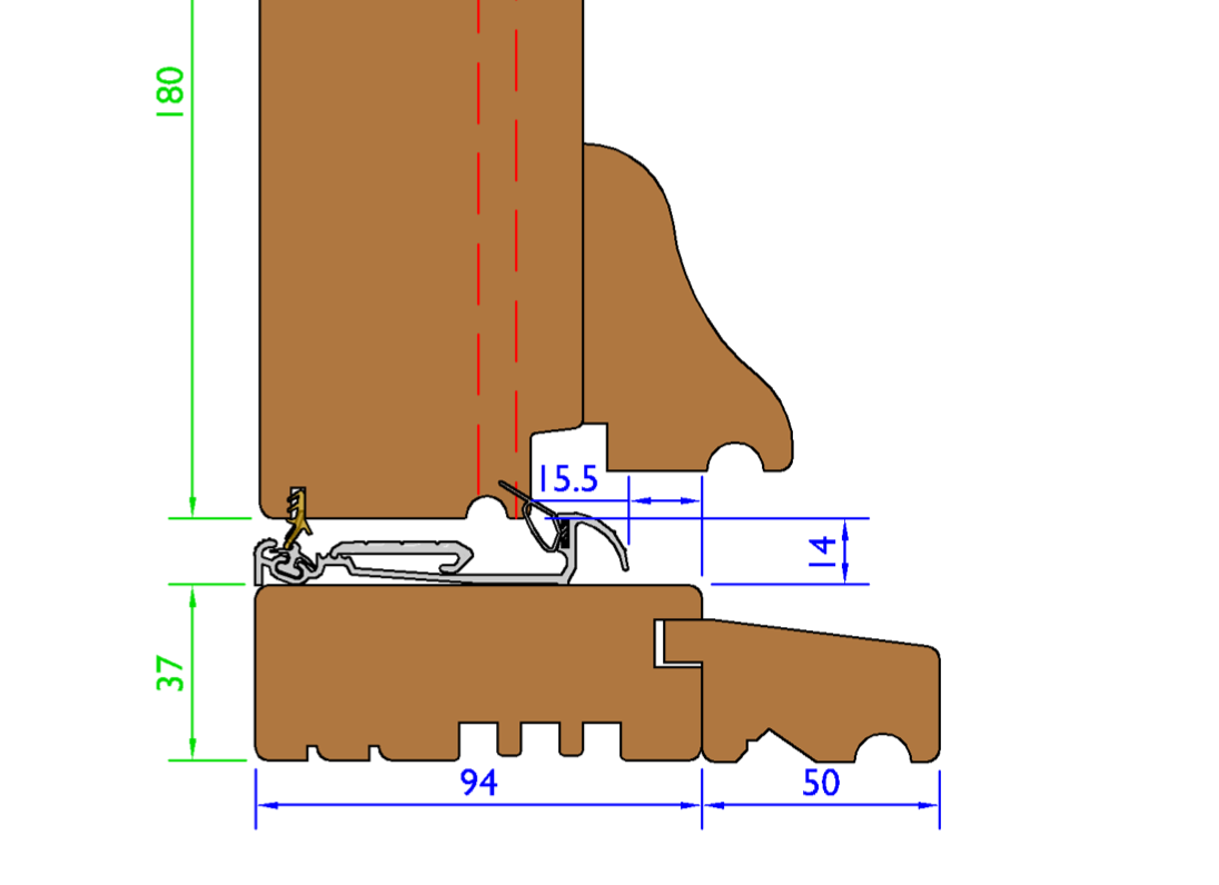

We have used George Barnsdale for our front & back doors. This is an example of the cill detail, ignore the measurements. The 94mm door frame sat on the 150mm concrete core of the ICF block. Then we have a cill extension piece extending over the outer leaf of EPS by about 25mm. My understanding is that this would usually be fixed with a screw from the bottom going into the frame from the outside. They were unable to do this, because the EPS was in the way, so they screwed the cill extension piece from the inside through the door frame. Hope that makes sense. For out French doors, these are aluminium and have aluminium cills large enough to protruded past the EPS.
