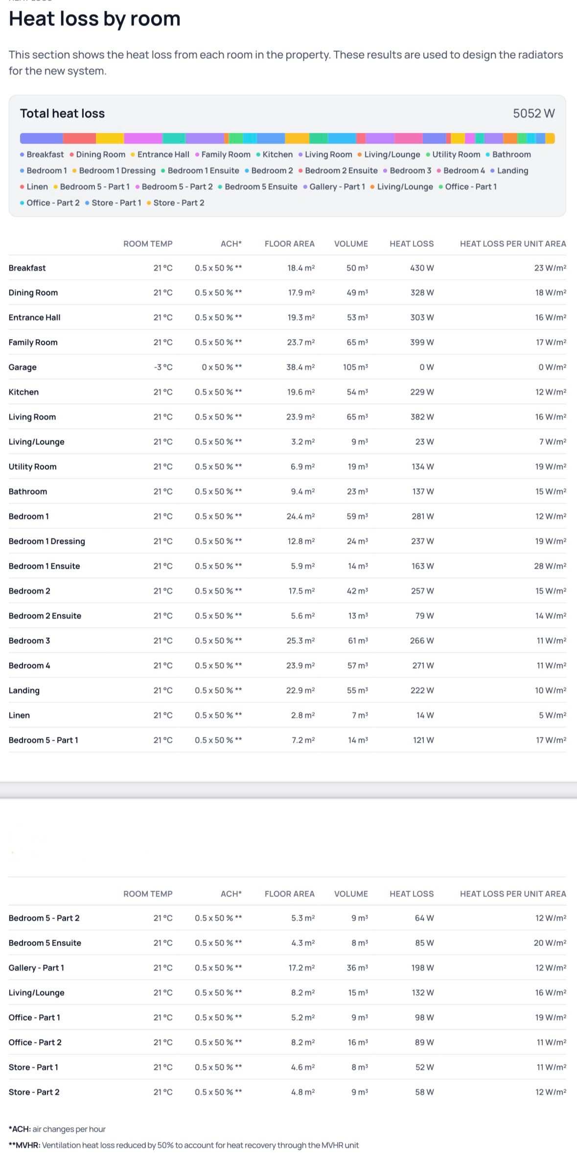

Hi All,
I have recently received my heat loss calculations from my local ASHP/UFH installer. It’s for my new build which is currently under construction. I’m not really going above a beyond building regs when it comes to insulation/glazing etc however will have MVHR.
Heat loss shows 5kw heat loss and they are proposing a 5kw Vaillant Arotherm plus. Property is 387sqm of which 39sqm is the garage and this element has not been used for the heat loss calcs as is not heated. Please see details attached, I would appreciate any comments and whether the proposed heat loss with proposed ASHP looks about right?
Thanks!

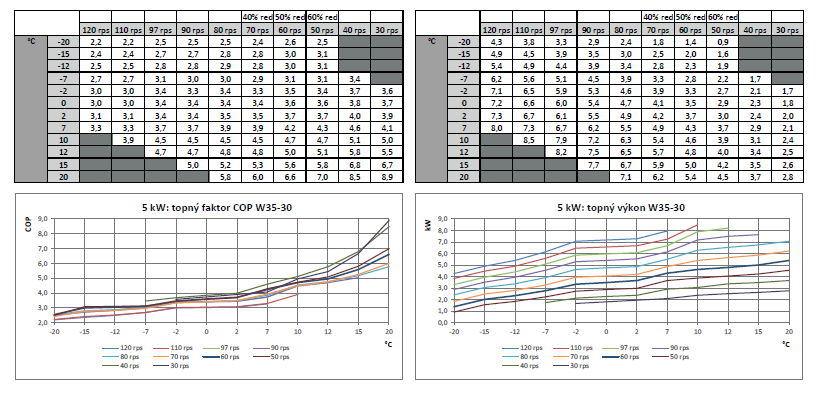

Without commenting on the calculations and assumptions, a 5kW will struggle. If the max output of the heatpump is the same as the heat loss, when it's cold, the heatpump will have to work 24x7 to keep the house warm. So no time for heating water. And if the COP isn't at what the point needed to produce 5kW, then your house won't maintain temperature. I'd be looking at a 7-9kW heat pump.
You have to check that the heat pump can deliver 5 kW (now kw) at -3°C.
Not sure if this is the model you are getting.
https://www.vaillant.co.uk/product-images/0020330791-03.pdf.pdf
but it shows a power output of between 2.1 and 6.9 kW.
The 2.1 will be when the temperature is cold.

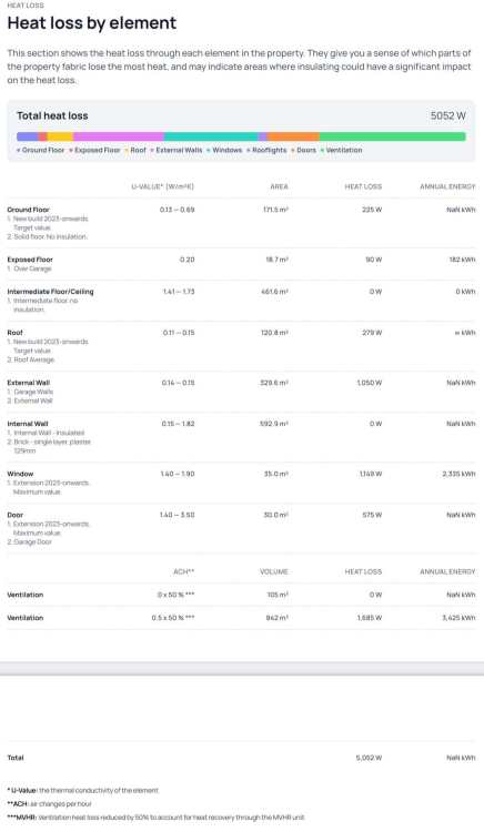

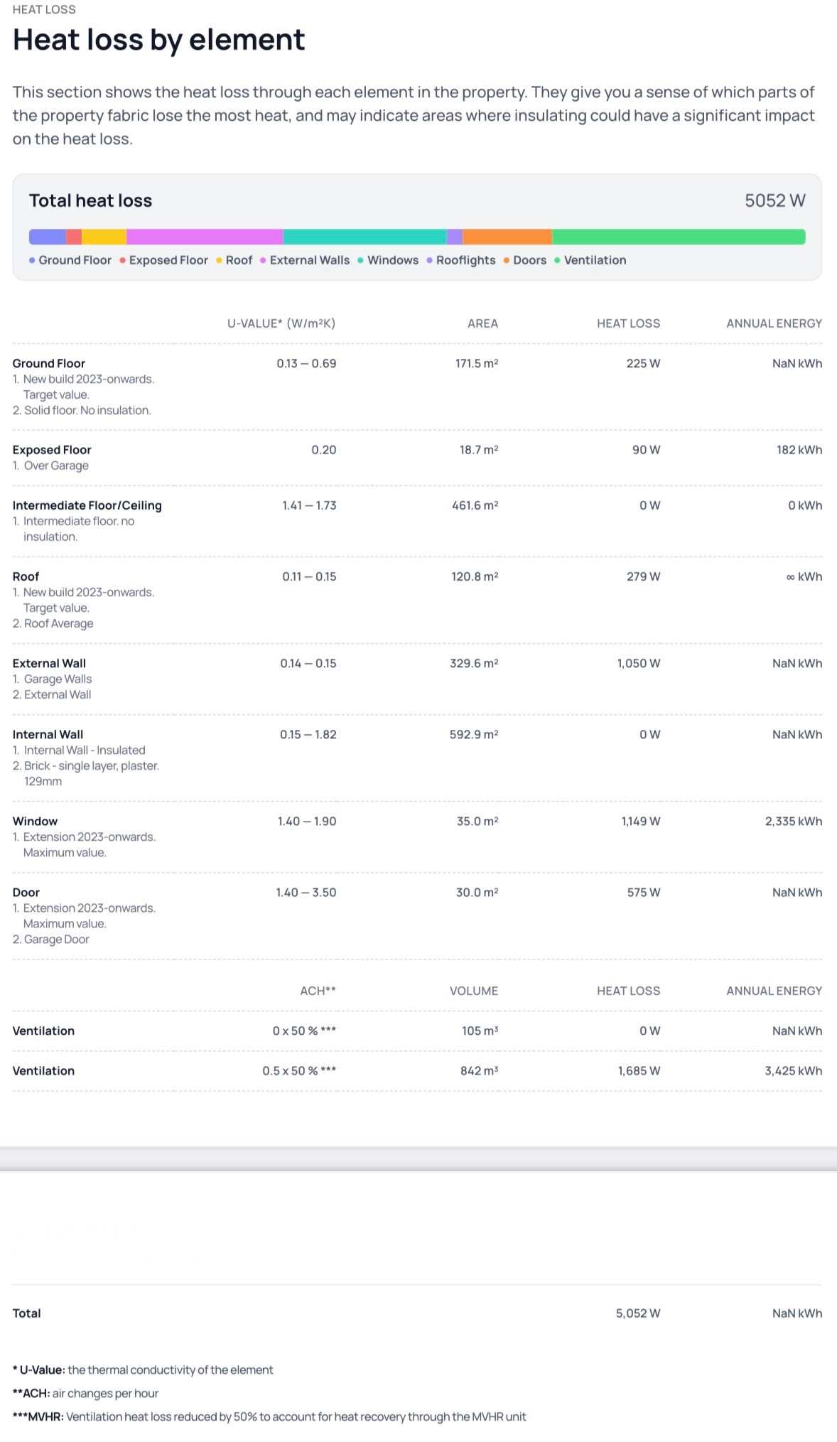

Just had a look at your heat loss calculations.
Says that there is no insulation under the solid ground floor.
Is that correct, I though floors had to have a minimum of 0.13 W.m-2.K-1 I think.
Better to have more if UFH is installed.

I noticed this too. I Will query this as we are definitely having 130mm insulation above the beam and block floor.

Heat pump manufacturers label heat pumps differently. Vaillant 5kW at -3 kicks out quite a bit more kW than 5, you need to look at data sheets to get the correct figures. See no issue with what is proposed. So long as you aren't being ripped off.

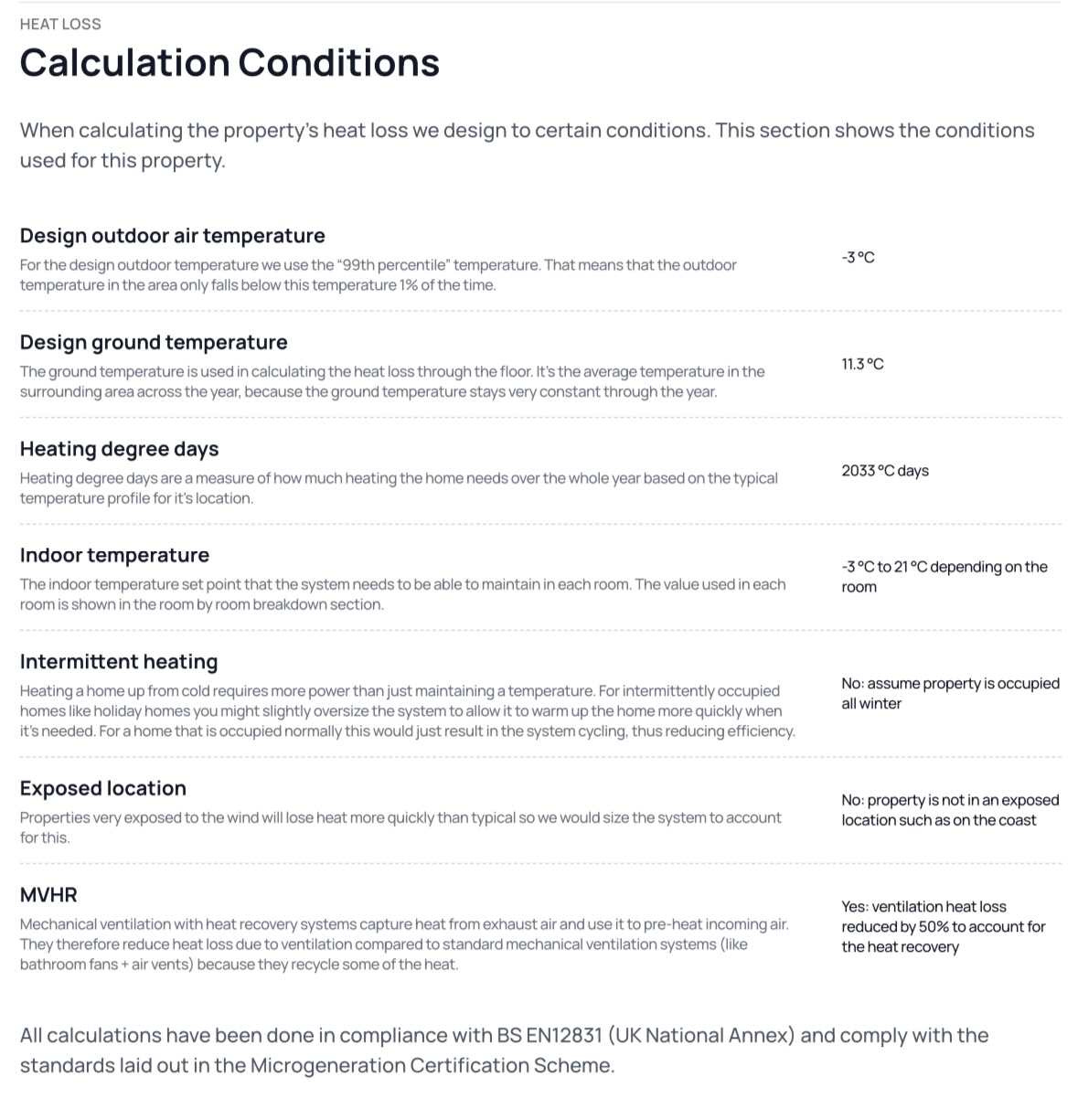

There is an argument that an oversized heat pump may tend to cycle which is inefficient, so you may want to deliberately not have much headroom. Also, how many days are at -3C for 24h in Berkshire? - so there’s already some headroom built in. Ask them to re-run the calc (should take 2 minutes) for a more realistic cold day, to see how much real headroom you have?

If the heat loss calculation is about right then the 5kW Vaillant is a pretty much perfect fit.  It claims 6.5kW at -3/35C (as you have UFH I presume you will be operating at 35 or less), but note these figures may not include defrost..  Its a nice unit with good and very capable controls - better than many).  As your installer says there is no point in going for the 3kW model its just the 5kW one software limited at the top end but identical at the bottom end.  Your installer sounds like they may be a goodun!
Far and few between. I would say maybe only 2 days like that over the past year.

A heating system is designed to supply the correct amount of thermal power, 99.5% of the time.
2 day below -3°C is 0.55% of the time.
So that looks good.
Most of the heating season time the outside air temperature will be between 10°C (very little heating needed) and 5°C (not that much in reality).
We do get weeks where the temperature hovers around freezing for 4 or 5 days (when the Thames freezes over) but not seen any of those weeks since the early 1980s (worked in Marlow back then).
The worse that will happen is that your internal temperature will drop a couple of degrees, say to 18°C, then plug in a fan heater.
If the domestic hot water becomes a struggle, turn the immersion heater on.
Don't fret over the extremes, they are called extremes for a reason.

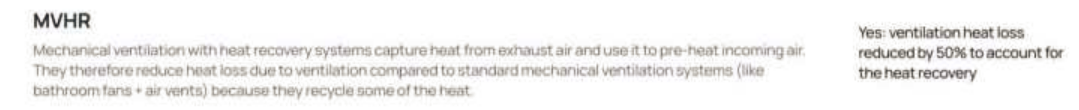

To me the big unknown is the 50% discount in the heat loss calcs from the assumption that the MVHR will recover 50% of the heat that would otherwise be lost through ventilation, I don't know how realistic this is.
OTOH they have assumed all rooms will be at 21C. For most ppl this is too hot for a bedroom and 18C ensures a better night's sleep. Ditto Utility Room and some others perhaps.
It's fairly conservative, as long as your house doesn't naturally leak a lot. Passivhaus standards are in the high 80s 90s%

But losses through walls and roof must be very low with a total net 348 sq m only needing 5kW, which is under 15W/sq m* so the accuracy of the air change prediction is probably quite important. So I would seek assurances from whoever specified the MVHR and its mfrs rather than rely on a guesstimate from the HP installers.
*that's 4x better than our barn conversion at 60W/ sq m
