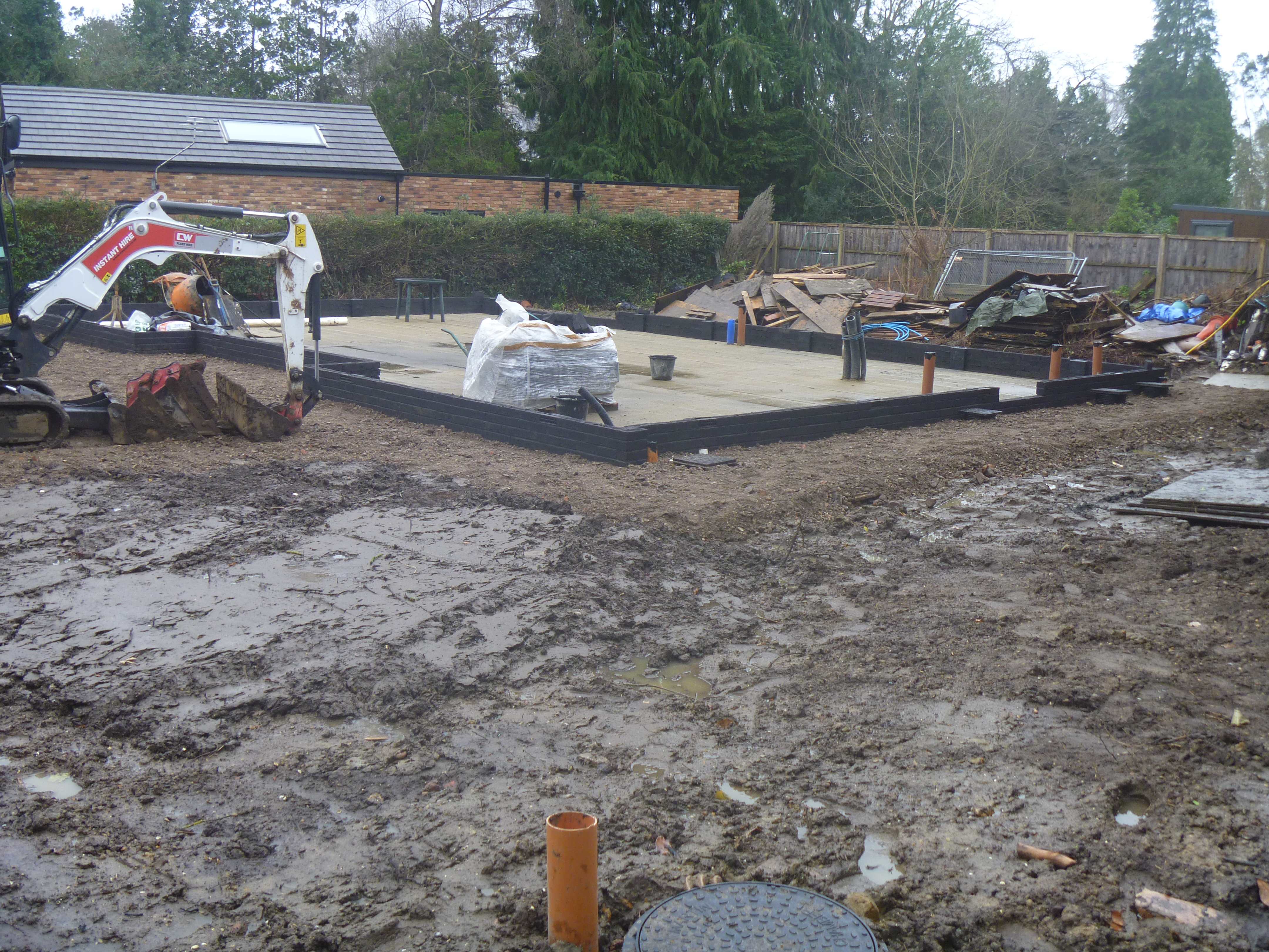

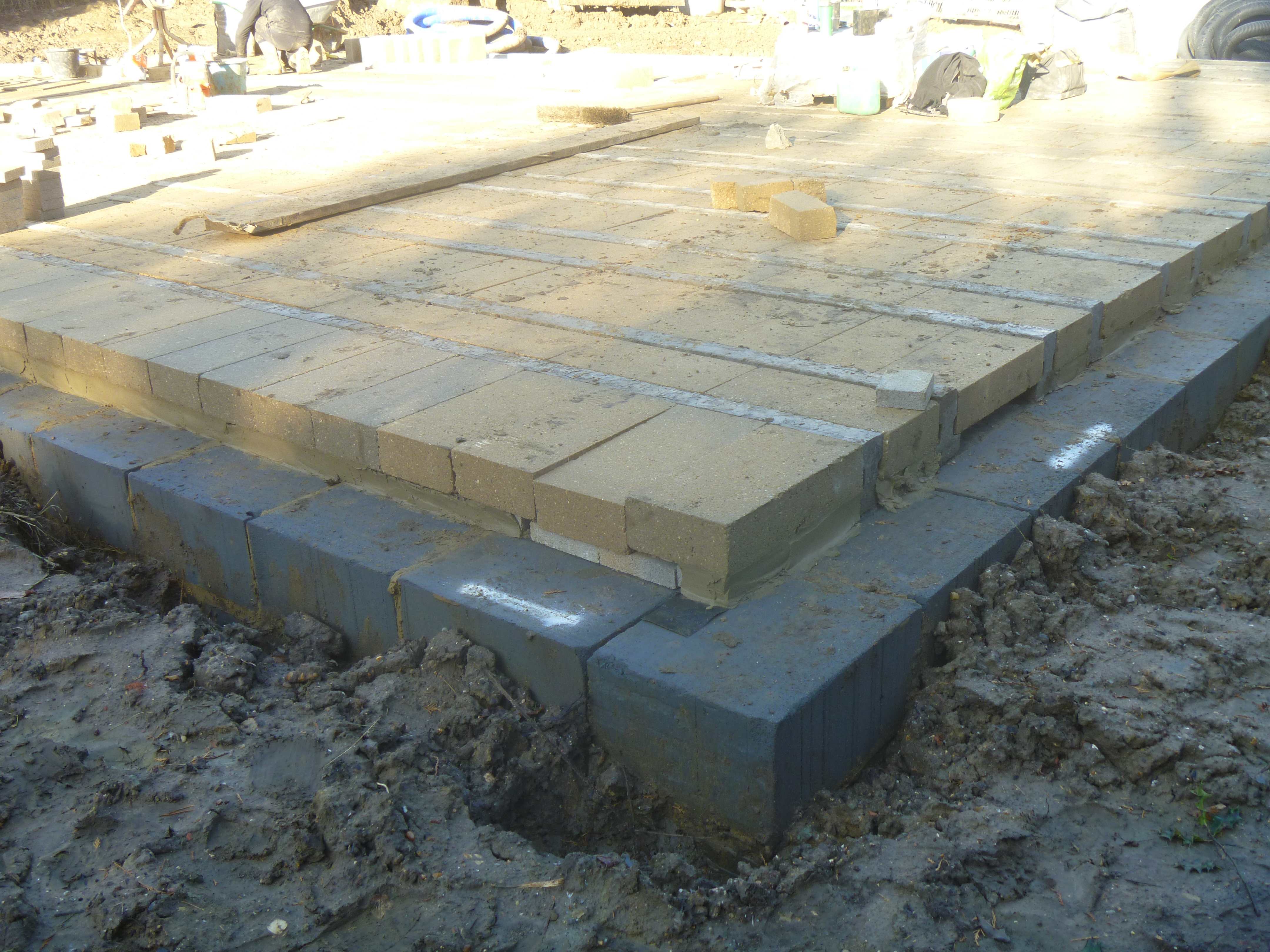

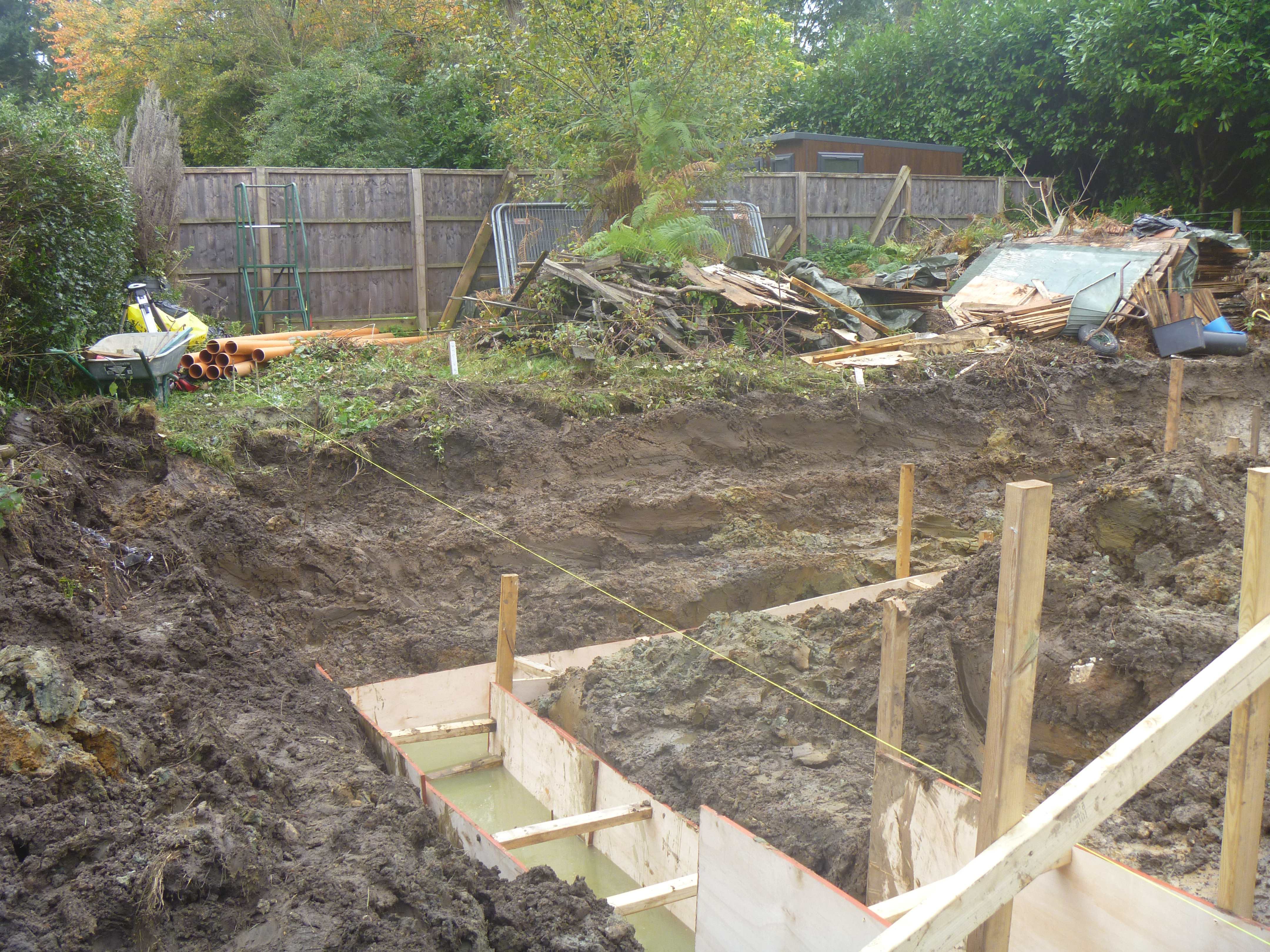

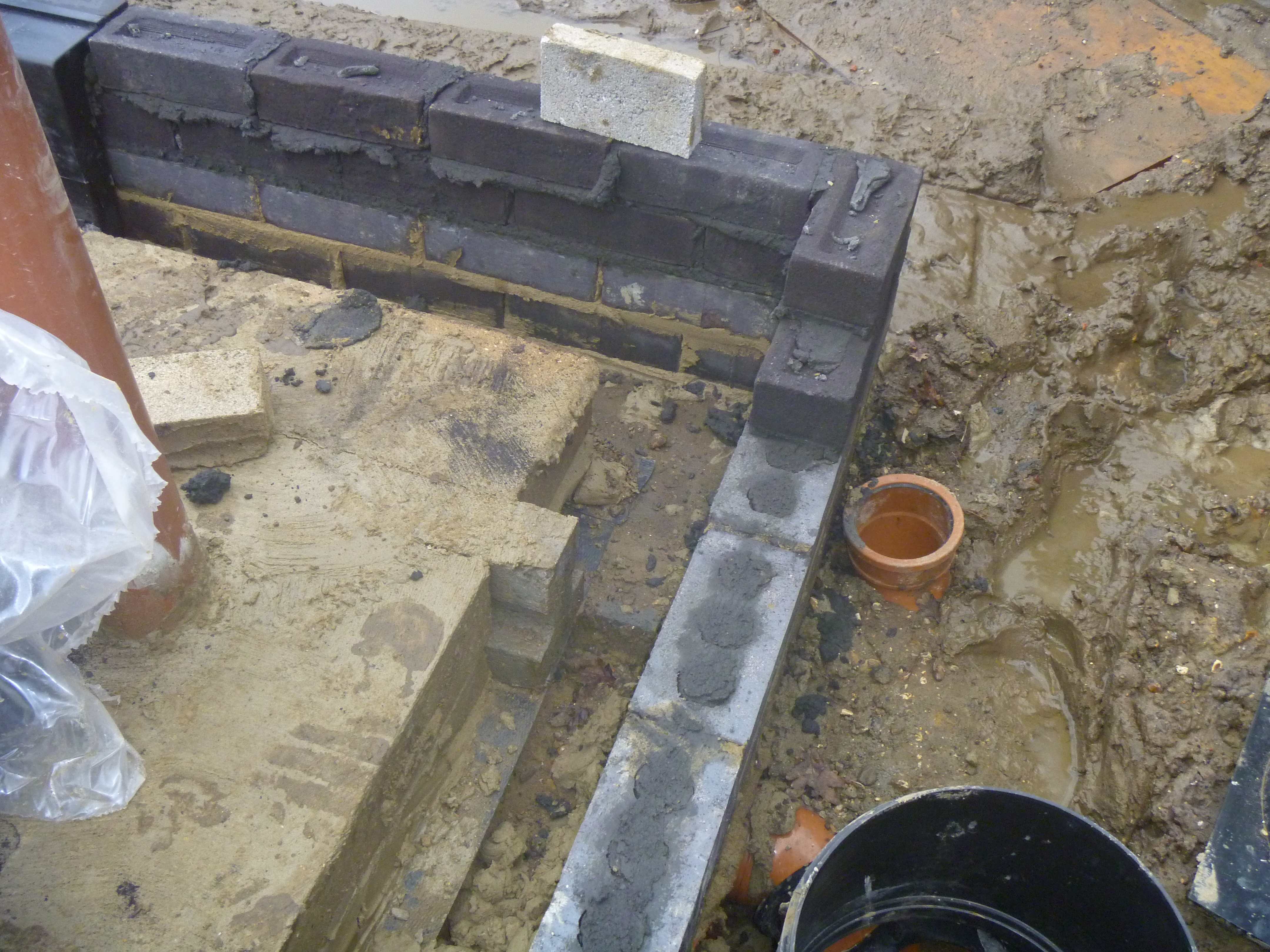

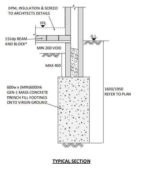

Tony L Posted March 22, 2025 Posted March 22, 2025 On 21/03/2025 at 08:33, Big Jimbo said: ...and don't forget to seal the ends of the beams which is now a Building regs requirement I only had a quick look at the reg.s, but they don’t seem clear. I think what you say is true for beams with exposed rebar at the ends, but not all beams have this. What do you think? This mess, below was built by my cowboy builder, before I got rid of him. He was supposed to build according to my drawings (2nd picture), but what I’ve ended up with is trench blocks going up above ground level. The beams rest on the trench blocks. There’s DPM beneath the beams, but it’s not really doing much, because it only goes (almost) as far as the end of the beams (& doesn’t go right to the inside of the trench blocks either). Also, the builder has bridged from the trench blocks to the beams with big dollops of mortar. This might not be such a cause for concern on most plots, but I have a very high water table, so water is going to be rising up through these blocks into my beams. I’d decided to build off the top of this mess, but lately I’ve been considering removing all the blocks, jacking the ends of the beams up with a trolley jack, putting some wider DPC in there & capping the beam ends with K-Kaps (picture below). Is this idea worth further consideration? It would be good to hear some opinions from those in the know, please. 1

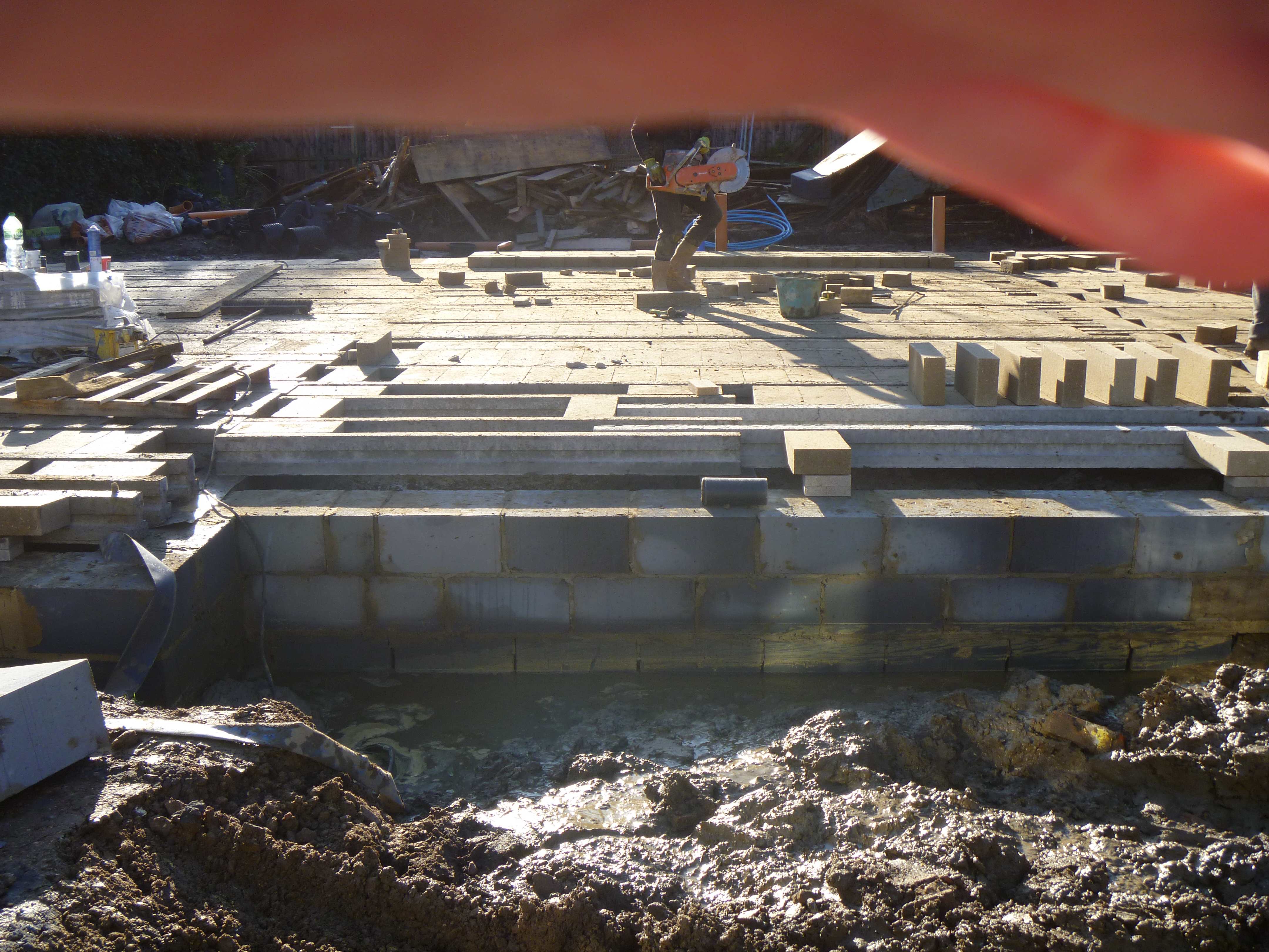

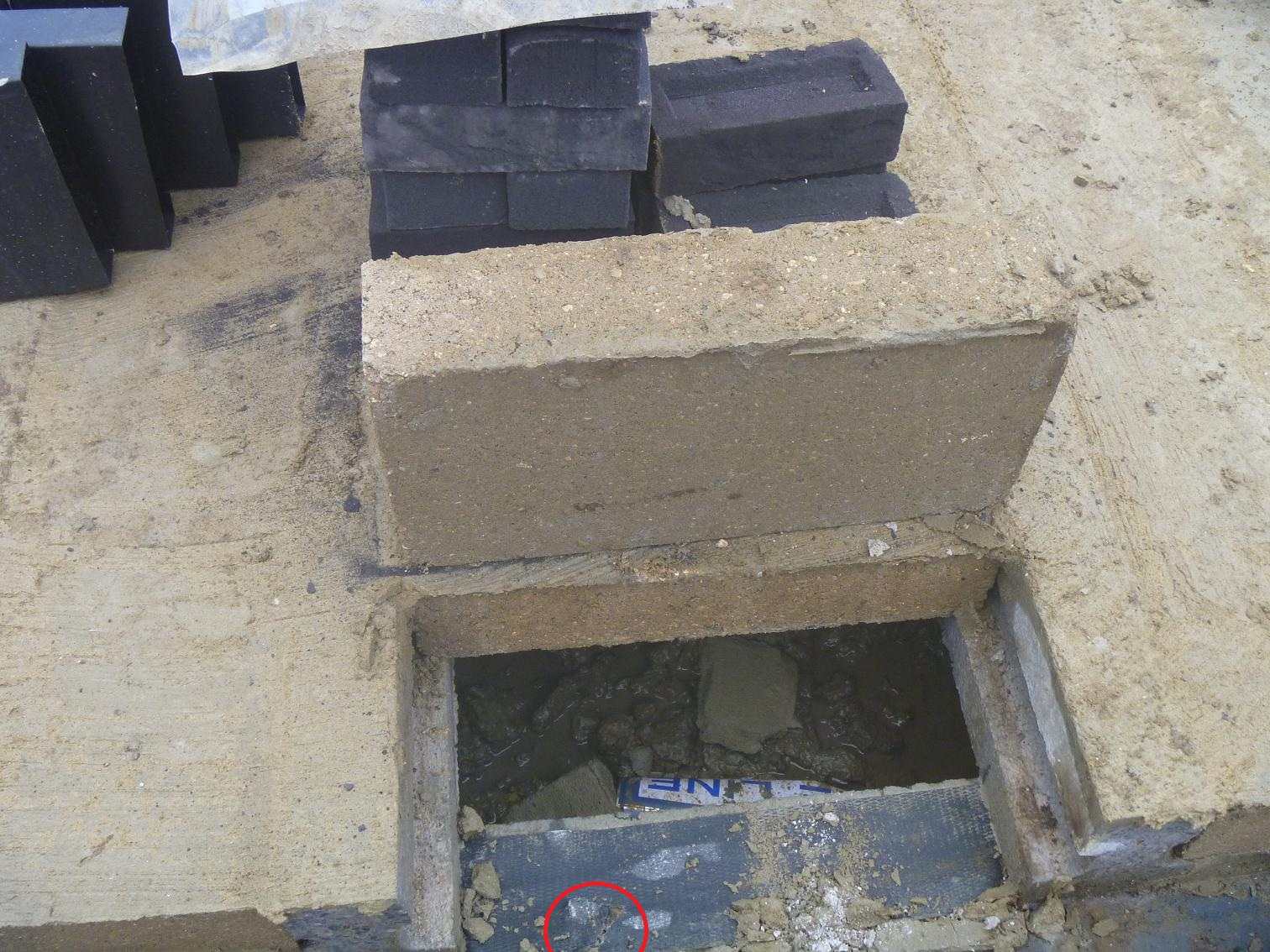

Tony L Posted March 22, 2025 Posted March 22, 2025 Ripped DPC in the red circle & DPC doesn't reach the inside edge of the blocks.

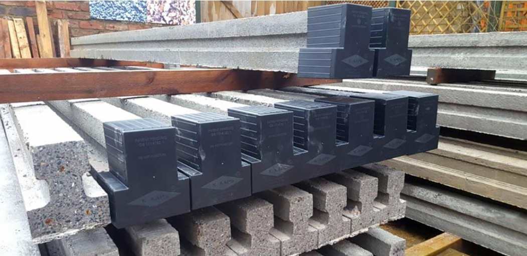

Tony L Posted March 22, 2025 Posted March 22, 2025 (edited) & these are the K-Kaps. You can see the rebar at the ends of these beams. My beams have no visible rebar. I hope you don't mind me jumping in on your thread, @Glee. I think @Canski has told you everything you need to know, anyway. Should I get my trolley jack out? Edited March 22, 2025 by Tony L
Big Jimbo Posted March 23, 2025 Posted March 23, 2025 Tony. What a mess. That whole thing is so wrong. That whole thing needs to come up, and be started again. You have no cavity ! I have got to go out now, but I will be back tonight and try and give you some answers later. Your builder is not a builder. I'm shocked.
Andeh Posted March 23, 2025 Posted March 23, 2025 Is builder fully paid up? I presume cavity will be built around it? Your missing the outer skin bottom layer?.. Can you chisel out the mortar around edges so it doesn't bridge the DPC?

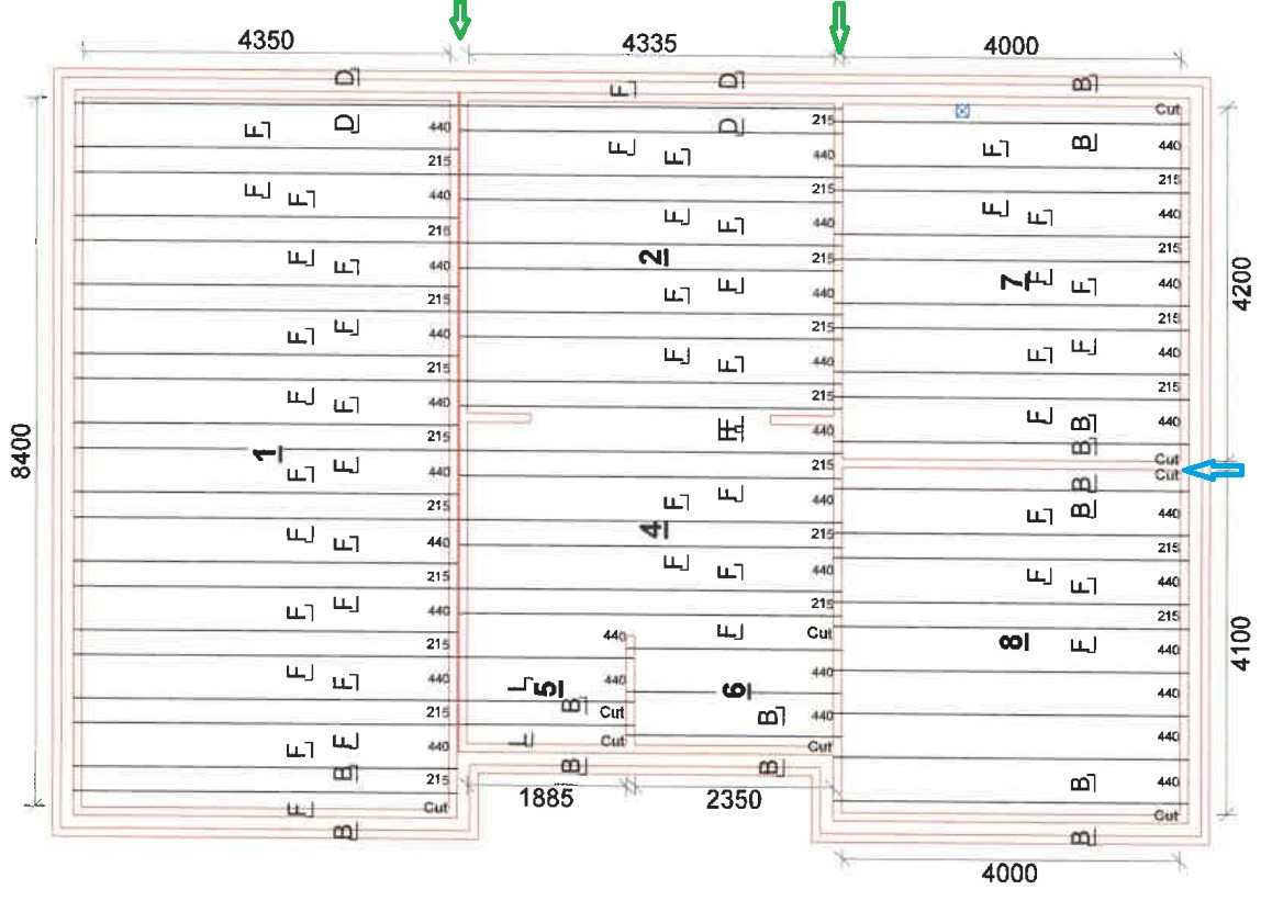

Tony L Posted March 23, 2025 Posted March 23, 2025 Thank you, @Big Jimbo. Here's the beam plan, in case that's any help. There are sleeper walls under the B&B. The two longest of these are indicated by the green arrows. The sleeper wall indicated by the blue arrow wasn't built. There's a double beam here instead. I asked (paid) a proper builder to come on site to inspect & report on the work. His opinion was that we could build off what was there, but we'd have to take the airbricks out & re-fit them properly. Of course, if we build off what's there, we're going to have to accept the B&B floor will be a lot more damp than it should be (higher U value) & our only protection from the excessive damp will be the membrane that goes on top.

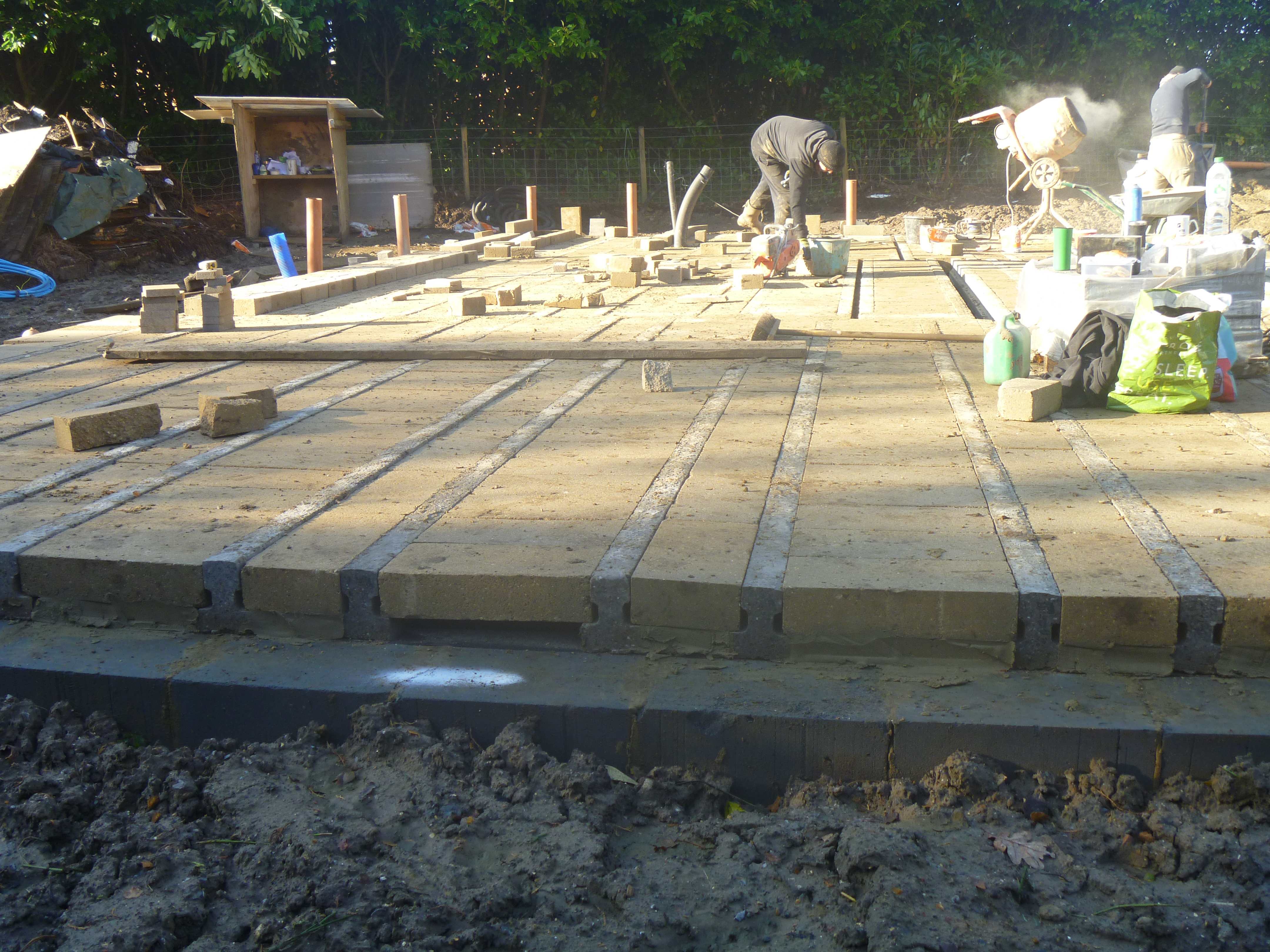

Tony L Posted March 23, 2025 Posted March 23, 2025 7 hours ago, Andehh said: I presume cavity will be built around it? Your missing the outer skin bottom layer?.. Can you chisel out the mortar around edges so it doesn't bridge the DPC? Yes, the cowboy builder started building up the outer leaf. It's very bad (see thread linked above, if you're interested). I may end up knocking the outer leaf down & starting again, or I may just take out the air bricks, or I may re-do the air bricks & the whole of the start of the outer leaf across the facade, because the black bricks are already looking terrible, due to efflorescence. Those black bricks were quite expensive & the mortar is quite strong, so it would be a job to clean them up & re-use them. These pictures show how things look on site right now.
Tony L Posted March 23, 2025 Posted March 23, 2025 Actually, this doesn't show how it look now. This is before the last three or four courses were added.

Tony L Posted March 24, 2025 Posted March 24, 2025 On 23/03/2025 at 07:30, Andehh said: Can you chisel out the mortar around edges so it doesn't bridge the DPC? Sorry, @Andehh, I forgot to respond to this. I've thought about trying to get rid of some of the mortar that's bridging the DPC with an angle grinder, but I'm conscious that if I accidentally cut a small channel into the trench blocks right at the edge of the beams, this will be a point from which a stress fracture could start, & I really don't want that. Chiselling might also give rise to stress fractures. Even if care had been taken with the installation of the 100mm wide DPC, & there were no mortar bridges, I would still not be happy that the DPC would provide maybe 1mm separation between the beams & the damp trench blocks. The k-Kaps look a lot more chunky. Any input on my idea of jacking up the beam ends & putting K-Kaps on them would be most welcome. Or, if there's a better affordable solution, I'm keen to hear about it, please.
