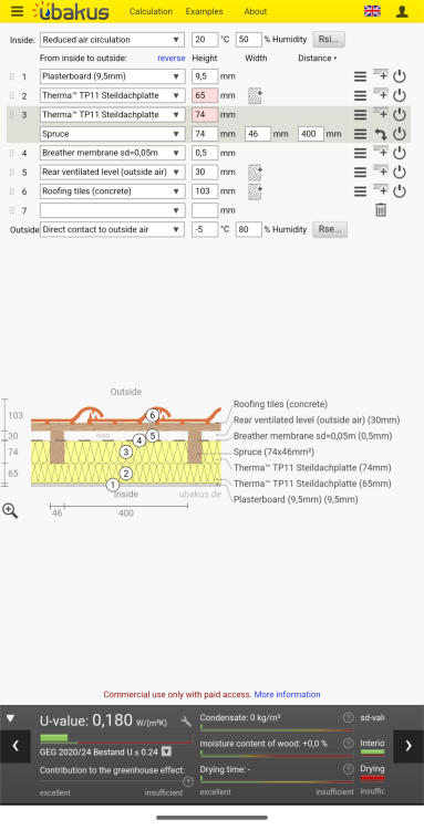

Can you help me understand what insulation I should go for on a pitched roof in an attic conversion.
I'm hoping to have the insulation layer as thin as possible because I need to maintain 1.9m head height from middle of the stairs and 1.8m at the end of the stairs.

Rafter depth is 74mm. width is 46mm. 430mm centers.

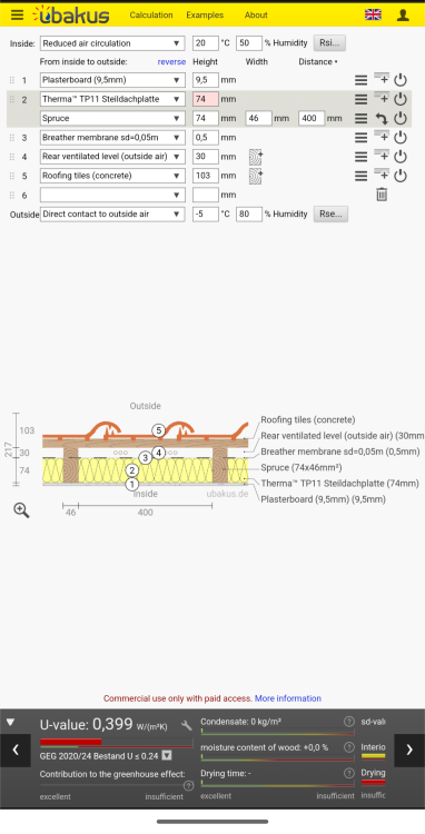

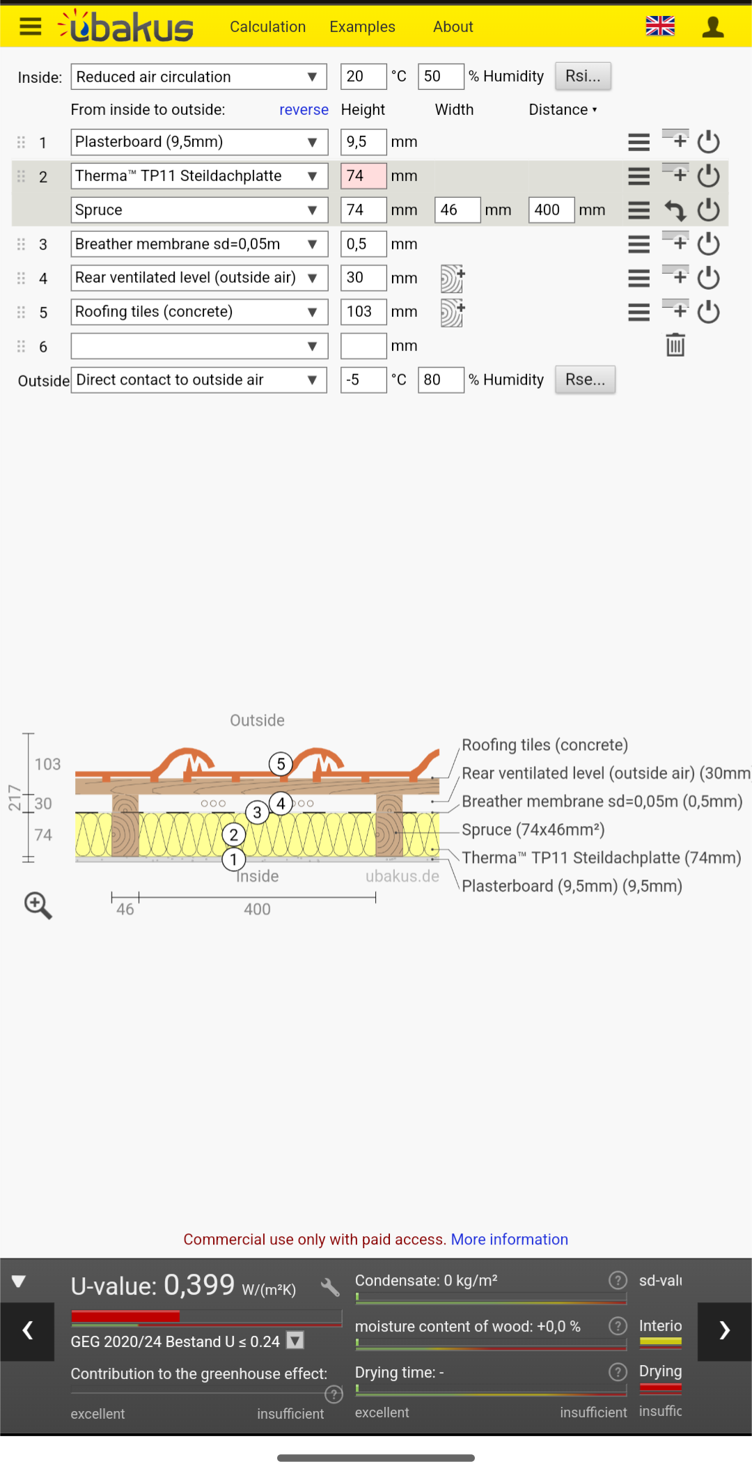

Quick play using PIR if you just fill between rafters gives u value of 0.399.
To hit the required Building Regs U value you need another 65mm of PIR.
This assumes PIR of 0.023 R value.
As I'm sure others will comment, it's great on paper, but really hard to do well unfortunately.

Mineral wool / EPS would increase your insulation depth required by 1/3. I.e. a total of 185mm.
I think you are stuck with a cold roof buildup, so will need a ventilation gap no matter what.
