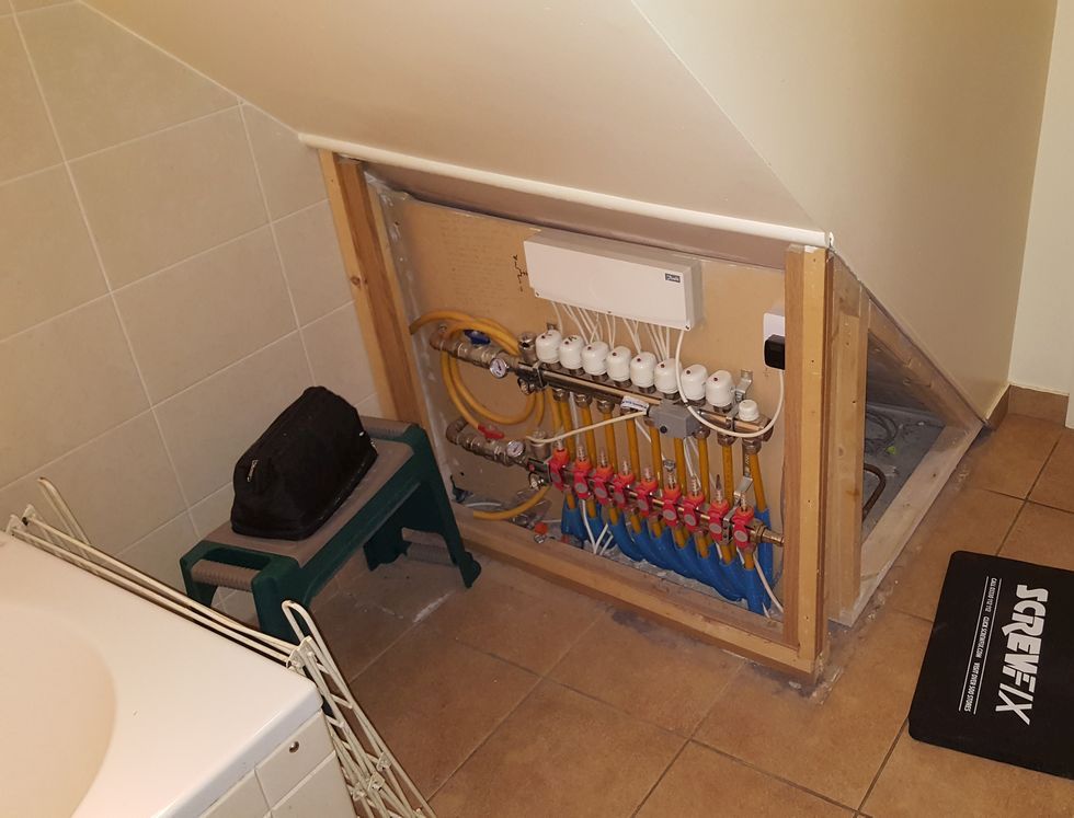

Ferdinand Posted December 20, 2017 Share Posted December 20, 2017 (edited) On 09/12/2017 at 20:14, pocster said: Resin floor would save my knees !! A couple of months ago, Screwfix were giving away free foam doormat-like things as seen below. Might they still be around? Ferdinand Edited December 20, 2017 by Ferdinand 1 Link to comment Share on other sites More sharing options...
