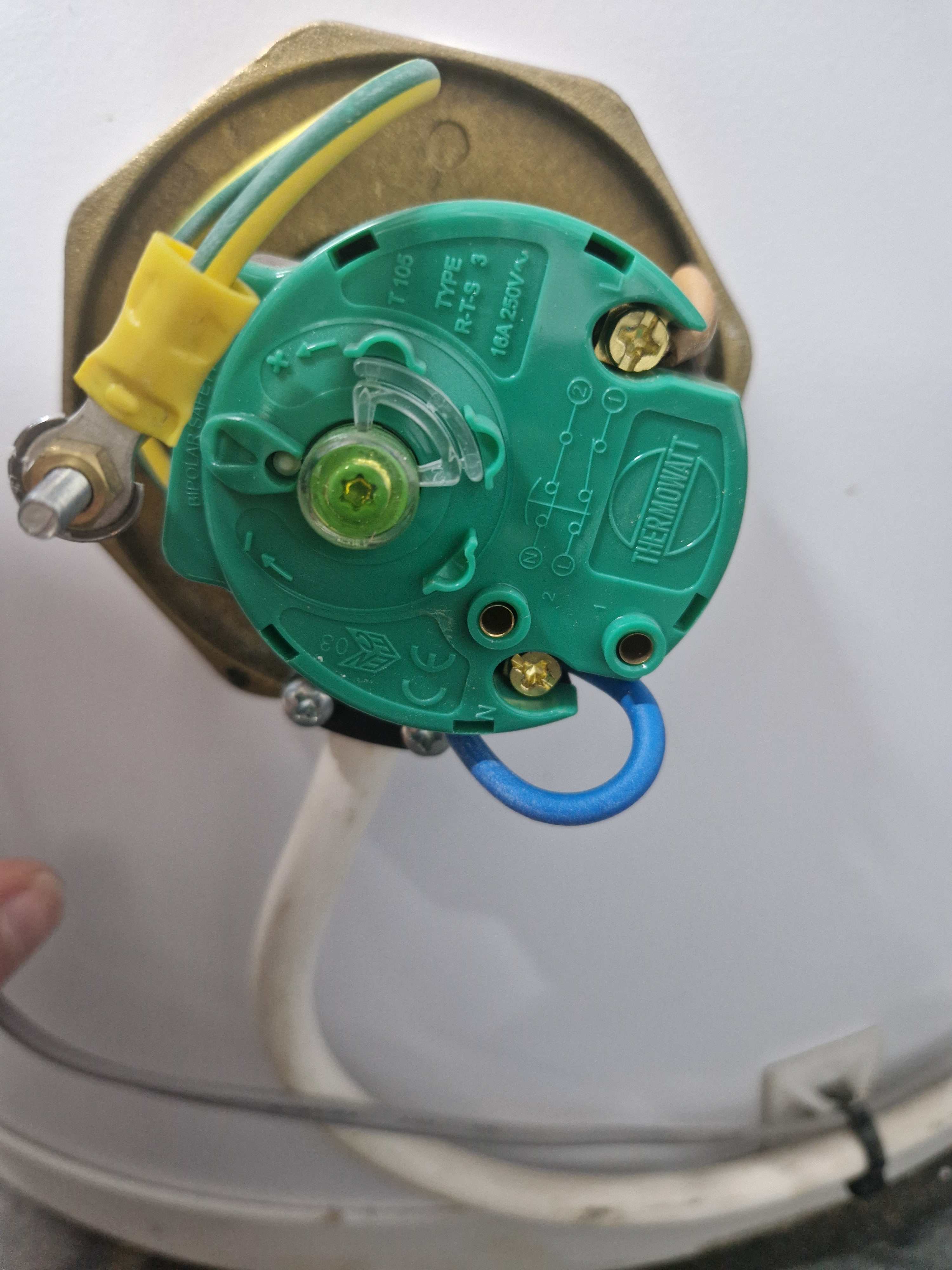

Tom Posted Monday at 15:15 Posted Monday at 15:15 I've finally had a working eddi diverter fitted and I'm trying to max out my usage, it seemed to cut out at just below 50 degrees, so I turned up the immersion thermostat but the tank still only reaches 55 degrees before the eddi stops. Attached is a picture of the thermostat. Presumably it must go higher, especially if it's going to do a legionella cycle, any idea how I can turn it up to eleven?

ProDave Posted Monday at 21:44 Posted Monday at 21:44 This is not "advice" but mine (different make design) came to a dead stop against a flimsy plastic pip and maxed out at barely 60 degrees. Turning it a "little" harder the pip broke off. I then turned it further a little each day noting now hot the cylinder got before it cut off. I stopped at 75 degrees. If you try anything similar, entirely at your own decision and risk. 1
marshian Posted Monday at 23:46 Posted Monday at 23:46 Looks to me like it could go higher (anticlockwise)
Tom Posted yesterday at 06:59 Author Posted yesterday at 06:59 7 hours ago, marshian said: Looks to me like it could go higher (anticlockwise) Ah, this was my "before" photo of the thing before I adjusted it, in case I needed to put it back. Now fully anticlockwise 1
John Carroll Posted yesterday at 07:32 Posted yesterday at 07:32 Assuming it fully anticlockwise now, can you remove that plastic quadrant and reposition it a (good) bit to the right to see can you then turn the adjustment more anticlockwise.
