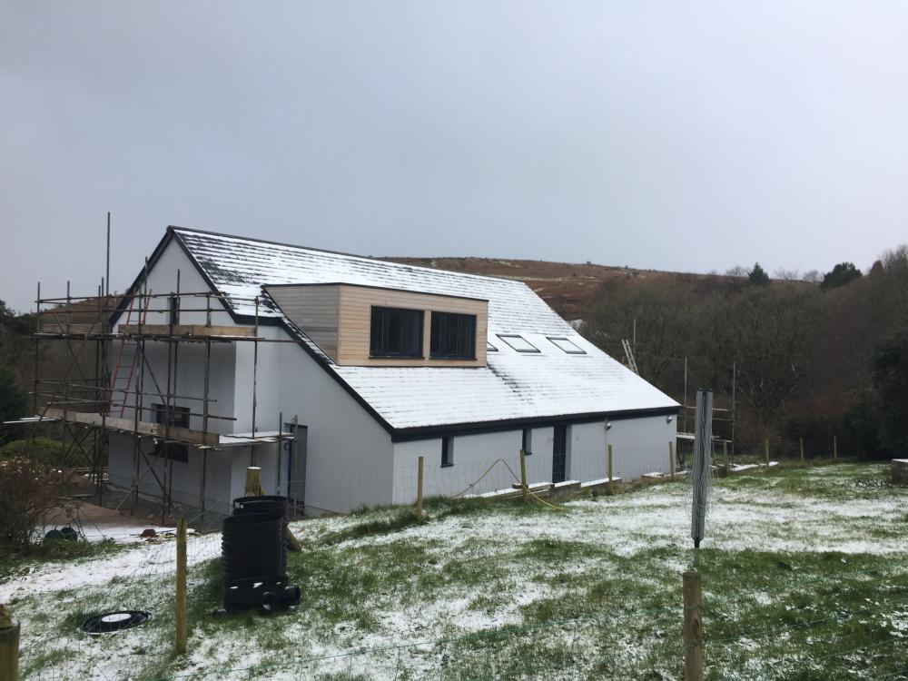

Barney12 Posted December 9, 2017 Share Posted December 9, 2017 Thought the collective would find this interesting. MBC build, externally finished but nothing but bare plaster walls inside. MVHR operational but no form of heating yet in place. I have a heat battery on the MVHR intake but that’s not commissioned yet either. The temperature up up here on the moor has been pretty cold of late. Certainly close to freezing for over a week now. However, the temperature in the house seems to sit at a pretty constant 12-15 degrees. Hopefully it bodes well for future heating demand. 1 Link to comment Share on other sites More sharing options...

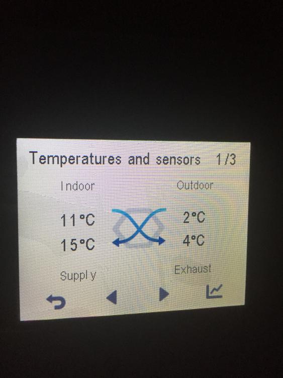

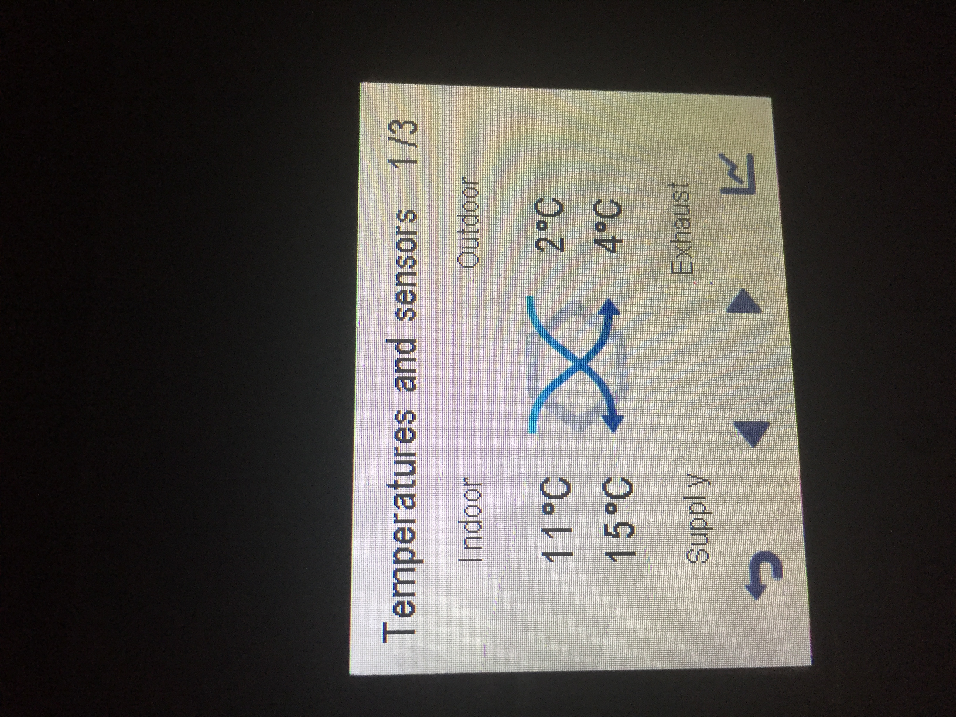

A_L Posted December 9, 2017 Share Posted December 9, 2017 (edited) @Barney12- Do you have any thoughts on the outgoing dT of 7°C with an incoming dT of 13°C? Airflows not yet balanced? Lots of condensate? Incoming reduced to protect heat exchanger? Edited December 9, 2017 by A_L More thinking! Link to comment Share on other sites More sharing options...
pdf27 Posted December 9, 2017 Share Posted December 9, 2017 8 minutes ago, A_L said: @Barney12- Do you have any thoughts on the outgoing dT of 7°C with an incoming dT of 13°C? Airflows not yet balanced? Lots of condensate? Incoming reduced to protect heat exchanger? Umm... that it probably breaks the laws of physics? I think the indoor temperatures look like they're the wrong way around - that seems to be saying that the heat exchanger is taking indoor air at 11°C and sending fresh, warmed air out again at 15°C. Much more likely is the other way around - that gives outgoing dT of 11°C and incoming of 9°C. If flow rates are equal in and out (as they should be) then that's about 82% efficiency. Link to comment Share on other sites More sharing options...

Barney12 Posted December 9, 2017 Author Share Posted December 9, 2017 1 hour ago, A_L said: @Barney12- Do you have any thoughts on the outgoing dT of 7°C with an incoming dT of 13°C? Airflows not yet balanced? Lots of condensate? Incoming reduced to protect heat exchanger? Not even got any covers on the room plenums so definitely not balanced Plastering only just finished so yes plenty of moisture. Link to comment Share on other sites More sharing options...

Jeremy Harris Posted December 9, 2017 Share Posted December 9, 2017 There's loads of heat released as a consequence of condensation in the heat exchanger, so with warm, moist air being drawn out, and the moisture condensing in the heat exchanger and giving up its heat to the incoming fresh air, you can get some pretty high apparent heat exchange efficiencies, especially if the outside air is dry, as it will be in cold weather. Link to comment Share on other sites More sharing options...

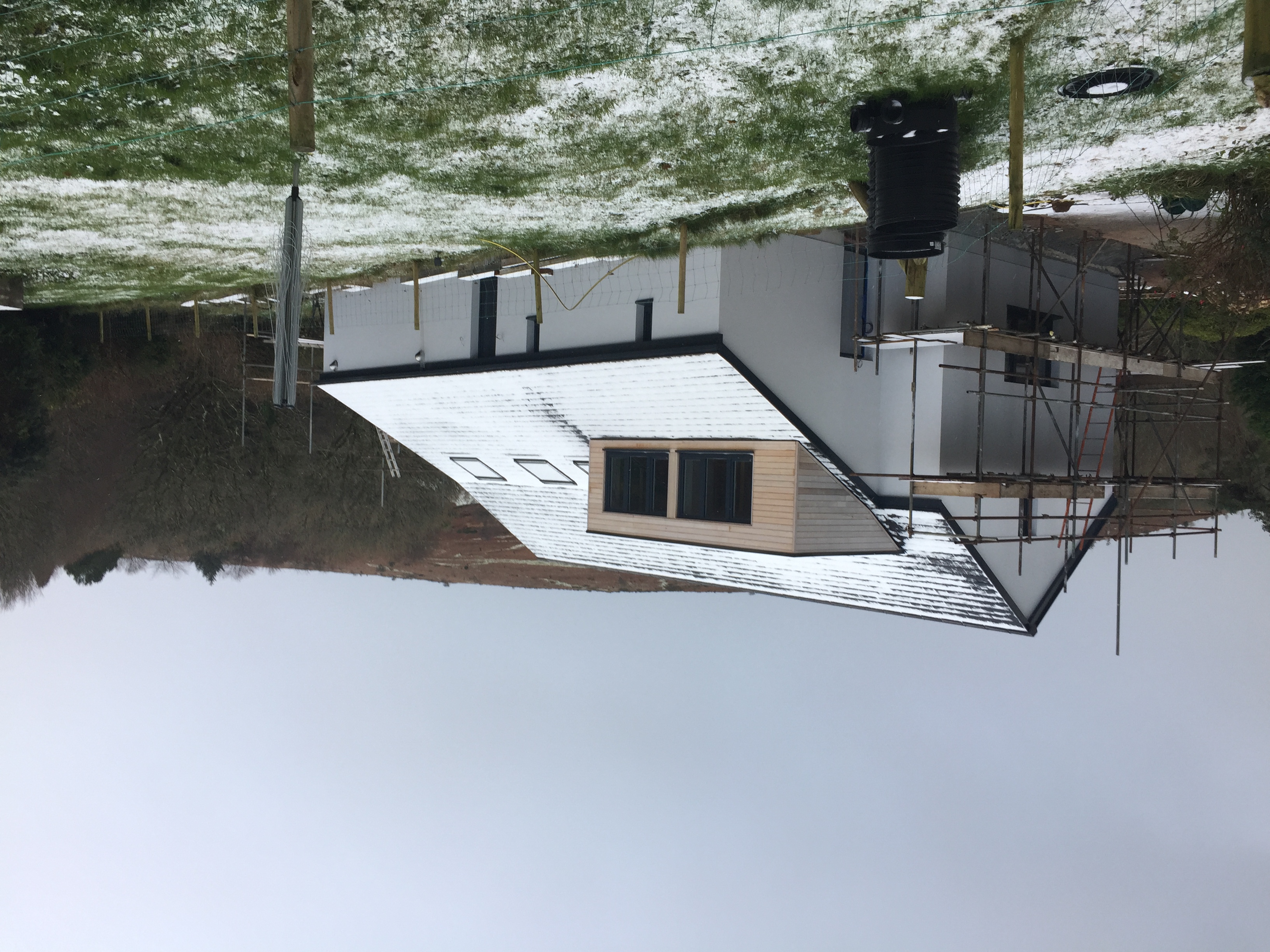

Barney12 Posted December 9, 2017 Author Share Posted December 9, 2017 Insulation is definitely doing it’s job as well as there isn’t any sign of any snow falls melting. This was yesterday mornings dusting later in the day. Link to comment Share on other sites More sharing options...

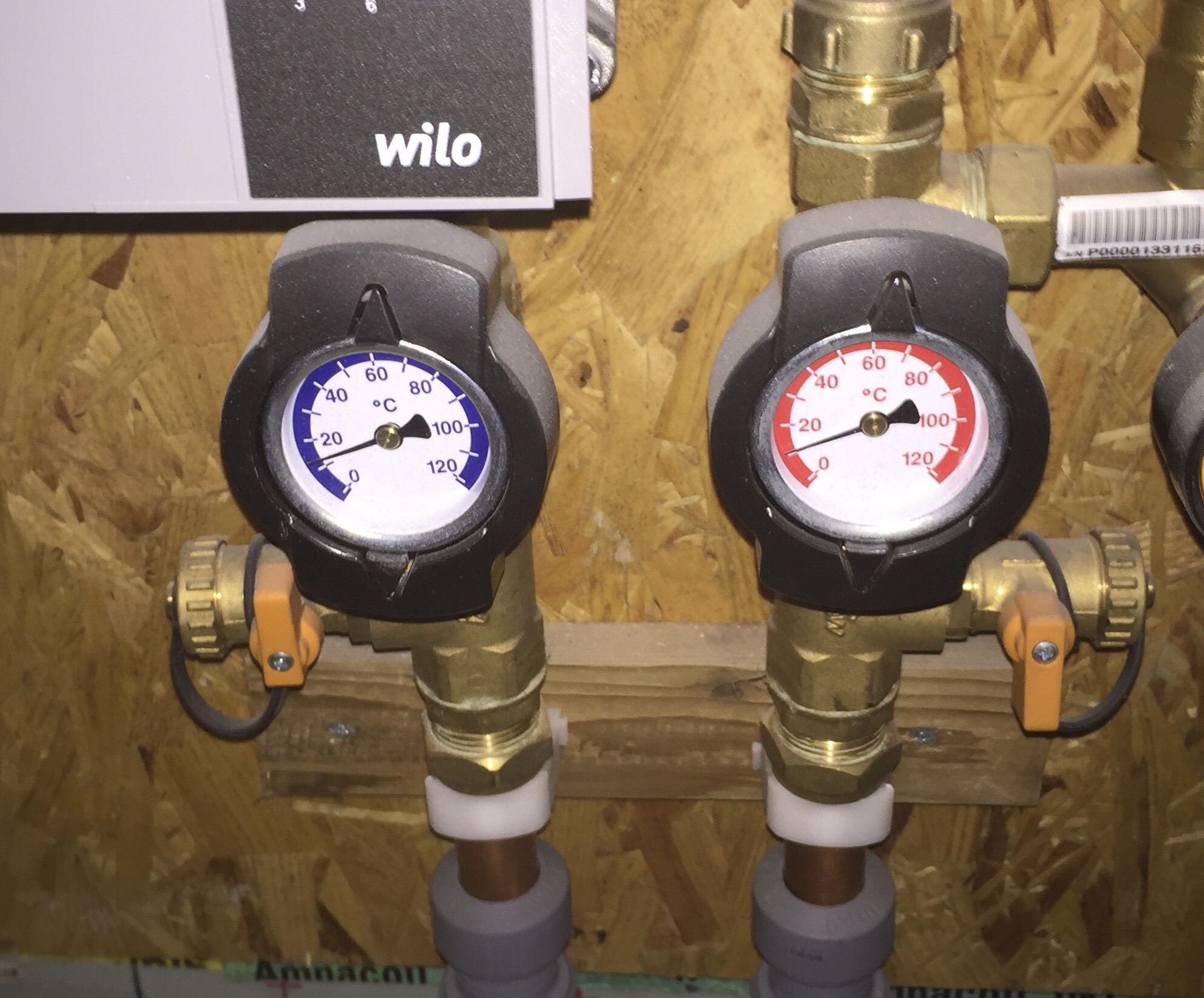

Barney12 Posted December 9, 2017 Author Share Posted December 9, 2017 Going to try and get the MVHR heat battery commissioned this weekend. It’s powered by ground source heat loop and if I run the pump to circulate there’s clearly warmth to be gained down there 1.5m below the soil. Link to comment Share on other sites More sharing options...
