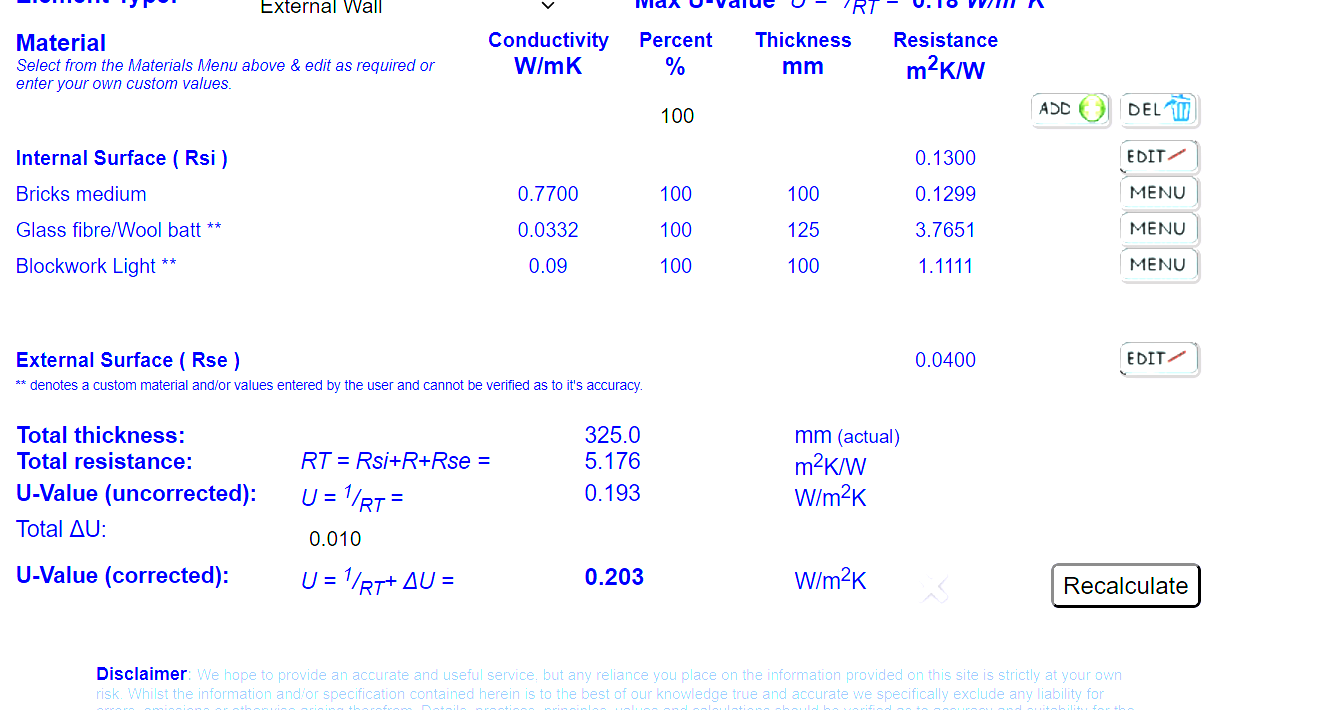

MikeGrahamT21 Posted yesterday at 11:58 Posted yesterday at 11:58 4 minutes ago, Dave Jones said: sure about that ? Change your glass fibre on to 0.032 and the blockwork to 0.09, currently the best values available for these, not that i'd want to use any more AAC blocks, but they're an option nonetheless

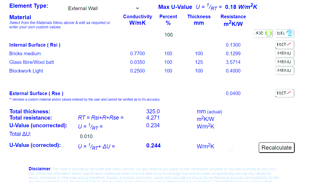

Dave Jones Posted yesterday at 12:01 Posted yesterday at 12:01 2 minutes ago, MikeGrahamT21 said: Change your glass fibre on to 0.032 and the blockwork to 0.09, currently the best values available for these, not that i'd want to use any more AAC blocks, but they're an option nonetheless link to the blocks with 0.09 U ? aerated conc are crap for air tightness and the normal ones are 0.15U still a fail for regs. 1

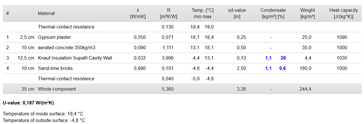

MikeGrahamT21 Posted yesterday at 12:05 Posted yesterday at 12:05 https://www.thomasarmstrongconcreteblocks.co.uk/airtec-aerated-concrete-blocks/airtec-xl Aiming for 0.18W/m2K for an extension, so still a fail, but very close
Dave Jones Posted yesterday at 12:08 Posted yesterday at 12:08 2 minutes ago, MikeGrahamT21 said: https://www.thomasarmstrongconcreteblocks.co.uk/airtec-aerated-concrete-blocks/airtec-xl Aiming for 0.18W/m2K for an extension, so still a fail, but very close that calc looks wrong. its the uncorrected U value by the looks. try https://www.changeplan.co.uk/
MikeGrahamT21 Posted yesterday at 12:13 Posted yesterday at 12:13 1 minute ago, Dave Jones said: that calc looks wrong. its the uncorrected U value by the looks. try https://www.changeplan.co.uk/ Think i'll stick with ubakus to be fair after looking at that site! Looks like it was designed in the early 2000's lol. https://www.ubakus.de/u-wert-rechner/? Its made by someone who studied Physics, not some random IT Support company. I'd advise using a more accurate tool.
