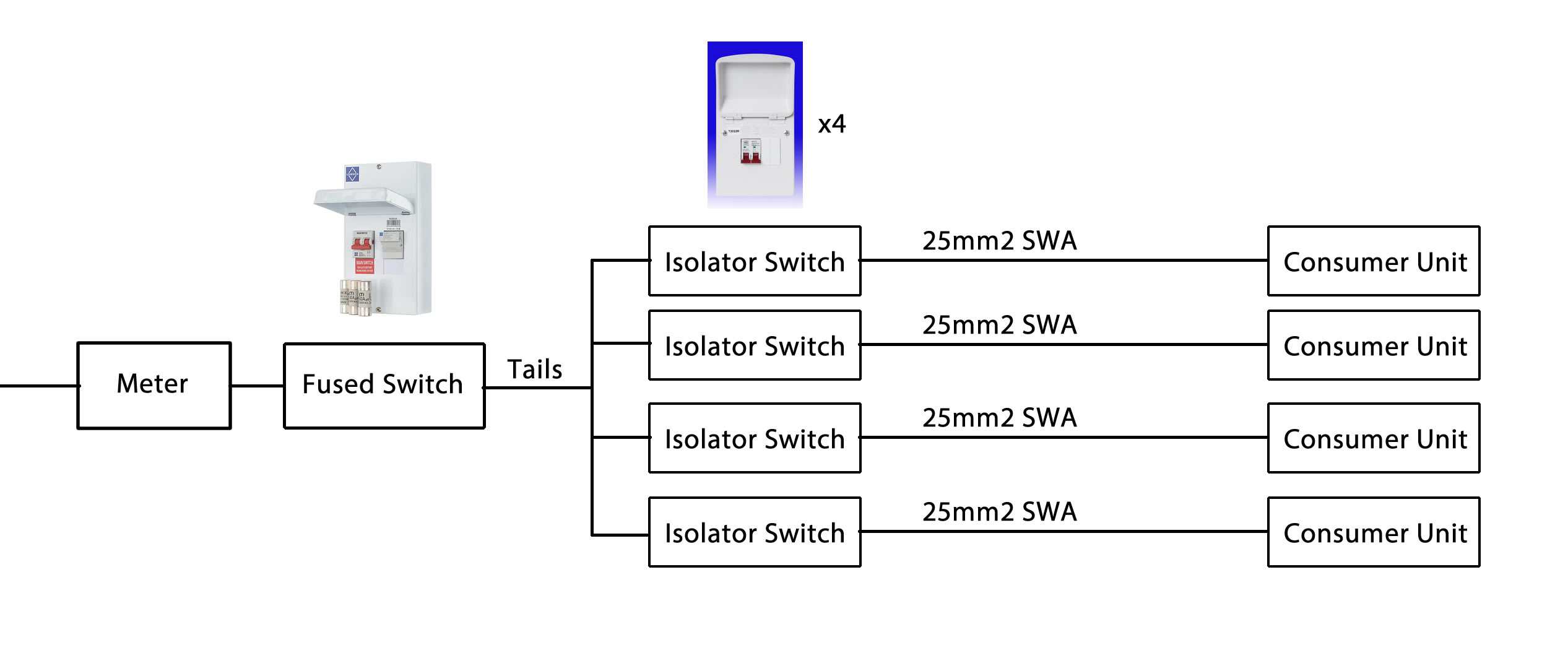

March 3, 20251 yr Hello, I would like some advice about the proposed approach to be taken by my electrician. I have a single phase 100A supply to my property and need this to serve 4 separate consumer units. (A diversity calculations has been made). My electrician has proposed using a Ryefield distribution board to split the supply to the 4 consumer units. He has informed me that a 5-way Henley block is not suitable for this application. However, I have seen many examples online where a Henley block has been used to distribute the supply to consumer units, but admittedly not to split the supply 4 ways. Is he correct in stating that the Ryfield board is the only suitable appropriate approach for splitting the supply 4 ways? Thanks, Jonathan.
March 3, 20251 yr Henley blocks don't provide isolation and over current protection of the submains, so your electrician is correct.
March 4, 20251 yr Author Hi Dave, Thanks so much for the response. The full layout is as shown (I didn't include full description previously for simplicity). There will be a fused switch at the meter and isolators for each consumer unit after the supply has been distributed. In this instance would Henley blocks work? Thanks, Jonathan.
March 4, 20251 yr I would go straight from meter to henley blocks then feed each SWA with a switch fuse.
March 4, 20251 yr 1 hour ago, ProDave said: I would go straight from meter to henley blocks then feed each SWA with a switch fuse. Yup +1. Defo need to have those de-rated to say 60a per run vs just isolated x4. Can be the same device, just knock a way out for a 63a MCB in each one, and then you have a switch-fuse isolator. Is this a very big property, eg to warrant 4 CU's?

March 6, 20251 yr Author Yes, the heating/hobs will be gas. I do have a further question related to this if I can tag it on. My DNO specifies that the meter tails between the meter position and the consumer unit should not be longer than 3 metres without the installation of an additional protective device at the nearest point to the supply inside the premises. The consumer units will be over 3 metres from the meter and therefore would I need to keep the fused switch after the meter (before the Henley blocks split the supply) (as shown in my previous post)? If so, I assume I would have this fused switch as well as having the isolator switch with 63A fuse (or MCB) on each of the 4 feeds to the consumer units (after the Henley blocks)? Edited March 6, 20251 yr by JonChas
March 6, 20251 yr 44 minutes ago, JonChas said: My DNO specifies that the meter tails between the meter position and the consumer unit should not be longer than 3 metres without the installation of an additional protective device at the nearest point to the supply inside the premises. Henley blocks and your bank of switch fuses need to be withing 3 metres of the suppliers meter. Simple.

March 7, 20251 yr Author 10 hours ago, ProDave said: Henley blocks and your bank of switch fuses need to be withing 3 metres of the suppliers meter. Simple. Thanks for this Dave, What I don't understand is how a 63A fuse on each of the 4 sub supplies would protect the incoming supply? This would not do the same as a 100A fuse after the meter?
March 7, 20251 yr The incoming supply should be protected by the dno fuse on the cut out before the meter.
March 7, 20251 yr 4 hours ago, JonChas said: Thanks for this Dave, What I don't understand is how a 63A fuse on each of the 4 sub supplies would protect the incoming supply? This would not do the same as a 100A fuse after the meter? The max you can draw is 100a, before the supply head fuse would ‘blow’ (it’ll take a lot more than 100a before it blows though). Your 100a fuse protects the meter / DNO equipment, plus also limits your max possible draw on the network (grid). Each individual switch fuse after the Henley’s de-rates the 100a that would otherwise be available to each of the 4 legs. Because you have 4 satellite fuse boards (CU) that are >3m away from the supply fuse you must limit the liability of each of the cables feeding each of the CU’s, eg in the event that a cable becomes mechanically damaged, or if any CU takes too much juice and would risk blowing the 100a fuse. You cannot have such a huge amount of power (current capacity) in a cable traversing a domestic dwelling. Just too risky. This is why the head / 100a fuse / meter are always on an outside / external wall or fed from a cable riding from the ground immediately under them. None of that has true earth protection, so can only ‘blow’ with over current or a catastrophic short circuit (mechanical damage directly linking live to neutral). Anything less than a direct short results in a spectacular and worryingly long lasting fireworks display as the fault arcs itself into infinity, literally. In that event you soon realise just how much raw power is available from that 100a fuse !! De-rating allows each of the 4 legs to all be managed in terms of the max current carrying capacity vs the distance of the cable going from each switch fuse to each CU, and caps the max amount of current each can draw in the event of a failure. If one CU was drawing 80a and the other three say 40a a piece then the main fuse would blow (rupture), and then you’d go blame the designer as it then should not have got past initial feasibility. Each leg must have its own isolation and lower rated fuse, as you are not allowed to consider the DNO fuse as your primary means of protection.
