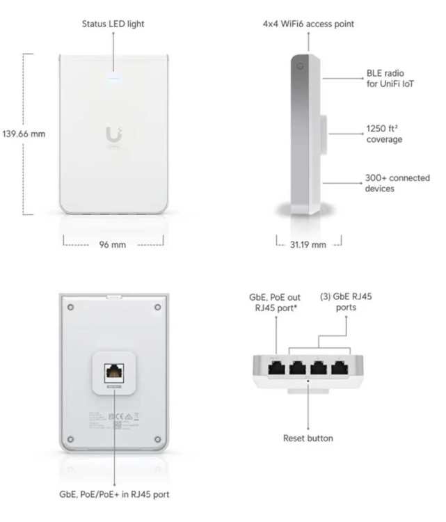

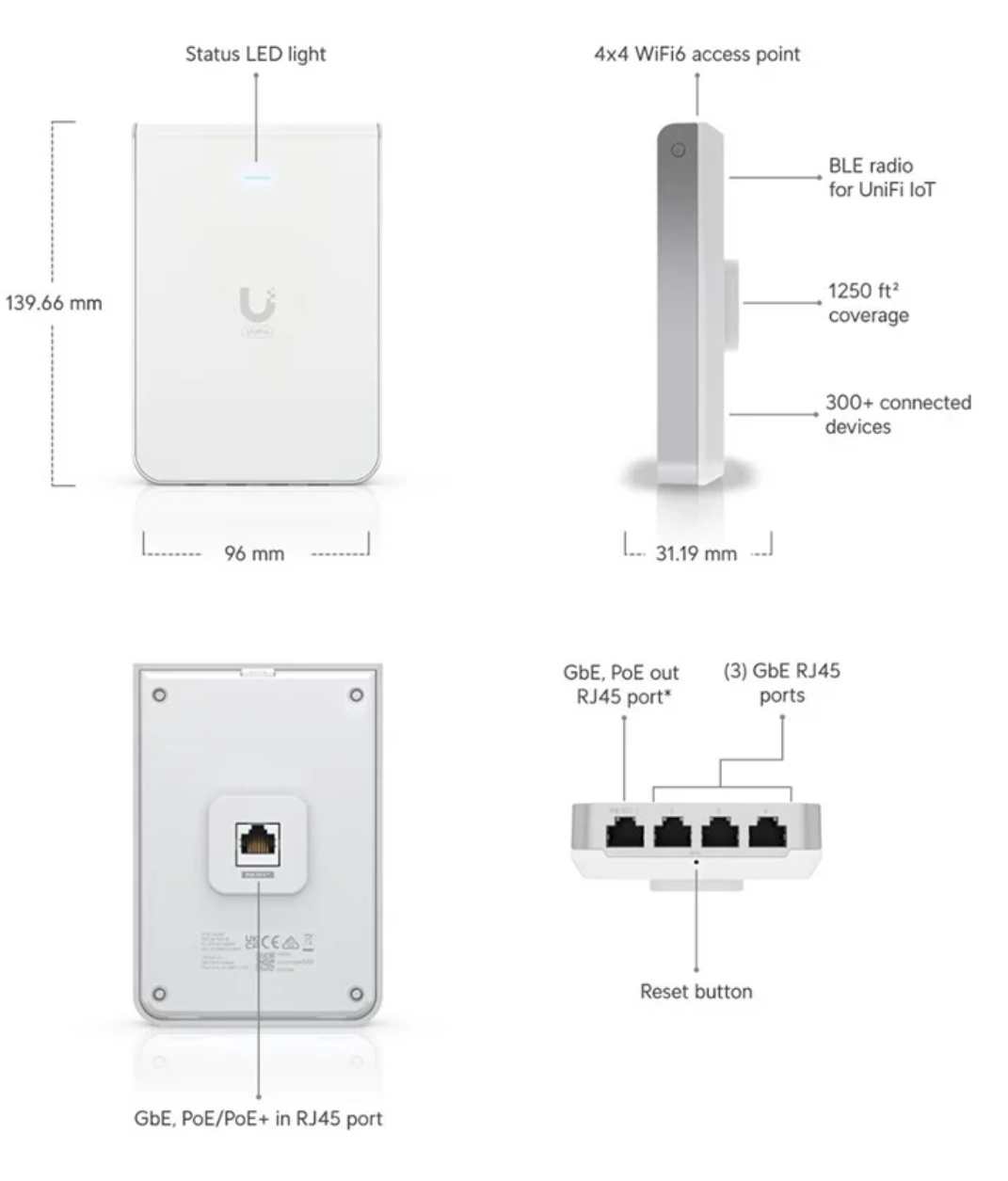

I did not lay enough Ethernet cable in my house and now need to get creative to set up various extra PoE cameras.
currently, I have the Internet coming in and going straight to a VirginMedia router that is just set up in modem mode. From there, it goes to my Ubiquiti Dream Router which then provides internet to a NETGEAR PoE Switch 8 Port Gigabit Ethernet Unmanaged Network Switch (GS308PP) - with 8 x PoE+ @ 83W.
Two of those ports respectively feed Internet to two combination APs/switches which @Nickfromwales recommended, otherwise known as the Ubiquiti U6-IW. Image of the U6-IW below:
If I buy another netgear switch like the one above, and feed it Internet from one of the U6-IW units, will that enable me to plug my PoE cameras into the netgear switch, or is not advisable to have a switch taking its Internet from a switch which is in turn taking its Internet from the U iquiti Dream Router (which itself has a form of built in switch). Sends like a lot of switches!

Depends if you exceed the max w rating of the last powered port. POE to the last switch will be fed from a single port, so there’s the possible bottleneck.
Plural (camera's) so how many need to run off the last switch?

Shouldn’t be a problem. The new switch should receive data only, with power supplied to the POE ports by the new switch’s power supply (unless I’ve misunderstood the setup!)

Ah, yes, my apologies.
@Adsibob I thought you meant another Ubiquiti WAP, where it gets power from the source that feeds it, so @MrSniff is correct; you can send the data signal to another mains powered POE switch and gain another x number of powered ports for the POE cameras.
