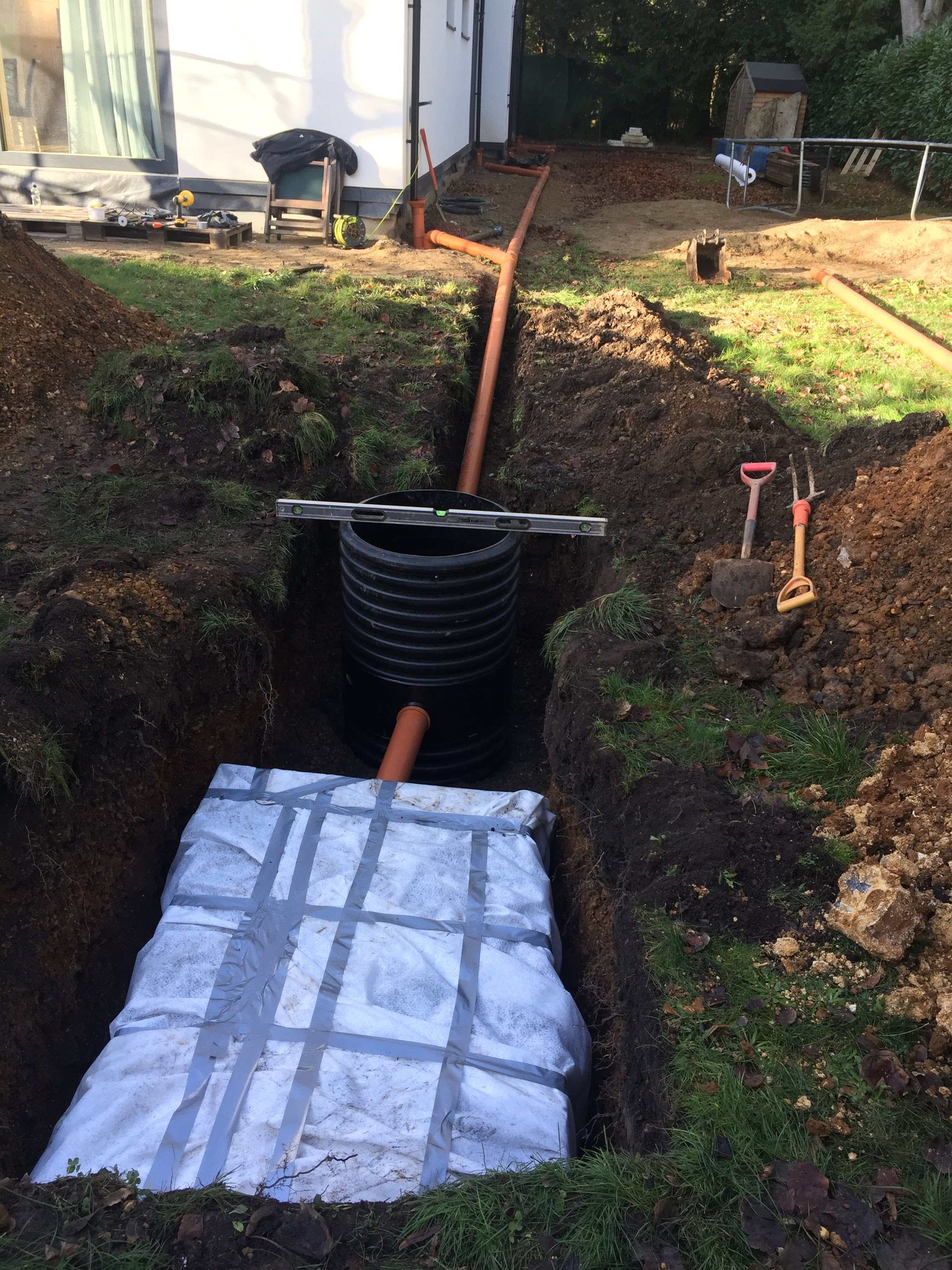

Weebles Posted February 23 Posted February 23 When we did the house drainage we had no money so we just drained our flat roof to a new soakaway. Now, we can afford a rainwater tank and with water bills going up and more dry spells and the garden still not finished we have an opportunity to fit an underground rainwater storage tank to serve the garden only. Here’s what the drain looks like. There’s not enough space to fit a tank “in series” (ie before the circular catchpit) as we have a bit of a paved path in place now. But can we fit it “in parallel” ie spur off the pipe before the catchpit and then flow the overflow from the rainwater storage tank (sited to the left in the photo) back into that pipe before the catchpit? Is this a crazy thing to do? We would have to expose all this again too as it’s buried under an area that is going to be turfed properly this year so this is the last chance. Was thinking a pump to a tap too. has anyone done anything like this?

saveasteading Posted February 23 Posted February 23 13 minutes ago, Nickfromwales said: most in agreement that it costs more, long term, than it saves. Yes, if it is only about money. But it is 'a good thing' in reducing water consumption i summer and outfall to soakaway in winter. You may have water for the garden when others have none, in a hosepipe ban. In parallel could work if you get the levels right and the water to flow where you want. Or change that chamber into a holding tank, with overflow going to the soakaway.

Alan Ambrose Posted February 24 Posted February 24 >>> But can we fit it “in parallel” Looks like you have enough room to branch off at an angle and back again - it might depend on which tank though i.e. inlet and outlet positions and height. Min fall of pipe is, say, 1 in 100. 1

Temp Posted February 24 Posted February 24 (edited) We installed an underground tank and pump when we built our house. The instructions specified a concrete slab foundation to stop the tank floating out of the ground. It has a leaf trap/filter but has still accumulated a fine silt in the bottom. There is an access hatch/manhole cover to allow the pump to be lifted out. Gets used a lot in summer for garden watering. Can't remember the exact capacity but think it's around 2000L. We also had a caged IBC on an allotment. This was raised up about 800mm on blocks laid horizontally so a watering can fits under the tap and gives a bit more pressure for a hose. I don't think the IBC we had would be cutting enough for underground use without more reinforcement. Probably need to fill it with water then concrete around it? We nearly had a disaster with our turf. The weather changed to sunny and windy and we couldn't water it fast enough to stop it shrinking and gaps forming. We had two sprinklers going and moved them every hour but still wasn't enough. Couldn't use more sprinklers because the pressure dropped so the area being watered didn't increase. The rainwater tank ran out on second day. The next week or so we had the sprinklers on mains water. Edited February 24 by Temp

saveasteading Posted February 24 Posted February 24 We will put in a tank between the house and soakaway, be part of the journey if you will. I'm thinking 3m3. For the pump, I Can choose to immerse a battery pump with a hose or to a simple standpipe. Or a quaint village pump type thing. Perhaps both. It will be fed from 180m2 plan area of roof, so it will take 15 mm of rain to fill it. July rainfall is 61mm. Maybe I should go 4m3. I'll look on 'marketplace' for a tank. But for now, I'm going to think of whether ibc × 3 is sensible. At the right price, £25 yes. But people seem to want £50 or more. Then how to stop it caving in when empty? It should never float because it will be full in wet weather. But a couple of spikes and a cable is simple. All suggestions welcomed. The BuildHub rwh for cheapskates/ the sustainably minded. @Temp @marshian What would you do differently another time?
