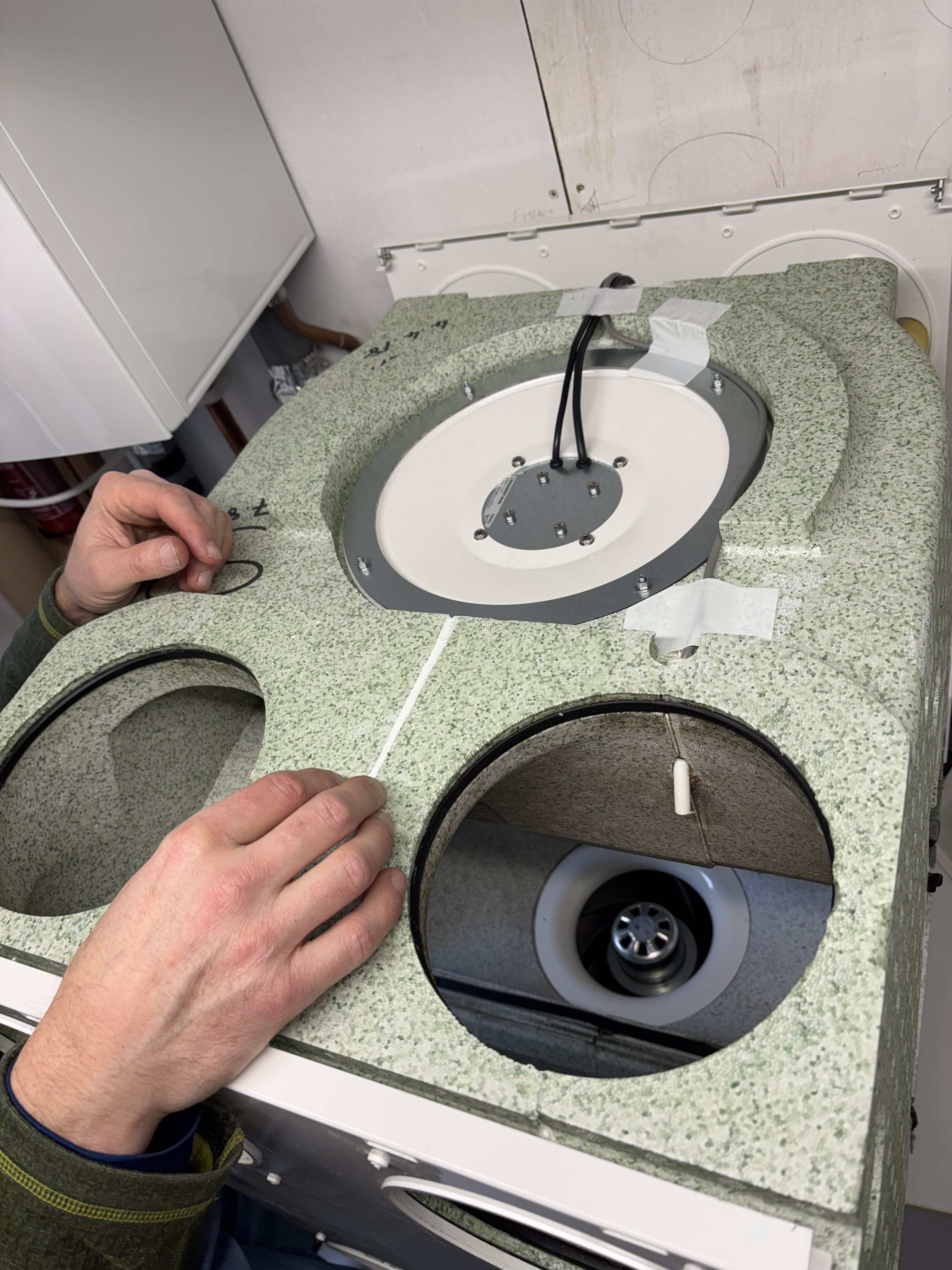

You can’t get to the fans without taking off the side panel. You can’t take off the side panel without taking it off the wall. And to do that you have to disconnect all the extract / intake ducts. The photos below start from once we got to this point.
We identified which fan had the problem. When spinning them both one of them stopped a lot quicker.

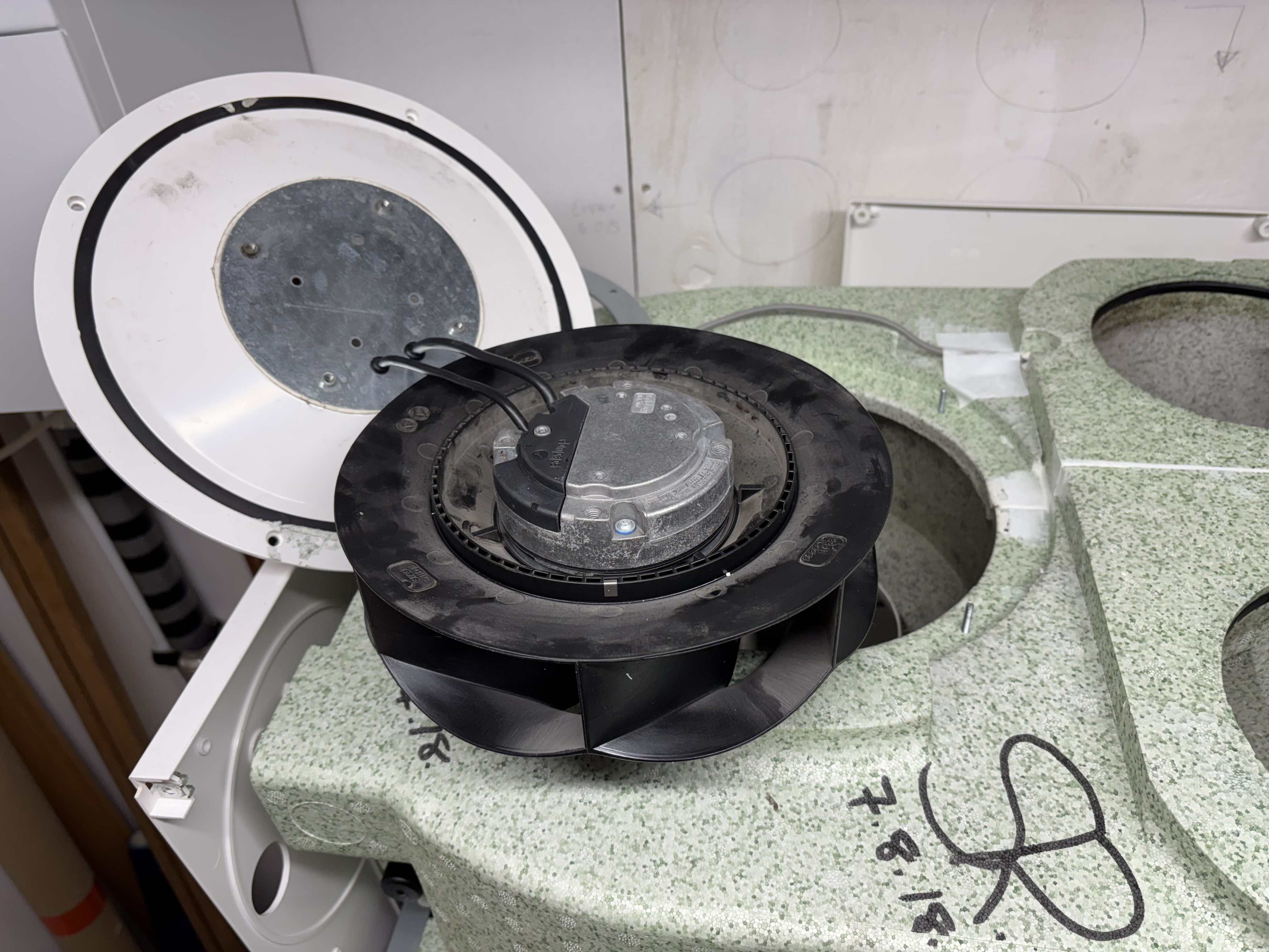

Was an effort just to get the fan housing out due to it being stuck in with lots of sealant.
But here it is, finally out. Prised out with a flathead screwdriver.

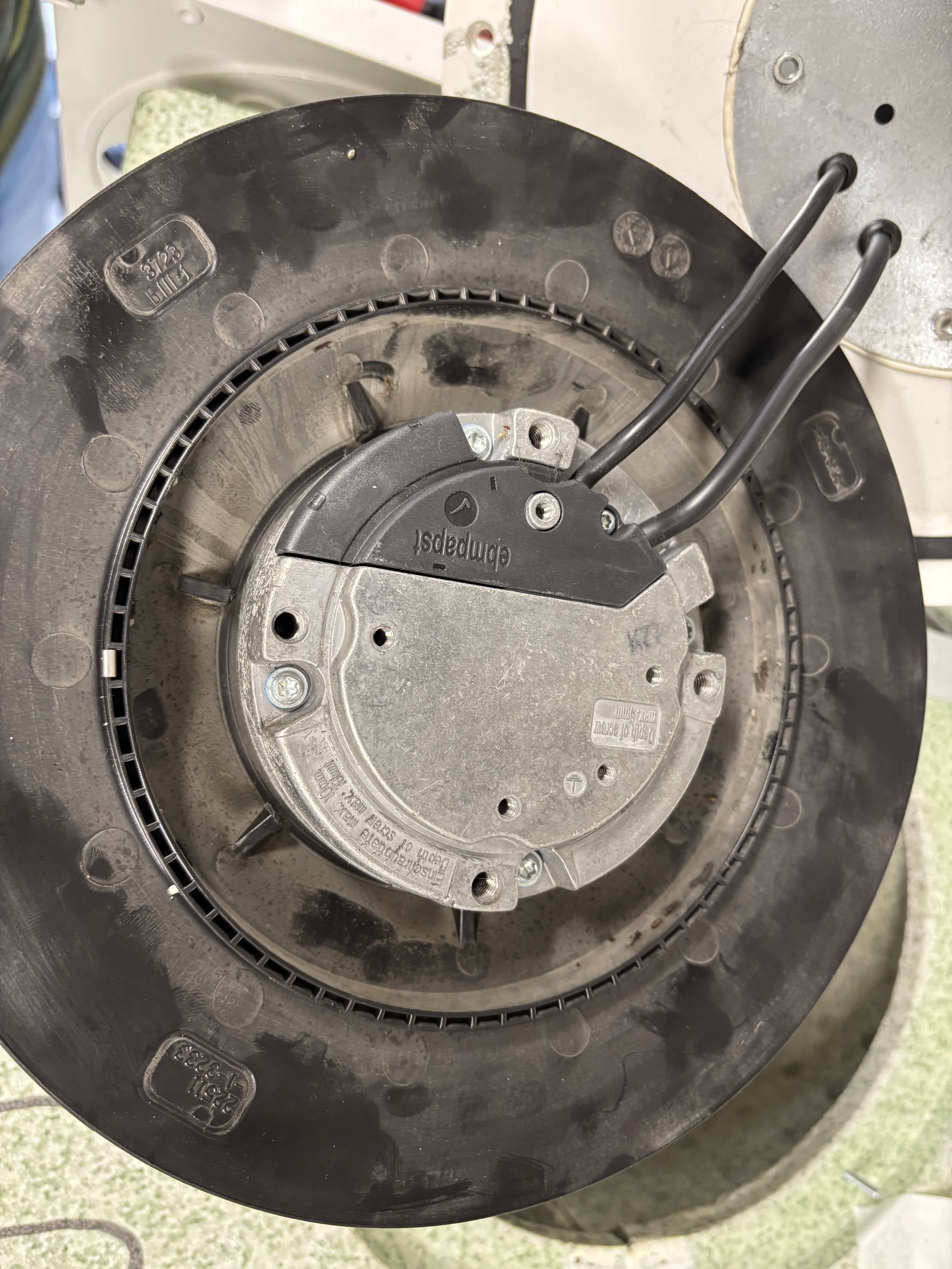

Then we removed the black rubber bit on the top. That took some prising out too once the screws were out.

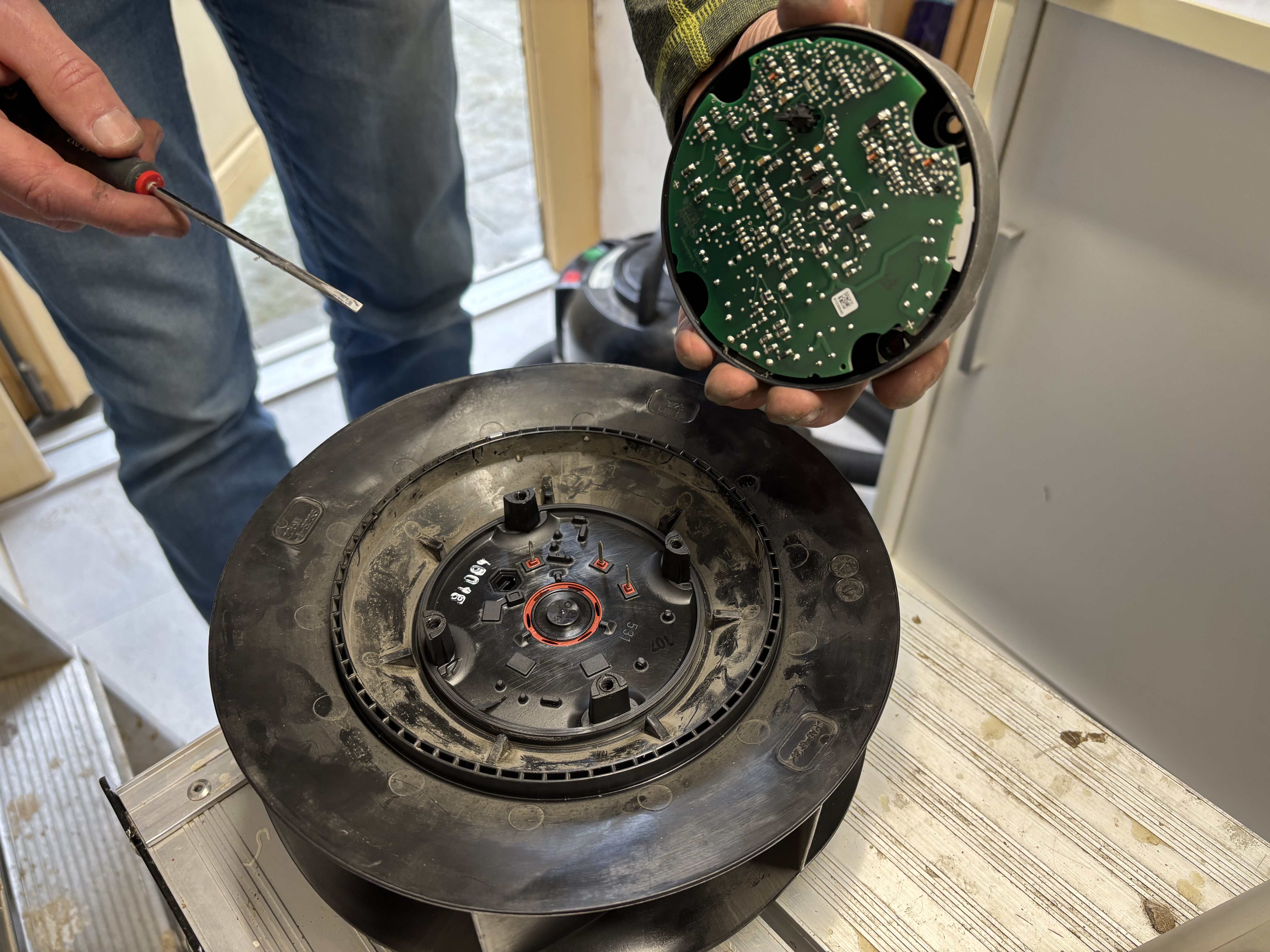

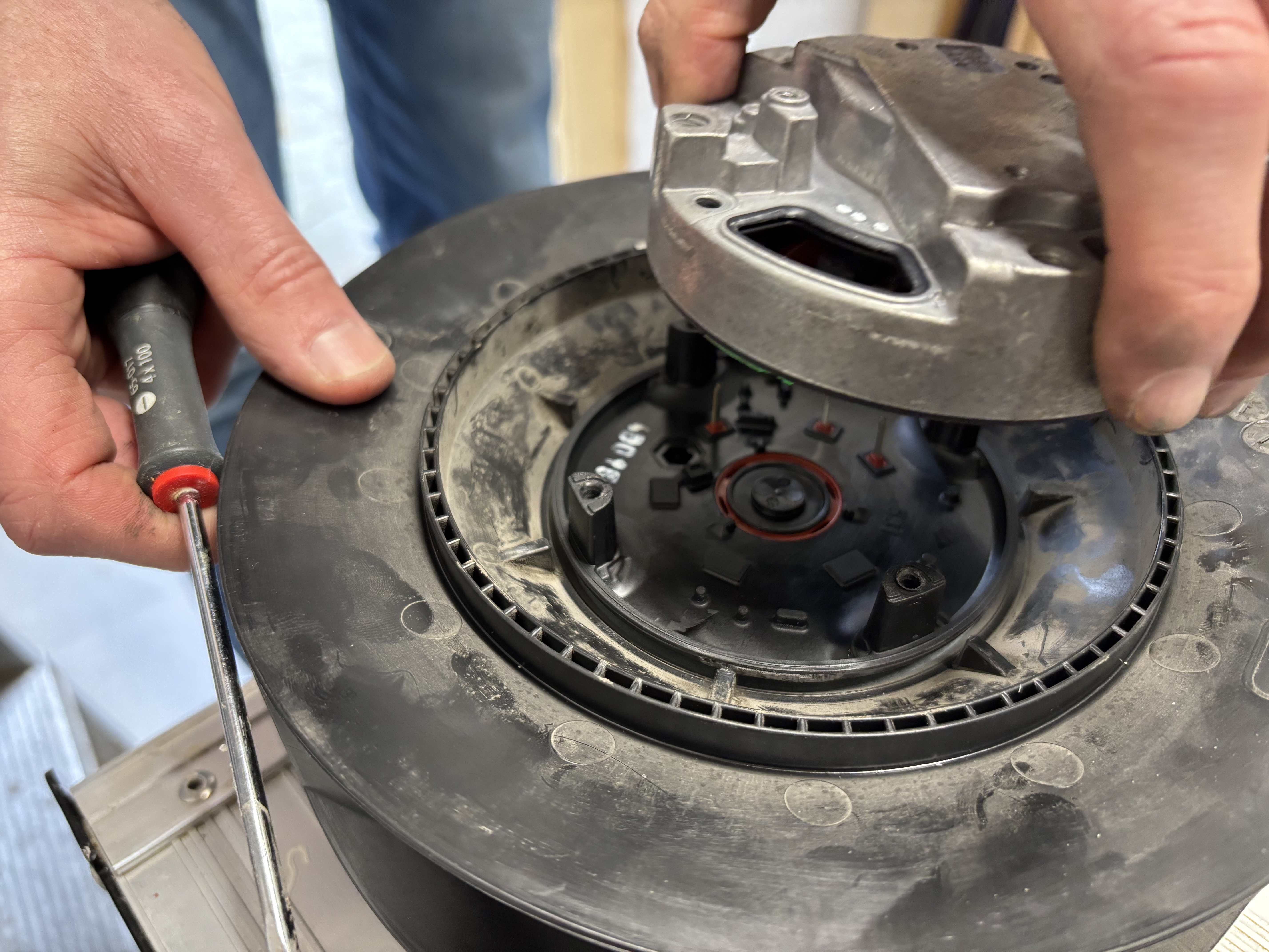

Then we pulled the section housing the circuit board off. Again, it didn’t come away easily.

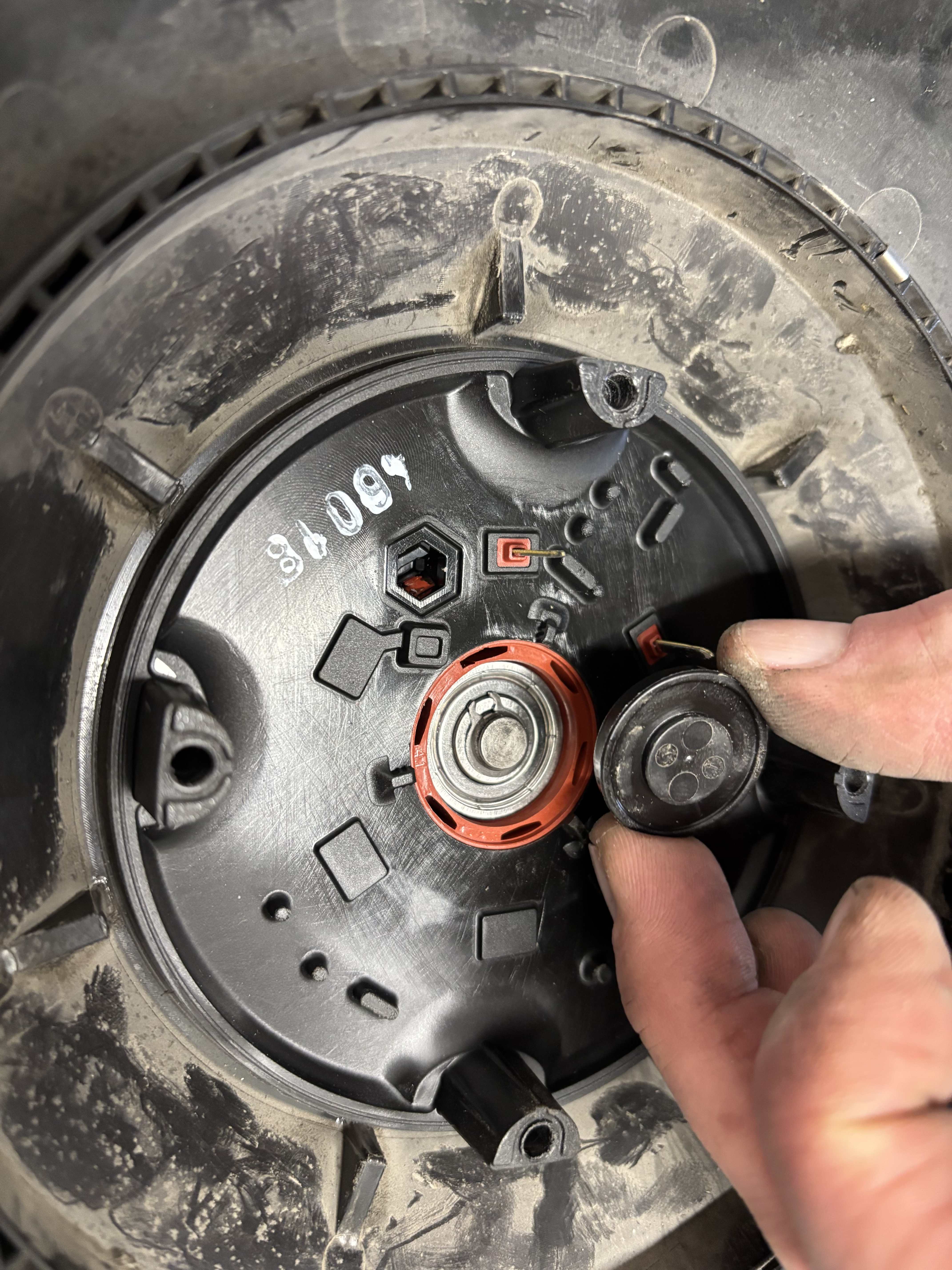

Then we popped the black button bit off
The next bit was surprisingly hard as @Stones had said - the c-clip was really hard to remove. We used a couple of screwdrivers to force it open and a third to pop it up, and it bounced around the plant room fortunately landing at our feet.

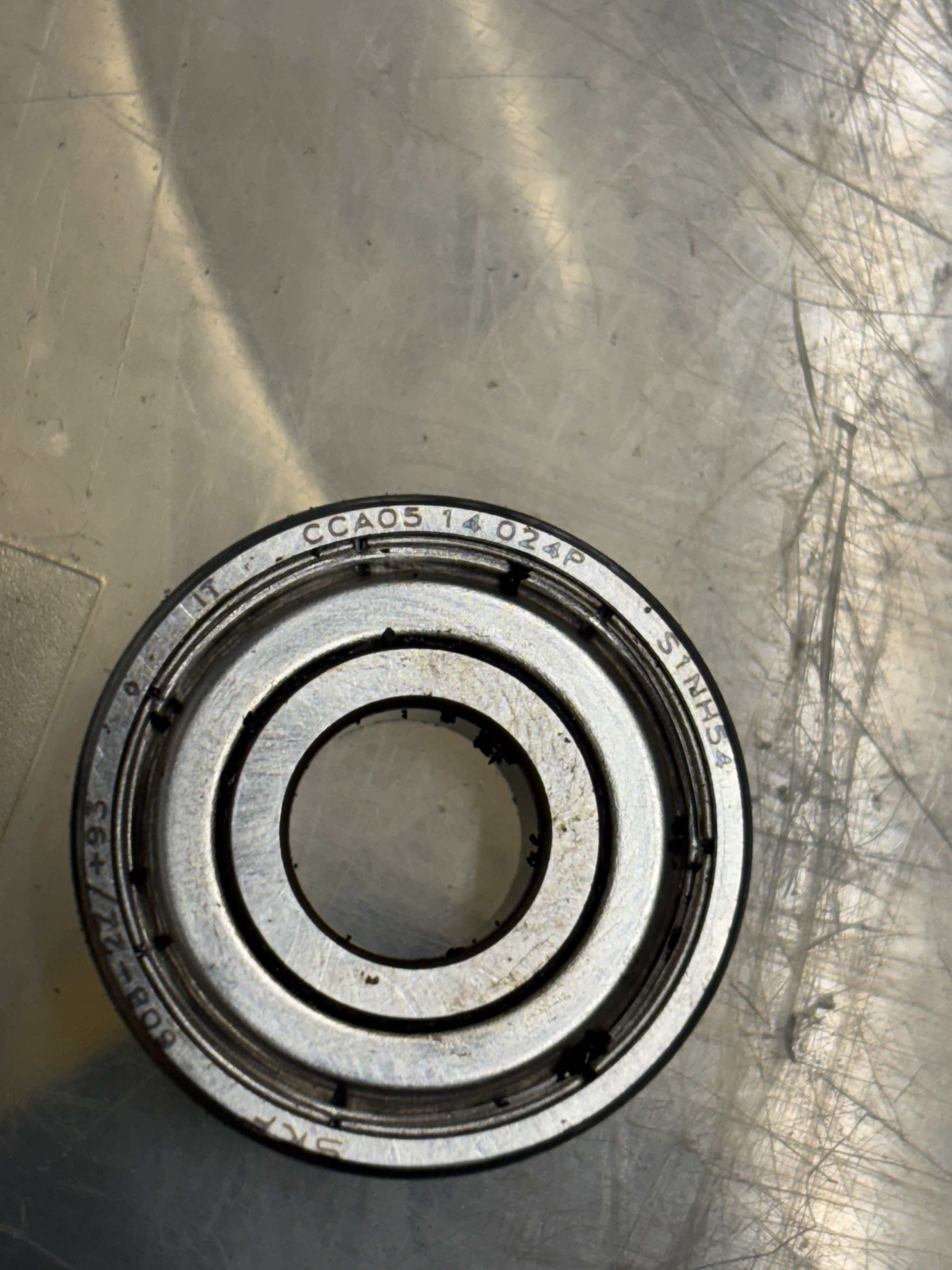

The first bearing took some effort to get out but it looks alright - we will still replace it as maybe the dirt around it is early signs that it’s done. Part number easily seen. 608-2Z

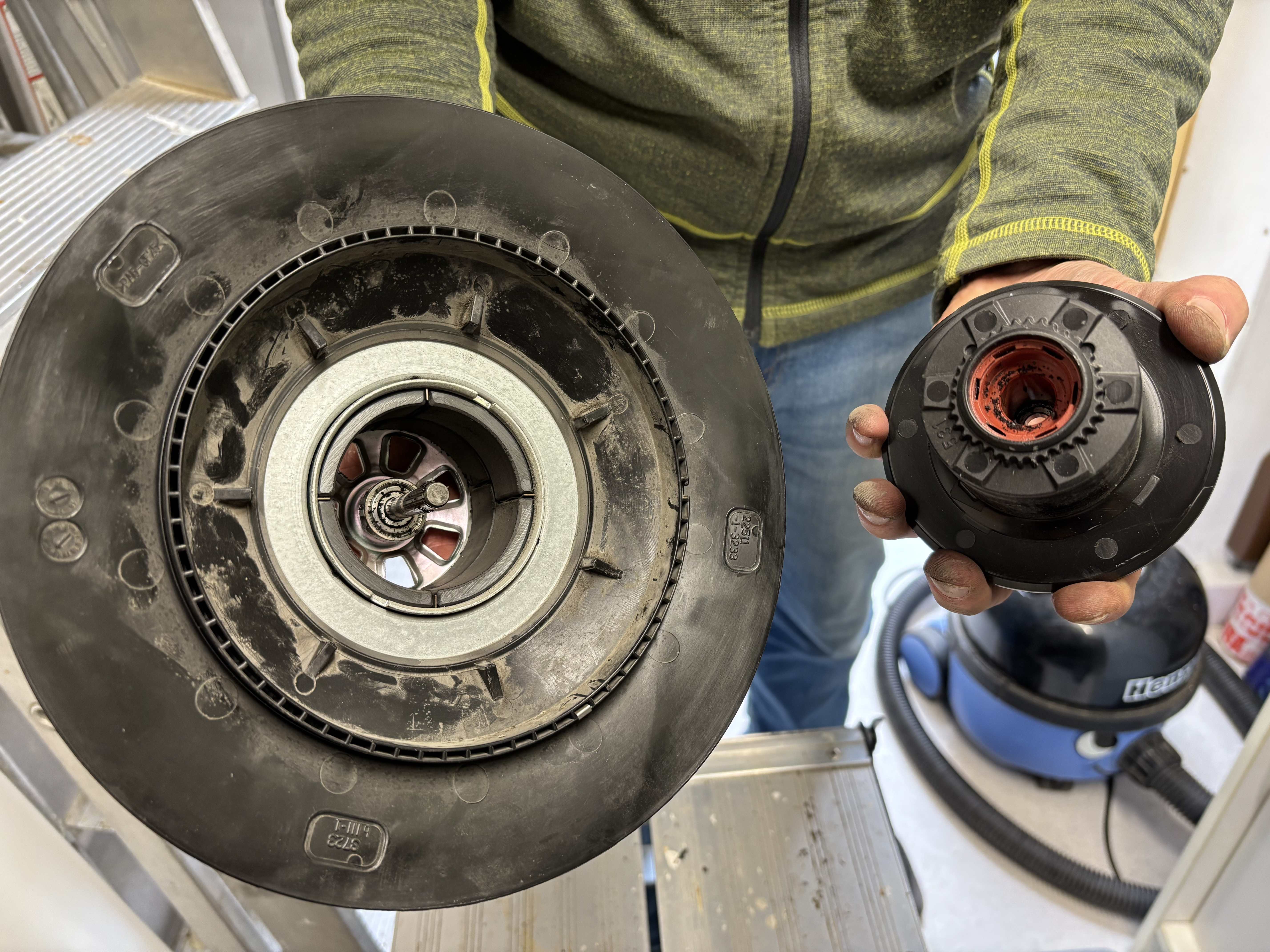

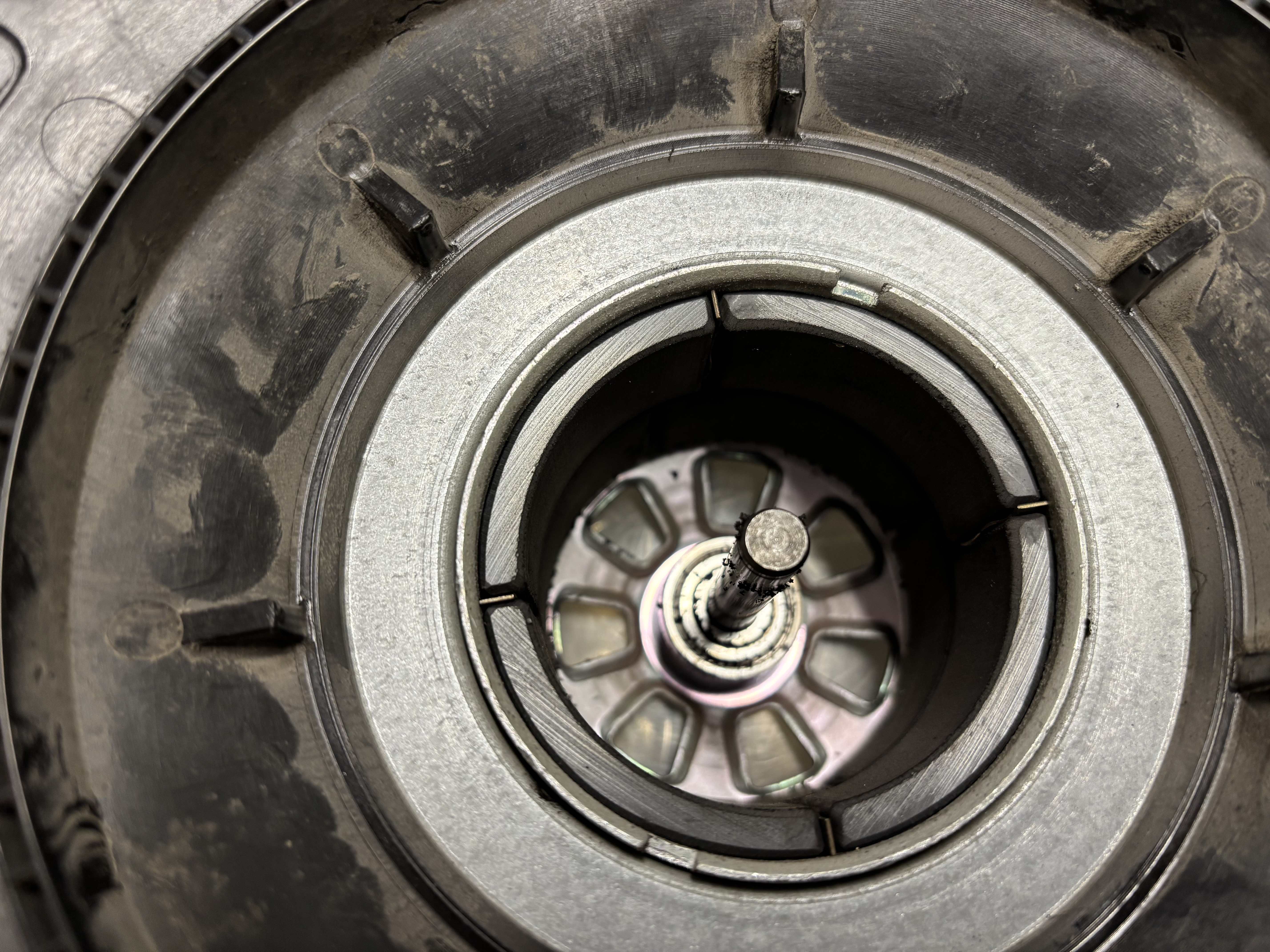

Then the magnet holding this section in was so strong it took a fair force from the other end to get it out and see the other bearing.

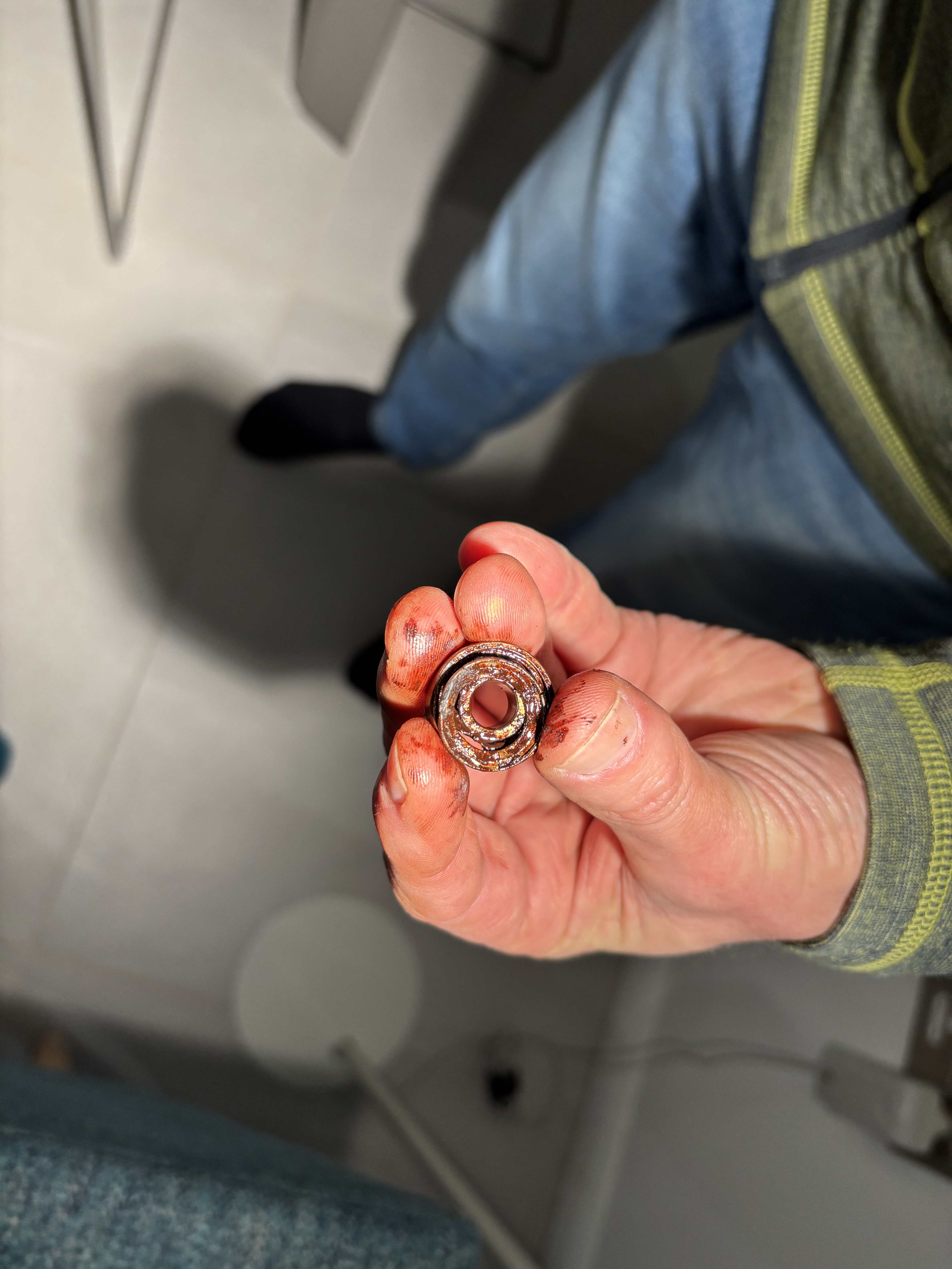

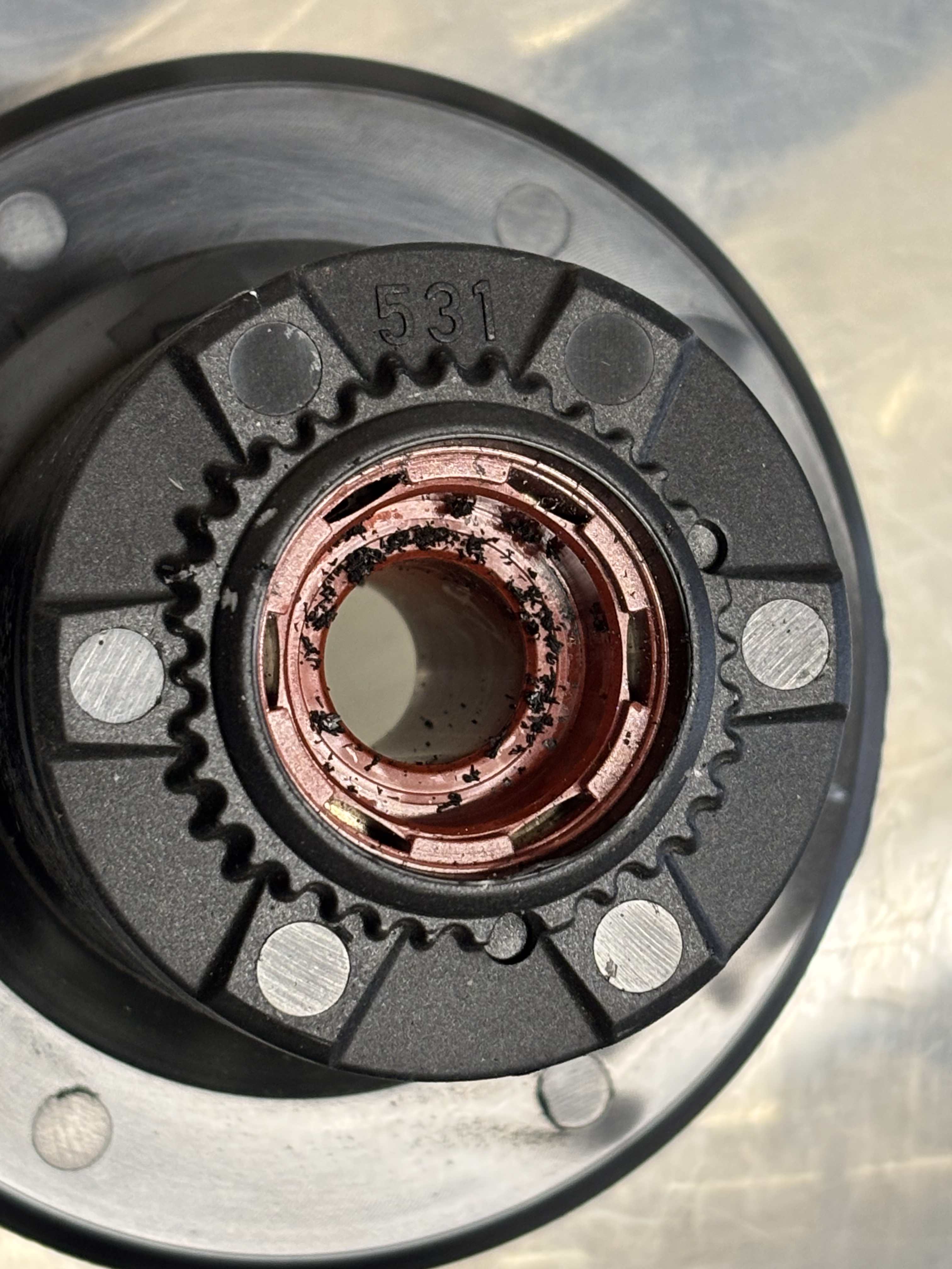

This bearing was so hard to remove. Others have said they just popped out. Not ours. But this might be why….
