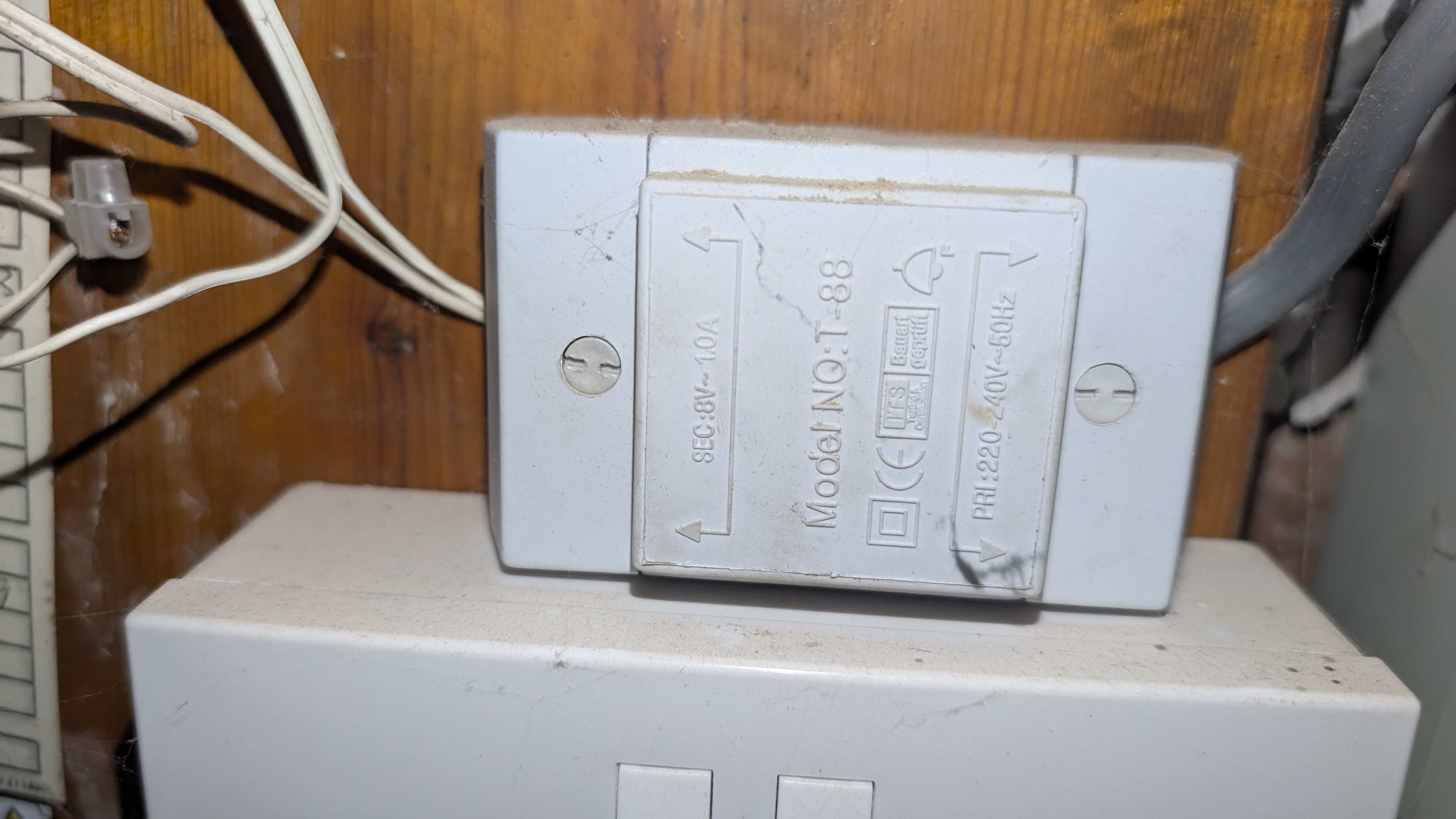

Bryera Posted February 17, 2025 Posted February 17, 2025 Dose anyone know by looking at this if this will power a ring door bell ?
MikeSharp01 Posted February 17, 2025 Posted February 17, 2025 Not really because the ring system is 24V at 500mA AC by the looks of it. Your transformer is 8V at 1.00A so neither has the power output needed (12W needed 8W available) or the voltage (24V needed 8V available.) 2

Bryera Posted February 17, 2025 Author Posted February 17, 2025 6 hours ago, Alan Ambrose said: A PoE doorbell, if you can run a cat5 cable to it, will give you power and direct network so you never have to think about it again. So do I need a different transformer and if so witch one ? And yer I had ring door bell for long time and sick of changing batteries as I have my settings to max and it covers a big bit of the garage so battery seems to go down quicker getting up on power I have one less job to do one less thing for wife to shout at me about 😂😂
