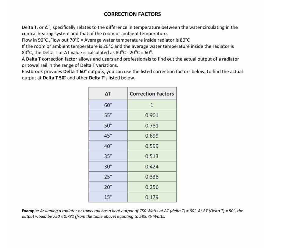

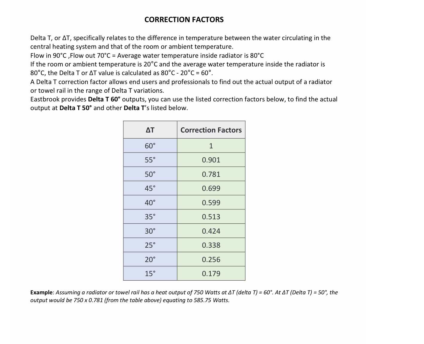

John Carroll Posted February 16, 2025 Posted February 16, 2025 17 minutes ago, DREG said: The main bathroom, which has a room volume of 25m3 is fitted with a vertical panel radiator rated at 5668BTU at deltaT 60C. However, the water going into the radiator is only about 38-40C; giving a deltaT of 20C. Weather compensation is set so that the heat pump should produce water at 48C, when air temp. is close to 0C. Applying the radiator manufacturer’s deltaT correction factor means a corrected output of approx. 1400BTU. The design temperature of the bathroom is 22C and to date, the developer’s plumber has not been able to achieve a temperature higher than 20C, by balancing the upstairs radiators. Usually, the bathroom temperature hovers around 17-19C dependent on outside air temperature. A lack of adequate insulation was identified in the bathroom ceiling. It was underdrawn with thermal plasterboard recently; but this has made no discernible difference. There was a discussion about putting a larger rad [higher BTU output] in the bathroom. However, the heat pump manufacturer/supplier advised against this as it would “result in the heat pump becoming over worked and running more defrost cycles, taking heat away from the primary circuit”. Just looking at the figures for the bathroom, flowtemp of say 39C with dT of 20C? gives a return temp of 19C, a mean rad temperature of, (39+20)/2, 29C, giving a output (T60 based) of ((29-20)/60)1.3, (9/60)^1.3, 8.5%, rad output, 5668*8.5%, 482BTU by my calcs or 141W (not a lot), if the room temp is 18C then the output is (11/60)^1.3, 11.02%, actual rad output 5668*11.02%, 625BTU, 183W?. That dT seems very high for a flowtemp of 39C, would have expected ~ maybe around 8C or so which would increase the rad output due to the higher mean rad temp so ~ rad output of 16.49% to give a output of 935BTU, 274W assuming the room temp rose to 20C.

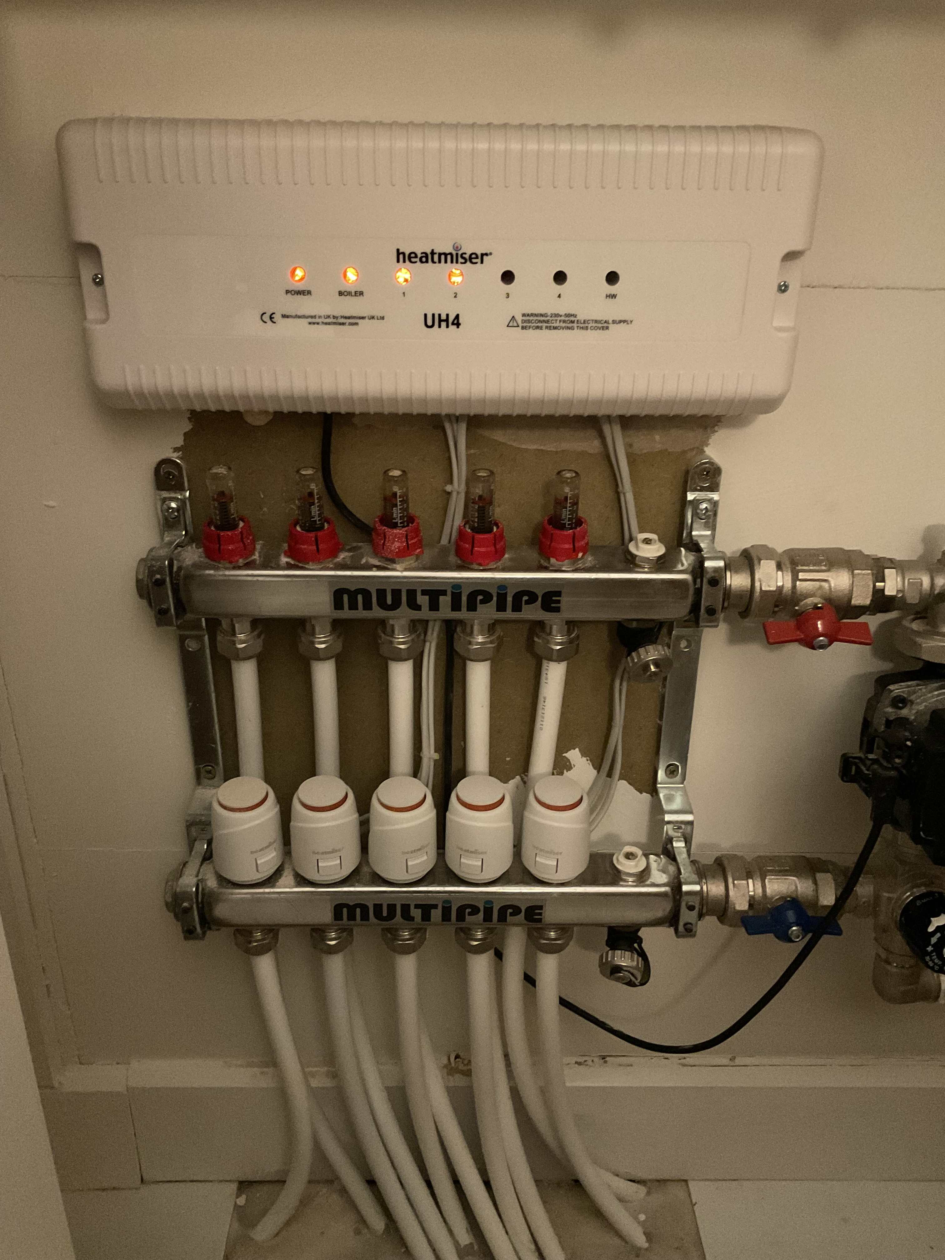

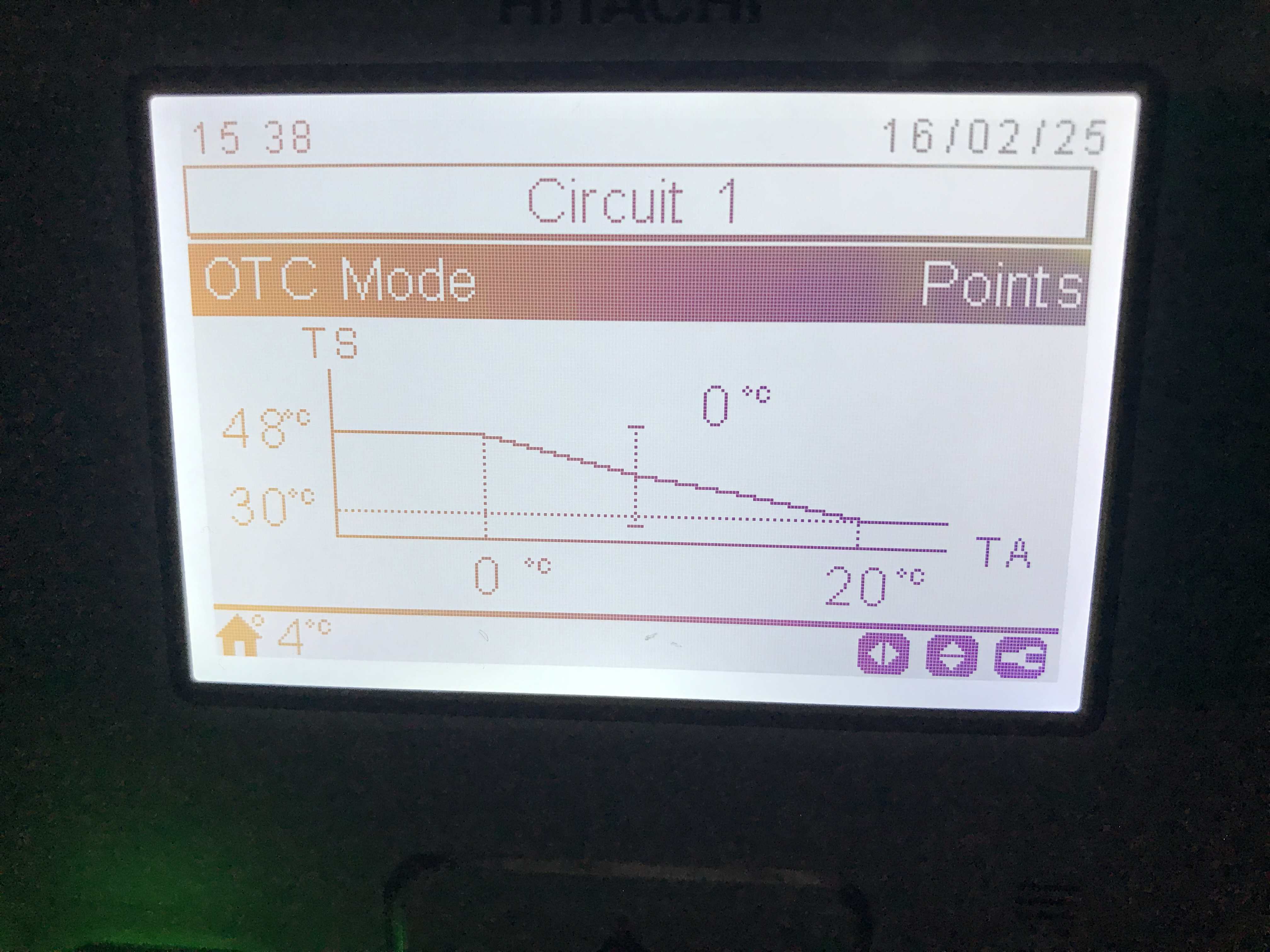

DREG Posted February 16, 2025 Author Posted February 16, 2025 Hi JohnMo There are 6 Heatmiser thermostats on the ground floor which has UFH. The schedule is: 06-0900 21C 09-1600 20C 16-2200 21C 22-0600 20C That is to have the heat pump running 24/7 and to reduce the warm up load, based on the advice I was given. Weather compensation is set on the YUTAKI controller, photo below. Upstairs radiators controlled by a single Honeywell thermostat located on the landing. Schedule is very similar to that of the ground floor.

DREG Posted February 16, 2025 Author Posted February 16, 2025 4 hours ago, John Carroll said: Just looking at the figures for the bathroom, flowtemp of say 39C with dT of 20C? gives a return temp of 19C, a mean rad temperature of, (39+20)/2, 29C, giving a output (T60 based) of ((29-20)/60)1.3, (9/60)^1.3, 8.5%, rad output, 5668*8.5%, 482BTU by my calcs or 141W (not a lot), if the room temp is 18C then the output is (11/60)^1.3, 11.02%, actual rad output 5668*11.02%, 625BTU, 183W?. That dT seems very high for a flowtemp of 39C, would have expected ~ maybe around 8C or so which would increase the rad output due to the higher mean rad temp so ~ rad output of 16.49% to give a output of 935BTU, 274W assuming the room temp rose to 20C. The plumber found the temp of the water entering the rad to be 37C. The design temp of bathroom is 22C. Based on rad manufacturer’s table (see photo) the deltaT is 15C, I think-perhaps less if you allow for the temp drop across the rad. It’s a big rad (1800x575mm) with output of 5668BTU/1662W. I’m assuming the reduced heat output and less than design temperature in the bathroom is down to the temp of the water entering the rad. This is the second rad that’s been put in the bathroom. Previously it was a chrome type towel rad. When developer changed it they said the aluminium column rad would be more than adequate but they don’t appear to have taken account of the temp of the water in the rad.

JohnMo Posted February 16, 2025 Posted February 16, 2025 39 minutes ago, DREG said: That is to have the heat pump running 24/7 and to reduce the warm up load, The basics on how a heat pump works. It will start and basically ramp up to full load. It will first try and get it's running delta T (difference between flow and return temperature) to within a defined pont controlled by the controller. It then only as Delta T reduces add more heat to the flow temperature. With UFH this can take hours. I would set all thermostats to 22, and let the system stabilise. Leave a couple of days. Do not do any setbacks, just let weather compensation do it's thing. You are making the heat pump run full load most the time. Doing yourself no favours. If I let my house temp drop by a full degree, heat pump or boiler would take around 24 hrs to recover. Room temperature setup, if a room is too hot, reduce the flow rate to those loops by 0.5L/min, leave again for 12 hours. Opposite for cool rooms. Use the heatmiser as a monitor system do not use for control. That is the heat pumps job. This will take some time.
JohnMo Posted February 16, 2025 Posted February 16, 2025 A thing I forgot to mention With a mixed radiator and UFH, the flow coming out of the UFH (cool) will dominate how the heat pump runs, until the floor temp stabilises.

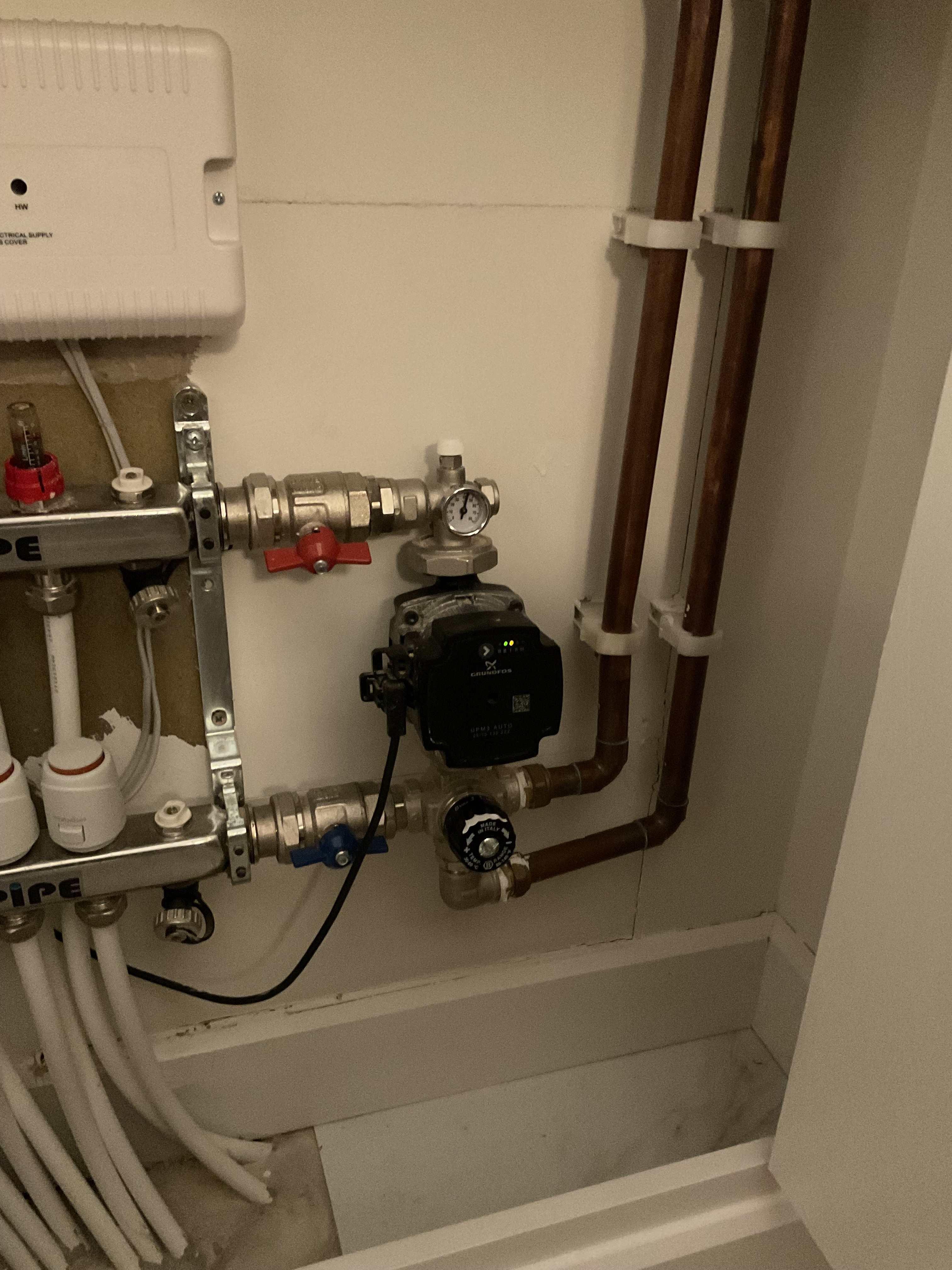

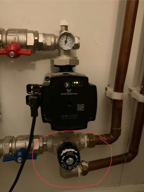

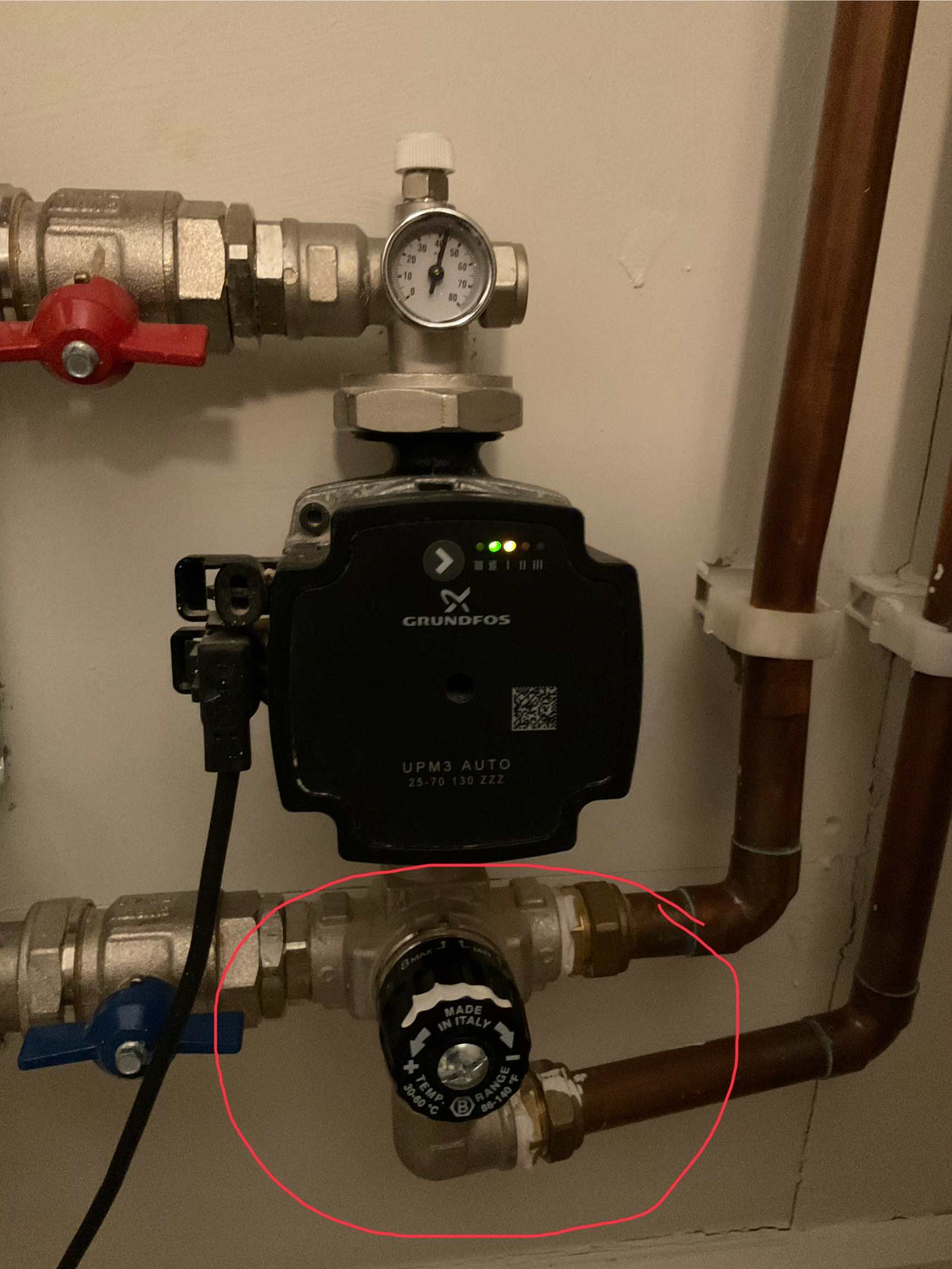

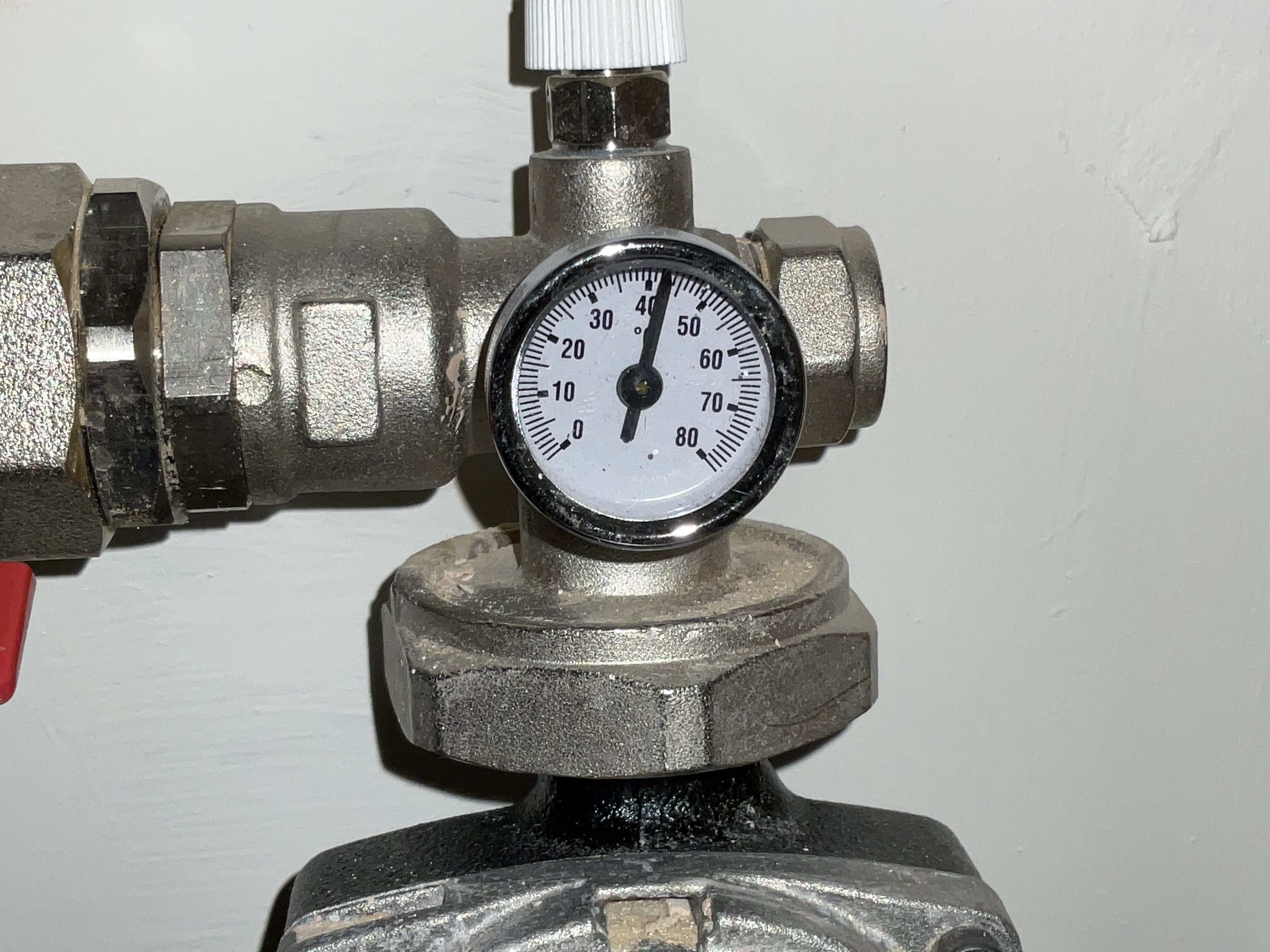

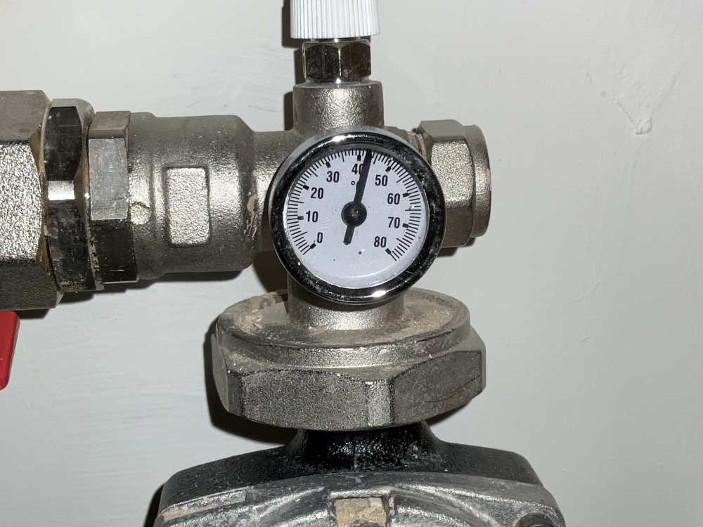

JohnMo Posted February 16, 2025 Posted February 16, 2025 4 minutes ago, DREG said: Assuming the WATER INLET and WATER OUTLET temps shown on the controller (photos below) equate to RETURN and FLOW temps, I could estimate POWER as: Sounds about correct. But your target flow temp has been met, dT is small, so heat pump is modulating output down. At that time you have the UFH switched down to 20 degs, so most likely the heat pump is just doing radiators.
DREG Posted February 16, 2025 Author Posted February 16, 2025 1 hour ago, JohnMo said: There isn't a reason why a house completed in 2022 should need anywhere near 11kW. I'm at nearly 200m² 6m high ceiling in one room, which also floor to ceiling glass, all other average 3m tall. At -9 the house needs around 3kW. Taking away heat recovery ventilation would double the heat load Floors take lots of energy, take a huge amount of time to recover from being cool. Letting house cool takes an age to recover. If house heat loss is say 10kW, an 11kW heat pump needs to run 24/7 to just stand still. Let alone recover from 14 hrs effective off due to thermostat timings. Several different heat loss calcs done and all give heat loss of approx 10.3kW. I assume 11kW heat pump specified on that basis. But there’s no allowance for DHW heating or defrosting. Should there be? You recommend setting everything to 21C for 24hrs daily with no set-backs. Is that right?
JohnMo Posted February 16, 2025 Posted February 16, 2025 15 minutes ago, DREG said: You recommend setting everything to 21C for 24hrs daily with no set-backs. Is that right? Nearly. Set thermostats to 22. Ideal is to trim everything to get the room temperatures you want. But after a couple of days of settling. Set backs are serving to make the heat pump work harder than it needs too. 1

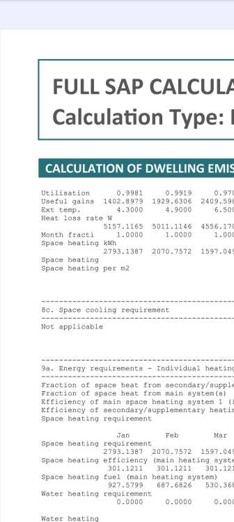

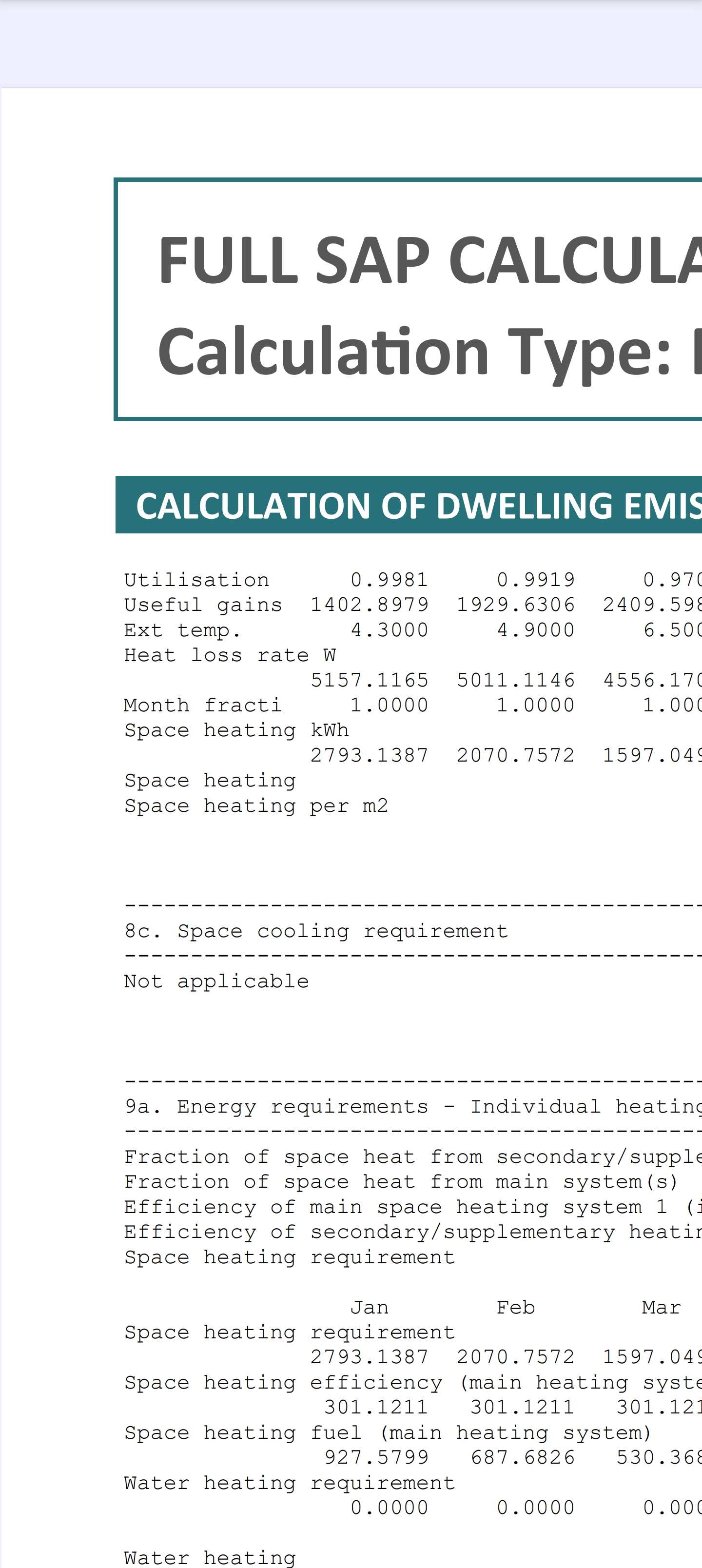

DREG Posted February 16, 2025 Author Posted February 16, 2025 ABSAPD_1.pdf 27 minutes ago, Andehh said: Something not right. We're 250sqm ish bungalow, with 3.5 to 4.5m ceilings, lots of glazing (albeit it 45 sqm kitchen floor have around 25sqm of glazing.... Which is a lot in its own right) and our 12kw Samsung ASHP has no real issues keeping us around 21 degrees with around 12 hours run time even on the coldest of sub zero days. Ufh throughout though and we upgraded all our insulation. Can you post up your Sap report? What insulation is detailed? Here’s the SAP report
JohnMo Posted February 16, 2025 Posted February 16, 2025 As said earlier the 11kW sounded high. Your SAP report says the January heat demand is 5171W.
JohnMo Posted February 16, 2025 Posted February 16, 2025 Interesting the target rates are lower that the as built. Which is very poor. So built house is worse than minimum building regs.
